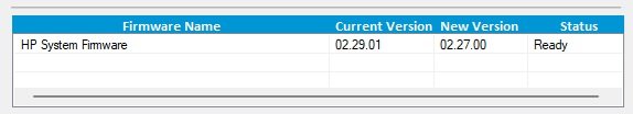

deeveedee Posted January 20 Author Share Posted January 20 (edited) I haven't been the most attentive to BIOS updates for the HP EliteDesk Minis, so I may have missed someone's earlier post. The HP support site for EliteDesk 800 G4 Mini 35W shows the latest BIOS version as 2.27. I just performed a BIOS update from within BIOS Setup and my EliteDesk 800 G4 Mini 35W detected and downloaded version 2.29. Just to confirm, I downloaded the HP BIOS update in Windows 11 and started the update from within Windows. The BIOS updater detected my BIOS version as 2.29, while showing the latest version as 2.27. Anyone else seeing this? EDIT: I have updated my HP EliteDesk 800 G5 Mini 65W BIOS to 2.21. My G4 and G5 Mini hacks running BIOS 2.29 and 2.21 respectively are running macOS without issues. I'll update the BIOS requirements in the first post of this thread. Edited January 20 by deeveedee 1 Link to comment https://www.insanelymac.com/forum/topic/343937-guide-catalina-big-sur-monterey-ventura-sonoma-sequoia-on-hp-elitedesk-800-g4g5-mini-the-perfect-macmini81-hackintosh/page/40/#findComment-2829774 Share on other sites More sharing options...
ird Posted January 20 Share Posted January 20 5 hours ago, deeveedee said: I haven't been the most attentive to BIOS updates for the HP EliteDesk Minis, so I may have missed someone's earlier post. The HP support site for EliteDesk 800 G4 Mini 35W shows the latest BIOS version as 2.27. I just performed a BIOS update from within BIOS Setup and my EliteDesk 800 G4 Mini 35W detected and downloaded version 2.29. Just to confirm, I downloaded the HP BIOS update in Windows 11 and started the update from within Windows. The BIOS updater detected my BIOS version as 2.29, while showing the latest version as 2.27. Anyone else seeing this? EDIT: I have updated my HP EliteDesk 800 G5 Mini 65W BIOS to 2.21. My G4 and G5 Mini hacks running BIOS 2.29 and 2.21 respectively are running macOS without issues. I'll update the BIOS requirements in the first post of this thread. I have 2 HP G4 800 minis, one 35W running macOS and the other 65W running Linux. Only the Linux 65W had 2.29 available for download and update while the 35W strangely is still on 2.27 on the website. Other than having LAN connected to the computer at boot (that I don't), not sure how to pull in 2.29 for the 35W mini. Any advice or download links? Link to comment https://www.insanelymac.com/forum/topic/343937-guide-catalina-big-sur-monterey-ventura-sonoma-sequoia-on-hp-elitedesk-800-g4g5-mini-the-perfect-macmini81-hackintosh/page/40/#findComment-2829791 Share on other sites More sharing options...
deeveedee Posted January 20 Author Share Posted January 20 (edited) @ird Maybe HPs support site still needs to catch-up to the latest BIOS update. In order to update my EliteDesk 800 G4 35W minis to 2.29 (with connected Ethernet), I opened BIOS settings (F10) and updated BIOS. 2.29 was detected as the latest version. EDIT: I don't know how to pull 2.29 without connected Ethernet. Edited January 20 by deeveedee 1 Link to comment https://www.insanelymac.com/forum/topic/343937-guide-catalina-big-sur-monterey-ventura-sonoma-sequoia-on-hp-elitedesk-800-g4g5-mini-the-perfect-macmini81-hackintosh/page/40/#findComment-2829793 Share on other sites More sharing options...
CloverLeaf Posted January 21 Share Posted January 21 6 hours ago, deeveedee said: @ird Maybe HPs support site still needs to catch-up to the latest BIOS update. In order to update my EliteDesk 800 G4 35W minis to 2.29 (with connected Ethernet), I opened BIOS settings (F10) and updated BIOS. 2.29 was detected as the latest version. EDIT: I don't know how to pull 2.29 without connected Ethernet. You can download the latest update through HP Support Assistant (on Windows). I have mine updated already, doesn't see/feel anything different. Link to comment https://www.insanelymac.com/forum/topic/343937-guide-catalina-big-sur-monterey-ventura-sonoma-sequoia-on-hp-elitedesk-800-g4g5-mini-the-perfect-macmini81-hackintosh/page/40/#findComment-2829799 Share on other sites More sharing options...
deeveedee Posted January 21 Author Share Posted January 21 (edited) @CloverLeaf HP's support site for EliteDesk 800 G4 Mini 35W still shows BIOS version 2.27 for me. If I try to use the "auto-detect drivers" feature on HP's site, it shows no BIOS updates. I tried clearing browser cache and using different browsers to manually download, but still don't see version 2.29 (latest is still 2.27). When I performed my manual search, I selected OS as Windows 11. Edited January 21 by deeveedee 1 Link to comment https://www.insanelymac.com/forum/topic/343937-guide-catalina-big-sur-monterey-ventura-sonoma-sequoia-on-hp-elitedesk-800-g4g5-mini-the-perfect-macmini81-hackintosh/page/40/#findComment-2829817 Share on other sites More sharing options...
ird Posted January 21 Share Posted January 21 4 hours ago, deeveedee said: @CloverLeaf HP's support site for EliteDesk 800 G4 Mini 35W still shows BIOS version 2.27 for me. If I try to use the "auto-detect drivers" feature on HP's site, it shows no BIOS updates. I tried clearing browser cache and using different browsers to manually download, but still don't see version 2.29 (latest is still 2.27). When I performed my manual search, I selected OS as Windows 11. Selecting Windows 11 or Windows 10 is the same: shows 2.27 as the latest. Link to comment https://www.insanelymac.com/forum/topic/343937-guide-catalina-big-sur-monterey-ventura-sonoma-sequoia-on-hp-elitedesk-800-g4g5-mini-the-perfect-macmini81-hackintosh/page/40/#findComment-2829822 Share on other sites More sharing options...

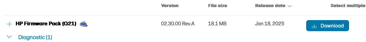

deeveedee Posted January 29 Author Share Posted January 29 (edited) Well, the HP support site has skipped BIOS 2.29 and is now providing 2.30. EDIT: At the time of this post, the support site does not include BIOS version 2.29 in the BIOS revision history. This is not the first time that HP's BIOS version releases are confusing. HP has synchronized the BIOS versions of the EliteDesk 800 G4 and G5 Minis. A new BIOS is also available for the G5 Mini and is also numbered 2.30. EDIT2: Note that, at the time of this post, the BIOS version available via BIOS setup (F10) is still 2.29, while 2.30 is available for download from the HP support site. Edited January 29 by deeveedee 1 1 Link to comment https://www.insanelymac.com/forum/topic/343937-guide-catalina-big-sur-monterey-ventura-sonoma-sequoia-on-hp-elitedesk-800-g4g5-mini-the-perfect-macmini81-hackintosh/page/40/#findComment-2830045 Share on other sites More sharing options...
ird Posted January 30 Share Posted January 30 11 hours ago, deeveedee said: Well, the HP support site has skipped BIOS 2.29 and is now providing 2.30. EDIT: At the time of this post, the support site does not include BIOS version 2.29 in the BIOS revision history. This is not the first time that HP's BIOS version releases are confusing. HP has synchronized the BIOS versions of the EliteDesk 800 G4 and G5 Minis. A new BIOS is also available for the G5 Mini and is also numbered 2.30. EDIT2: Note that, at the time of this post, the BIOS version available via BIOS setup (F10) is still 2.29, while 2.30 is available for download from the HP support site. I'm curious if this is just a version number change or a much bigger merge for G4 and G5. Two questions that I'm curious about: 1) Per your previous assessment G4 could not support any "true" 9th gen CPUs. Does that change now? 2) Per your previous assessment, G4 did not impose any PL1/2/3 CPU power limits and allowed good performance scaling of 65W CPUs in 35W Elitedesk SKUs but the G5 put a limit. Does that change now? Link to comment https://www.insanelymac.com/forum/topic/343937-guide-catalina-big-sur-monterey-ventura-sonoma-sequoia-on-hp-elitedesk-800-g4g5-mini-the-perfect-macmini81-hackintosh/page/40/#findComment-2830063 Share on other sites More sharing options...
