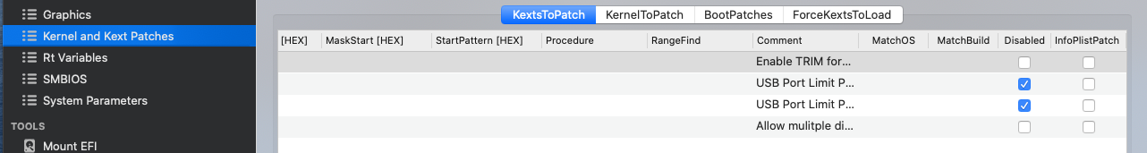

The USB port mapping for the micro may be different from the mini.  Try removing SSDT-UIAC.aml from EFI/CLOVER/ACPI/patched and enable the USB port limit patches in config.plist.  If you are using Clover Configurator, open the config.plist, navigate to Kernel and Kext Patches, enable the two USB port limit patches (I have them disabled) and save your config.plist.
Clover Configurator: Kernel and Kext Patches
Spoiler
111749589_ScreenShot2020-07-09at8_15_59AM.thumb.png.ef6367327e2c7273af652d9b77193683.png
If this "fixes" your problem, you will need to create your own USB port mapping for the micro.  I used Hackintool to create the SSDT-UIAC.aml for the mini.

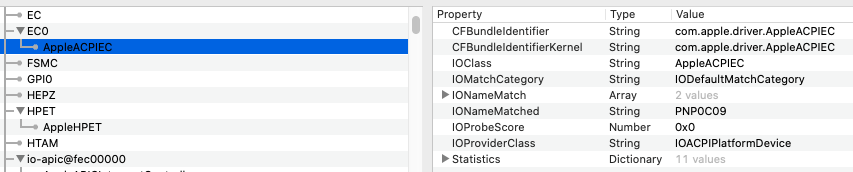

EDIT: After reviewing and testing the EC and PMCR advice in Dortania's ACPI Guide, I'm sticking with my original solutions. No changes at this time. Leaving the info below for informational purposes, in case I need to revisit for OpenCore.
I'm starting to examine OpenCore for this HP EliteDesk 800 G4 Mini. Dortania's reference here appears to be extremely well done. In addition, Dortania's ACPI Guide is a wealth of information. In the ACPI Guide, there is excellent discussion of the Embedded Controller and PMCR devices.
Based on the teachings in Dortania's ACPI Guide, I'm specifically reviewing the following:
  • Creating a Fake EC device instead of renaming EC0->EC. Preliminary results suggest that renaming EC0 is the correct way to handle the Embedded Controller for this G4 Mini. When a Fake EC device is created (instead of renaming EC0), Device (EC) exists, but AppleACPIEC binds to the existing EC0 device (because the existing EC0 device has HID PNP0C09).
    Spoiler
  • Moving Device (PMCR) from Scope (_SB.PCI0) to Scope (_SB.PCI0.LPCB) so that PMCR loads earlier. I'm hoping to assess the affect of this change through continued use, because I have not noticed any change in system behavior following this change. Note that as observed in the IORegistry dump from a real MacMini8,1, Device (PMCR) in a real MacMini8,1 is in Scope (_SB.PCI0).
Edited by tonyx86

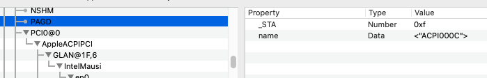

The DSDT for my HP EliteDesk 800 G4 Mini includes Device (PAGD) that is enabled on condition _OSI("Processor Aggregator Device").  I've searched for ACPI documentation on "Processor Aggregator Device" and found this reference.  Device (PAGD) does not appear in the IORegistry dump from a real MacMini8,1, so I'm fairly certain that Device (PAGD) is not relevant/applicable to macOS.
Just for fun, I added "Processor Aggregator Device" to my SSDT-XOSI (attached) and have confirmed (with IORegistryExplorer) that Device (PAGD) is loaded.
IORegistry Explorer Screenshot: SSDT-XOSI includes "Processor Aggregator Device"
Spoiler
IORegistry Explorer Screenshot: SSDT-XOSI does not include "Processor Aggregator Device"
Spoiler
It doesn't appear that macOS does anything with this device.
If anyone knows more about this, I would welcome your explanation.

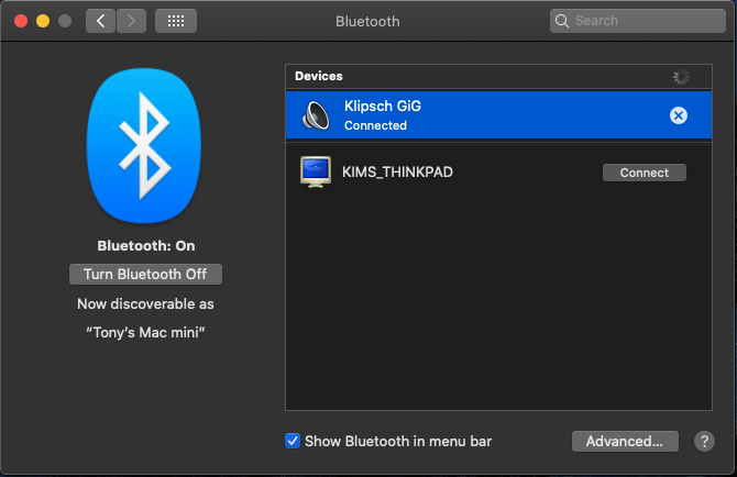

I am offering NO support for Intel Wi-Fi / Bluetooth and am only posting this for others who may want to experiment on their own. Please don't clutter this thread with Intel Wi-Fi /Bluetooth support questions. However, if after testing, you have concrete/tested suggestions that improve Intel Wi-Fi / Bluetooth performance, your posts are welcome.
Initial tests of Intel Wi-Fi/Bluetooth look promising after being alerted to this solution here. If you want to test with the Intel Wi-Fi/Bluetooth card that is factory-installed in your HP EliteDesk 800 G4 Mini, do the following:
  1. Enable Wi-Fi / Bluetooth device in BIOS
    1. Enable System Options -> M.2 WLAN / BT
    2. Enable Built-in Device Options -> M.2 USB / Bluetooth
  2. Add USB port HS14 to SSDT-UIAC.aml (used in conjunction with Rehabman's USBInjectAll.kext). An updated SSDT-UIAC.aml is attached. Replace SSDT-UIAC.aml in EFI/CLOVER/ACPI/patched with this updated version.
  3. Install kexts from the links at this post as follows:
    1. If you are injecting 3rd-party kexts with CLOVER (FakeSMC.kext or VirtualSMC.kext is NOT in /Library/Extensions), add IntelBluetoothFirmware.kext, IntelBluetoothInjector.kext and itlwm.ikext to /EFI/CLOVER/kexts/Other (do NOT add itlwmx.kext).
    2. If you have installed FakeSMC.kext or VirtualSMC.kext in /Library/Extensions with CLOVER's "Inject Kexts" = DETECT, you must remove all 3rd-party kexts from /EFI/CLOVER/kexts/Other, set CLOVER "Inject Kexts" = YES (not DETECT) and copy the following kexts to /EFI/CLOVER/kexts/Other: IntelBluetoothFirmware.kext, IntelBluetoothInjector.kext and itlwm.ikext (do NOT add itlwmx.kext)
  4. Reboot and configure Bluetooth and Wi-Fi
Since I am running with 3rd-party kexts in /Library/Extensions, my kext configuration is as follows
  • CLOVER "Inject Kexts" = YES
  • Kexts in /EFI/CLOVER/kexts/Other: IntelBluetoothFirmware.kext, IntelBluetoothInjector.kext, itlwm.ikext
  • Kexts in /Library/Extensions: AppleALC.kext, EFICheckDisabler.kext, FakeSMC_CPUSensors.kext, FakeSMC.kext, IntelMausi.kext, Lilu.kext, NVMeFix.kext, USBInjectAll.kext, WhateverGreen.kext
I have not thoroughly tested, but Intel Bluetooth/Wi-Fi looks promising. Below are some screenshots. Bluetooth connected easily to my Bluetooth speaker. Wi-Fi appears as another Ethernet device.
Screenshots
Spoiler
SSDT-UIAC.zip
Edited by tonyx86

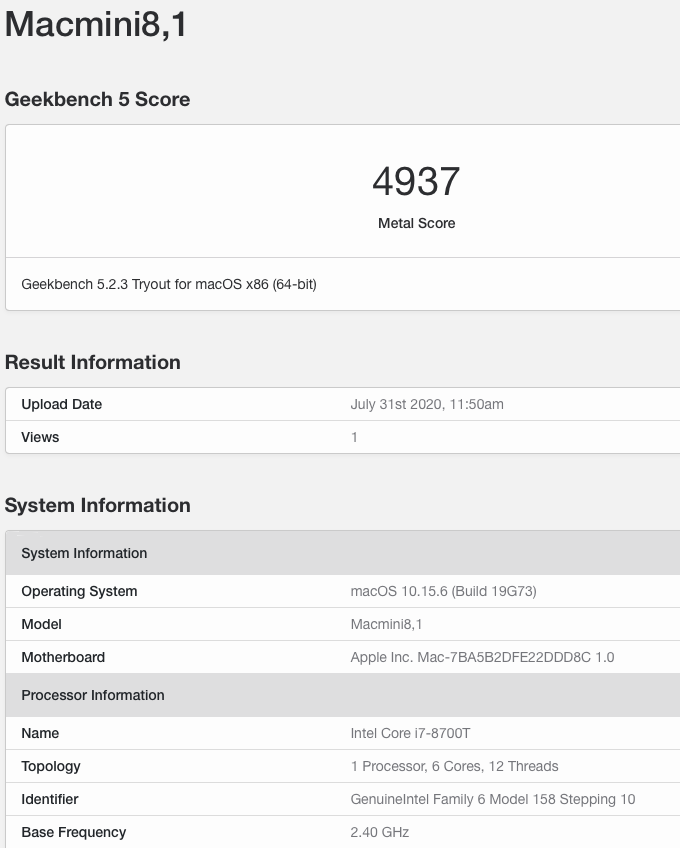

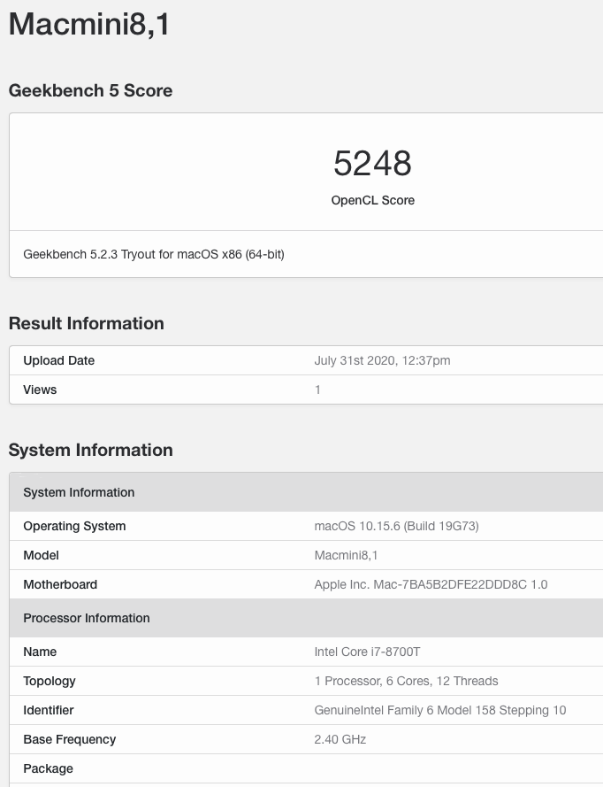

I hadn't run GeekBench 5 for a while. Attached are my latest GeekBench 5 graphics scores (OpenCL and Metal). These are consistent with what I first posted in Post #1 of this thread.
EDIT: These benchmarks were collected with the additional IGPU graphics attributes discussed in the next post.
Spoiler
1263295108_ScreenShot2020-07-31at12_33_50PM.thumb.png.9361fa5327529dde507b1f215c96556e.png
1215997181_ScreenShot2020-07-31at12_37_58PM.thumb.png.9d72c14ad29943cb3986b59ec54e3db4.png
Edited by tonyx86

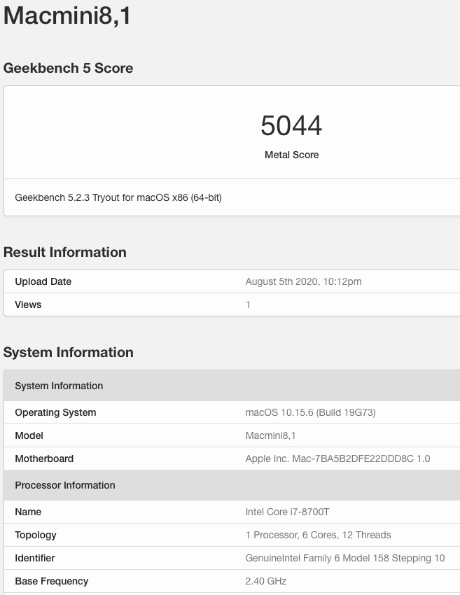

I initially thought that the WhateverGreen / Lilu update here made no difference. I stand corrected. My Metal and OpenCL GeekBench5 scores are better. See new scores attached to this post, see previous scores attached here and see comparison below.
GeekBench5 Test
WEG 1.40 / Lilu 1.4.5
WEG 1.4.1 / Lilu 1.4.6
Metal
4937
5044
OpenCL
5248
5303
GeekBench5 Graphics Scores with WEG 1.4.1 / Lilu 1.4.6
Spoiler
Edited by tonyx86
Fixed broken links

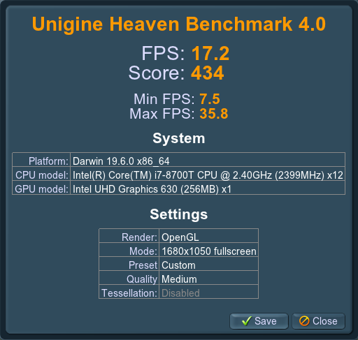

I hadn't run the Unigine Heaven Benchmark for a while. The latest test with results attached shows an improvement in the Max FPS over the results I attached to Post #1. Since I hadn't run this since my first successful installation of Catalina on this rig, I don't know whether the recent WEG upgrade deserves credit for this FPS performance improvement (the latest test having a Max FPS of 35.8 vs. the originally tested Max FPS of 29.9).
While not anywhere near the performance of my Sapphire Pulse RX580, this UHD 630 graphics engine on a 35W integrated CPU/GPU is very respectable.
Engine Heaven Benchmark Results
Spoiler
Edited by tonyx86
Fixed broken link

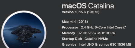

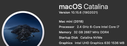

The upgrade to 10.15.6 19G2021 was easy with the steps below. During the upgrade, don't be surprised if displays flash on and off. Also, pay attention to the selected volume when the system reboots during the upgrade.
  1. Backup! Use Carbon Copy or your favorite backup utility.
  2. If you have installed your 3rd-party kexts in EFI/CLOVER/kexts/Other and not in /Library/Extensions, proceed to Step 3.
    If you have installed your 3rd-party kexts in /Library/Extensions as I have done, create a USB boot disk, install Clover r5119 on the USB drive and install your EFI on the USB drive. Copy all 3rd-party kexts to EFI/CLOVER/kexts/Other on the USB drive. Leave your USB drive inserted so that your system reboots from the USB drive. All 3rd-party kexts must be located in EFI/CLOVER/kexts/Other for the macOS upgrade.
  3. Select About This Mac -> Software Update and start the update. Your system will begin the update.
  4. After your system reboots the first time, select the "Install macOS from Catalina Data" Volume
  5. After your system reboots the second time, select the "Install macOS from Catalina Data" Volume
  6. After your system reboots the third time, boot from your Catalina Volume (now updated). If you created a USB boot drive, you may now remove it.
  7. Welcome to Catalina 10.15.6 19G2021!
Screenshot: About this Mac
Spoiler

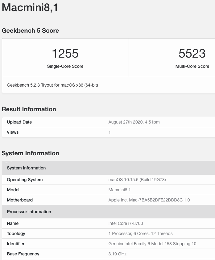

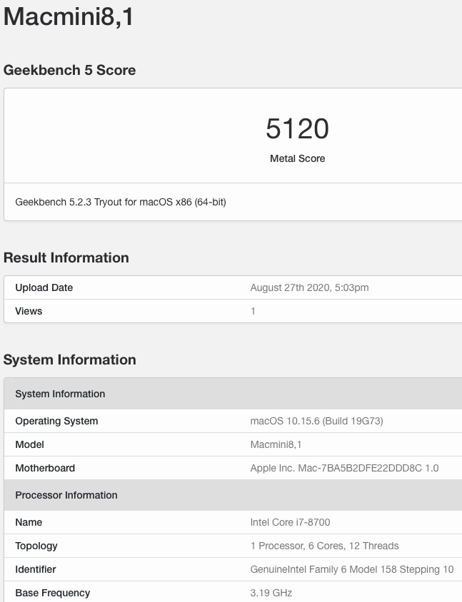

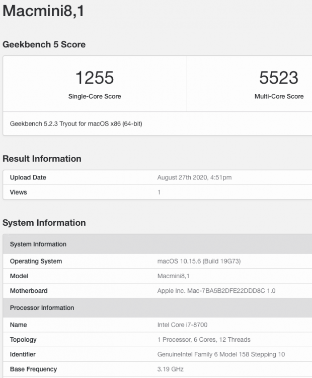

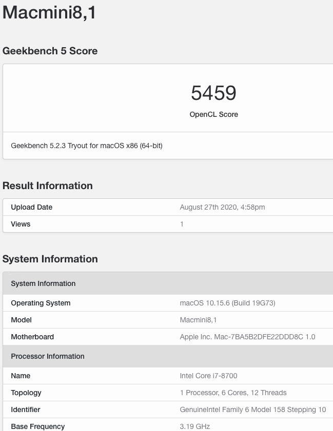

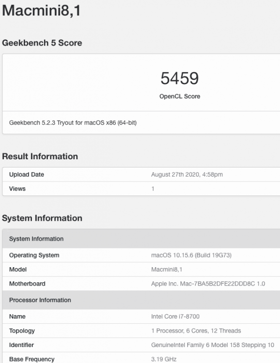

I purchased another gently used HP EliteDesk 800 G4 Mini with i7-8700 65W CPU (vs. the original i7-8700T 35W CPU originally documented in this thread).  Purchase price was $419 USD and included 512GB M.2 SSD and one 16GB DDR4 RAM module (leaving room for an additional M.2 SSD, a SATA6 SSD/HD and another 16GB DDR4 RAM module).  These G4 Mini's are fantastic.
GeekBench5 benchmarks for the "new" G4 Mini are summarized below with screenshots attached.
GeekBench5 Test i7-8700T (35W) i7-8700 (65W)
Metal 5044 5120
OpenCL 5303 5459
CPU 1098 / 5015 1255 / 5523
Screenshots: GeekBench5 Benchmarks
Spoiler
671135299_ScreenShot2020-08-27at4_51_47PM.thumb.png.64bc0a2e9a58dfa06222692d1e8a432c.png
106526324_ScreenShot2020-08-27at4_59_31PM.thumb.png.b34d50e32d34666cbe6800213bcb9548.png
1222289284_ScreenShot2020-08-27at5_04_00PM.thumb.png.ef2f6bb5aa992ceec2ae947dc72f8b48.png
