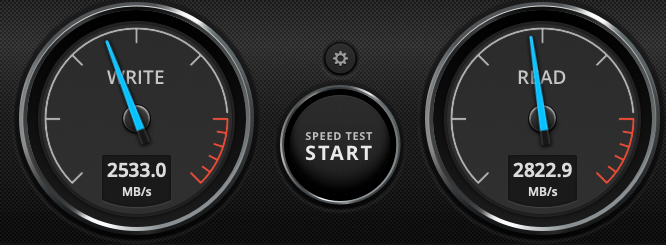

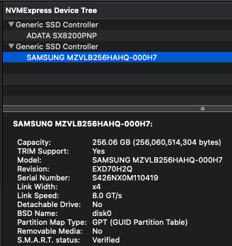

EDIT: The slow NVMe SSD performance was due to the ADATA M.2 NVMe SSD. I swapped it for a WD M.2 NVMe SSD as described here. Leaving this post for historical purposes.
In This Post I noted that my system boots Catalina 10.15.5 slower from my NVMe SSD than it does from my SATA6 SSD. I found threads that discuss NVMe SSD Controllers detected as "Generic SSD Controller" instead of "Apple SSD Controller."
As shown in the attached screenshot, both of my NVMeExpress SSD Controllers are detected as Generic. Both NVMe SSD Controllers are reported as "Link Width: x4" and "Link Speed: 8.0 GT/s" with Trim Support.
Could it be that the performance issue is simply because they are detected as Generic SSD Controllers and not Apple SSD Controllers?
Spoiler
Edited by tonyx86
Fixed broken links
Big lesson learned...
After experiencing poor NVMe SSD performance, I swapped my ADATA SSD for a WD Black SSD. R/W speeds are awesome (and symmetric) as shown in the attached screenshot. However, the big lesson learned was about the displays. When I cloned my backup to the new NVMe drive (using Carbon Copy), my displays did not work properly after booting from the new NVMe SSD. The only change was the NVMe SSD - no other changes and EFI was identical. My system would start to boot and login normally, but then one display would go black and I'd be left with a single display.
I made a VERY lucky guess and rebuilt kextcache using Hackintool - problem fixed. Displays are back to normal.
Lesson learned: if you're having display problems after cloning a new drive image, rebuild kextcache with Hackintool, manually or your favorite way.

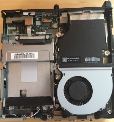

*** WARNING *** If you perform this drive caddy modification, make sure that you thoroughly clean the modified drive caddy so that you don't introduce metal fragments into your PC. ***
*** SUGGESTION *** Operating with two M.2 storage devices and a SATA storage device will generate extra heat in your EliteDesk Mini. If your rig does not have a SATA caddy fan (which may be the case if you have a 35W Mini), you may want to add a SATA caddy fan to help dissipate the extra heat. ***
*** CAUTION *** If you make this modification to an EliteDesk Mini that does not have a vented cover (which may be the case if you have a 35W Mini), your internal device temps may be higher than is advisable.  In my opinion, this modification is best for models that have a vented cover. ***
*** SUGGESTION *** If you perform this drive caddy modification to install two NVMe SSDs and one SATA drive and your SATA drive caddy does not include a cooling fan (SATA caddy cooling fans are included with 65W EliteDesk 800 G4 / G5 Minis but may not be included with 35W units), I advise you to add a SATA caddy cooling fan to your rig since the three drives will be generating extra heat.  See the cooling fan in one of the photos below. ***

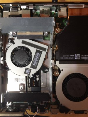

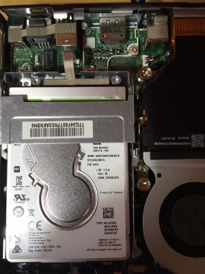

Installing 3 drives in your HP EliteDesk 800 G4 Mini (2 x M.2 2280 NVMe SSDs and 1 x SATA HD / SSD)
The HP EliteDesk 800 G4 Mini specs indicate that the G4 Mini supports two M.2 2280 NVMe SSDs and one SATA6 HD/SSD. Unfortunately, a mechanical design flaw prevents simultaneous use of the second M.2 2280 slot and the SATA drive caddy. As shown here, when the second M.2 2280 slot is populated, the SATA drive caddy sits on top of the M.2 2280 SSD card and the drive caddy cannot be properly installed. If you call HP support, they will admit that you can only install one or the other and not both.
Unmodified SATA Drive Caddy SATA Caddy sits on second M.2 2280 NVMe SSD
My solution was to modify the SATA drive caddy by making a cutout that provides clearance for the second M.2 2280 slot as shown here. A Dremel tool and cutting wheel works perfectly for this modification.
Modified SATA Drive Caddy
Spoiler
With this modified SATA drive caddy, the HP EliteDesk 800 G4 Mini easily accommodates two M.2 2280 NVMe SSDs and a SATA HD / SSD in the SATA drive caddy.
Spoiler
HD Fan Assembly in 65W HP EliteDesk 800 G4 Mini
Note that this caddy mod works perfectly with the HD fan in 65W units

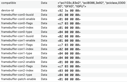

When not specified, device-id defaults to the macOS-detected device-id (which for my I7-8700T / UHD 630 is 0x3e92) - read here.    0x3e92 is the best device-id for me based on my testing, so no reason to "spoof" a different value.  I could also have defined device-id = 0x3e92 (Reverse Byte Order 0x923e0000), which still leaves the device-id unchanged from its default.  Read this post and this post for further explanation.
See attached IORegistry dump and note the value of device-id (without me having to specify a value).
Spoiler

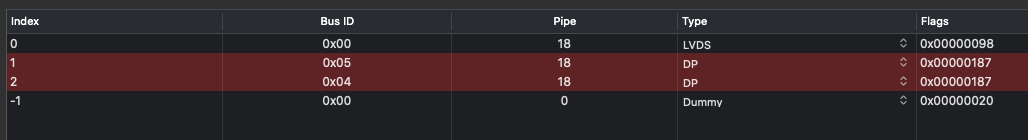

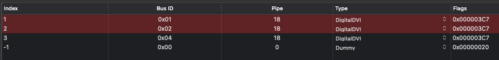

EDIT: Many thanks to @headkaze for his thorough explanation here.  I have learned enough about WEG to be dangerous, but won't attempt any more "manual" graphics framebuffer patching.  I'll be sticking with WEG and allowing it to do its magic :)
After posting this, I have encountered graphics issues following a few reboots.  Specifically, there are display glitches before the login prompt appears and sometimes, the system boots to black screens (with monitors on).  Clearly, there is something that WEG does that I have not captured in these patches.  I am reverting to my WEG baseline and welcome any suggestions for running without WEG.  It's not that I don't like WEG - I just want to fully understand what it is doing.
I suspect that WEG is defining additional UHD 630 graphics device attributes that I have not defined with my "manual' patches.
I was inspired by @Zenith432 's post here to determine a UHD630 graphics solution that does not require WhateverGreen.  My brute force approach duplicates the  WhateverGreen graphics properties that I injected (with Clover) as described here.
In addition to removing WhateverGreen.kext, I modified my Clover config.plist to work without WEG as follows
  • Remove all but the AAPL,ig-platform-id graphics device property (0000923E)
  • Enable the following DSDT device renames (WEG was renaming these)
    • change GFX0 to IGPU
    • change HDAS to HDEF
    • change HECI to IMEI
  • Add the following kext patches
Name
Find
Replace
Comment
com.apple.driver.AppleIntelCFLGraphicsFramebuffer
00000800
02000000
98000000
01010800
04000000
C7030000
10.15.5-CFL-3E920000-Con0-LVDS2DVI
01050900
00040000
87010000
02020900
04000000
C7030000
10.15.5-CFL-3E920000-Con1-DP2DVI
02040A00 00040000
87010000
03040A00
04000000 C7030000
10.15.5-CFL-3E920000-Con2-DP2DVI
The kext patches do the following
  • Add 1 (one) to each connector index (00 -> 01, 01 -> 02, 02 -> 03).  Without this index change, my system would boot to a single display that flashed on and off
  • Change all connector types to DigitalDVI (my system has DP connectors, but I am using DP->DVI adapters.  System booted to black screens without this connector type change and when I change connector types to DP.
  • Change all connector flags to 0x03C7.  Without the change in flag values, displays remained black after sleep/wake and I could not remotely connect after sleep/wake.
  • Change Bus IDs 0, 5, 4 to 1, 2, 4 respectively.  I determined this by trial and error.  There may be other Bus IDs that work, but my system booted to black screens if I did not change the Bus IDs.

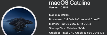

I'm posting this for those who are curious about VRAM and am not suggesting any changes. My configuration baseline is still running with 1536 MB VRAM which is the UHD 630 default and I don't see any performance benefits when running with 2048 MB VRAM.
The macOS supported UHD 630 VRAM sizes are 0x40000000 (1024 MB), 0x60000000 (1536 MB) and 0x80000000 (2048 MB). When graphics device property framebuffer-unifiedmem is unspecified, VRAM defaults to 1536 MB. When framebuffer-unifiedmem is set to 0x80000000 (Reverse Byte Order 0x00000080), VRAM is 2048 MB. I tried setting framebuffer-unifiedmem to 2048 MB, but don't notice any difference in graphics performance (as measured by GeekBench 5). The only difference I see is that macOS now sees 2048 MB VRAM.
*** NOTE *** This guide indicates that patching framebuffer-unifiedmem is not recommended.
Spoiler

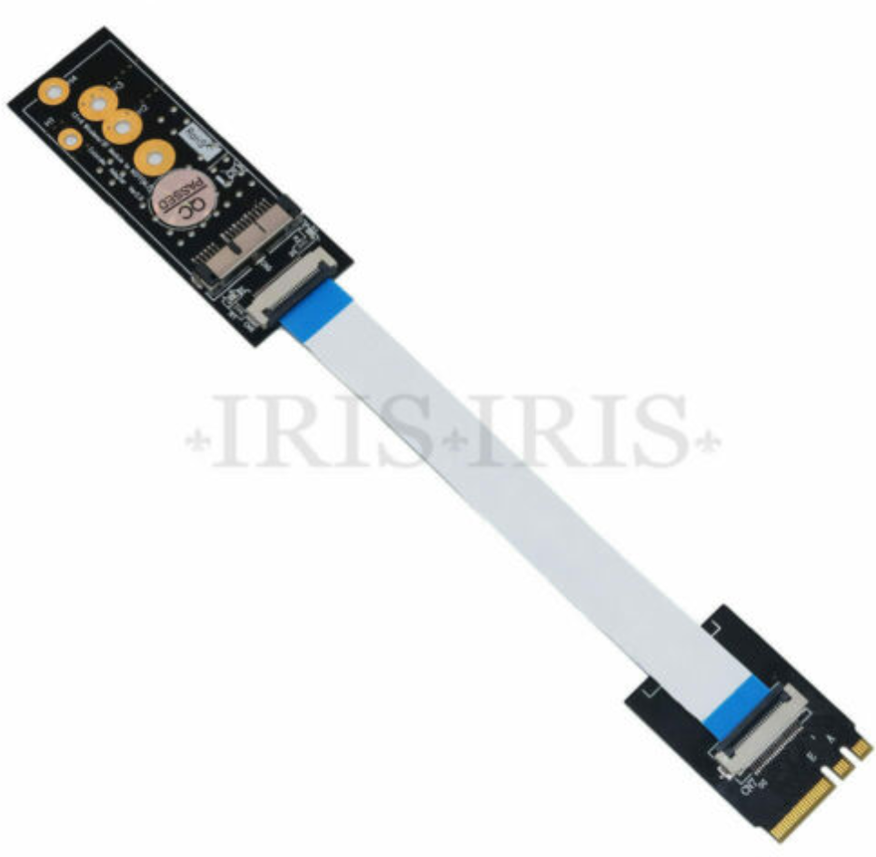

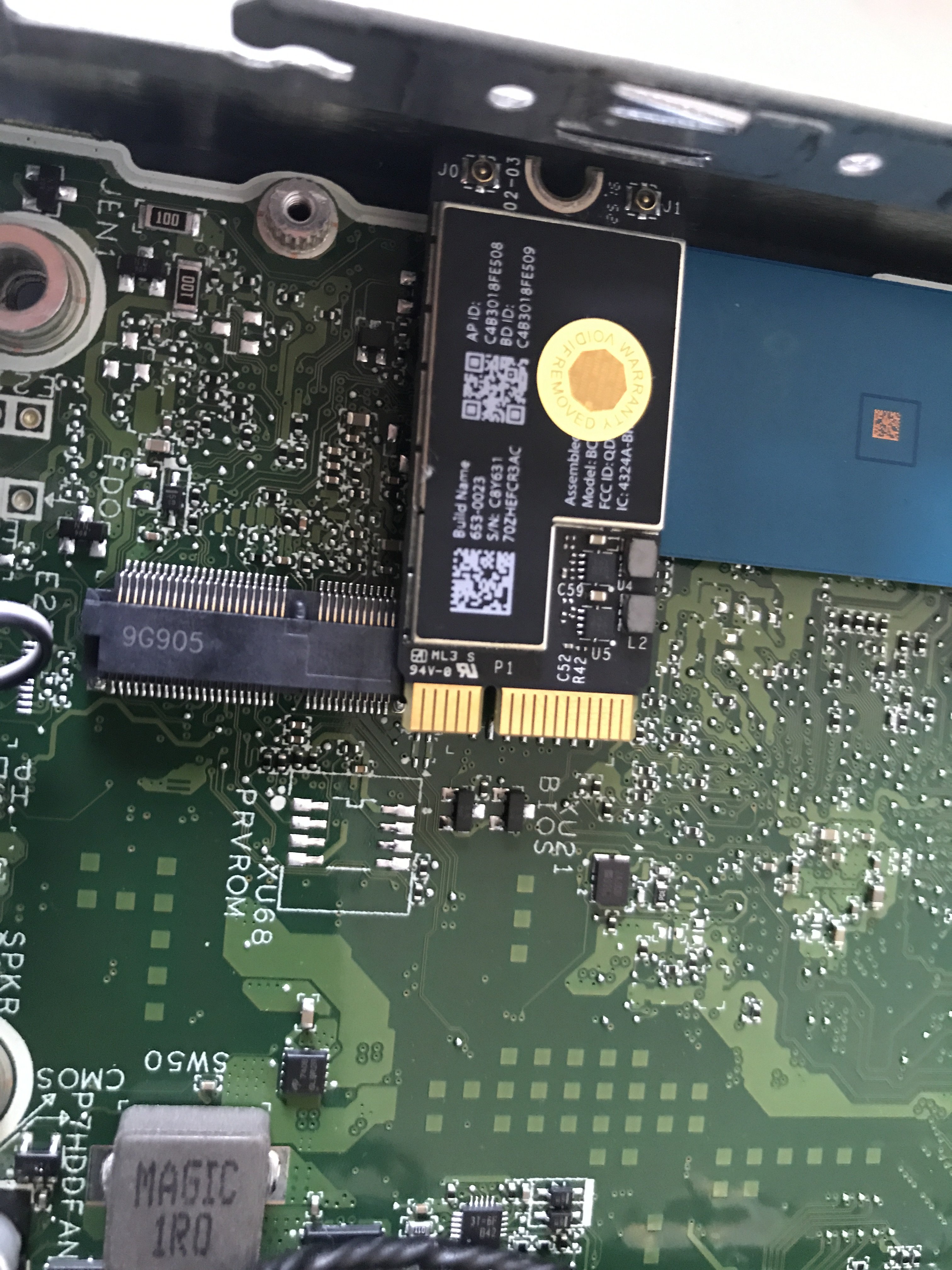

Great that works for you!  Another small problem is that the WIFI M.2 slot is positioned very close to the edge of the mother board (on my machine ) and as a consequence of that, the Adapter / BCM94360CS2 card length can not fit into the WIFI M2 slot. Any card length larger than 30mm will not fit.
Spoiler
There are some cards that thats support MacOS and will perfectly into the slot, though I prefer to use actual apple wifi cards and also find it cheaper.
My solution around this is to use an >> adapter with flex cable:
Spoiler
1256431207_Screenshot2020-07-08at08_19_21.thumb.png.4cbc68f4034e2f74e7c9516ba55fc68e.png
The HP EliteDesk 800 G4 Mini PC has two NVMe interfaces plus  SATA, so there is an extra options regarding adapter.
Have you (or anyone else) looked at the M.2 NGFF WLAN BCM94360NG 802.11ac Bluetooth 4.0 WiFi Card?  I don't need Wi-Fi/Bluetooth in my HackMini8,1 (not yet), so I haven't replaced the factory-installed Intel card.  I'm wondering if the BCM94360NG fits without modification in the Wi-Fi M.2 slot?
As far as know, it should work.
Hello,
First I would like to thanks tonyx86 for his hard and well documented works (yep, you can succeed but well documented for me it's a next level of knowledge sharing)
I have the EliteDesk 800 G4, but micro. I don't know why, I choose to boot from USB, then nothing happen, event with -v (normally I could see, even some small code line, now nothing), I tried different usb port, I tried USB2, USB3, nothing happen, I tried to switch between displayports, it doesn't work (in my boord I have 1 VGA and 2 DP), and it's the first time it happens to me. I doubt about the Bios settings, however, even with faulty bios settings, you will see something in the screen
I'm out of idea.
