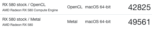

@Maf3r0 @IDON-NO What do you expect? Scores are up to the expected level in your cases. My kext only can improve scores if they are low. Example here:

@Labienus Not sure if it's necessary? How do the scores compare Windows vs. macOS?
https://forums.macrumors.com/threads/tired-of-low-geekbench-scores-use-radeonboost.2231366/post-28380276
https://forums.macrumors.com/threads/tired-of-low-geekbench-scores-use-radeonboost.2231366/page-2?post=28376589#post-28376589

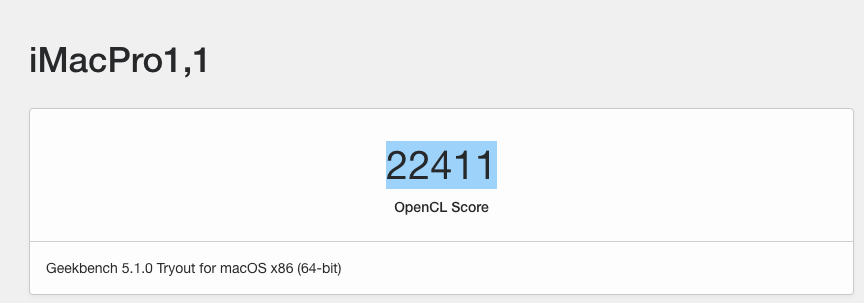

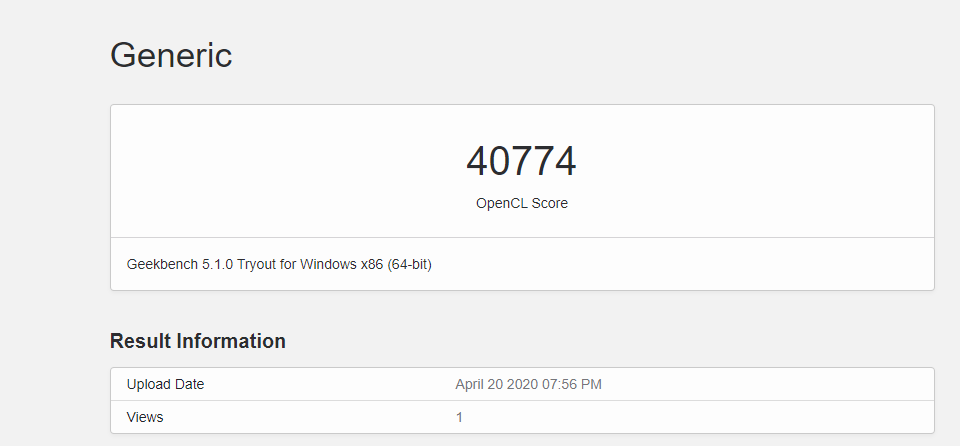

I have have certainly noticed a big difference, and there are a bunch of people on Reddit and AMD-OSX forums as well. I just did a benchmark in Windows and here is now they compare:
55004387_ScreenShot2020-04-20at3_53_46PM.png.f8950143924034f8001a161fdb5e2e94.pngwindowsbenchmark.png.33c6da5ba16e1a3f14da787b69c1b428.png
So if this issue affects the RX570 as well, which I think we might presume because we know of the issues with the 580, it does look like it could use the kext.
Thanks again! Let me know if I can do other benchmarking or anything else to help.
@IDON-NO What is it you don't understand? If you have no problem there is nothing to fix. So what do you expect?!
@Labienus I just checked, RX570 has the same device-id (67DF) as the Polaris cards already supported. So you can try RadeonBoost and check if it improves something.

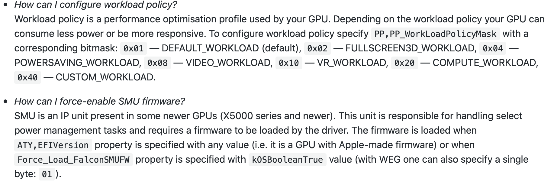

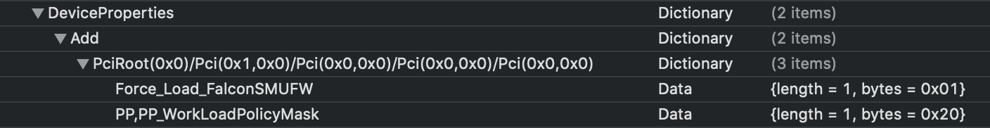

Hi, sorry if this is OT, i found a similar way from: https://github.com/acidanthera/WhateverGreen/blob/master/Manual/FAQ.Radeon.en.md. If you are using opencore with whatevergreen you can also inject gpu properties into config.plist, no need for kexts. It is working great and geekbench metal score skyrocketed from 39k to 66k+ on my rx 5700.
This results in a KP on the latest Cat betas (10.15.5). Looks like 10.15.5 might break all this stuff. The Navi chip is really just all over the place.
