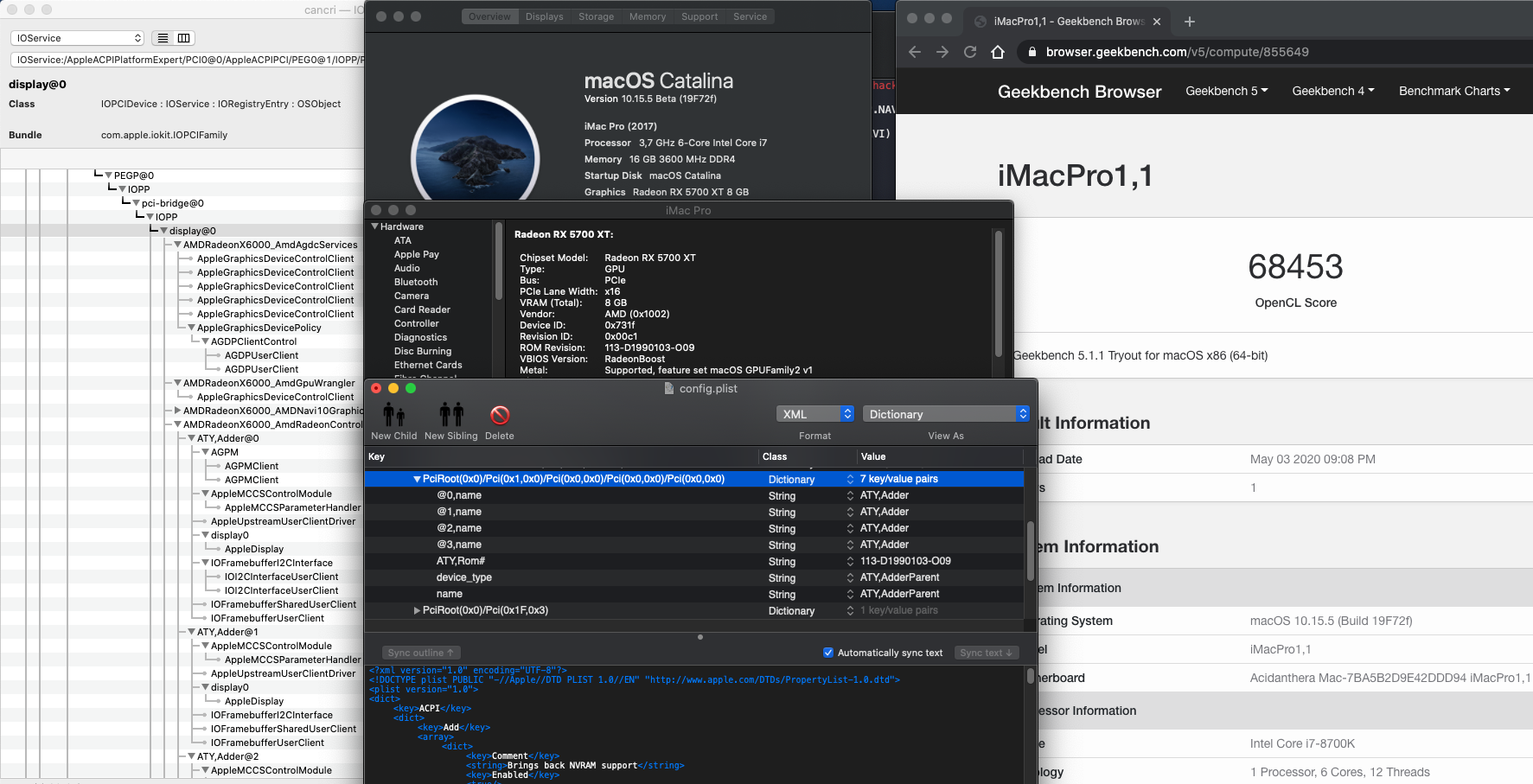

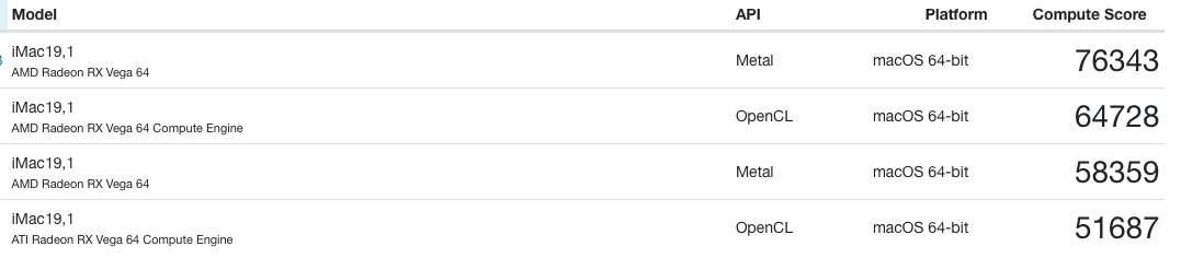

Hi Chris, Great job! Thanks.
RadeonBoost.kext v1.0 in kexts/Other using Clover r5112 and PowerPlayTable from config.plist gave a big boost in Geekbench 5:
340017729_Screenshot2020-04-23at15_29_52.thumb.png.711d27ef64dfdb9438cac0f1c3b74489.png
No problems with the Vega 64 giving excessive fan noise either.

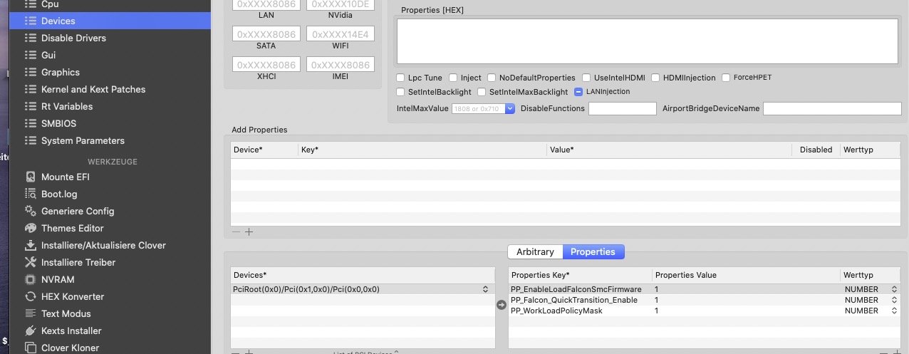

2. I can get (Thanks to Chris!) same higher, 30%, Geekbench  5 scores - and only there - if i inject 3 device properties by Clover (Screenshoot)
So i get same boost also without the kext. AGPM (is within newer kext versions) has no effect on my RX 460 card.

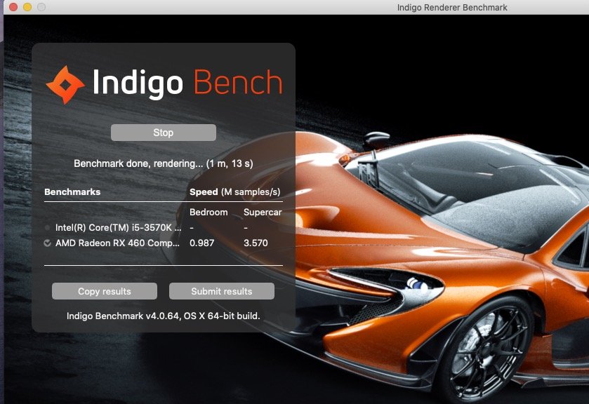

I used also Idigo Render Bench http://downloads.indigorenderer.com/dist/beta/IndigoBenchmark_v4.0.64.pkg, but also here no boost, same as without kext. HINT: Disable CPU as render device ;) Should bei gpu only like on sceenshoot.

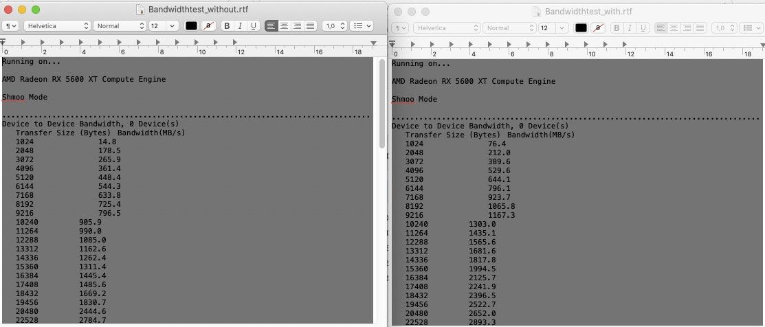

@Xanny: Can you try to measure the bandwidth speed with boost (kext) and without. Perhaps , if you measure higher value for the bandwidth iit may be the reason. For me its not - RX 460 has same bandwidth, doesnt matter using kext or not.
Small oclBandwidthTest is in my last post (2 post above this). Your bandwidth will be much hogher than my around 80000. I think at least 120000. But the interest is only in the difference (perhaps) with kext (or device properities inject) and without.
I did the tests, there is an effective improvement of the bandwidth. i repeated the tests few times results are comparable, attached here my two tests you can check. As i stated before i just inject Force_Load_FalconSMUFW directly with clover config.plist, but the kext do the same. The SSDT someone is working on, inject many totally useless things for my Graphic card, so i do not tested it.
Anyway you should try to check if there is a difference between two tests one on windows, one on mac os, if there is a difference and in which sector bandwith or whatever, then find the right parameter for your card if any.
Bandwidthtest_with.rtf
Bandwidthtest_without.rtf
Edited by Xanny
typos
Interesting results.
But it shows, that the maximum bandwidths are near the same for transfer sizes bytes more than around 20 KB. In your results the smaller transfersize speeds shows much , up to double , difference between with / without booster.
I cross tested that on my RX 460 (booster gain 30%!) with an closer look to the smaller transfer sizes, because like you my maximum BAndwidths are also same (less than 2% diff with/ without booster) , nears same as yours. Between runs the smaller transfersizes vary much more than the bigger transfersite bandwidths.
For my RX 460 frist run was onyl about 10 MB/S
Device to Device Bandwidth, 0 Device(s)
   Transfer Size (Bytes)    Bandwidth(MB/s)
   1024                9.2
   2048                146.2
Second  run and all other runs around 49 MB/S
   1024                50.4
   2048                160.4
So, if you also repeated the test are you sure also Bandwidths of the smaller transfersizes are between the runs same much lower with the booster?
If yes, that could explain why booster shows higher Geekbench Scores, they may use not much memory blocks by their around 8 small bench tasks.
yes results were comparable between tests.

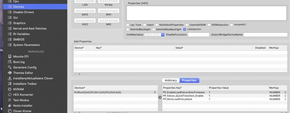

On 4/21/2020 at 12:21 PM, Paksman said:
Hi, sorry if this is OT, i found a similar way from: https://github.com/acidanthera/WhateverGreen/blob/master/Manual/FAQ.Radeon.en.md. If you are using opencore with whatevergreen you can also inject gpu properties into config.plist, no need for kexts. It is working great and geekbench metal score skyrocketed from 39k to 66k+ on my rx 5700.
In OC, you do not add the PP, in the properties but just the property.
In your screenshot you show PP,PP_WorkLoadPolicyMask but it should simply be entered as PP_WorkLoadPolicyMask
Otherwise you will end up with TWO entries in the registry (one with PP, and another without) which what I found.
The PP, (and CFG,) prefix is used when doing the patches via an SSDT.
