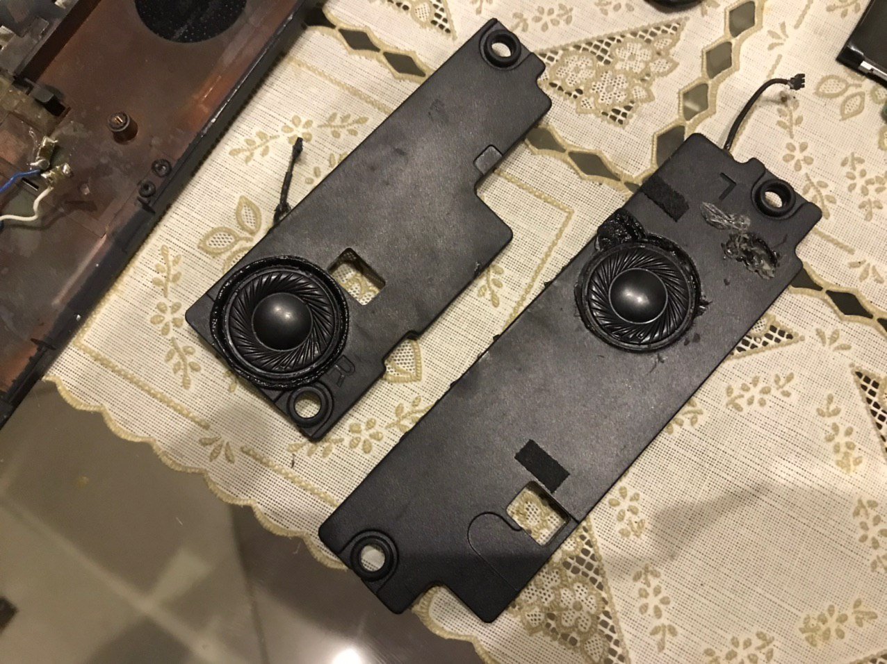

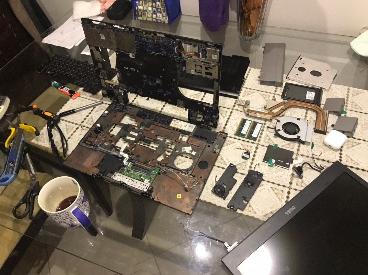

vbmota Posted June 2, 2020 Share Posted June 2, 2020 (edited) I finished the "forced replace" of the speakers in this machine. Provided from a died Macbook Air. Guide: https://pt.ifixit.com/Guide/Dell+Latitude+E6510+Speaker+Replacement/120046?lang=en Level dificult plus (it was not the original ones speakers) Success after hours of improvised thinking. Im so happy to hear it again without bluetooth speakers. This laptop its a war machine. hahaha Edited June 2, 2020 by vbmota 1 Link to comment https://www.insanelymac.com/forum/topic/341718-catalina-on-dell-latitude-e6410-nvidia-graphics-with-working-sleep/page/10/#findComment-2724702 Share on other sites More sharing options...

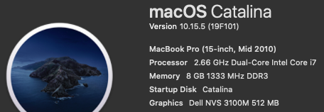

deeveedee Posted June 2, 2020 Author Share Posted June 2, 2020 (edited) I had a few minutes of free time, so I applied the Catalina 10.15.5.02 supplemental update. The install was easy and followed my 10.15.5 installation instructions with one change: Use DosDude Catalina Patcher 1.4.4. Edited June 2, 2020 by tonyx86 1 Link to comment https://www.insanelymac.com/forum/topic/341718-catalina-on-dell-latitude-e6410-nvidia-graphics-with-working-sleep/page/10/#findComment-2724736 Share on other sites More sharing options...

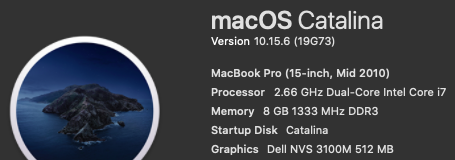

deeveedee Posted July 16, 2020 Author Share Posted July 16, 2020 (edited) For those who want to upgrade to Catalina 10.15.6, here are my upgrade steps (virtually identical to installation of 10.15.5): Backup your Catalina/Catalina-Data volumes Upgrade Clover on your SSD to r5119 (Legacy - NOT UEFI), following the Clover configuration in Post #1 If you haven't already, add the following Properties key to Clover config.plist: <key>NoDefaultProperties</key> <false>. This config.plist change is already included in the E6410-Catalina.zip archive attached to Post #1. Reboot and confirm that your existing version of Catalina boots with Clover r5119. If not, resolve the Clover boot issue before proceeding with your Catalina upgrade Before upgrading Catalina, if you haven't already, replace IntelMausiEthernet.kext in /L/E and E/C/k/O on your SSD with IntelMausi.kext 1.0.3 here. IntelMausi.kext is included in the E6410-Catalina.zip archive attached to Post #1. Reboot to confirm that your existing Catalina installation boots and works with IntelMausi.kext. If not, resolve issues before proceeding. Create a Catalina 10.15.6 installer USB using DosDude Catalina Patcher 1.4.4 Install Clover r5119 on the Catalina 10.15.6 installer USB thumb drive, following the Clover configuration in Post #1. Copy the EFI in E6410-Catalina.zip attached to Post #1 to your USB EFI and copy all kexts from the LE folder in E6410-Catalina.zip to E/C/k/O in the USB EFI. Be sure to replace XX-MASKED-XX values in config.plist with your own values. All of your 3rd-party kexts should be in E/C/k/O on the USB installer. Remove LegacyUSBInjector.kext and SIPManager.kext from the USB /Library/Extensions folder Modify the USB installer's CatalinaPatcherFlags.plist (use Xcode or your preferred plist editor) so that shouldAutoApplyPostInstallPatches and shouldUseAPFSBooter are both NO (default is YES) Boot your Latitude E6410 from the USB thumb drive (press F12 and select USB) At the Clover boot screen, select the Catalina Installer on the USB At the Catalina macOS Utilities screen, select "Reinstall macOS" If the installation aborts with a few minutes remaining (displaying error "An error occurred while preparing the installation") ignore this error Reboot from your USB thumb drive At the Clover boot screen, select the Catalina Installer on your destination drive's Catalina Data volume (NOT the installer on the USB). The installer will apply the 10.15.6 update. If the Catalina installer displays the error "The bless tool was unable to set the current boot disk" - ignore this error Reboot from your USB thumb drive At the Clover boot screen, select the Catalina Installer on the USB (NOT on the Catalina Data volume) At the Catalina macOS Utilities screen, select "macOS Post Install" and click Continue Make sure your upgraded Catalina volume is the destination volume (click Change if necessary) and select ONLY the following patches Install Patch Updater Legacy Video Card Patch Library Validation Disabler Patch Click Apply Patches (the Apply button may be grayed-out - click it anyway) Remove the USB thumb drive, reboot from your SSD and select your upgraded Catalina volume from the Clover boot screen Sign-in with your Apple ID If prompted to re-install any DosDude patches, re-install them but don't restart yet Confirm your macOS version is now 10.15.6 (About This Mac) Add boot-arg amfi_get_out_of_my_way=1 to your SSD's config.plist (if not added already) Remove the following kexts from /Library/Extensions (if they exist) LegacyUSBInjector.kext LegacyUSBVideoSupport.kext SIPDisabler.kext Rebuild kextcache (sudo kextcache -i /) and confirm that all 3rd-party kexts are "allowed" Reinstall VoodooHDA.pkg (customize install, selecting only Catalina Classic method) Delete '/System/Volumes/Data/macOS Install Data' (which is left because of the install error) Reboot from your upgraded Catalina Partition Welcome to Catalina 10.15.6 Screenshot Spoiler Edited August 15, 2020 by tonyx86 Link to comment https://www.insanelymac.com/forum/topic/341718-catalina-on-dell-latitude-e6410-nvidia-graphics-with-working-sleep/page/10/#findComment-2730549 Share on other sites More sharing options...
