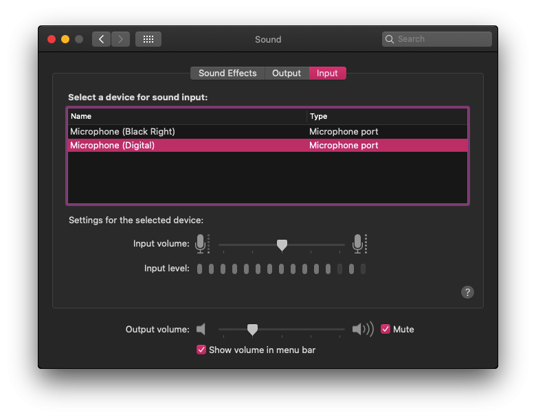

unilock Posted March 29, 2020 Share Posted March 29, 2020 (edited) @tonyx86 The internal microphone works for me with VoodooHDA after I switched "Input" to "Microphone (Digital)" in the Sound prefpane (see attached). Note that I have VoodooHDA installed via the "Legacy Clover" method (or whatever it was called), meaning that I have VoodooHDA.kext in /E/C/k/O, and no AppleHDADisabler.kext. We will need to add "amfi_get_out_of_my_way=0x1" to boot-args in order for the legacy video patch to work -- that, or we'll have to disable Library verification, as seen here. I've attached a relevant dialogue from the "macOS on Unsupported Macs" Discord server; if you're also a member of that server, you can access the attached messages directly through this link. Edited March 29, 2020 by unilock 1 Link to comment https://www.insanelymac.com/forum/topic/341718-catalina-on-dell-latitude-e6410-nvidia-graphics-with-working-sleep/page/6/#findComment-2714476 Share on other sites More sharing options...
deeveedee Posted March 29, 2020 Author Share Posted March 29, 2020 Thanks, @unilock. I did try "Microphone Digital," but that did not work for me during the Zoom conference. I'll look at it again. Link to comment https://www.insanelymac.com/forum/topic/341718-catalina-on-dell-latitude-e6410-nvidia-graphics-with-working-sleep/page/6/#findComment-2714505 Share on other sites More sharing options...

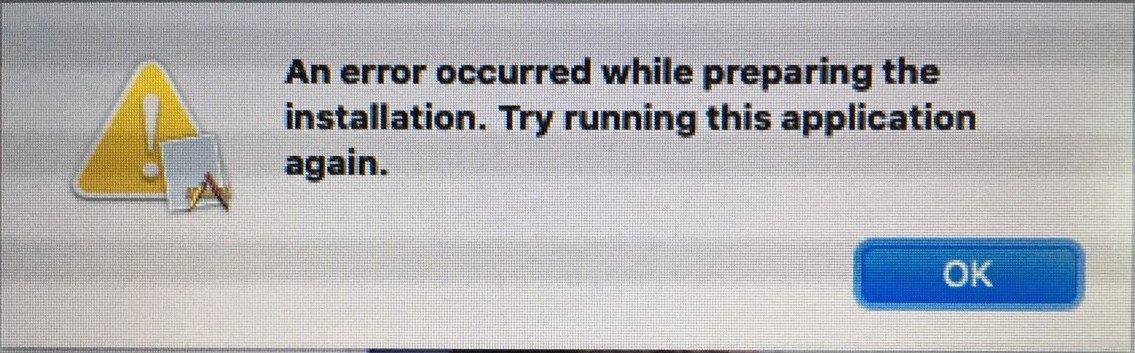

deeveedee Posted April 1, 2020 Author Share Posted April 1, 2020 (edited) EDIT: I just saw that there's a new DosDude Catalina Patcher v1.4. Will try again later with the new patcher. Leaving this for historical purposes. I have attempted to install 10.15.4 using DosDude Catalina Patcher 1.3.5, but have not been successful. The Catalina installer fails with the attached error. I have tried multiple USB thumb drives, played with multiple kext installation strategies, tinkered with Clover, but no luck. Any ideas? If not, will wait for 10.15.5 and try again. Edited April 1, 2020 by tonyx86 Link to comment https://www.insanelymac.com/forum/topic/341718-catalina-on-dell-latitude-e6410-nvidia-graphics-with-working-sleep/page/6/#findComment-2714899 Share on other sites More sharing options...

deeveedee Posted April 7, 2020 Author Share Posted April 7, 2020 I am not able to apply 10.15.4 to my Latitude E6410. I have attempted with different USB thumb drives, different USB ports, tweaks to CLOVER config.plist. Nothing works for me - I always get the error above. I have tried DosDude patcher versions after 1.30 including 1.4 and 1.4.1. Has anyone succeeded in applying 10.15.4 to their Latitude E6410? Link to comment https://www.insanelymac.com/forum/topic/341718-catalina-on-dell-latitude-e6410-nvidia-graphics-with-working-sleep/page/6/#findComment-2716029 Share on other sites More sharing options...

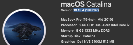

deeveedee Posted April 9, 2020 Author Share Posted April 9, 2020 (edited) EDIT: Despite the 10.15.4 installation errors, 10.15.4 is running well on this Latitude E6410. I no longer have reservations about installing 10.15.4. ------------------------------------------------------------------ For those who want to attempt the Catalina 10.15.4 upgrade from 10.15.3 (despite the installer errors), here are my upgrade steps: Backup your Catalina/Catalina-Data volumes Create Catalina 10.15.4 installer USB using DosDude Catalina Patcher 1.4.1 (or later) and Catalina 10.15.4.02 (or later). Note that 10.15.4.02 was released soon after 10.15.4.01. Install Clover r5109 (or later) on the USB thumb drive Copy the EFI attached to Post #1 to your USB EFI and copy all kexts from the LE folder attached to Post #1 to E/C/k/O in the USB EFI. Be sure to replace ### MASKED ### values in config.plist with your own values. All of your 3rd-party kexts should be in E/C/k/O on the USB installer. Remove LegacyUSBInject.kext and SIPManager.kext from the USB /Library/Extensions folder Modify the USB installer's CatalinaPatcherFlags.plist (use XCode) so that shouldAutoApplyPostInstallPatches and shouldUseAPFSBooter are both NO (default is YES) Boot your Latitude E6410 from the USB thumb drive (press F12 and select USB) At the Clover boot screen, select the Catalina Installer on the USB At the Catalina macOS Utilities screen, select "Reinstall macOS" Ignore the error "An error occurred while preparing the installation" and reboot from your USB thumbdrive At the Clover boot screen, select the Catalina Installer on your destination drive's Catalina Data volume (not the installer on the USB). The installer will apply the 10.15.4 update. Ignore the error "The bless tool was unable to set the current boot disk" and reboot from your USB At the Clover boot screen, select the Catalina Installer on the USB (not on the Catalina Data volume) At the Catalina macOS Utilities screen, select "macOS Post Install" and click Continue Make sure your upgraded Catalina volume is the destination volume (click Change if necessary) and select ONLY the following patches Install Patch Updater Legacy Video Card Patch Library Validation Disabler Patch Click Apply Patches Reboot from your USB (not yet from your SSD) and boot from your upgraded Catalina volume Sign-in with Apple ID (if you're prompted to enter your iPhone PIN and/or Setup iCloud keychain, skip this for now) If prompted to re-install any DosDude patches, re-install them but don't restart yet Confirm your macOS version is now 10.15.4 (About This Mac) Install Clover (LEGACY - not UEFI) r5109 (or later) on your SSD Add boot-arg amfi_get_out_of_my_way=1 to your SSD's config.plist Remove the following kexts from /Library/Extensions LegacyUSBInjector.kext LegacyUSBVideoSupport.kext SIPDisabler.kext (this shouldn't be installed unless you selected wrong DosDude patches) Rebuild kextcache (sudo kextcache -i /) and confirm that all 3rd-party kexts are "allowed" Reinstall VoodooHDA.pkg (customize install, selecting only Catalina Classic method) Delete '/System/Volumes/Data/macOS Install Data' (which is left because of the install error) Reboot from your upgraded Catalina Partition Welcome to Catalina 10.15.4 Edited May 23, 2020 by tonyx86 Added note about Clover LEGACY - not UEFI Link to comment https://www.insanelymac.com/forum/topic/341718-catalina-on-dell-latitude-e6410-nvidia-graphics-with-working-sleep/page/6/#findComment-2716461 Share on other sites More sharing options...

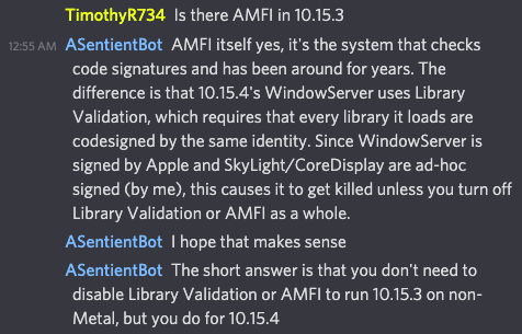

deeveedee Posted April 13, 2020 Author Share Posted April 13, 2020 (edited) EDIT: I have found that Microsoft Office 16.36 apps (e.g. Word) don't start without boot-arg 'amfi_get_out_of_my_way=1' I originally thought that this boot-arg could be removed after installation, but it appears that we must keep the boot-arg 'amfi_get_out_of_my_way=1' after installation of 10.15.4 on our old hacks. Edited April 14, 2020 by tonyx86 Link to comment https://www.insanelymac.com/forum/topic/341718-catalina-on-dell-latitude-e6410-nvidia-graphics-with-working-sleep/page/6/#findComment-2717252 Share on other sites More sharing options...

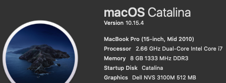

deeveedee Posted April 14, 2020 Author Share Posted April 14, 2020 (edited) I am currently running with Catalina 10.15.4 and Clover r5112. This Latitude E6410 is perfect. I am extremely impressed with @Slice's Clover team for the incredible work on Clover. If you look at github, you'll see that the Clover team has been spending many hours on refining the Clover bootloader. I am now running 10.15.4 and Clover r5112 on my HackPro5,1 and this HackBookPro6,2 and both boot fast and run great! Edited April 14, 2020 by tonyx86 Link to comment https://www.insanelymac.com/forum/topic/341718-catalina-on-dell-latitude-e6410-nvidia-graphics-with-working-sleep/page/6/#findComment-2717431 Share on other sites More sharing options...
deeveedee Posted April 17, 2020 Author Share Posted April 17, 2020 @unilock Digital Audio is working for me in Zoom. Not sure why it wasn't working for me before. Thanks for the tip! Link to comment https://www.insanelymac.com/forum/topic/341718-catalina-on-dell-latitude-e6410-nvidia-graphics-with-working-sleep/page/6/#findComment-2717927 Share on other sites More sharing options...
