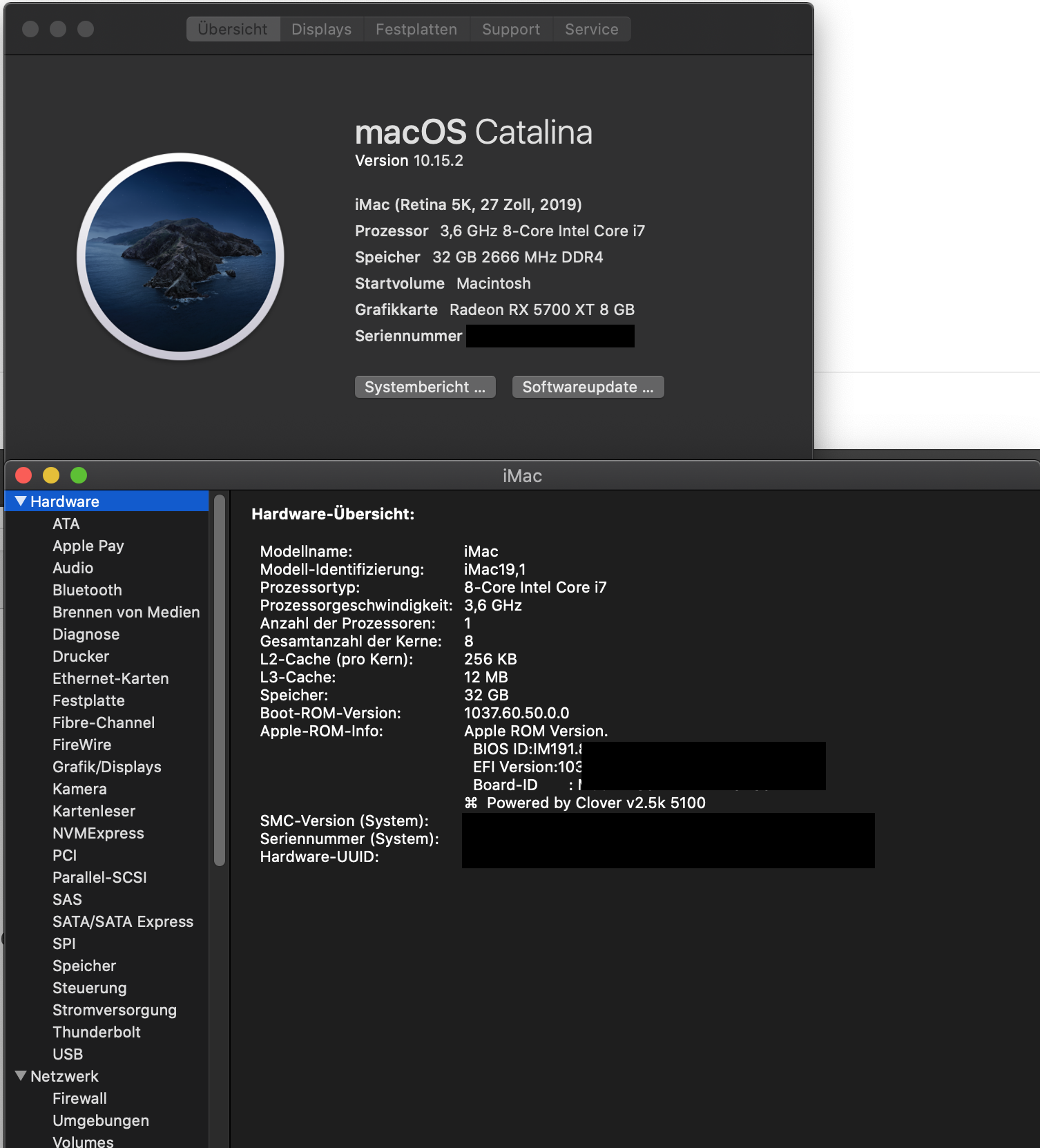

putzfraumann Posted December 31, 2019 Share Posted December 31, 2019 My man, my man, my man, this is the tutorial i needed and looked for. It simply works. My specs are: Case: NZXT H510 CPU: i7-9700K GPU: Gigabyte RX 5700 XT Gaming OC MB: Gigabyte Z390 Aorus Pro WIFI SSD: 2x Samsung MZ-76E1T0B/EU 860 EVO 1 TB. One for Win10Pro, One for HackOS CPU-Fan: Noctua DH-15 WIFI + Bluetooth-Card: Diyeeni Network Card 2.4 & 5G Dual-Frequenz 1750 Mbit/s High-Speed-Wireless-Netzwerkkarte, BCM943602CS + Bluetooth 4.1 (YES, Plug and Play works with this one) RAM: Crucial Ballistix Sport LT BLS2K16G4D26BFSC Desktop Gaming Kit (2666 MHz, DDR4, DRAM, 32GB (16GB x2), CL16) Power: Corsair RM650x 80 Plus Gold, 650 Watt, EU iMessage, FaceTime, Bluetooth, WIFI and Sound work perfectly. The only thing i had to check was Post-Installation EFI, the first time i picked wrong. But now... brilliant and smooth. Thank you brother for help. Merci. Gracias! 2 Link to comment https://www.insanelymac.com/forum/topic/340760-glasgoods-macos-catalina-install-guide-aorus-z390-pro-z390-master/page/2/#findComment-2702376 Share on other sites More sharing options...
AudioGod Posted December 31, 2019 Share Posted December 31, 2019 @putzfraumann That’s great to hear. Have a great new year and just Enjoy my friend. Link to comment https://www.insanelymac.com/forum/topic/340760-glasgoods-macos-catalina-install-guide-aorus-z390-pro-z390-master/page/2/#findComment-2702379 Share on other sites More sharing options...

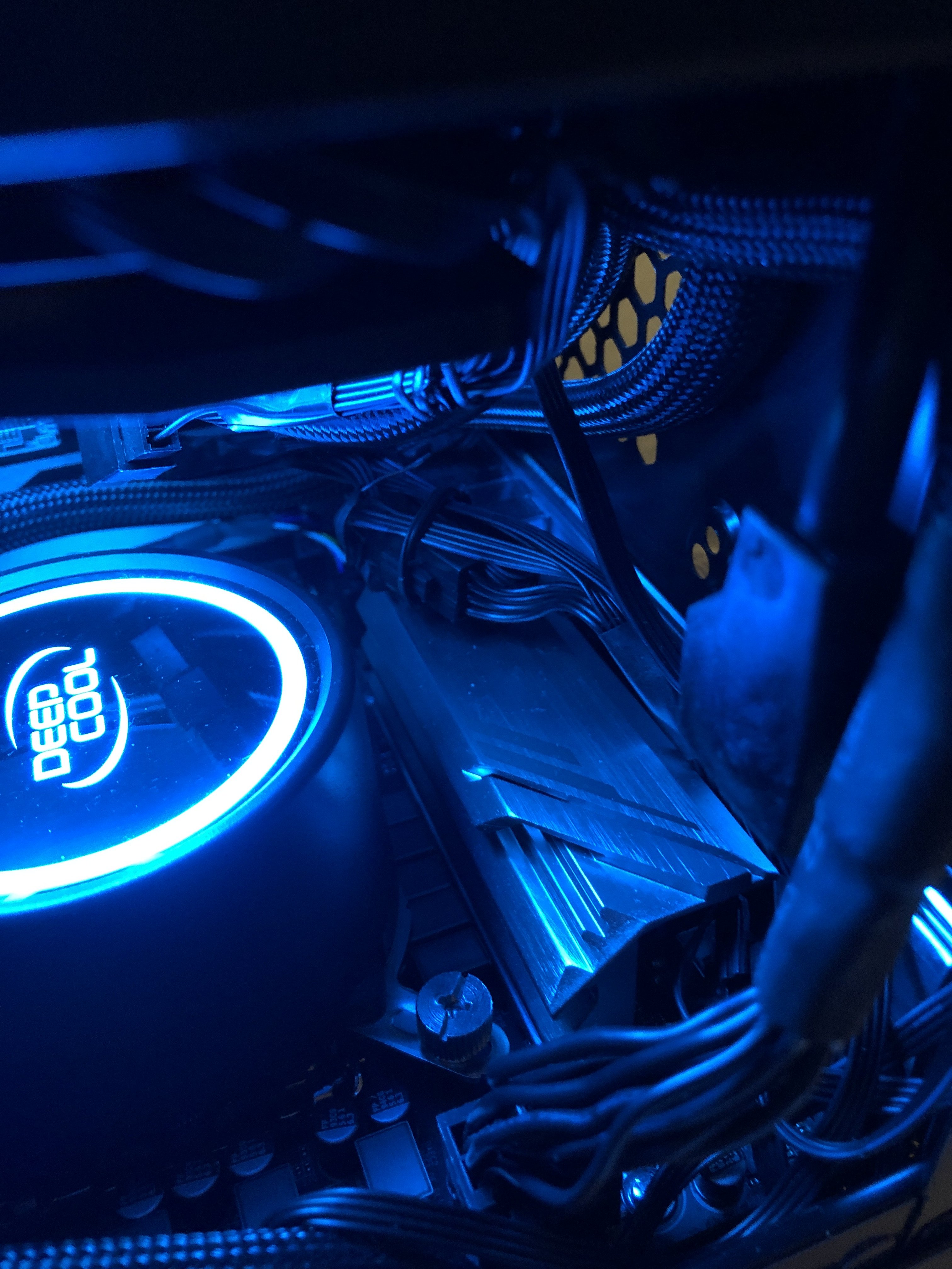

LVNona Posted January 10, 2020 Share Posted January 10, 2020 Hello and great work getting all stuff together, but I need some help. Me SLEEP is not working - dark screen - after a minute PC shuts down and at awake it crashes to restart and apple error about your device was improperly rebooted or something like that. Any idea where is an issue? I followed your BIOS settings and proper EFI, but I haven't unlocked CFG/MSR bios. Do I need to unlock and how does it helps anyway? Here is my settings: Gigabyte Z390 Aorus Master (BIOS F10) - i7 9700K - 32Go RAM 4100Mhz Team Catalina - PCI1-GTX780 - 970 EVO Plus NVMW 256Gb Win10 - PCI2-2080Ti Strix - 970 Evo Plus 1tb Custom water-cool loop PG348Q 34'' Display 1 Link to comment https://www.insanelymac.com/forum/topic/340760-glasgoods-macos-catalina-install-guide-aorus-z390-pro-z390-master/page/2/#findComment-2703664 Share on other sites More sharing options...
c1ru Posted January 10, 2020 Share Posted January 10, 2020 1 hour ago, LVNona said: Hello and great work getting all stuff together, but I need some help. Me SLEEP is not working - dark screen - after a minute PC shuts down and at awake it crashes to restart and apple error about your device was improperly rebooted or something like that. Any idea where is an issue? I followed your BIOS settings and proper EFI, but I haven't unlocked CFG/MSR bios. Do I need to unlock and how does it helps anyway? Here is my settings: Gigabyte Z390 Aorus Master (BIOS F10) - i7 9700K - 32Go RAM 4100Mhz Team Catalina - PCI1-GTX780 - 970 EVO Plus NVMW 256Gb Win10 - PCI2-2080Ti Strix - 970 Evo Plus 1tb Custom water-cool loop PG348Q 34'' Display I got same problem, but i cant find the option inside the clover config. I have another ml240 liquid fan. Link to comment https://www.insanelymac.com/forum/topic/340760-glasgoods-macos-catalina-install-guide-aorus-z390-pro-z390-master/page/2/#findComment-2703670 Share on other sites More sharing options...
LVNona Posted January 10, 2020 Share Posted January 10, 2020 2 minutes ago, c1ru said: I got same problem, but i cant find the option inside the clover config. I have another ml240 liquid fan. Which option you are looking and what option will help us? Link to comment https://www.insanelymac.com/forum/topic/340760-glasgoods-macos-catalina-install-guide-aorus-z390-pro-z390-master/page/2/#findComment-2703671 Share on other sites More sharing options...
AudioGod Posted January 10, 2020 Share Posted January 10, 2020 (edited) 2 hours ago, c1ru said: Thank you very much for the awesome guide! I was completed the installation in my Z390 I Aorus pro wifi but I have the problem of the sleep, when I put on sleep the computer fall and restart, if I try to shutdown restart again, and I can´t select XPRW change Method in clover, how can I search this option? @c1ru Download these files and replace the ones in the UEFI driver folder in clover with these and tell me if it fixes it for you pal. OcQuirks R12.zip Just in case question? Have you changed the USB config of my EFI by any chance? if you have then try again without adding any usb patching As the ssdt and dsdt are patched to give you full native USB with no port limits so no extra usb kexts or patching is needed. Edited January 10, 2020 by AudioGod 1 Link to comment https://www.insanelymac.com/forum/topic/340760-glasgoods-macos-catalina-install-guide-aorus-z390-pro-z390-master/page/2/#findComment-2703676 Share on other sites More sharing options...
c1ru Posted January 10, 2020 Share Posted January 10, 2020 (edited) 1 hour ago, AudioGod said: @c1ru Download these files and replace the ones in the UEFI driver folder in clover with these and tell me if it fixes it for you pal. OcQuirks R12.zip Just in case question? Have you changed the USB config of my EFI by any chance? if you have then try again without adding any usb patching As the ssdt and dsdt are patched to give you full native USB with no port limits so no extra usb kexts or patching is needed. Yes, i have modify my usbmap with hackintool. Should i replace back our efi again if do not work this? And wich is the latest folder of efi i have to use? latest in this page? Checking my bios is v7, and latest in Gyga is F8c https://www.gigabyte.com/latam/Motherboard/Z390-I-AORUS-PRO-WIFI-rev-10/support#support-dl-bios Should i use this efi really: https://www.insanelymac.com/applications/core/interface/file/attachment.php?id=340214 My grpahic is Radeon RX 580 and intel 9 9900 Edited January 10, 2020 by c1ru Link to comment https://www.insanelymac.com/forum/topic/340760-glasgoods-macos-catalina-install-guide-aorus-z390-pro-z390-master/page/2/#findComment-2703682 Share on other sites More sharing options...

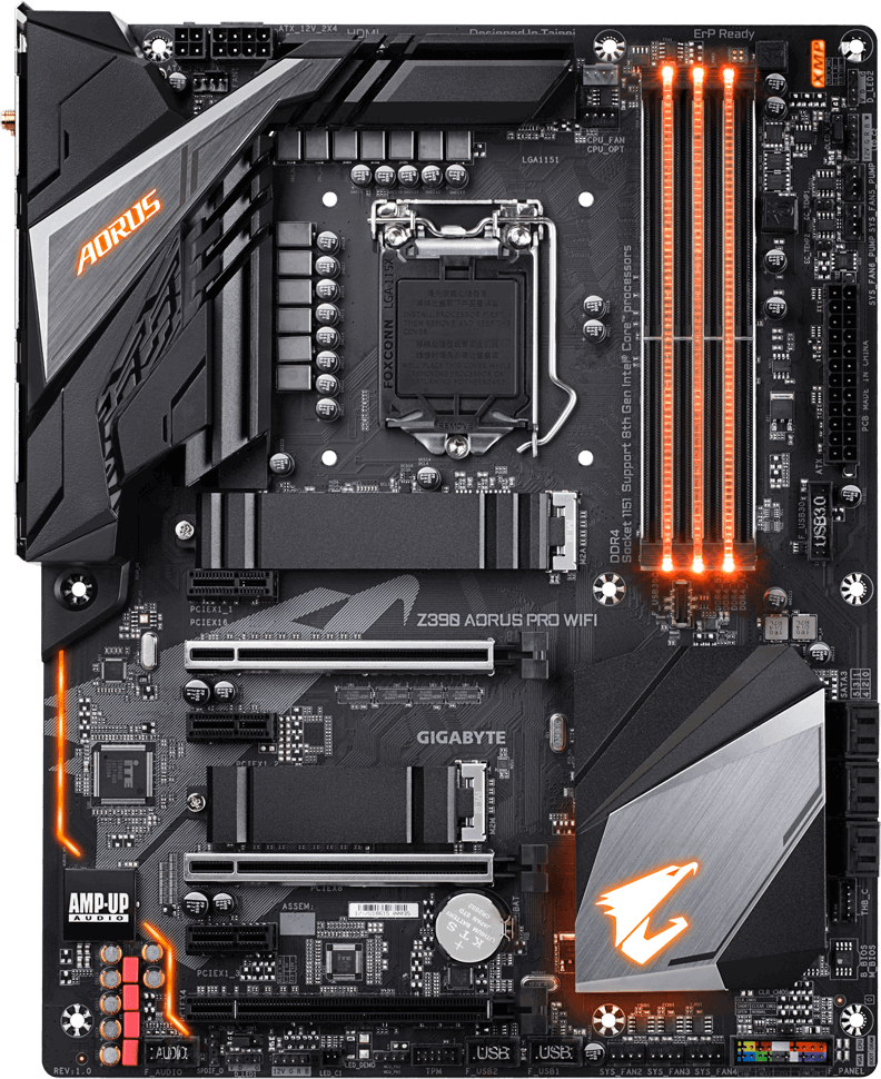

c1ru Posted January 11, 2020 Share Posted January 11, 2020 (edited) 5 minutes ago, AudioGod said: Sure it does, all motherboards do and the pro WiFi is no different. Your find it just below the second or third pcie slot. Omg I have found the battery but I need to un assembly all to remove the battery, I will try it tomorrow thanks for supper again! Right now I have boot for testing and is working fine Down the plate is the battery Y_Y I have put the computer to sleep and works!!!! Omg!! Thank you very much totally success with this mobo!! Also i can wake up with the keyboard connected by bluetooth belkin adapter, but after waykup i have to replug the adapter to get keyboard working, well is a bit rare, tomorrow i will work on that. Edited January 11, 2020 by c1ru Link to comment https://www.insanelymac.com/forum/topic/340760-glasgoods-macos-catalina-install-guide-aorus-z390-pro-z390-master/page/2/#findComment-2703692 Share on other sites More sharing options...
AudioGod Posted January 11, 2020 Share Posted January 11, 2020 @c1ru The battery is right under the second pcie slot. It’s the silver circle that looks like a coin. 1 Link to comment https://www.insanelymac.com/forum/topic/340760-glasgoods-macos-catalina-install-guide-aorus-z390-pro-z390-master/page/2/#findComment-2703693 Share on other sites More sharing options...

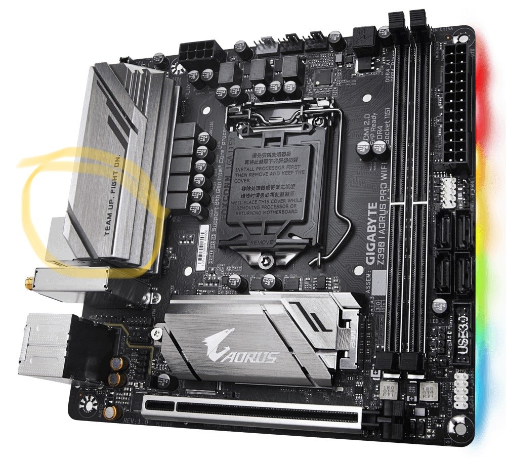

c1ru Posted January 11, 2020 Share Posted January 11, 2020 (edited) No, mine is Z390 I Aorus pro wifi mini itx and the battery is in vertical near the Ethernet and usb3 ports i know what is the battery thx look at picture is down the plate Edited January 11, 2020 by c1ru 1 Link to comment https://www.insanelymac.com/forum/topic/340760-glasgoods-macos-catalina-install-guide-aorus-z390-pro-z390-master/page/2/#findComment-2703694 Share on other sites More sharing options...
AudioGod Posted January 11, 2020 Share Posted January 11, 2020 (edited) 6 minutes ago, c1ru said: No, mine is Z390 I Aorus pro wifi mini itx and the battery is in vertical near the Ethernet and usb3 ports i know what is the battery thx Ahhh you have the mini, I didn’t realise sorry then yes your spot on in that case. if this EFI doesn’t work for you then the differences between the standard and mini must be greater then just the name and size making my dsdt and ssdt no good and it would also explain why your having issues like you are with glasgoods EFI’s. if that is the case then il point you to the man to make you a new DSDT for your little pro itx board. let’s see what happens with my EFI first of all and we shall go from there. I'm fascinated to know if it will work for you and your board. let me know how you get on tomorrow and report back on my main thread so we don’t spam up poor old glasgoods thread. LoL Edited January 11, 2020 by AudioGod 1 Link to comment https://www.insanelymac.com/forum/topic/340760-glasgoods-macos-catalina-install-guide-aorus-z390-pro-z390-master/page/2/#findComment-2703695 Share on other sites More sharing options...
