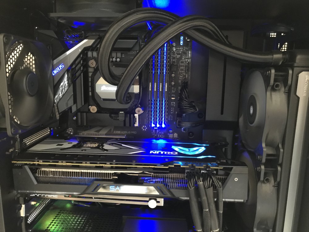

PART LIST
 Intel I7 8700
 Gigabyte Z390 AORUS PRO
 Sapphire Vega 64 Nitro+  8GB ( connected to monitor with DisplayPort )
 Corsair Vengeance LPX 32GB ( 4 x 8GB ) 2666MHz – CMK16GX4M2A2666C16
 Corsair RM650x 80 Plus Gold Power Supply Unit
 Corsair H100i V2 AIO Hydro/Water RGB LED CPU Cooler
 Samsung EVO 500GB SSD (2.5) macOS Catalina
 Samsung EVO 250 GB SSD (2.5) Windows 10 Pro
 NZXT H500 Mid Tower ATX Case

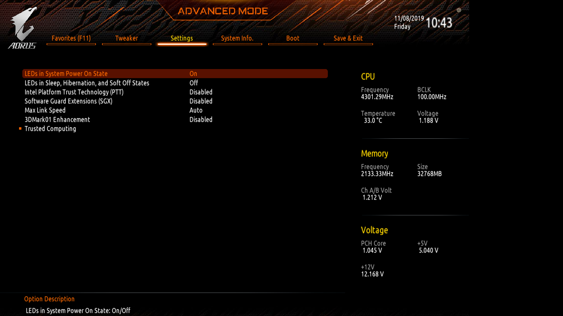

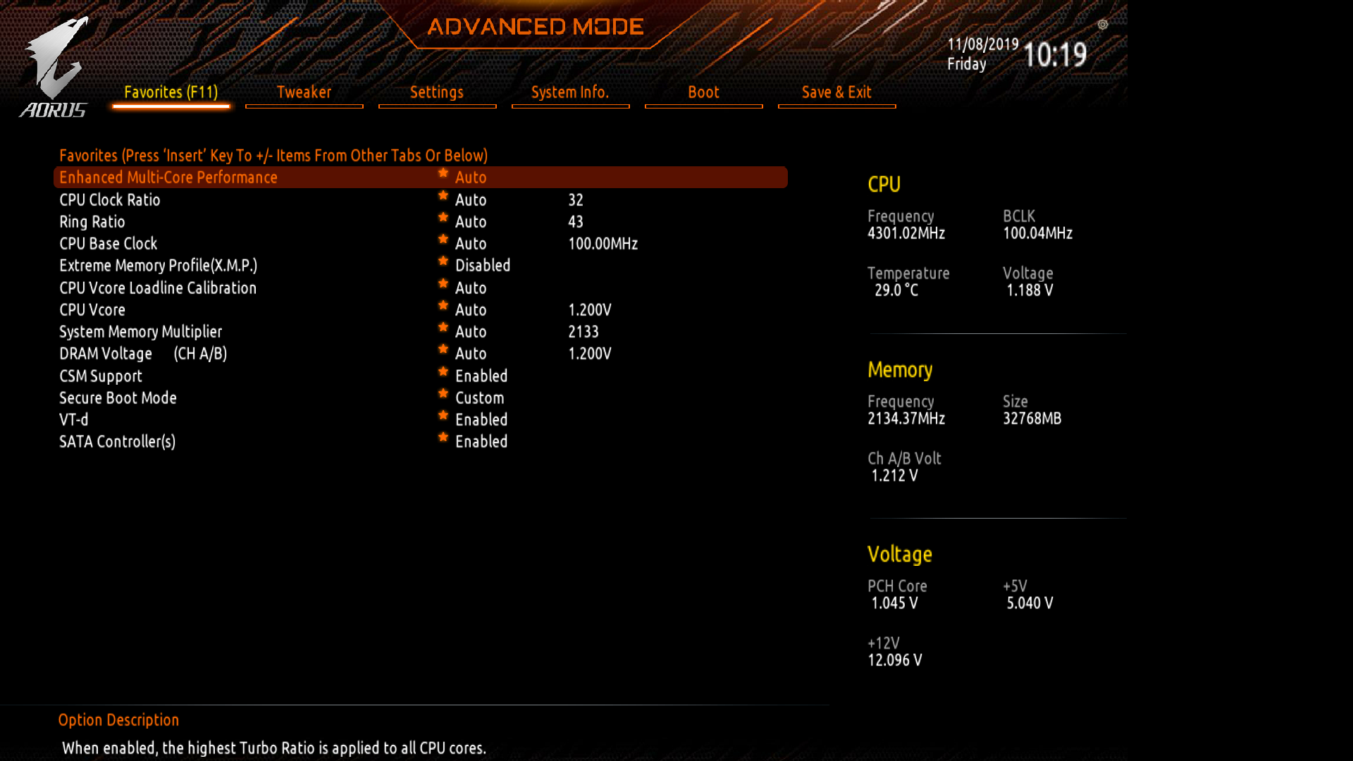

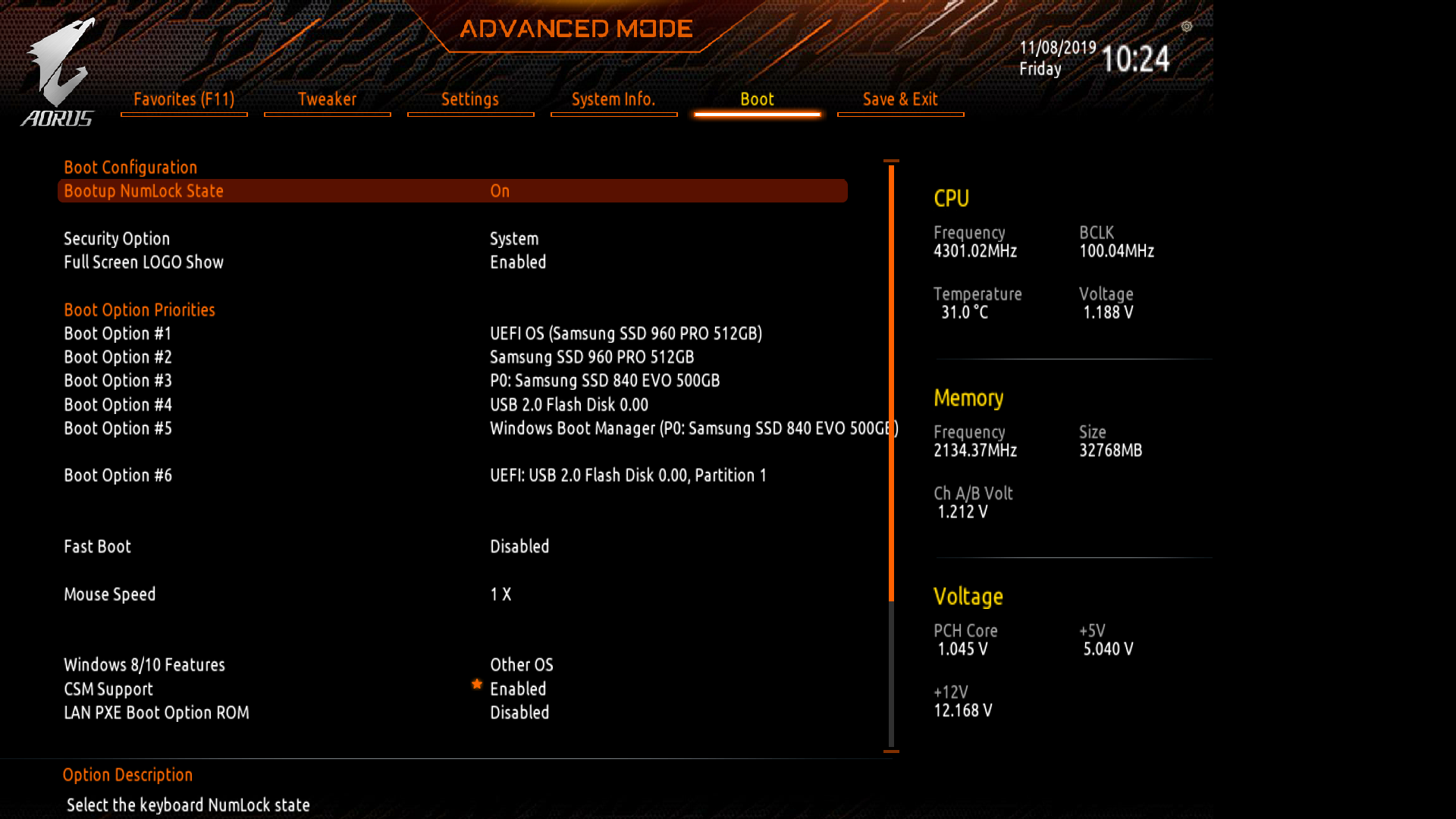

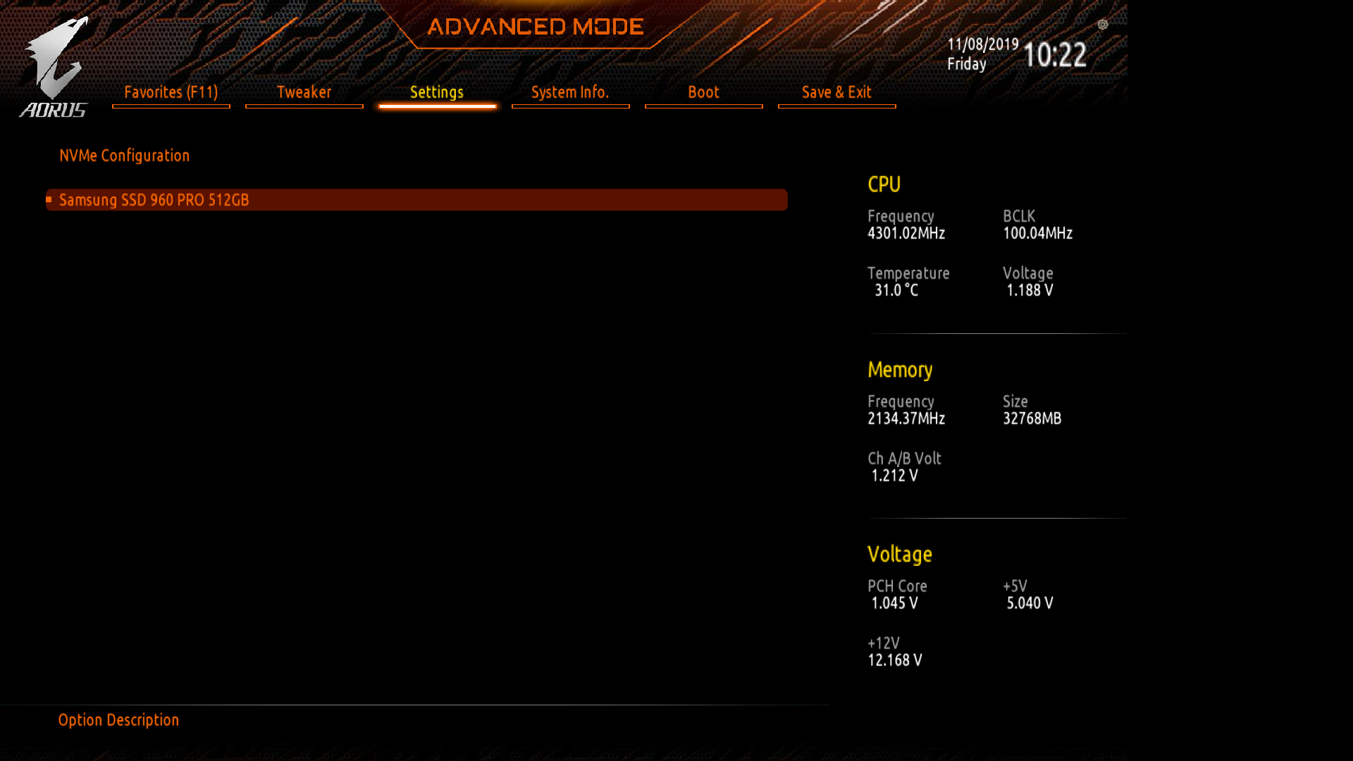

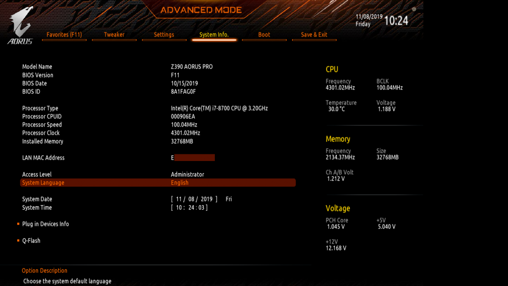

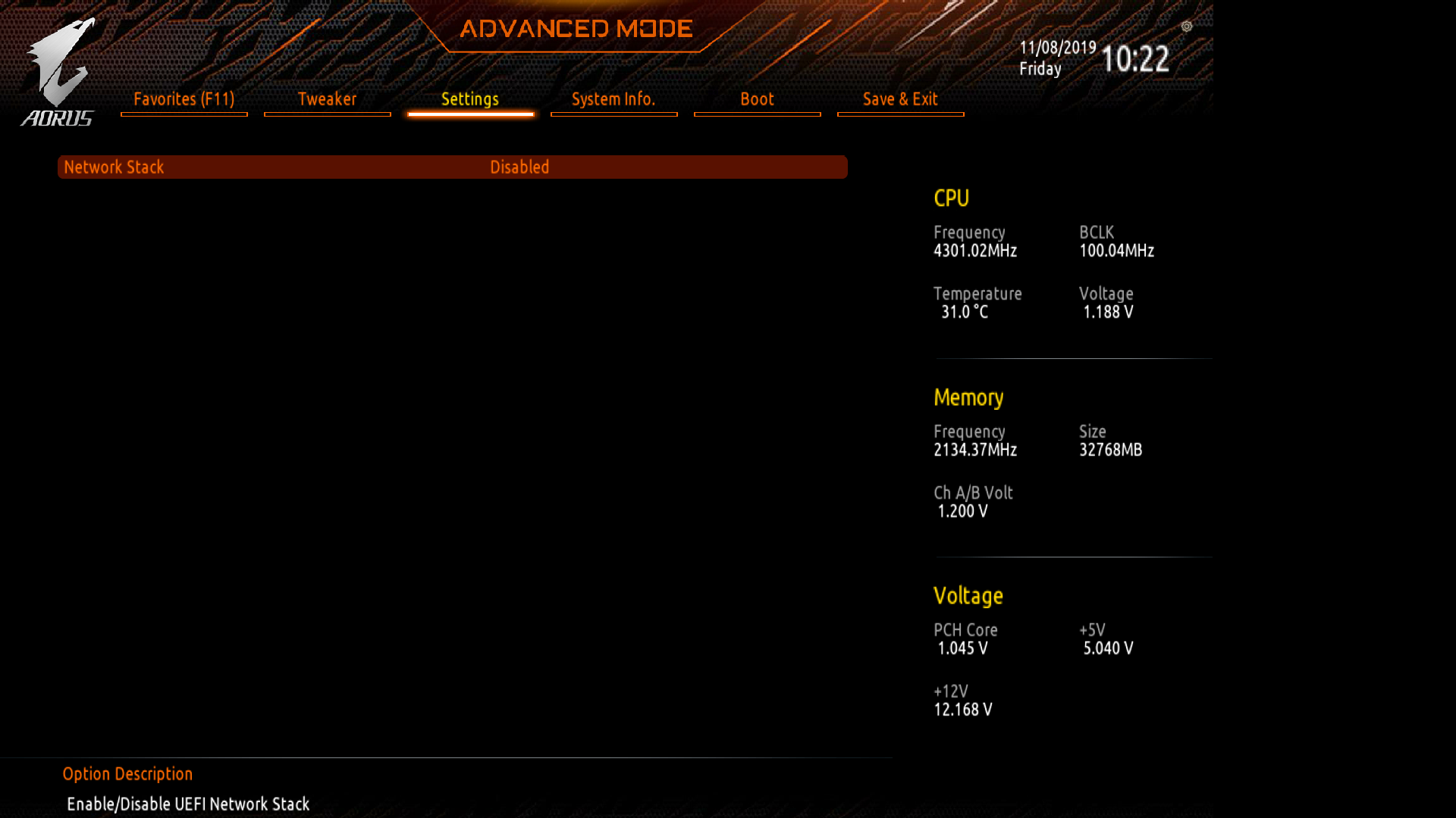

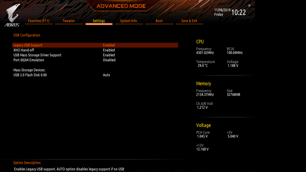

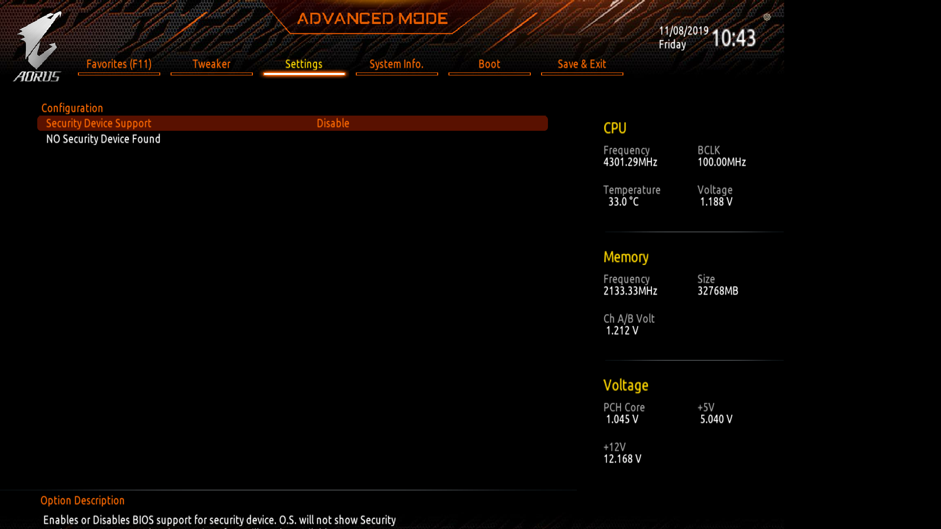

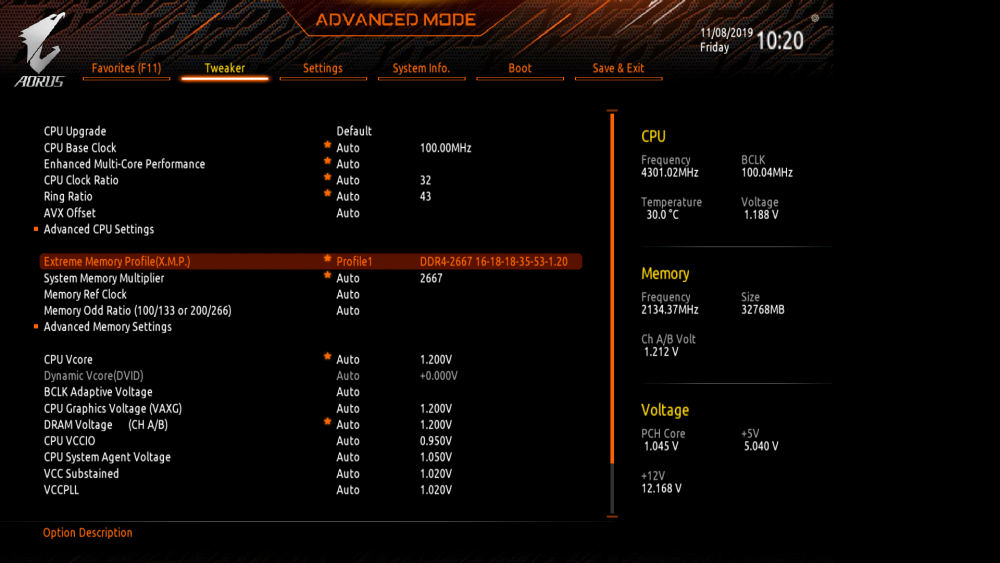

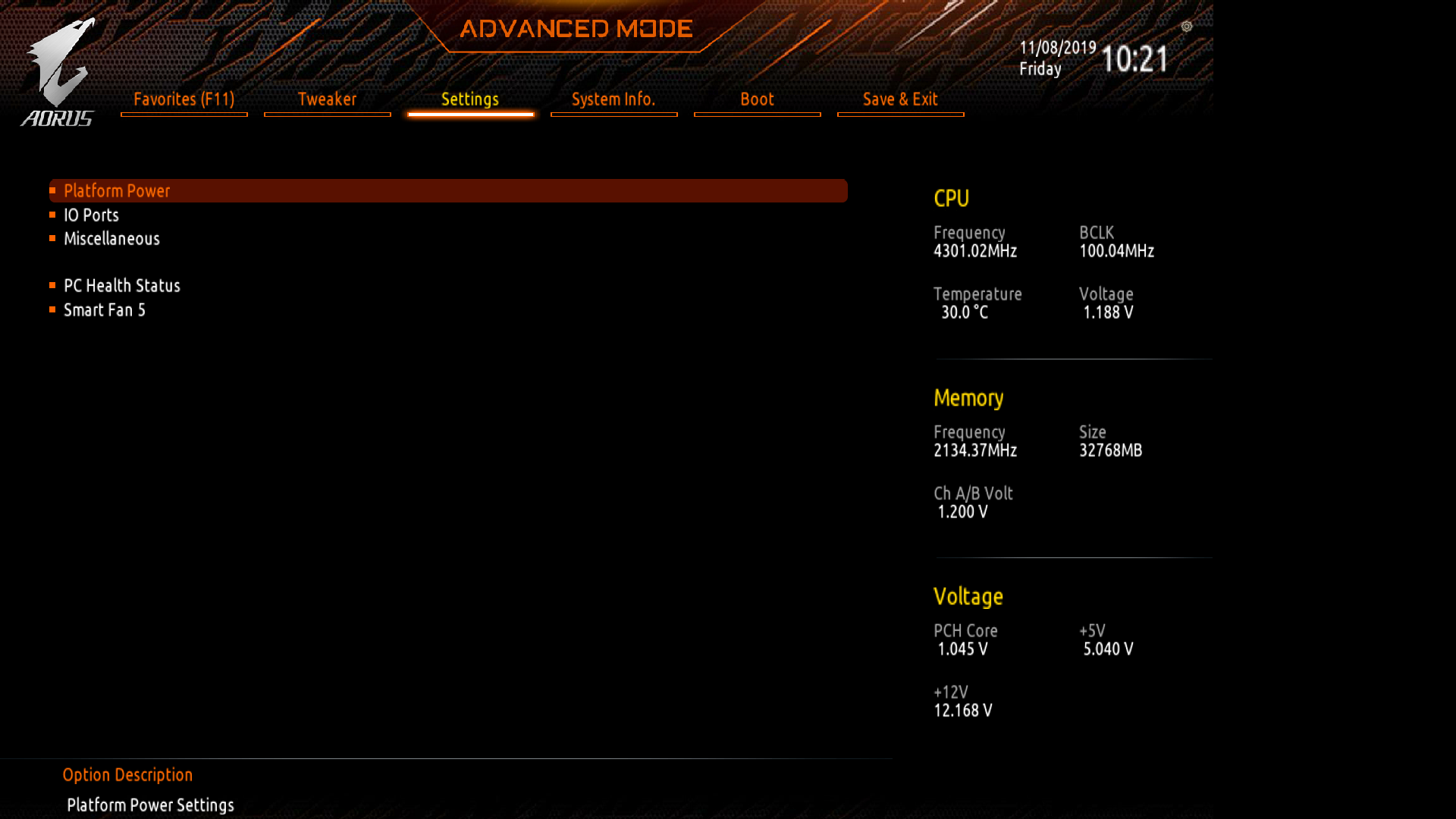

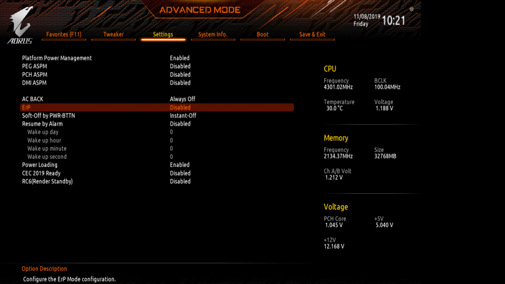

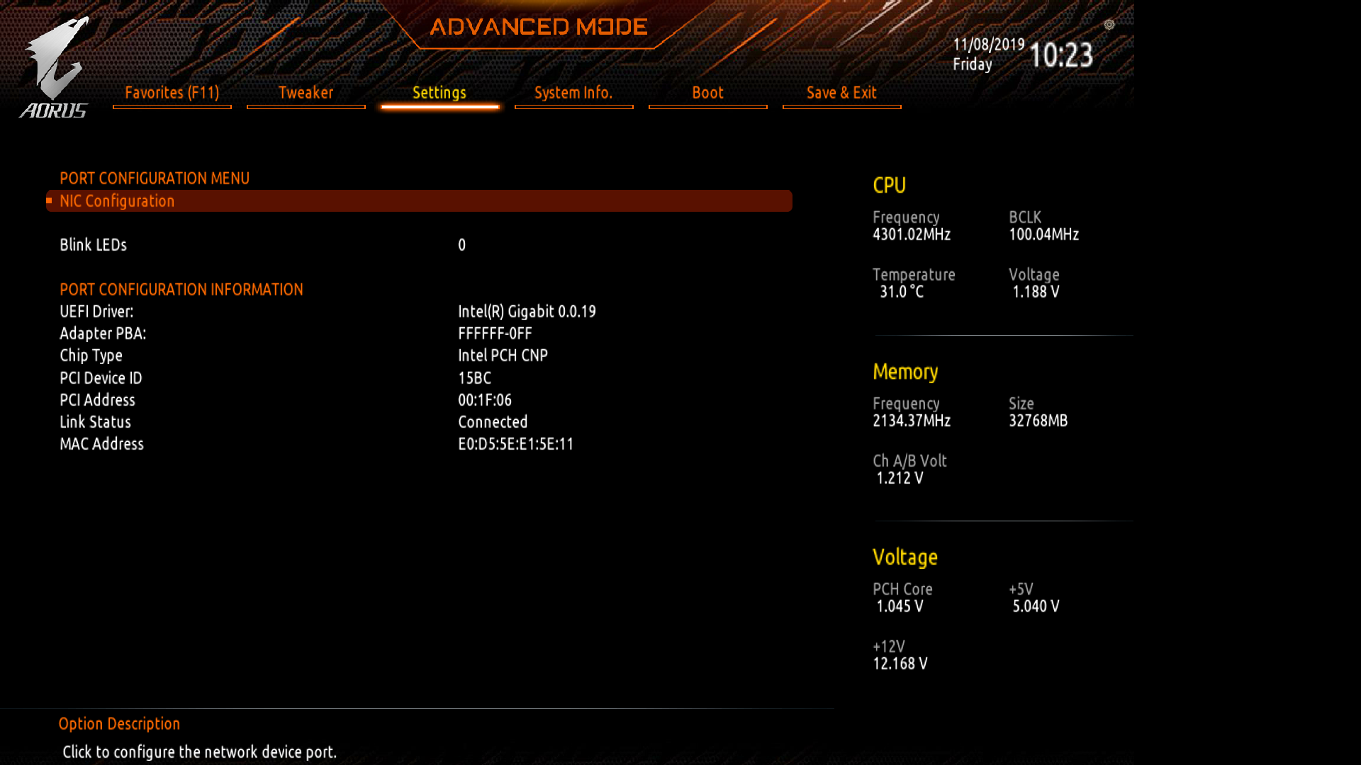

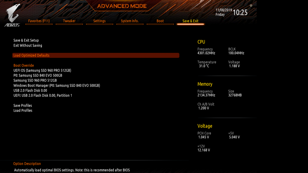

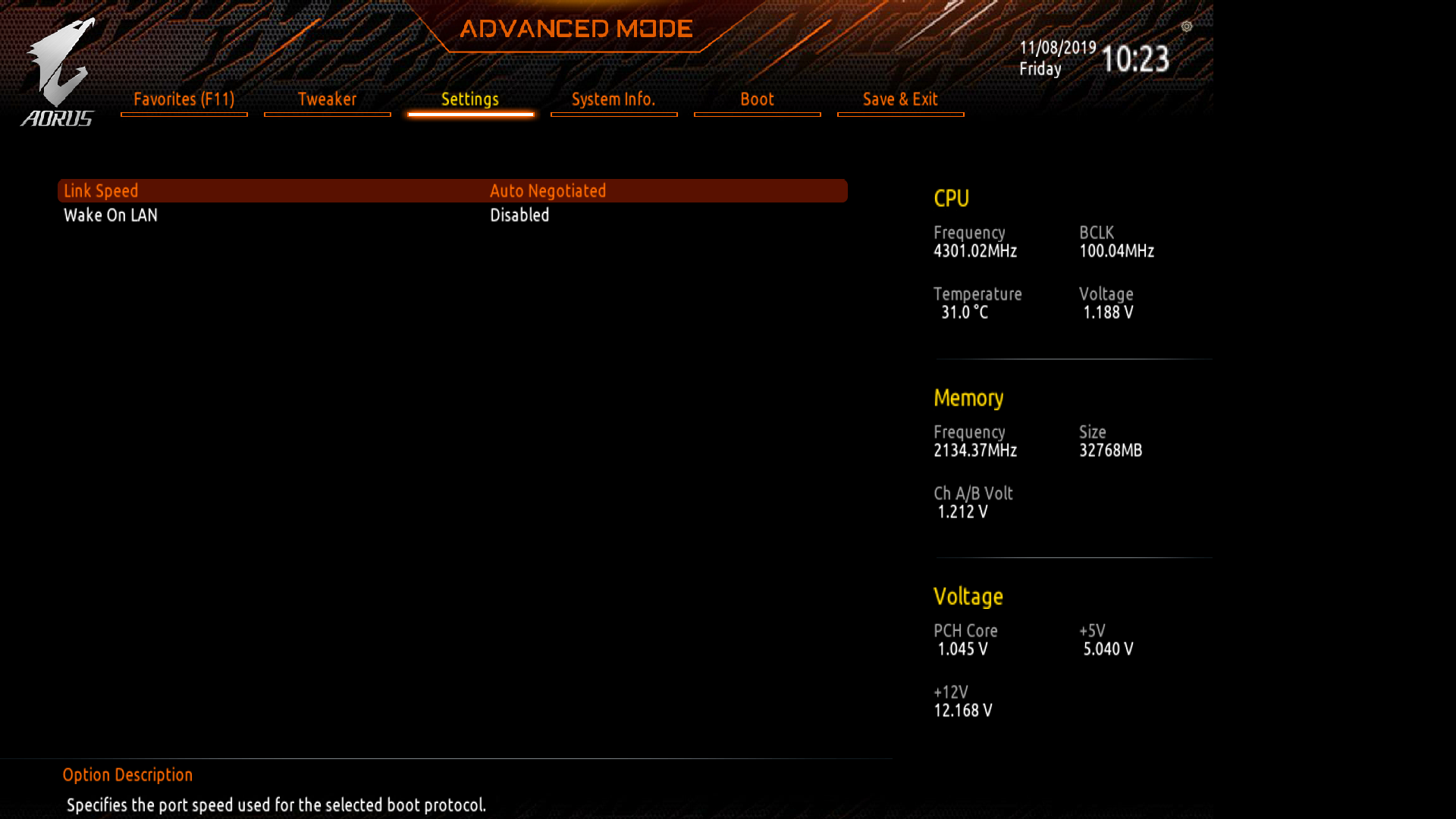

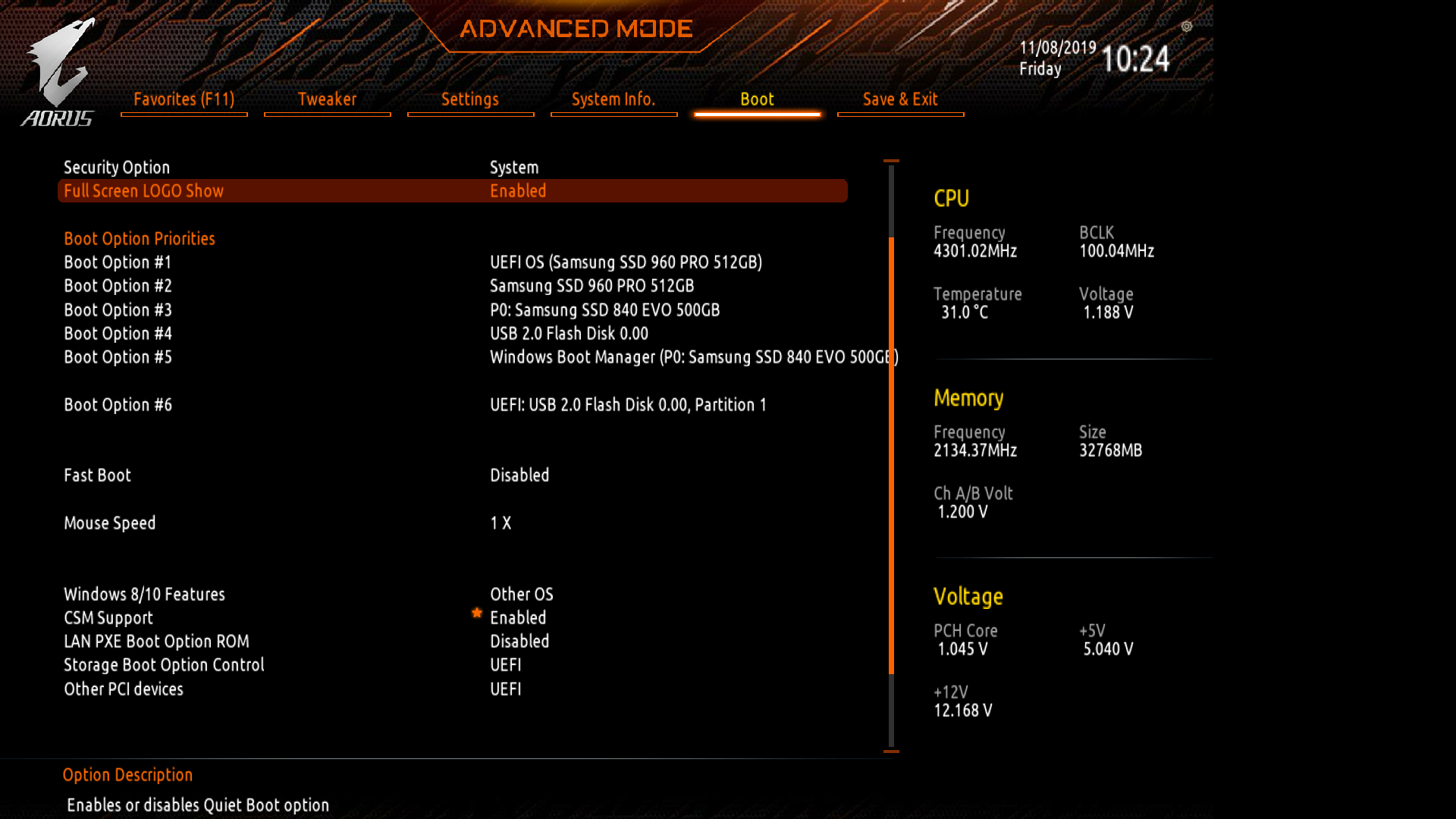

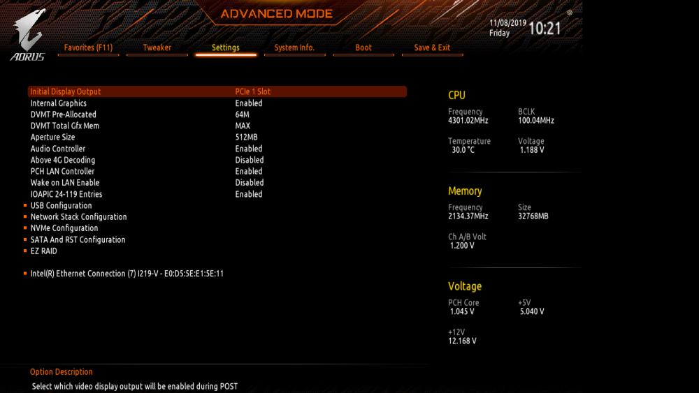

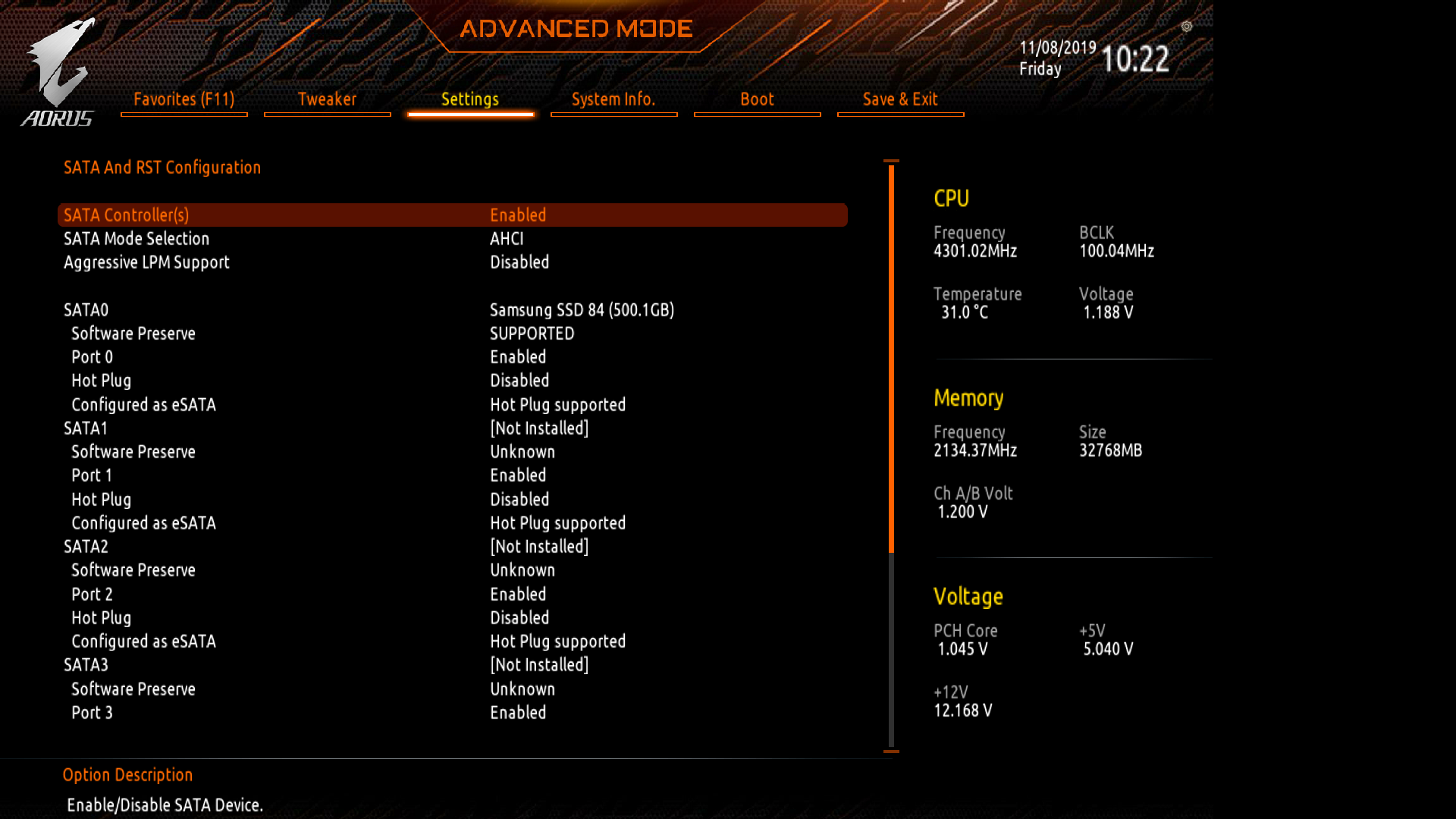

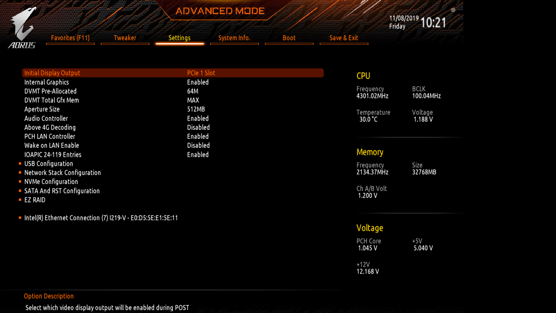

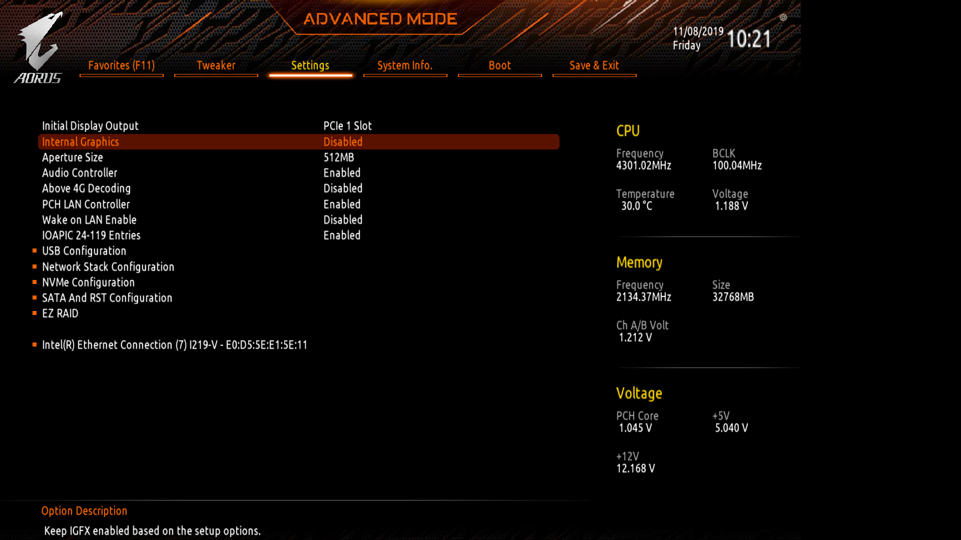

PART 2 - BIOS SETTINGS (Version F10 )
Here is a list of the BIOS settings that I use ( Screenshots in spoiler below )
BIOS SETTINGS (Bios Revision F11)
 • Enter BIOS  Press F12  Change to ADVANCED MODE
IF USING iMac Pro 1,1
Also change Aperture Size to 512GB
IF USING Mac Pro 19,1
ERP IS OPTIONAL, ENABLE OR DISABLE
ONLY IF USING CORSAIR H100i v2 AIO
 Save & Exit  Save & Exit Setup

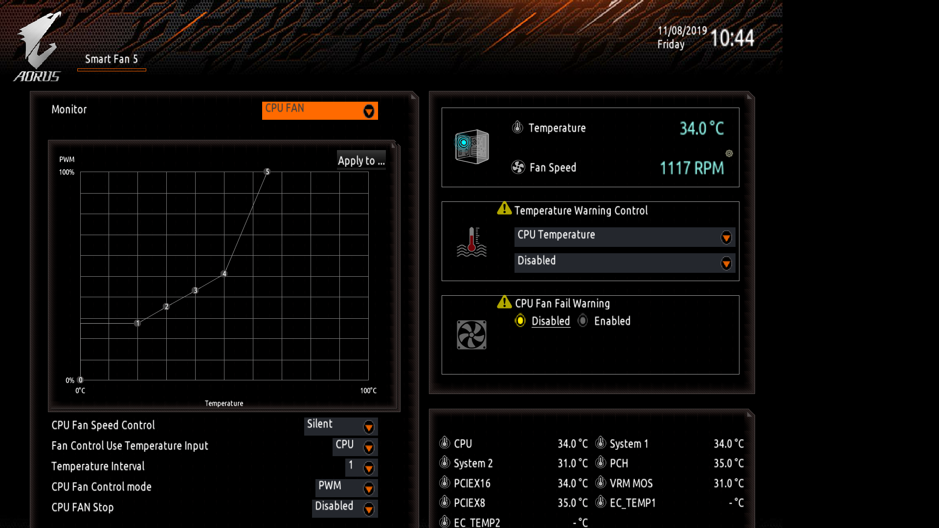

// IF USING  CORSAIR H100i V2 AIO CPU WATER COOLER
 MIT  Smart Fan 5 Settings  CPU Fan Control mode  PWM

ENSURE BIOS: Above 4G Decoding is set to Disabled

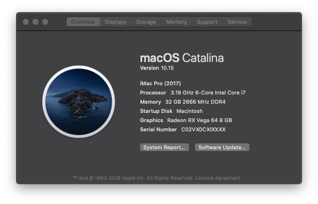

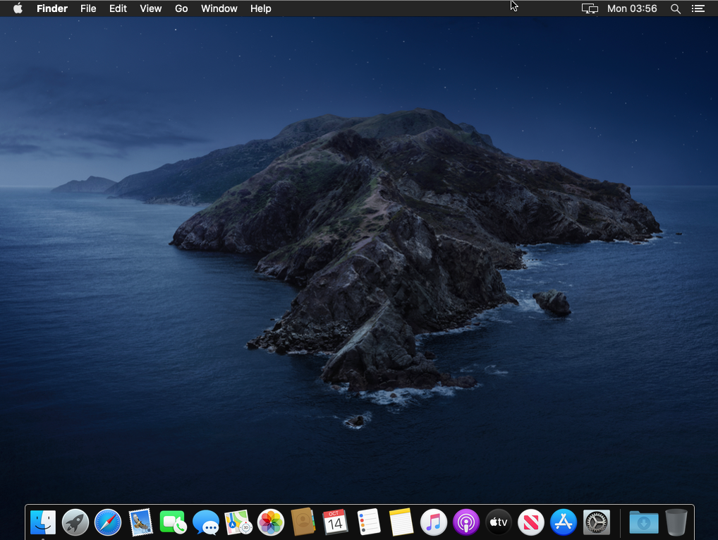

macOS Catalina is now installed, but it can only boot at this moment thanks to FakeSMC and Clover on the macOS Catalina USB installer.
1878378092_Screenshot2019-10-16at14_45_37.thumb.png.9638ba9c114c11ba6e08da217a52b2a0.png
PART 5 – MAKE AORUS Z390 PRO INTERNAL DRIVE BOOTABLE
Make Internal macOS Catalina system drive bootable ( Video below )
So far, the Aorus Pro can only boot the internal system drive with the aid of the macOS Catalina USB Installer.
To boot from the internal system drive without the installer:
  • Download and install Clover without the RC Scripts.
  • Copy the EFI folder from inside Z390 Pro DSDT EFI.zip  folder and paste it inside the the System Drive EFI partition ( you can delete nvram.plist ).
 Remove macOS Catalina installer and shut down and restart.
Aorus Hackintosh should now be able to boot to macOS Catalina.
