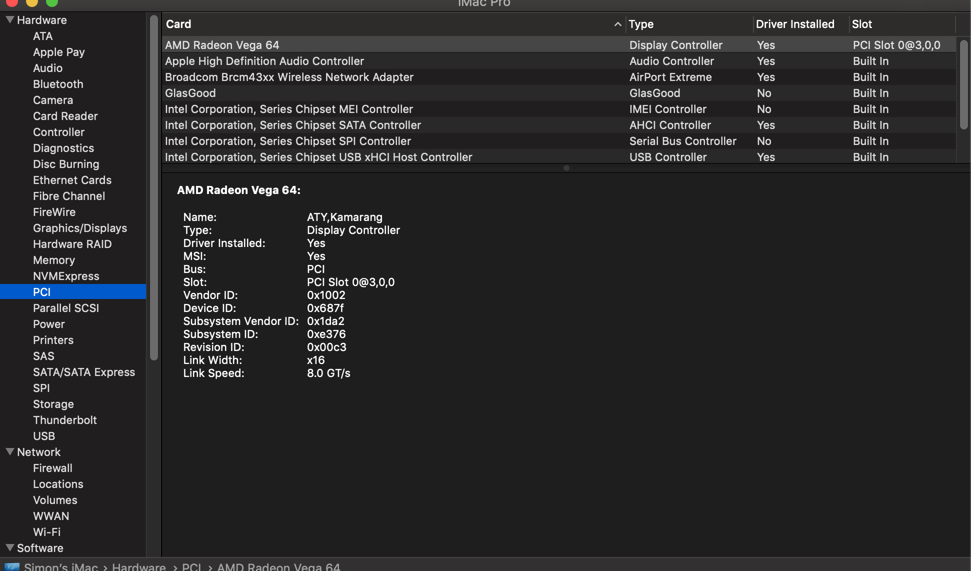

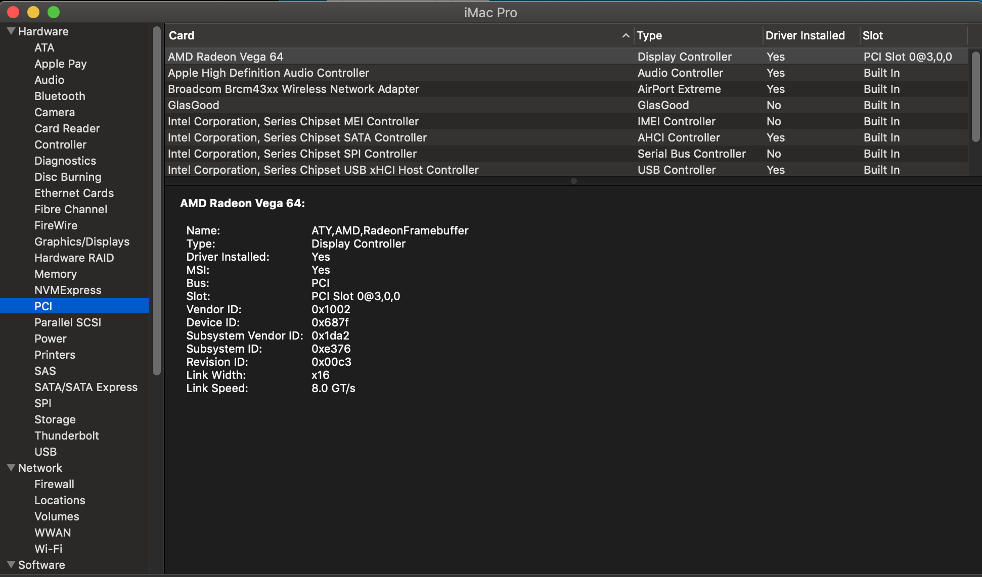

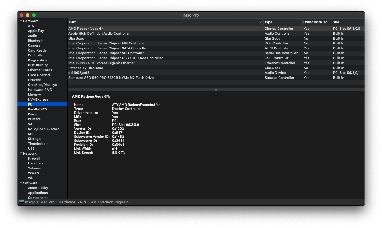

@glasgood Im back...lol....How do I change over to Kamarang?  Its not listed under FB Name.
I believe you can just type any name in on the framebuffer, doesn't have to match an entry in the list.
I typed it in but its still listed as ATY,AMD,RadeonFramebuffer under pci info?
@glasgood What am I doing wrong buddy?

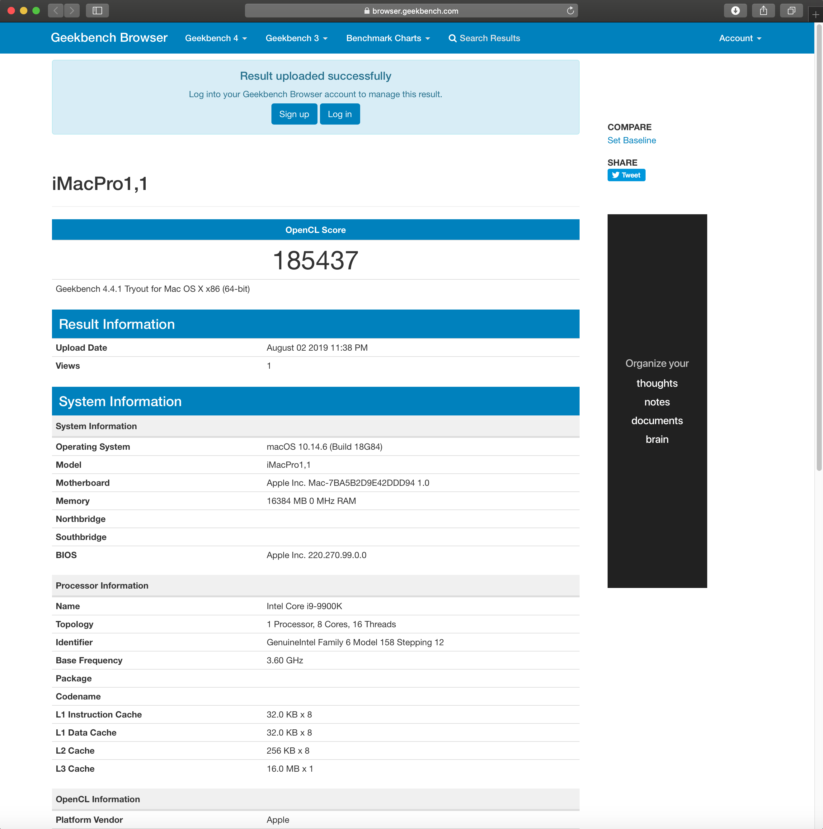

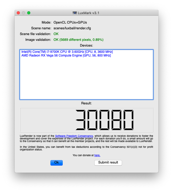

Test 1: Replaced Glasgood's EFI with Mald0n New EFI, Replace Framebuffer name. @glasgood This turns my 56 into 64 for some reasons... Lots and lots of graphic corruption during booting (screen tearing, rainbow lines, yes double rainbows during verbose boot looks super fun), but so far it's still running fine after logging in. Fans appears to be spinning a lot during testing. Temperature within range 66*C max, voltage is within max range of 1250mv too high for my weak vega56 board.

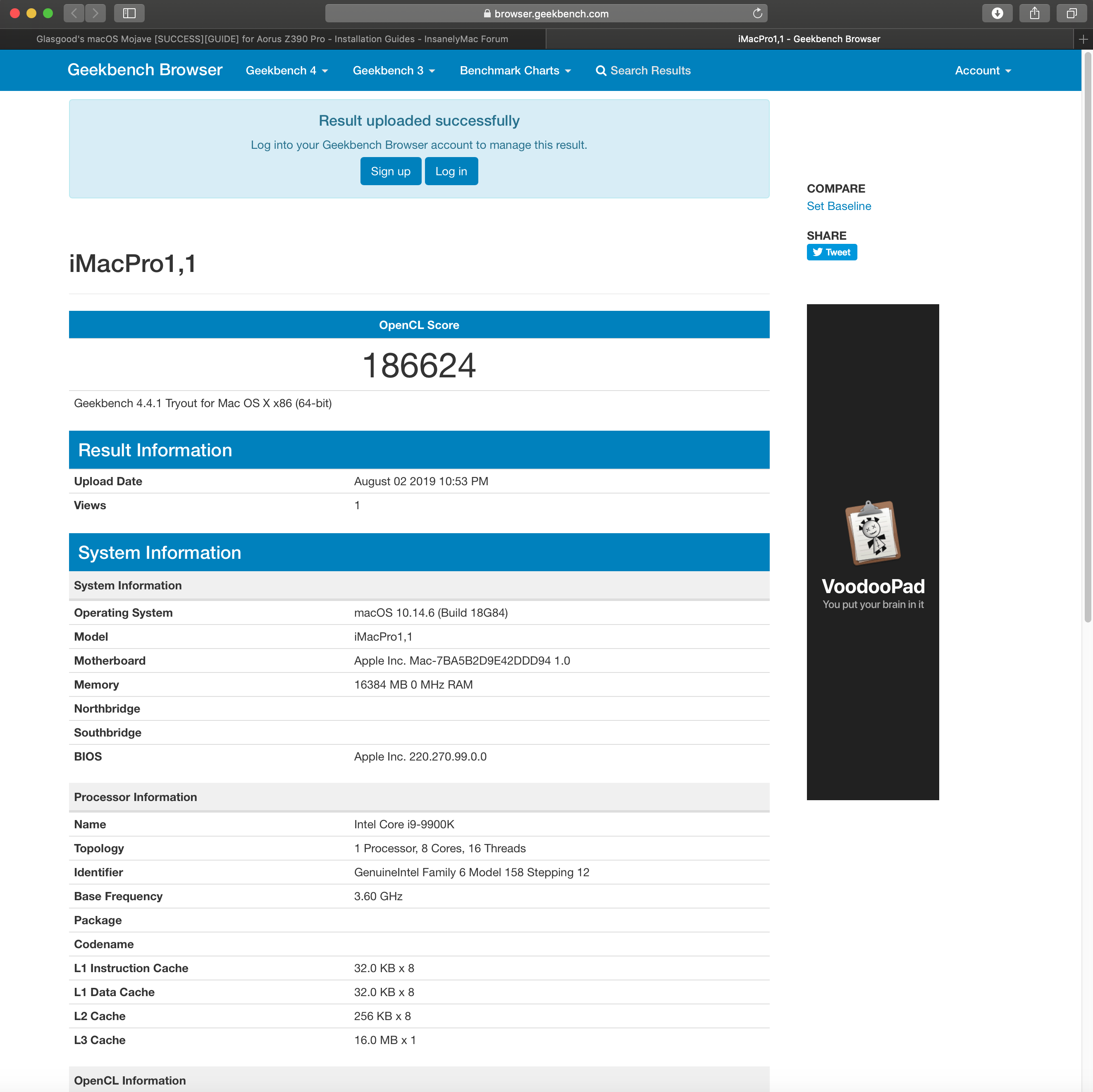

@AudioGod trying beating this score buddy.  I've just had a 30k score jump from 151k to 180k. Will get back with more information
1385331706_ScreenShot2019-08-02at1_35_47PM.png.8bc1d35dadee0b6dcab856bd17955d93.png1832285761_ScreenShot2019-08-02at1_48_31PM.png.c855ed43d48bbd833fab917c4b86ed3a.png
Update to graphic card test after several restarts, the score stablized at 184k:
@glasgood There are a bunch of Glasgood devices in my PCI hahahha. and I need to remove your 960 Pro PCI too...
@larabee Have That!!!!!!!

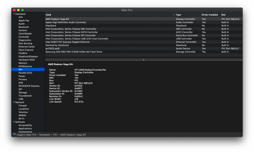

And that's with it not listing as Kamarang under pci info. I dont what I've done wrong now buddy...lol

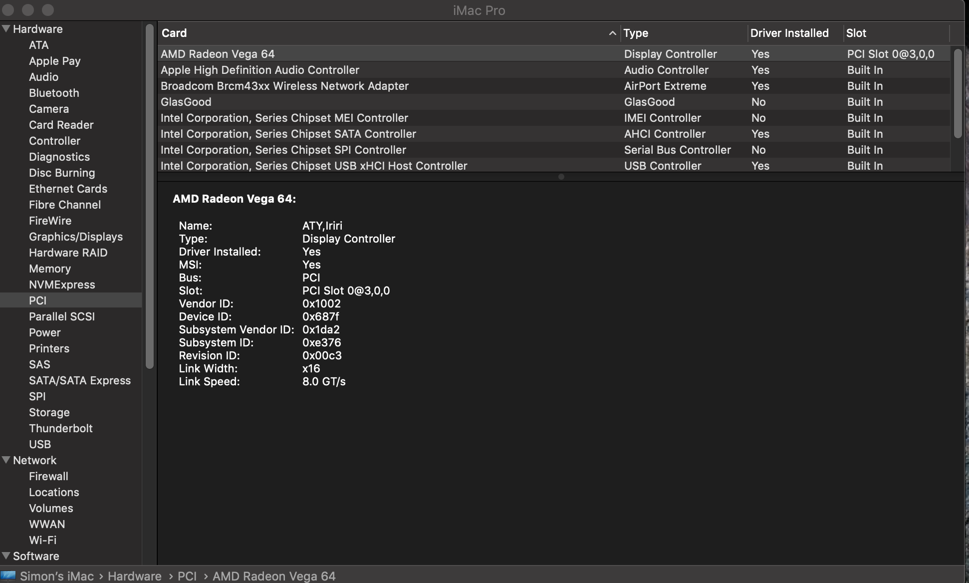

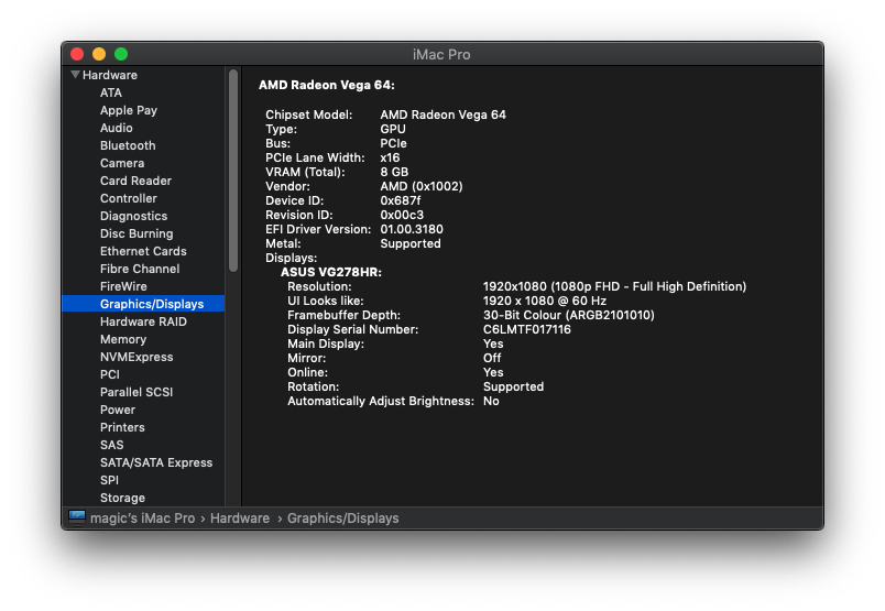

Ok, I got it going correctly now and like @larabee My card is showing as a Vega 64 using Kamarang and scoring around 185000.
Il swap over to Iriri now and see if I get the same results as @larabee again

I got Iriri working with the same results.
Im not getting any artifacting or strange behaviour with the vega56 running as a 64 though but I would prefer to have it as it should be.

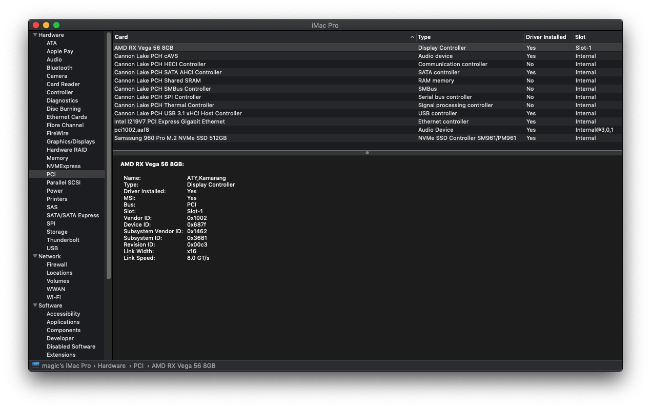

Is there not a way to use Kamarang and have it running as a Vega 56 cos it must be pumping to much voltage though the GPUs to be doing this {censored}e? :)

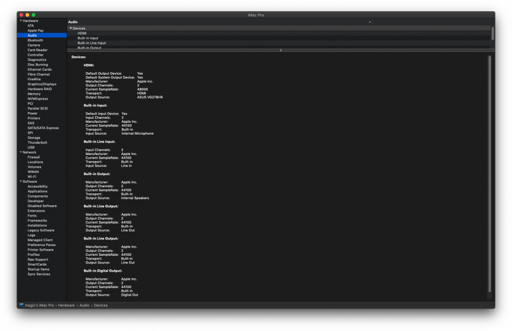

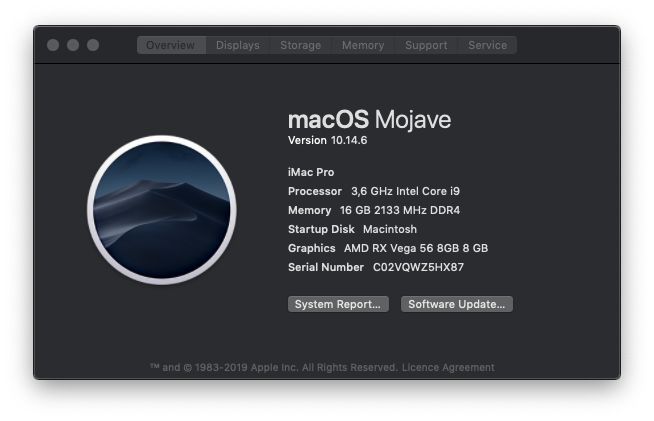

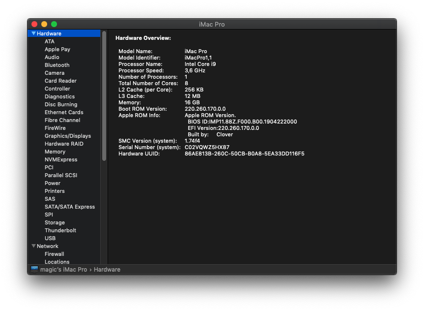

first of all BIIG thanks to @glasgood for the GREAT guide!!
Following all the steps, and mainly thanks to BIOS screenshots I finally was able to boot into installation and install Mojave!! :thumbsup_anim:
I've used the Aorus Pro Z390 EFI - Vega-56.zip  for the usb boot, and worked perfectly for the installation!
Now I'm on mojave finally,  BUT still booting from usb for now:
WHAT WORKS FOR NOW
  • Audio Works using ("csub" rear port input, the "H" port in the usb scheme in the guide)
  • Lan is recognized (but i didn't tried yet, but I'm confident should work , because it's recognized also in network interfaces)
  • Only the USB 2 ports are working (the 4 rear ports and 2 front)
  • Bluetooth dongle iogear GBU521W6  (on the 1 of the usb2 front ports)
  • Shutdown and Reboot
  • Sleep seems working also (I can awake it using keyboard spacebar)
WHAT DON'T WORKS (for now I hope:))
  • My already owned TP-Link TL-WDN4800  PCI (that worked great on Sierra) don't seems to be recognized (can I fix it ? or is better to buy the suggested ABWB BCM943602CS 802.11AC WI-FI With Bluetooth 4.0 ?) and it that case will work also the bluetooth?
  • None of the USB 3 ports seems to works (the usb pen light does not light up, and not showing on system)

The QUESTION NOW ARE:
Now I'm on Post Installation, And I'm pretty confused, WHICH POST INSTALLATION zip should I use now to boot directly from disk without USB ?
Should I just copy everything from working usb EFI or not?
And what to do to fix my problems? (usb3 and wifi ?)
THANK YOU VERY MUCH to All

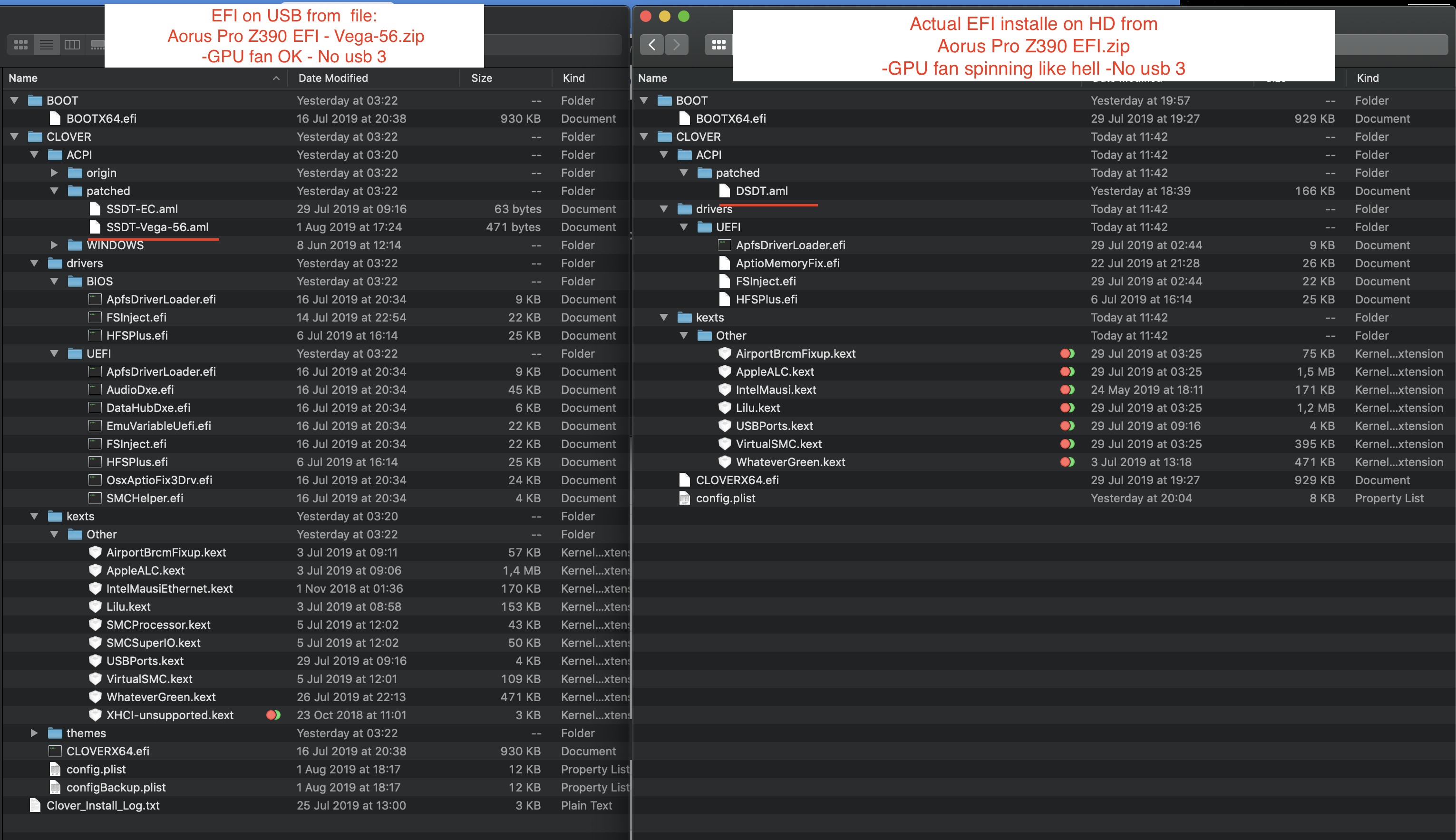

So this are my "problems"

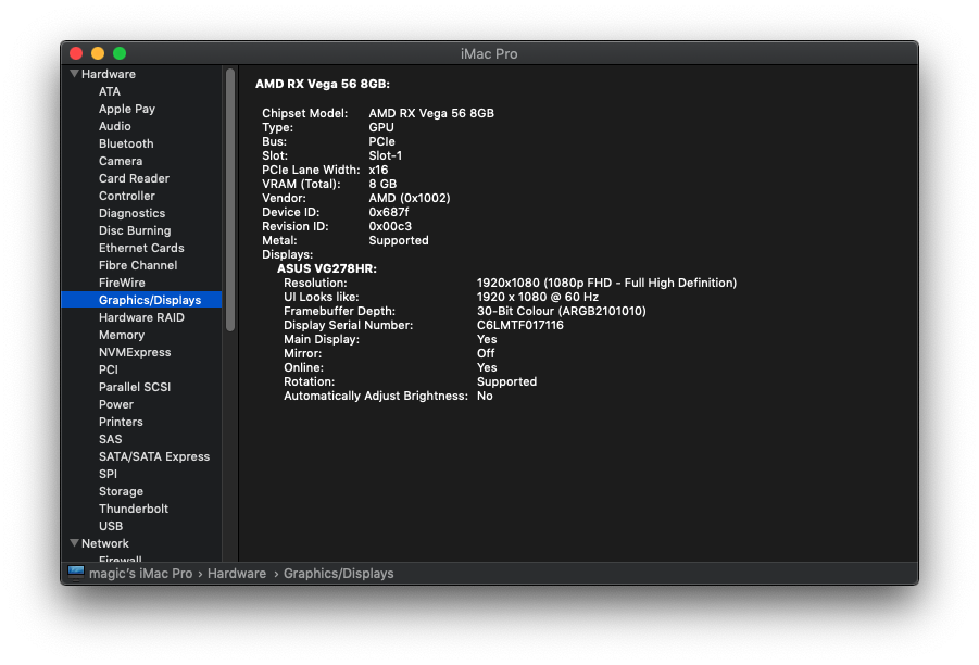

GPU
Now my GFX Fan are always spinning at max speed
During Sleep they stops, and when awake with POWER button, after login, they start spinning like hell
When I boot with the usb created using Aorus Pro Z390 EFI - Vega-56.zip this does not happens
(maybe i can take some configuration or kext from there?)

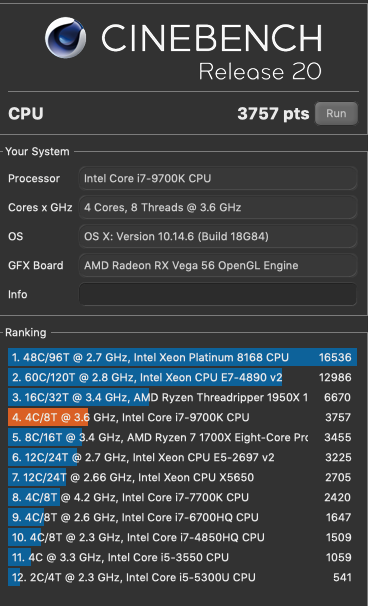

GPU "should" working good,
But I'm not sure, because Cinebench does NOT shot GPU in the benchmark, but only CPU,
insted LUX seems normal.
What I can try to verify that GPU is working at full speed?
 555762488_Screenshot2019-08-03at13_13_43.thumb.png.9a4a85f2de5b4062532fb7e3d21b4a5b.png

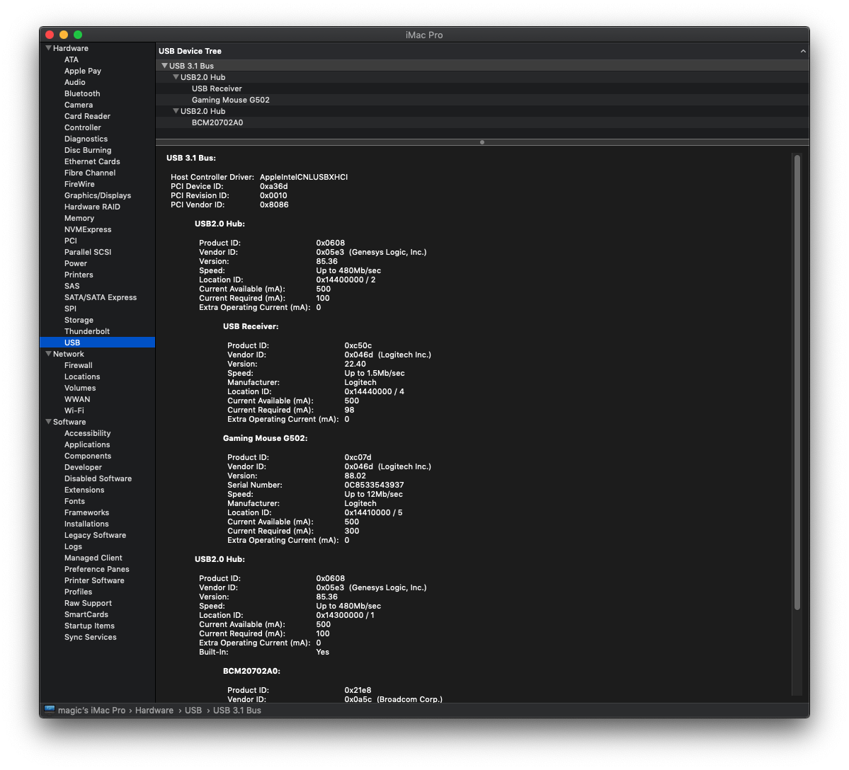

USB 3
Only the 4 top usb and 2 front are working (this is my sys info, maybe I needed to connect something when mounting mobo? :surprised:)
1782259472_Screenshot2019-08-03at12_51_38.thumb.png.8b2a950f6cd444241a7c9491070b5284.png

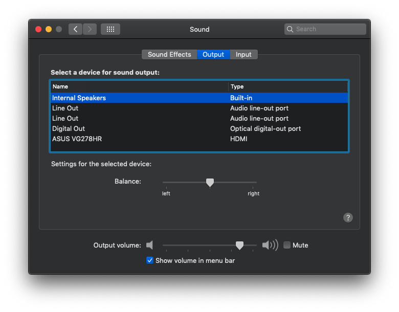

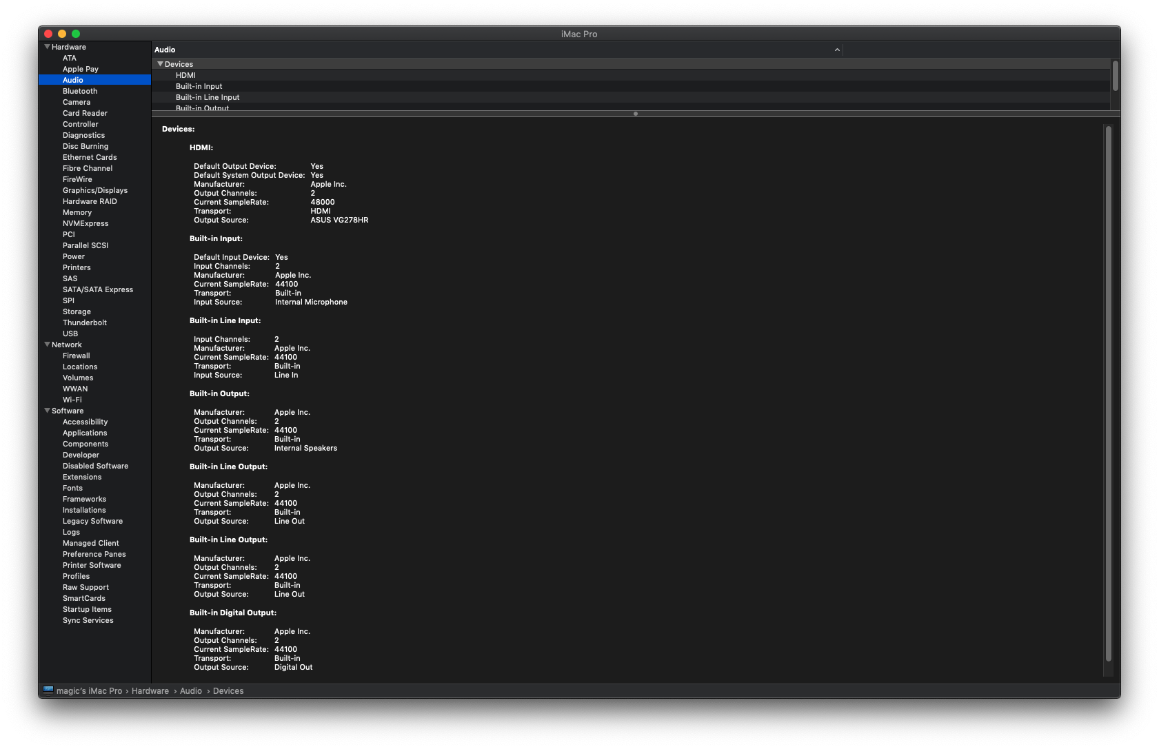

AUDIO
Audio now works using Internal Speaker device, and using the LINE OUT port (the "L" port in the usb  port conf Image) it is normal?
But when I switched the audio jack, tI got a black screen, and I was forced to manually reboot :shock: )
Thank you for your time!!

Attach your EFI

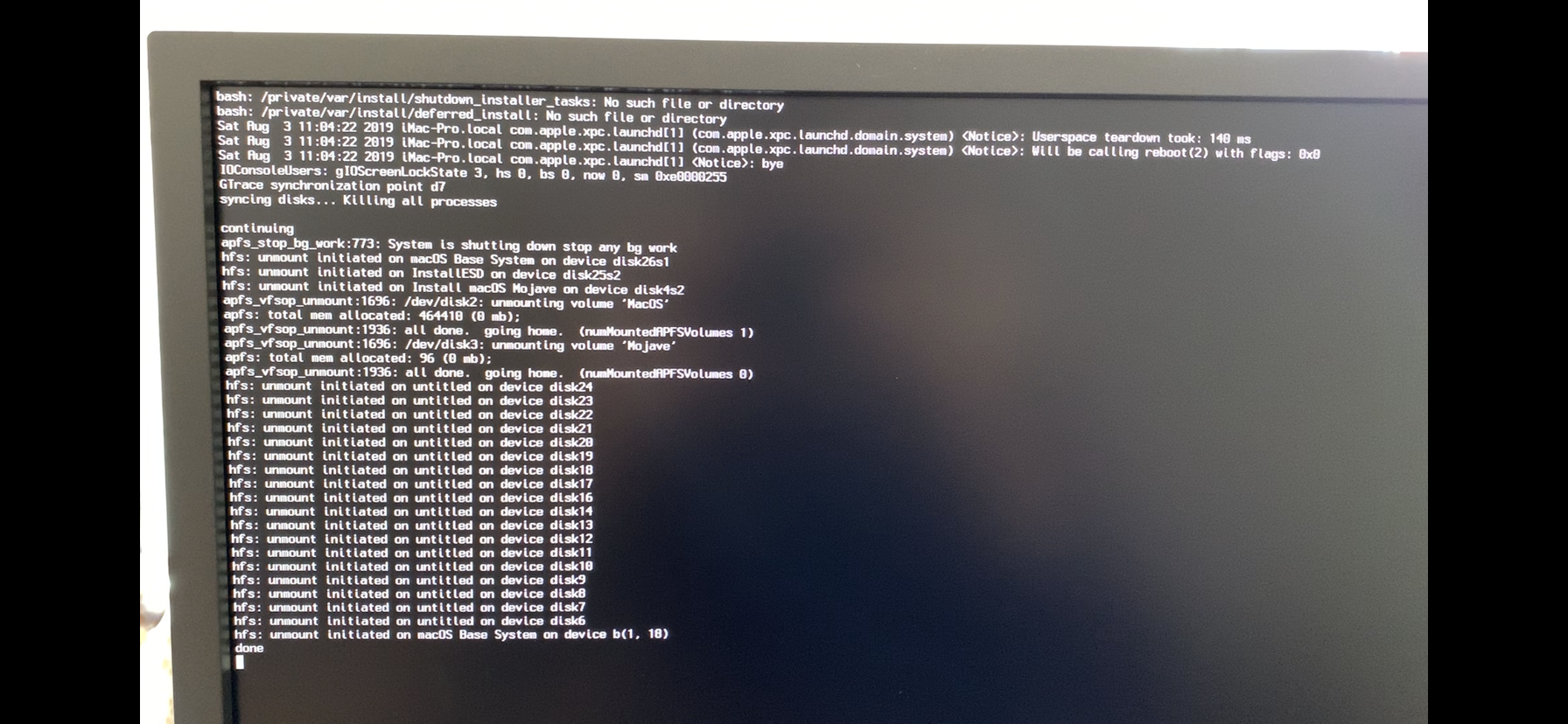

Hi,
I am new to the Hackintosh Topic and I just cant resolve this issue.
When I boot up for the installation everything goes perfectly fine.. until I want to install Mojave on the previously formatted drive.
No matter what I do, I cant get past the Installer.
It loads shows 3min remaining, 2min and then crashes. Everytime.
I made a Video that shows the problem.
I really hope someone can give me a keyword to search for, because I am lost.
Is it the Mainboard Bios Version?
Video <- here is a video of the process.
Setup:
Z390 Aorus Pro (Bios ver F10)
i5 9600k
RX580
Samsung Evo 860
2 minutes ago, erikmay said:
Hi,
Setup:
i5 9600k
RX580
Samsung Evo 860
That's not a crash, it normal part of the install process. Boot back to your USB installer and go to Clover boot menu and continue installation.
Follow video.
Ok so this are the 2 EFI, also attached as ZIP
USB EFI (on the left)
SHould be identical to your Aorus Pro Z390 EFI - Vega-56.zip
used for first boot and Mojave installation
(this has the SSD-Vega-56, maybe this is needed for the always on fans?)
HD EFI (on the right)
Should be identical to your Aorus Pro Z390 EFI
And its the EFI isntalled in the HD of the installed Mojave
In both cases no USB 3 port of the rear panel is working (also the usb c)
I just installed an external Usb 3 Panel connected to usb3 mobo port, and they are working, but NOT the "natives"
1728975804_Screenshot2019-08-03at12_38_20.thumb.png.378a9274157d14f10402c12ab3fba907.png
USB EFI.zip
HD EFI.zip
