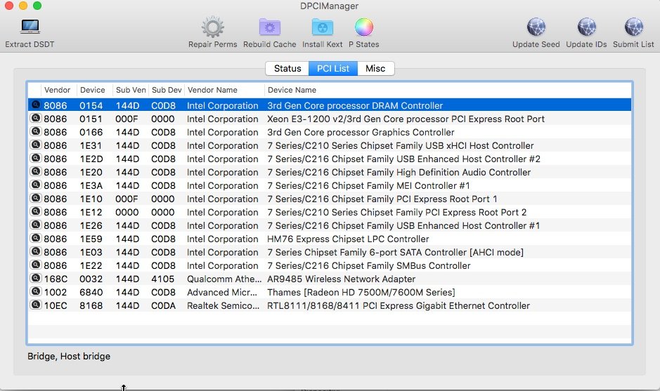

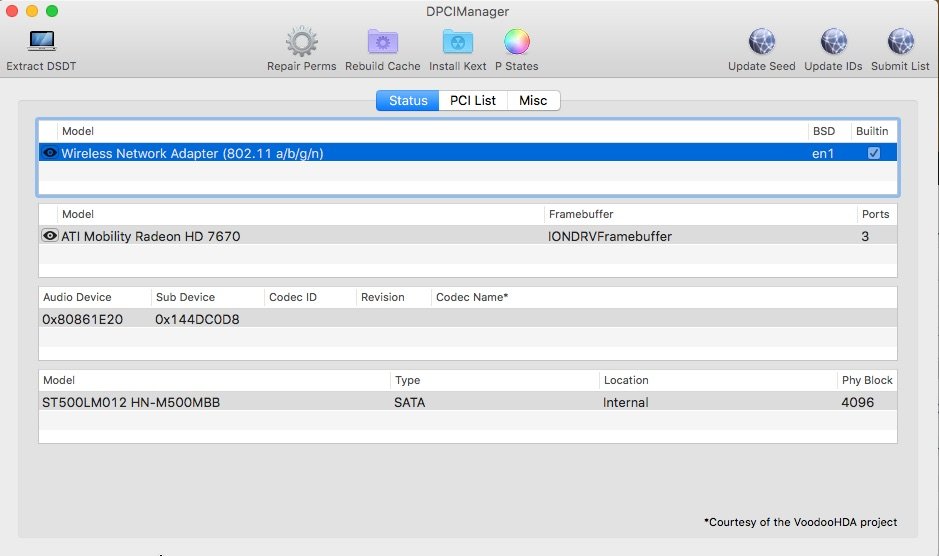

freek Posted November 27, 2018 Author Share Posted November 27, 2018 (edited) allora.. Archivio.zip questa è la mia efi questo dpci manager Edited November 27, 2018 by freek Link to comment https://www.insanelymac.com/forum/topic/336595-np350v5c-s09it/page/6/#findComment-2650230 Share on other sites More sharing options...
