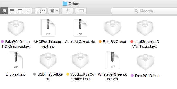

foskvs Posted November 30, 2018 Share Posted November 30, 2018 (edited) Non ho capito perché ti ostini a usare FakePCIID.kext con una HD 4000. Devo essere all'oscuro di qualcosa... Sostituisci (NON unire le cartelle). CLOVER.zip Edited November 30, 2018 by foskvs 1 Link to comment https://www.insanelymac.com/forum/topic/336595-np350v5c-s09it/page/7/#findComment-2650689 Share on other sites More sharing options...
freek Posted November 30, 2018 Author Share Posted November 30, 2018 @foskvs questa cosa non lho fatta..ho solo cambiato su clover config una impostazione,nella sezione grafica, ho intel inject e messo ig platform id con quello che dovrebbe essere la mia scheda, ma non ho installato nullissimo a parte il driver ethernet Link to comment https://www.insanelymac.com/forum/topic/336595-np350v5c-s09it/page/7/#findComment-2650693 Share on other sites More sharing options...
foskvs Posted November 30, 2018 Share Posted November 30, 2018 No, intendo che hai FakePCIID e FakePCIID_intel_graphics in EFI/CLOVER/kexts/Other Link to comment https://www.insanelymac.com/forum/topic/336595-np350v5c-s09it/page/7/#findComment-2650699 Share on other sites More sharing options...

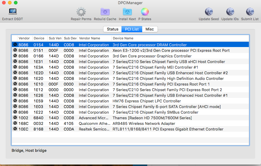

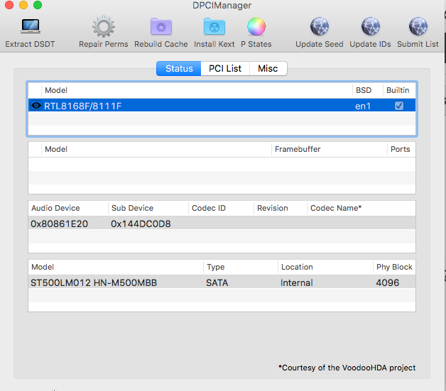

freek Posted November 30, 2018 Author Share Posted November 30, 2018 1 minute ago, foskvs said: No, intendo che hai FakePCIID e FakePCIID_intel_graphics in EFI/CLOVER/kexts/Other io non ne so nulla.. comunque ora la scheda video viene riconosciuta, manca l'audio, il wifi, il lettore sd, e il fatto che all'accensione, devo scegliere manualmente l'hd di bot dalle impostazioni veloci del bios.. Link to comment https://www.insanelymac.com/forum/topic/336595-np350v5c-s09it/page/7/#findComment-2650701 Share on other sites More sharing options...
foskvs Posted November 30, 2018 Share Posted November 30, 2018 Rifai hack_info e ioreg. 1 Link to comment https://www.insanelymac.com/forum/topic/336595-np350v5c-s09it/page/7/#findComment-2650702 Share on other sites More sharing options...
freek Posted November 30, 2018 Author Share Posted November 30, 2018 (edited) e per scorrere tra le impostazioni devo collegare un mouse usb perche altrimenti non riesco a muovere nulla, ne con trackpad ne con tastiera @foskvs eccoli MacBook Pro di freek.zip HackInfo_Report.zip Edited November 30, 2018 by freek Link to comment https://www.insanelymac.com/forum/topic/336595-np350v5c-s09it/page/7/#findComment-2650704 Share on other sites More sharing options...
foskvs Posted November 30, 2018 Share Posted November 30, 2018 Per l'audio, prova uno di questi layout sul config.plist nella sezione Devices/Audio/Inject: layout 1-11, 13-16, 18-20, 27-30, 32, 33, 35, 40, 45, 58, 66, 76, 93, 99, 127 Per il WiFi, installa il kext in S/L/E. Il lettore di schede SD non è compatibile. Alla gui di Clover, premi F4, attendi e poi avvia macOS. Poi allega la cartella CLOVER. Link to comment https://www.insanelymac.com/forum/topic/336595-np350v5c-s09it/page/7/#findComment-2650707 Share on other sites More sharing options...
