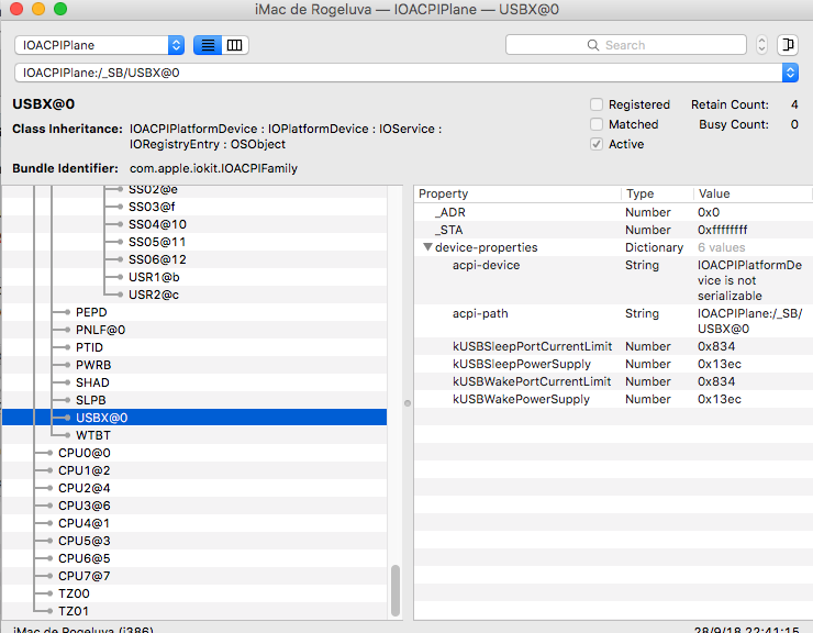

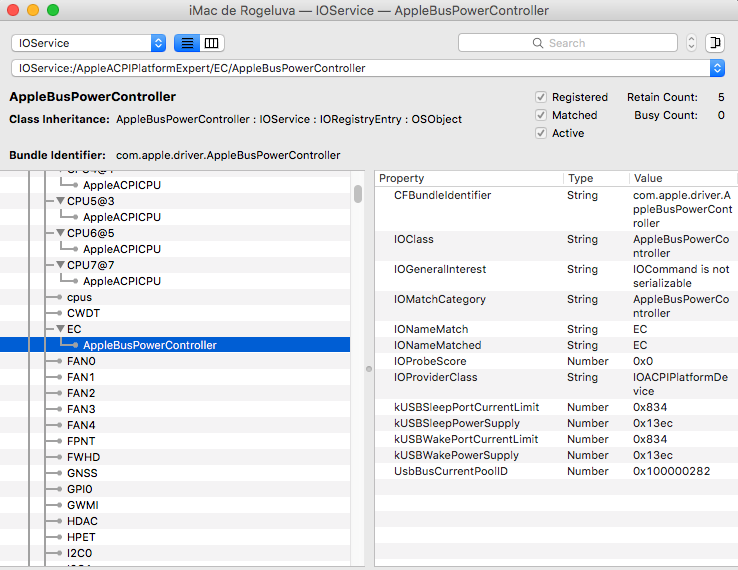

I'm glad that your problem is solved. With respect to the Electrical properties, use SSDT to enable EC Device ?. I think that starting from Sierra, the Electrical properties for the USB ports changed.
127061476_Capturadepantalla2018-09-28alas22_40_51.png.b1cea305f0b9de57186688de0645b5be.png
1255938680_Capturadepantalla2018-09-28alas22_42_37.png.ebb8dab76727d9f122396351ef3e347a.png
Great, just injected both EC and USBX and all values are properly detected, thanks to your information, now my system is even better configured than before 10.14.1 update.  Definitely learned some new interesting things about it, thanks to you. :thumbsup_anim:
