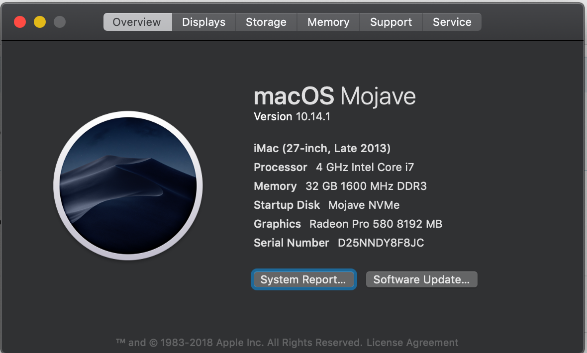

SavageAUS Posted November 12, 2018 Author Share Posted November 12, 2018 2 hours ago, tikizondo94 said: I made the same change. Came from a GTX970 and went to the RX580 8GB model. Using the Gigabyte Auros model. No issues at all. Love it. Attached is something to try with your card. This kext changes your RX580 to an AMDRadeonPro. Which is what's in the iMacPro. Allows for full support for H264 and H265:) Just add the kext in Clover/Kexts/Other. I cant claim any credit for this kext. AMDRadeonPro.kext.zip With this kext do you get the bright white flash on bootup? between first and second stage? Link to comment Share on other sites More sharing options...

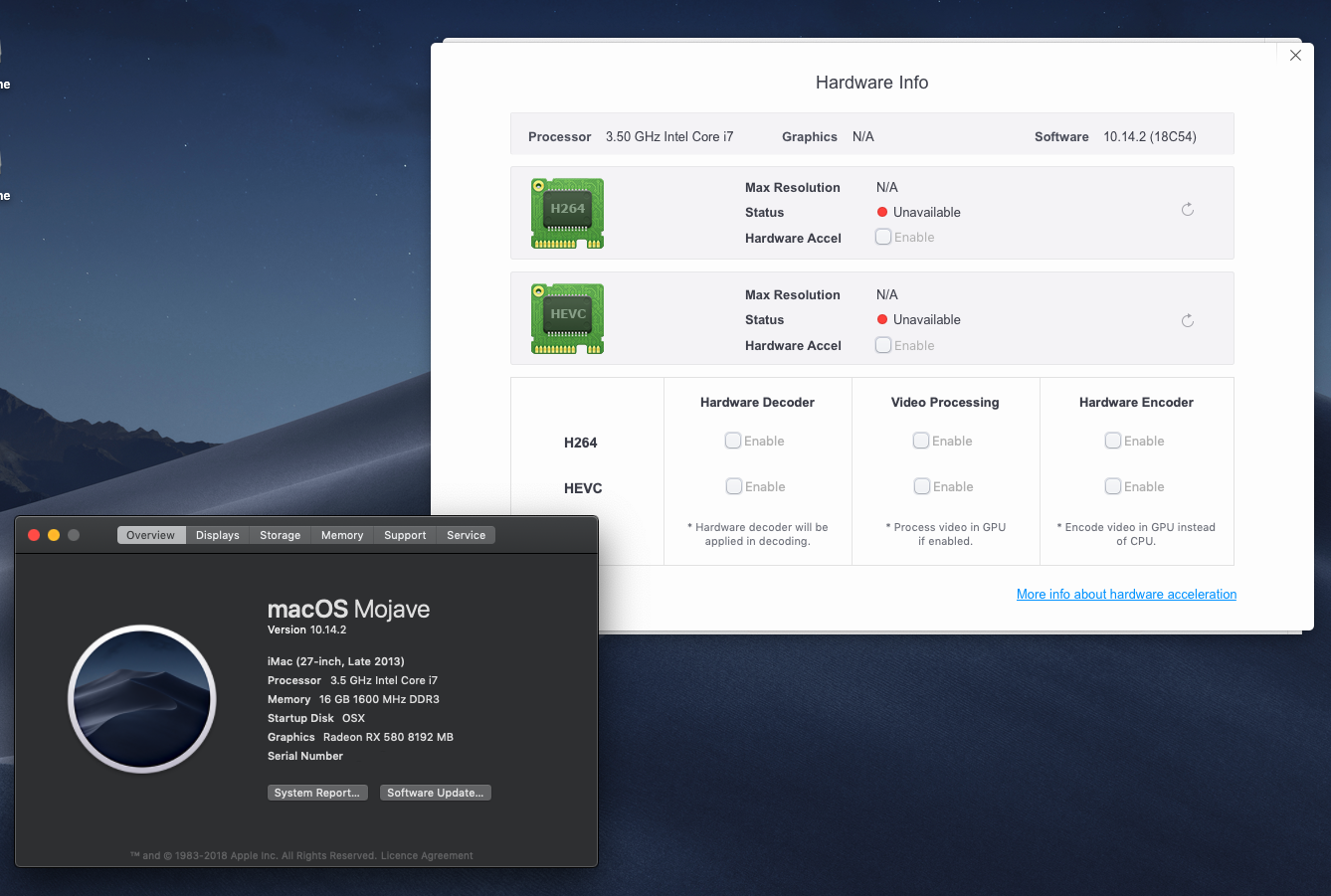

xAyiDe Posted January 8, 2019 Share Posted January 8, 2019 On 12/3/2018 at 3:21 PM, tikizondo94 said: I've made some more progress with getting hevc and h.264 working with our rx580s. -Try the attached text in Clover/Kexts/Other. -Remove the above AMDRadeonPro.kext -Clear all caches and repair permissions. -Disable your iGPU in BIOS. I've got Netflix working in safari again, and HEVC and H.264 encode/decode working and reporting in IOregistry. (I claim no credit for this kext) AMDRadeonEllesmereGVA.kext.zip would it be possible for you to attached your EFI-folder. I cannot get the radeonpro.kext to load and show any difference nor do I get HEVC/H264 to work in either encode or decode with the AMDRadeonEllesmereGVA.kext. I am on 10.14.2 with rx580 nitro+ flashed to native card 113-4E353BU-O4E. Link to comment Share on other sites More sharing options...
tikizondo94 Posted January 9, 2019 Share Posted January 9, 2019 53 minutes ago, xAyiDe said: would it be possible for you to attached your EFI-folder. I cannot get the radeonpro.kext to load and show any difference nor do I get HEVC/H264 to work in either encode or decode with the AMDRadeonEllesmereGVA.kext. I am on 10.14.2 with rx580 nitro+ flashed to native card 113-4E353BU-O4E. This is my current clover im using. Im currently setup using Intel Qsync with my RX 580. "iGPU enabled in BIOS and using a headless connector ID". Now, when i have Qsync enabled i cannot view Netflix in safari. Only when i disable my iGPU in BIOS and using only my RX580 can i view DRM content in safari. CLOVER.zip Link to comment Share on other sites More sharing options...

xAyiDe Posted January 9, 2019 Share Posted January 9, 2019 5 hours ago, SavageAUS said: What was the reason to flash the card? Mine is the same 8Gb version and works oob. If I use the radeonpro kext it’s shows as a Radeon pro. Haven’t tested h264 or the new kext yet. Sent from my iPhone using Tapatalk The reason was that I wanted to have the right orinoco framebuffer without edits. So I added the right BIOS serial/Partnumber but still it wouldnt give the right amount of ports so the edit was of no use actualy. I still need to inject orinoco and 5 ports to get it to work with 4-5 screens and sleepmode. Link to comment Share on other sites More sharing options...
xAyiDe Posted January 9, 2019 Share Posted January 9, 2019 7 hours ago, tikizondo94 said: This is my current clover im using. Im currently setup using Intel Qsync with my RX 580. "iGPU enabled in BIOS and using a headless connector ID". Now, when i have Qsync enabled i cannot view Netflix in safari. Only when i disable my iGPU in BIOS and using only my RX580 can i view DRM content in safari. CLOVER.zip Aha, that must be it. I have no iGPU. Forgott to add my signature with my build but I have Xeon E5 so no iGpu. I guess thats what makes this a bit harder with HEVC/H264. Link to comment Share on other sites More sharing options...

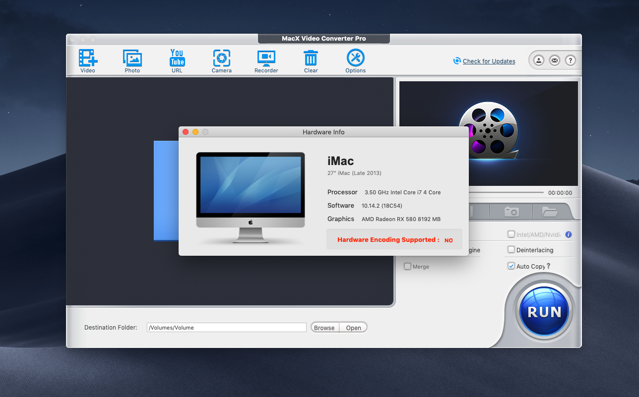

Apple Hunter Posted January 22, 2019 Share Posted January 22, 2019 Till now I have done lots of setting, edit config, adding whatevergreen and lilu kext still I cant fix hardware encoding on FCP, Premier Pro are Getting Very poor Performance on AMD RX 580. Even Enable both dGPU & iGPU same issues No hardware encoding. In IGPU HD 4000 QS encoding works Fine. I have attached my EFI Please check whether that settings are wrong and help me How to fix it ? will be more appreciate. My system:- OS MOJAVE 10.14.2 Z77 with i7 3770k 16G RAMSAPPHIRE Pulse RX 580 8GB (PEG) Primary Display HD4000 Secondary Display. EFI.zip Link to comment Share on other sites More sharing options...
