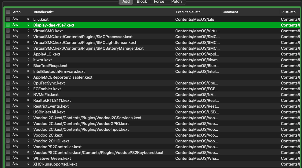

I've create the .kext with Hackintool and put it on OC/kext folder + address it on config.plist, but nothing changes at the System Preferences > Displays
31 minutes ago, joevt said:

Here is:

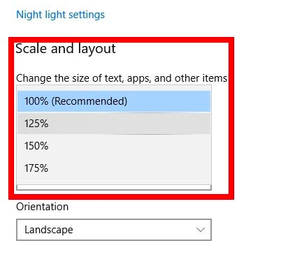

On 7/1/2022 at 6:36 AM, Allan said:
In a nutshell something that I want is to increase/decrease scaling on macOS like Windows. :wacko:
The ability to choose arbitrary UI scaling factors in macOS was removed after Mac OS X 10.5. It's possible the code still exists in macOS, but I haven't tried making a patch to create a mode that is not 1x or 2x to test this.
Now you have to combine a UI scaling factor of 200% (per dimension) with an arbitrary resolution scale factor.
On the Windows side, you need to determine if the scale % that you want is referring to area (two dimensions) or length (single dimension) before you can translate this to macOS.
  • Thanks 1

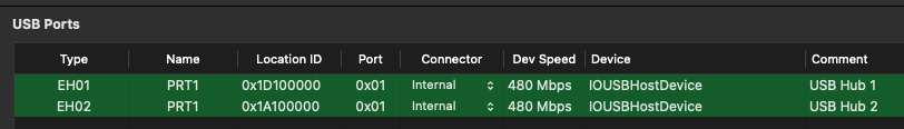

I am using Hackintool 3.9.1 on multiple hacks without any issues.  It works great for me.  Most recently, I used Hackintool to generate USBPorts.kext for my HackBookPro6,2 (Dell Latitude E6410) here.  The resulting USBPorts.kext is attached to this post.  I am not having any USB functionality issues with my hack. I am only reporting this in case it helps to diagnose/debug issues with Hackintool.
When my hack is running macOS Big Sur and Monterey, Hackintool displays USBPorts as would be expected.
Spoiler
1342890127_ScreenShot2022-12-05at4_59_46PM.thumb.png.d46d9c325c45f7af6c82642378bb60d0.png
However, when running Ventura 13.0.1, Hackintool displays only the USB Hubs EH01 and EH02 (none of the USB Ports):
Spoiler
Despite this display issue in Hackintool, USB ports are working normally on my hack and USB ports are displayed as would be expected in IORegistryExplorer:
Spoiler
When a USB thumb drive is inserted into one of my hack's USB ports, the port status updates in IORegistry explorer, but Hackintool continues to show only the USB  hubs (even when Hackintool USB screen is manually cleared and refreshed.
Spoiler
I am only observing this Hackintool USB display issue when running Ventura.  This issue does not occur when running Big Sur and Monterey.  This is not a problem for me - I'm only reporting in case this helps @headkaze diagnose/debug issues.
Thank you for a great tool, @headkaze!
USBPorts.kext.zip
I can only suspect yet another means of reading/enumerating the ports on Ventura that Hackintool hasn't caught up yet...
What is important @deeveedee is that the generated USBPorts (on Monterey I assume, and you kept using it) is working on Ventura OS well.
Could that be it @headkaze?  (and thanks from me too, once more, for the great tool!)
@MacKonsti I ran Hackintool in Big Sur to generate USBPorts.kext.  It was a little tricky, because the Internal Port Type 255 works only for the Hub.  Assigning Internal Port Type 255 to any of the USB ports (children of the Hub) would break USB patching.  I had to go back to a Rehabman post (not sure which one) which assigned Port Type 2.  Note in my USBPorts.kext/Contents/Info.plist that the Hub uses UsbConnector while the Ports use PortType.
Edited by deeveedee
  • Thanks 1

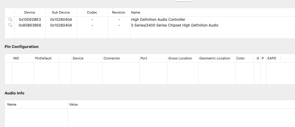

I used Hackintool 3.9.1 to assist with my installation of VoodooHDA.kext 2.9.8 in Big Sur (OC 0.8.7) as described here.  After installation of VoodooHDA.kext 2.9.8 and rebooting my hack, sound is working perfectly with internal laptop speakers.  However, when I attempt to view audio properties (Pin Configuration and Audio info) with Hackintool, audio properties are not displayed.  Hackintool did display audio properties when I was using AppleALC.  Is this intentional?  It's not a problem for me - just curious.
Hackintool 3.9.1 audio properties when using VoodooHDA.kext
Spoiler

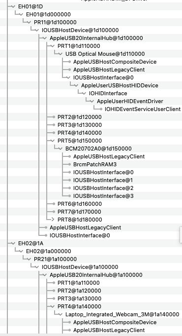

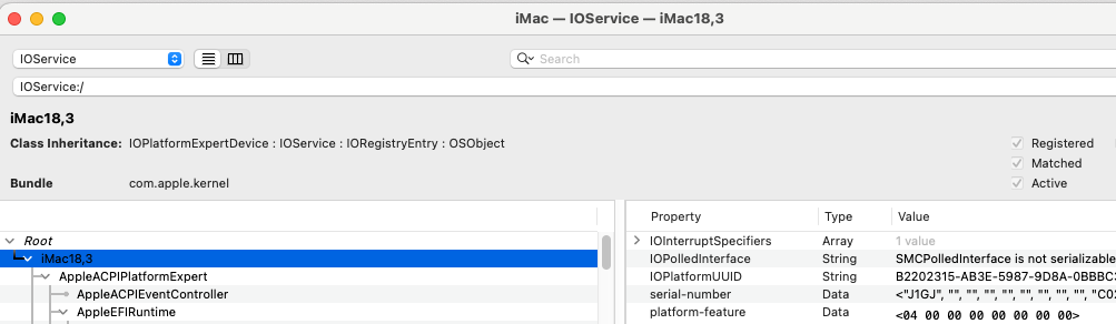

Hi @deeveedee I can suspect that the IORegistry is not created the same way when VoodooHDA is used thus Hackintool may not detect the right branches or devices etc. But as you say, I am also curious to know, if it was ever attempted to code it to detect VoodooHDA (not used as much as AppleALC I guess?)
Why don't you post a screenshot of your IORegistry Explorer or better, a sanitised export of IORegistryExplorer (without S/Ns if possible?) so that @headkaze can comment?  (just a tip ;) )
  Reveal hidden contents
I already reported to @headkaze that Hackintool will not see VoodooHDA.
  • Thanks 2
I've never thought about sanitizing my posted IORegistry Explorer dumps before.  Where in IORegistry Explorer dumps do the S/Ns appear?  Thanks!
@Slice and @MacKonsti - I've never thought to sanitize my IOReg dump before posting.  Is there an easy way to remove the private parameters without corrupting the file?

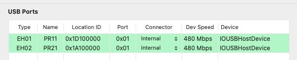

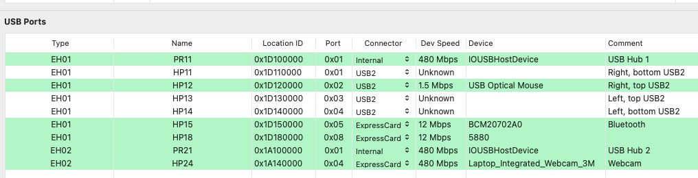

When running macOS Ventura on my HackBookPro6,2, Hackintool shows only my USB Hubs (no child ports) when first clicking the USB tab.
Only USB Hubs visible when first clicking USB Tab
Spoiler
Clicking the Inject button shows the child ports for each hub
Inject Button
Spoiler
After clicking Inject Button, all child USB ports are visible (not just Hubs)
Spoiler
In previous versions of macOS (Monterey and earlier), Hackintool's USB tab shows hubs and child ports when the USB tab is first clicked (no need to click the Inject button to show the child ports).

Does it have USB 3.0 super speed port, or they are just High speed?
Are you asking about my 2010 Dell Latitude E6410?  If so, the ports are USB 2.0.  But you made me look it up - I see that USB 3.0 was released in 2008, so it looks like Dell decided not to adopt the USB 3.0 standard for my laptop.
