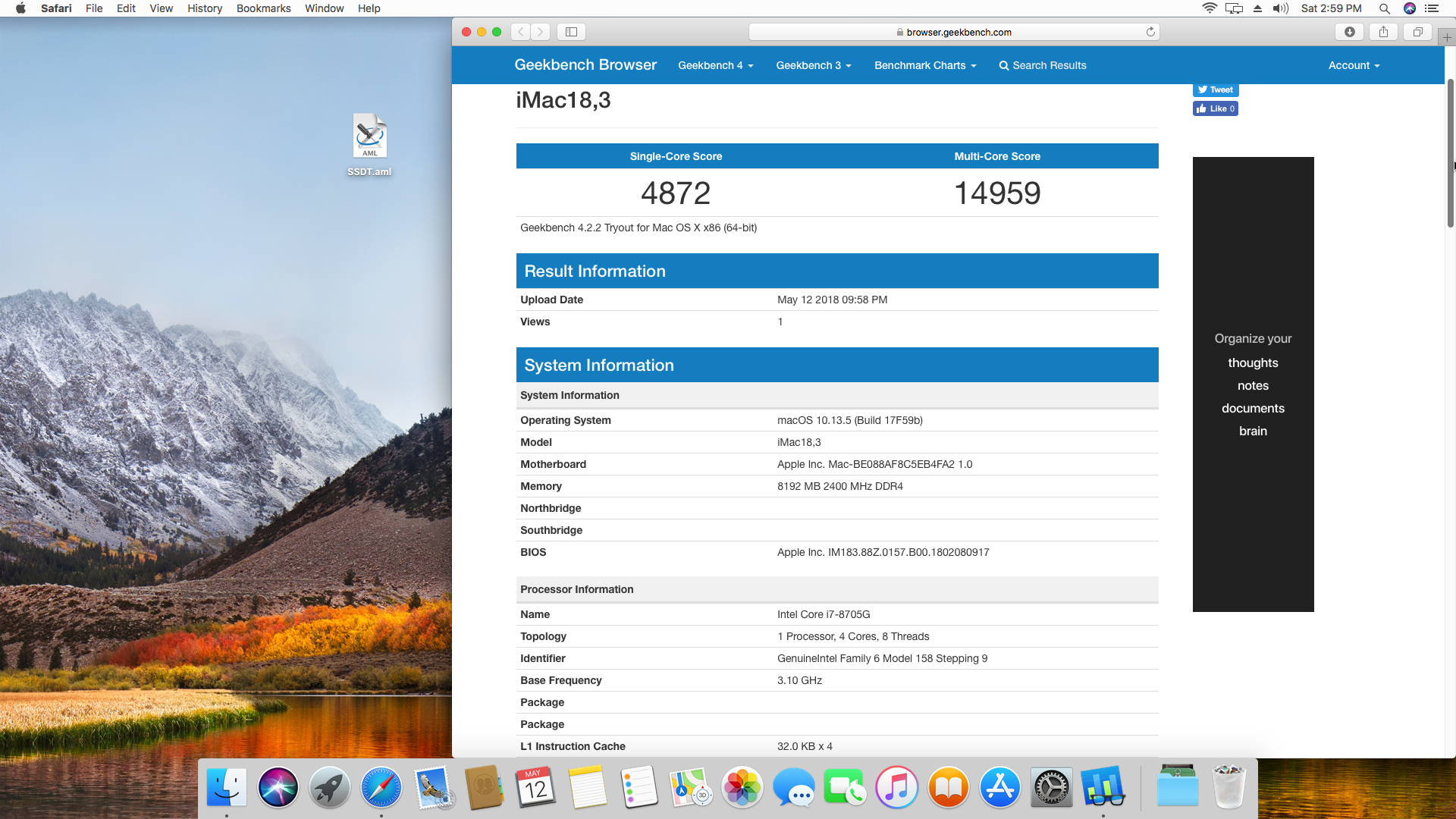

Gigamaxx Posted May 10, 2018 Share Posted May 10, 2018 On 3/29/2018 at 1:56 PM, WarDoc said: So is anyone planning on getting this to Hack it as its the perfect mix of intel and amd in the perfect size https://www.pcworld.com/article/3267074/computers/intel-hades-canyon-nuc-nuc8i7hvk-review.html I picked one up last night and tested. The graphics are not native in HS 13.5 beta 3 and I added real ID to all the vega kexts but no go. Display 7mb. ATI ID 0x694E1002 Intel CPUID 0x0906E9. I used ig platform ID and got HD 630 listed but no VRAM allocation. I will test further this weekend. 1 Link to comment https://www.insanelymac.com/forum/topic/333557-intel-hades-canyon-nuc-nuc8i7hvk/#findComment-2613092 Share on other sites More sharing options...

Gigamaxx Posted May 13, 2018 Share Posted May 13, 2018 (edited) 23 hours ago, Allan said: My dreams are gone... Mine too! So far no luck and about the same performance as the AMD Ryzen 2200g and 2400g models. Vega kexts have 0x69AO and 69AF but using fake ID doesn't take either. Edited May 13, 2018 by Gigamaxx 1 Link to comment https://www.insanelymac.com/forum/topic/333557-intel-hades-canyon-nuc-nuc8i7hvk/#findComment-2613449 Share on other sites More sharing options...
