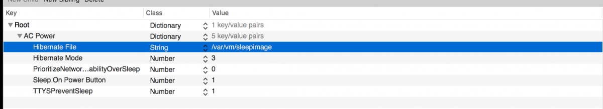

Matthew82 Posted January 19, 2018 Share Posted January 19, 2018 Like in me config. Exempt: nc_spanmodepolicy=1, debug=0x100, keepsym=1 Try tu delete "sleep image" and edit com.apple.PowerManagement.plist Link to comment https://www.insanelymac.com/forum/topic/331658-how-to-build-your-own-imac-pro-successful-buildextended-guide/page/2/#findComment-2572357 Share on other sites More sharing options...

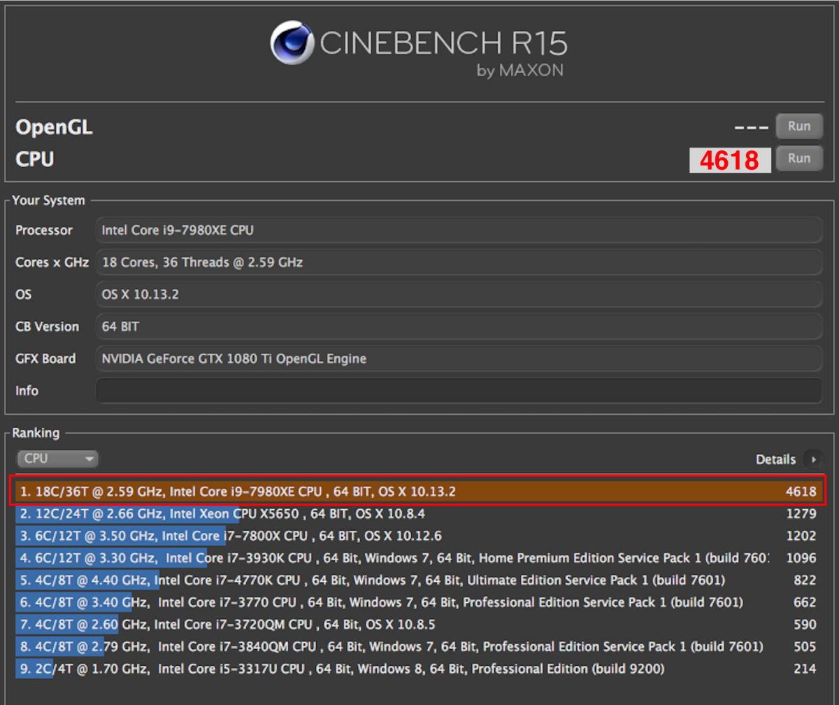

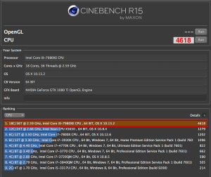

kgp Posted January 19, 2018 Author Share Posted January 19, 2018 Delidded i9-7980XE @4.8GHz (Sync All Cores) Cinebench CPU Benchmark All-Time Single-CPU Record! !! 4.618 !!! max. TEMP: 85 deg C!!!!! @DSM2, world's best delidder 3 Link to comment https://www.insanelymac.com/forum/topic/331658-how-to-build-your-own-imac-pro-successful-buildextended-guide/page/2/#findComment-2572397 Share on other sites More sharing options...

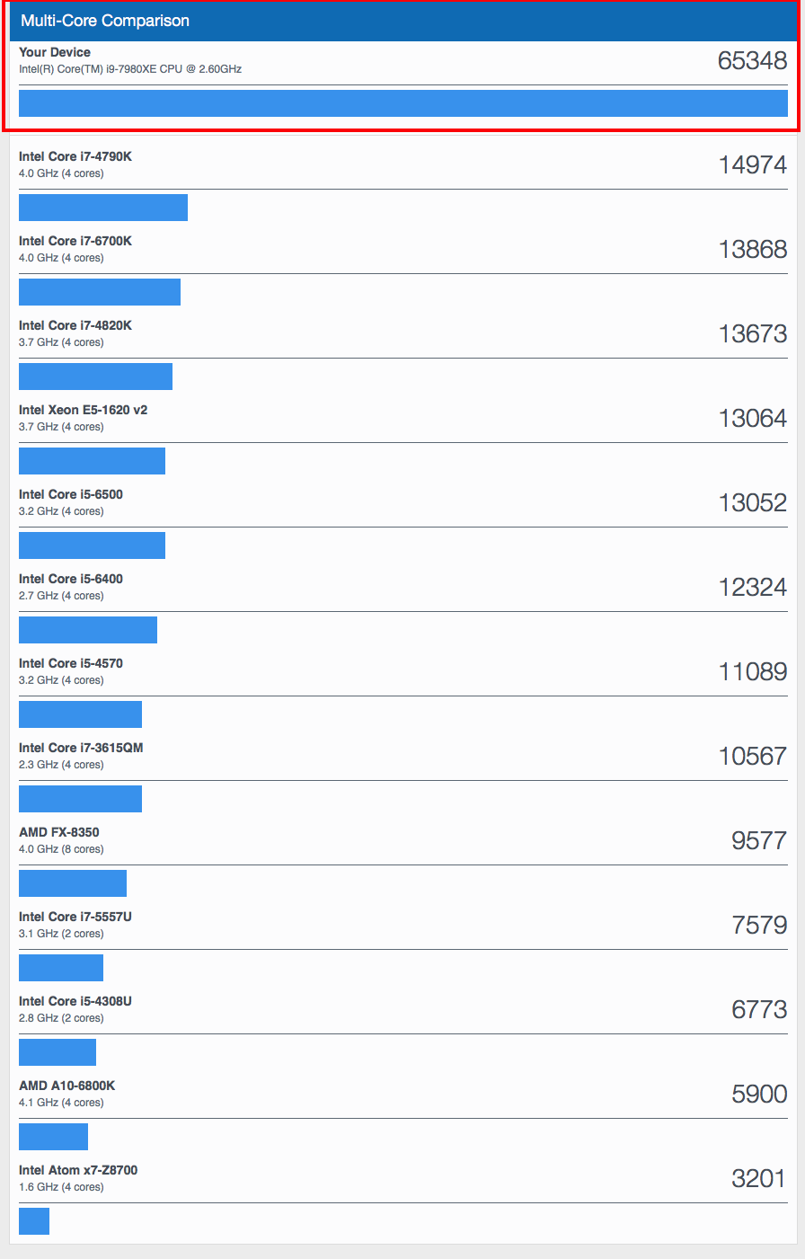

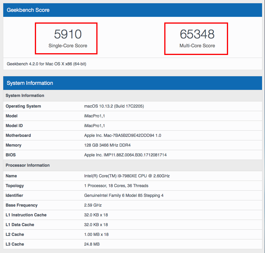

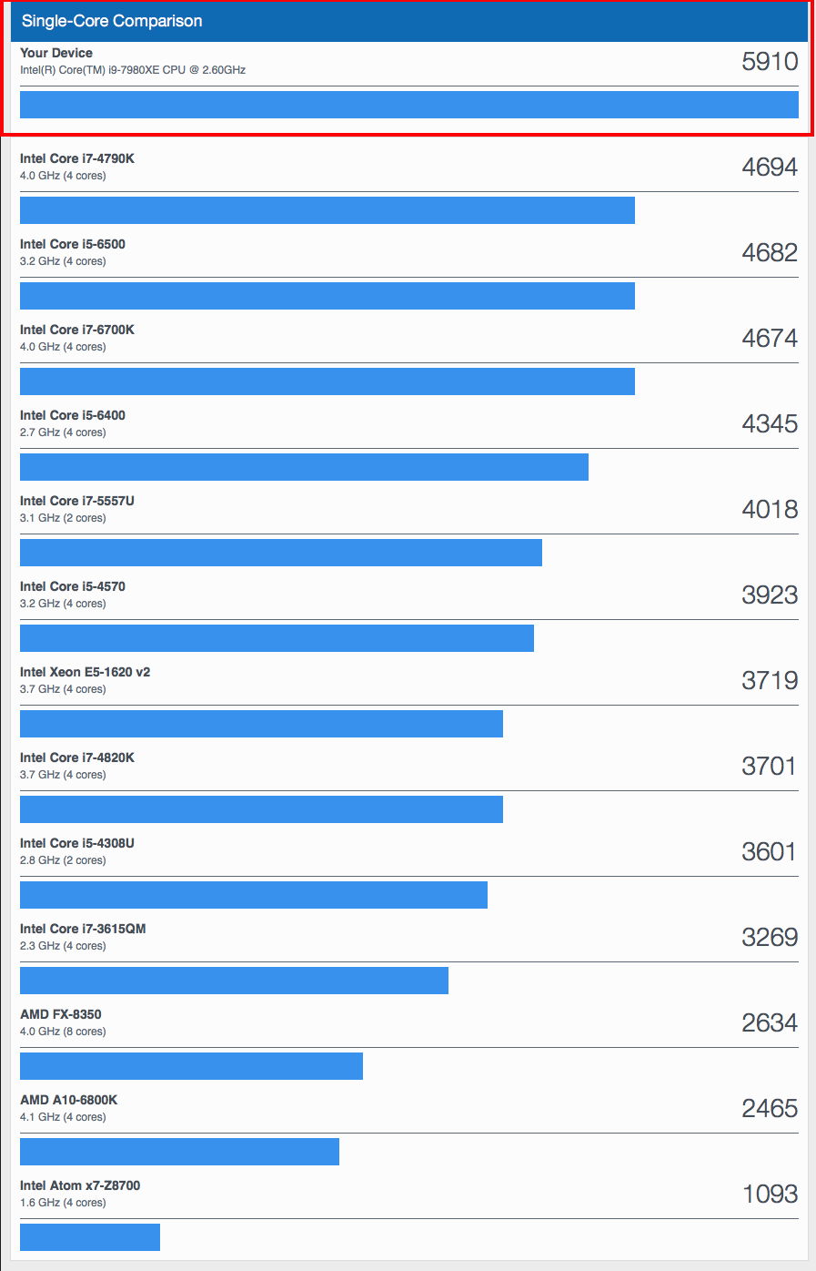

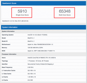

kgp Posted January 20, 2018 Author Share Posted January 20, 2018 Delidded i9-7980XE @4.8GHz (Sync All Cores) Geekbench CPU Benchmark All-Time Single-CPU Record! Multi-Score: 65.358 / Single Score: 5.910 max. TEMP: 63 deg C!!!!! @DSM2[/uSER], world's best delidder 2 Link to comment https://www.insanelymac.com/forum/topic/331658-how-to-build-your-own-imac-pro-successful-buildextended-guide/page/2/#findComment-2572412 Share on other sites More sharing options...

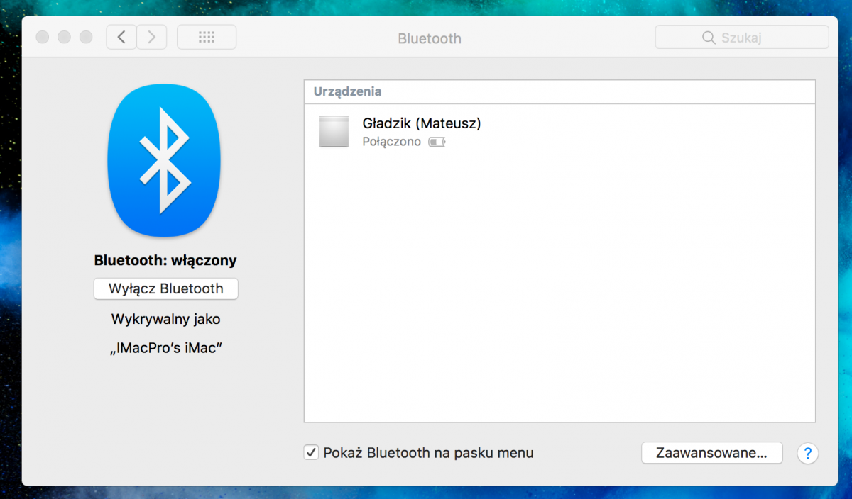

Matthew82 Posted January 20, 2018 Share Posted January 20, 2018 Patch to enable bluetooth ON/OFF for Asus x299 deluxe (Patch insert to FakeSMC) <dict> <key>Broadcom2045FamilyUSBBluetoothHCIController_D</key> <dict> <key>CFBundleIdentifier</key> <string>com.apple.iokit.BroadcomBluetoothHostControllerUSBTransport</string> <key>IOClass</key> <string>BroadcomBluetoothHostControllerUSBTransport</string> <key>IOProviderClass</key> <string>IOUSBHostDevice</string> <key>idProduct</key> <integer>6248</integer> <key>idVendor</key> <integer>2821</integer> </dict> 1 Link to comment https://www.insanelymac.com/forum/topic/331658-how-to-build-your-own-imac-pro-successful-buildextended-guide/page/2/#findComment-2572954 Share on other sites More sharing options...

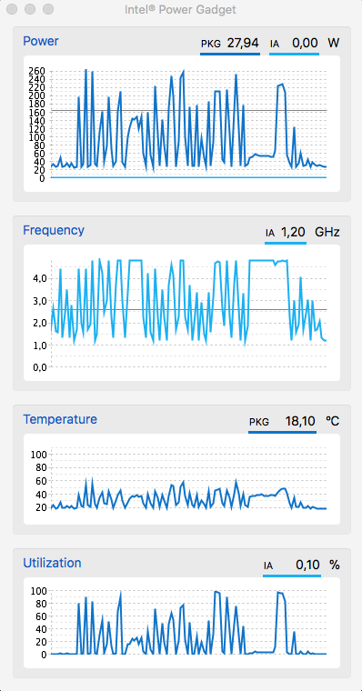

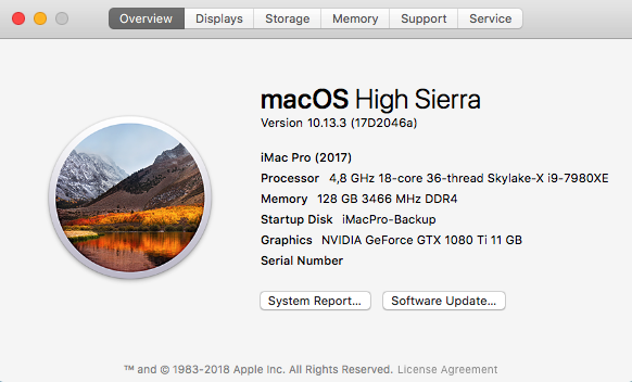

kgp Posted January 21, 2018 Author Share Posted January 21, 2018 Fantastic news my friends! Just installed 10.13.3 public beta 6 (17D2046a) And we have fully native HWP (Intel SpeedShift Technology) Power Management for all Skylake-X Processors, including the i9-7980XE! No XCPM patches, no FakeCPUID, no ssdt.aml! Beautiful and fully native HWP Management for all Skylake-X processors BTW.. The same also states for 10.13.2 SA (17C2205) .. Just made this additional discovery. Now updating EFI-Folder and guide Link to comment https://www.insanelymac.com/forum/topic/331658-how-to-build-your-own-imac-pro-successful-buildextended-guide/page/2/#findComment-2573108 Share on other sites More sharing options...

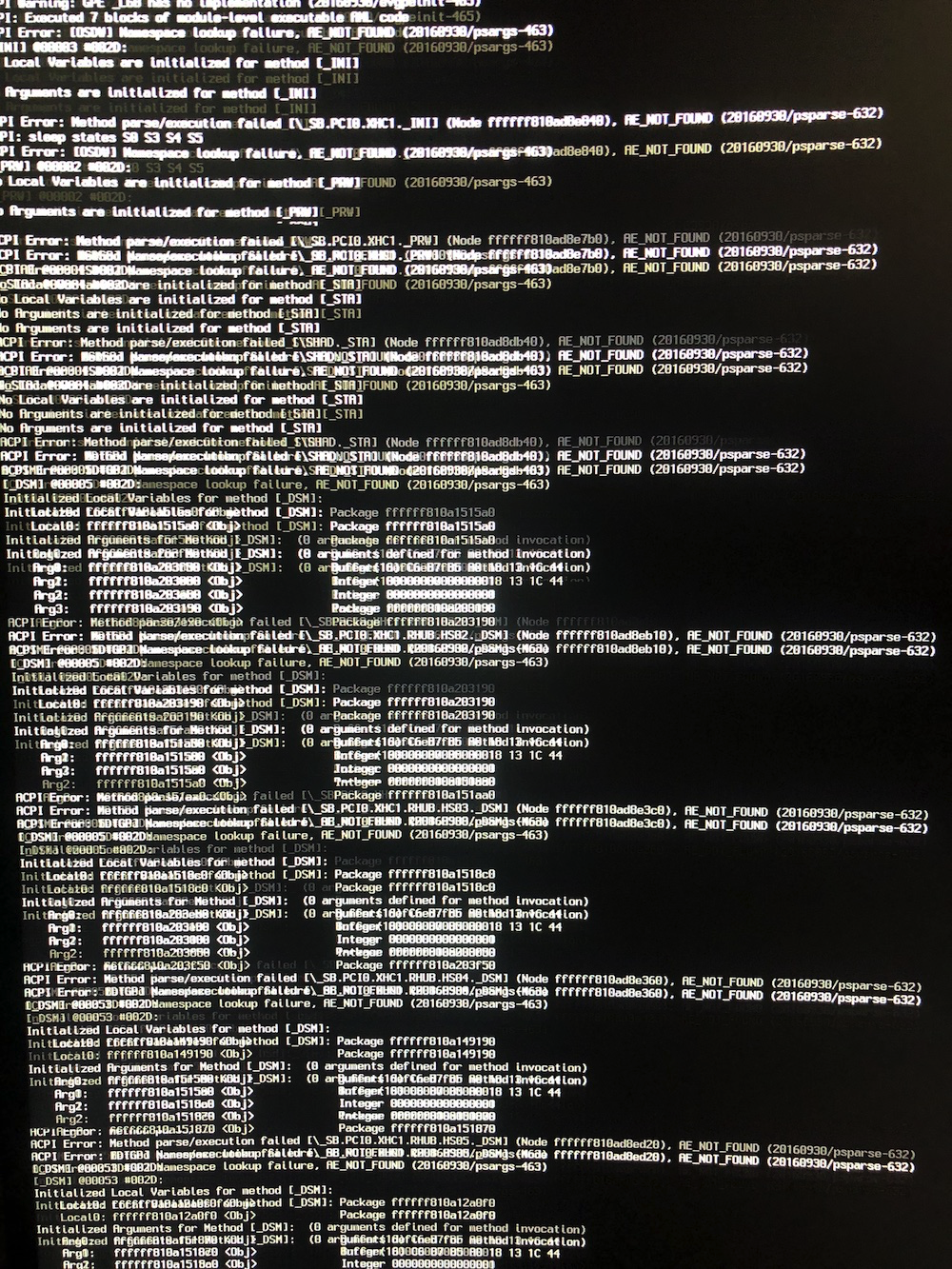

kgp Posted January 21, 2018 Author Share Posted January 21, 2018 Like in me config. Exempt: nc_spanmodepolicy=1, debug=0x100, keepsym=1 Try tu delete "sleep image" and edit com.apple.PowerManagement.plist Zrzut ekranu 2018-01-19 o 22.55.39.png You mean to remove /var/vm/sleepimage? And what should I edit in the in the com.apple.PowerManagement.plist? BTW, where to find the latter plist? Link to comment https://www.insanelymac.com/forum/topic/331658-how-to-build-your-own-imac-pro-successful-buildextended-guide/page/2/#findComment-2573596 Share on other sites More sharing options...
Matthew82 Posted January 21, 2018 Share Posted January 21, 2018 You mean to remove /var/vm/sleepimage? And what should I edit in the in the com.apple.PowerManagement.plist? BTW, where to find the latter plist? I found more elegant solution for sleep problem. Two things: Kernel patch: F: be030000 0031d2e8 72fcffff R: be030000 0031d290 90909090 and ssdt to prevent wake after one second https://drive.google.com/file/d/1Uehw5g1j5l38ktg7NJLOLAKXq-YEe7Ur/view?usp=sharing Link to comment https://www.insanelymac.com/forum/topic/331658-how-to-build-your-own-imac-pro-successful-buildextended-guide/page/2/#findComment-2573635 Share on other sites More sharing options...
kgp Posted January 21, 2018 Author Share Posted January 21, 2018 I found more elegant solution for sleep problem. Two things: Kernel patch: F: be030000 0031d2e8 72fcffff R: be030000 0031d290 90909090 and ssdt to prevent wake after one second https://drive.google.com/file/d/1Uehw5g1j5l38ktg7NJLOLAKXq-YEe7Ur/view?usp=sharing O.K. your KernelToPatch entry seems to help to some extent. The system indeed returns from sleep with code 30 but: Malfunction of all RPW Fans on Wake from Sleep... Intel Power Gadget fails to load after Wake from Sleep.. Entire System does not behave as expected after Wake from Sleep.. Cannot check the HWP performance, as IPG fails to load after Wake from Sleep. I also checked the Sleep/Wake functionality without your SSDT-10.aml: Same behaviour as described above.. Your SSDT-10.aml still causes a bunch of ACPI errors during boot (see attachment). Sorry for the bad image quality but the error messages scroll extremely fast ... and that's just a snapshot of some of ell error messages apparent during boot. In any case, I hope that the snap shot might partly help in improving your approach. Link to comment https://www.insanelymac.com/forum/topic/331658-how-to-build-your-own-imac-pro-successful-buildextended-guide/page/2/#findComment-2573657 Share on other sites More sharing options...
kgp Posted January 22, 2018 Author Share Posted January 22, 2018 I found more elegant solution for sleep problem. Two things: Kernel patch: F: be030000 0031d2e8 72fcffff R: be030000 0031d290 90909090 and ssdt to prevent wake after one second https://drive.google.com/file/d/1Uehw5g1j5l38ktg7NJLOLAKXq-YEe7Ur/view?usp=sharing Can you implement your ssdt-10.aml into the one attached below. I guess both amls are not harmonised, which leads to the bunch of ACPI errors during boot. SSDT-X299-iMacPro.aml.zip 1 Link to comment https://www.insanelymac.com/forum/topic/331658-how-to-build-your-own-imac-pro-successful-buildextended-guide/page/2/#findComment-2573810 Share on other sites More sharing options...
Matthew82 Posted January 22, 2018 Share Posted January 22, 2018 O.K. your KernelToPatch entry seems to help to some extent. The system indeed returns from sleep with code 30 but: Malfunction of all RPW Fans on Wake from Sleep... Intel Power Gadget fails to load after Wake from Sleep.. Entire System does not behave as expected after Wake from Sleep.. Cannot check the HWP performance, as IPG fails to load after Wake from Sleep. I also checked the Sleep/Wake functionality without your SSDT-10.aml: Same behaviour as described above.. Your SSDT-10.aml still causes a bunch of ACPI errors during boot (see attachment). Sorry for the bad image quality but the error messages scroll extremely fast ... and that's just a snapshot of some of ell error messages apparent during boot. In any case, I hope that the snap shot might partly help in improving your approach. Maybe you have sam mess or differences in your config. I only using ssd for GPU and CPU. I just check "AppleIntelInfo" before and after sleep and score are identical. Power Gedget working after sleep and benchmark are similar. Can you implement your ssdt-10.aml into the one attached below. I guess both amls are not harmonised, which leads to the bunch of ACPI errors during boot. I thing you have great skills and you can handle. an h Link to comment https://www.insanelymac.com/forum/topic/331658-how-to-build-your-own-imac-pro-successful-buildextended-guide/page/2/#findComment-2573818 Share on other sites More sharing options...
