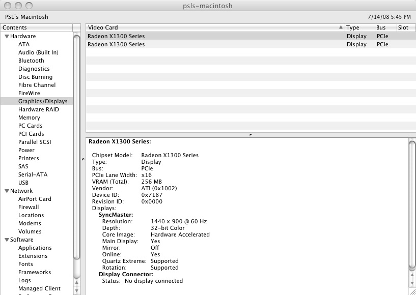

Hi,
Thank you for some really brilliant work! We all appreciate it, and I hope that I can contribute with something in the future =)
Here's the deal:
I have a working system that I use mostly for audio work (migration from windoze), and I have two x1300 PCIe cards installed (One DVI and one VGA on each card). I can't seem to get more that one monitor working (I have only had this machine three days. first attempt).
You can see from the attached pictures that OSX finds both cards, but haven't initialized the display for the second one (one monitor connected on the DVI port). I'm not sure if this is possible, but if it is I guess I have to edit one of the kexts or plist files, and this is where my knowledge lacks...
If you have a clue on how to make this work, I'm really thankful...
