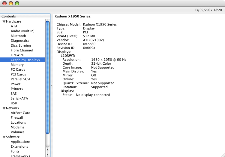

Hi, firstly I'd like to say thanks for all the good work going on here.
I've used all of the current Natit kexts found within the original post of the thread with my card:
Sapphire Radeon X1950 Pro 512Mb Dual DVI AGP
The card is recognised and I can get full resolution (1680x1050) through DVI with rotation but no QE/CI. I've added the card's device id (0x72801002) to the ATIRadeonX1000.kext so I'm not really sure where to go from here. If I remove Natit then I get QE/CI but I'm stuck at 1024x768 with mouse tearing and no rotation.
I appreciate that this post may not get answered, but if some could assist then I'd be extremely grateful.

Anyone have any luck with a PCIe 512MB X1650 Shappire Graphic Card?
Installed Jas OSX but only get Slow graphic redraw and 256MB instead of 512MB...
Anyone is cureently using this Sapphire Card or could send me the Correct
Ati Drivers?
Thanks Any help apprecciated!!!
