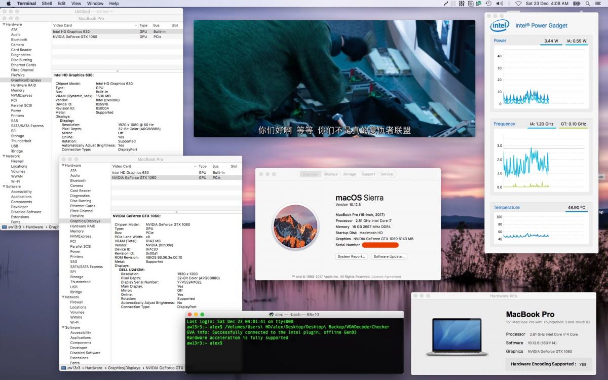

pure.wisdom Posted December 22, 2017 Share Posted December 22, 2017 @pure.wisdom With your help, I got Apple Hardware Video Acceleration working on aw13r3. As for aw15, it did not work despite passing VDADecoderChecker test, I think is because the Intel IGPU was not turn on properly (G-SYNC feature most likely ). I will try manual IGPU injection later when I know how. I am grateful to you for your help, never learned so much before in such a short time. Thanks You ! install shiki and add boot flag shikigva=60 1 Link to comment https://www.insanelymac.com/forum/topic/327089-alienware-15-r3-on-os-x-10126/page/2/#findComment-2554784 Share on other sites More sharing options...

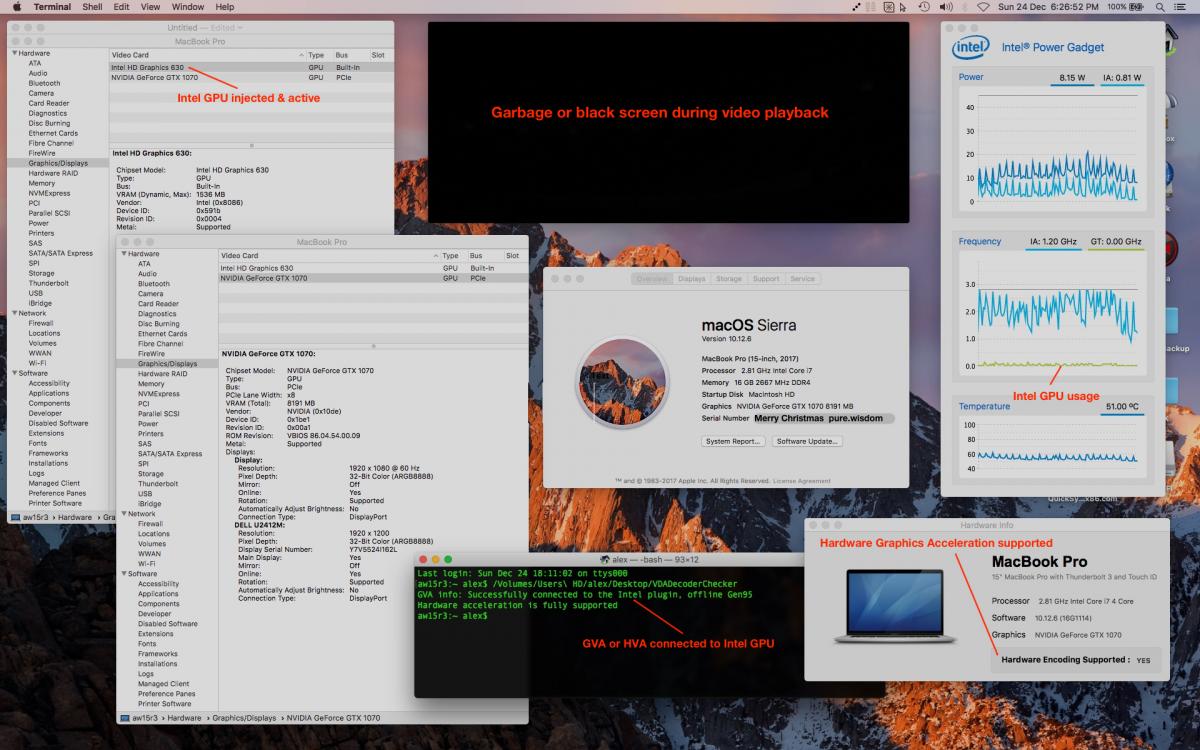

rongu Posted December 22, 2017 Author Share Posted December 22, 2017 install shiki and add boot flag shikigva=60 Hmm I did that, aw15r3 will show Hardware Video Acceleration = Supported, but it will not work when decoding video at least in iTunes. 1 Link to comment https://www.insanelymac.com/forum/topic/327089-alienware-15-r3-on-os-x-10126/page/2/#findComment-2554811 Share on other sites More sharing options...
pure.wisdom Posted December 22, 2017 Share Posted December 22, 2017 Hmm I did that, aw15r3 will show Hardware Video Acceleration = Supported, but it will not work when decoding video at least in iTunes. Try injection igpu 1 Link to comment https://www.insanelymac.com/forum/topic/327089-alienware-15-r3-on-os-x-10126/page/2/#findComment-2554835 Share on other sites More sharing options...
rongu Posted December 22, 2017 Author Share Posted December 22, 2017 Try injection igpu Did tried that on aw15 but no good result. aw13r3, decoding with Hardware Video Acceleration is working Thanks pure.wisdom 1 Link to comment https://www.insanelymac.com/forum/topic/327089-alienware-15-r3-on-os-x-10126/page/2/#findComment-2554903 Share on other sites More sharing options...
pure.wisdom Posted December 22, 2017 Share Posted December 22, 2017 Did tried that on aw15 but no good result. aw13, so far the decoding of Hardware Video Acceleration is working Thanks pure.wisdom ) you're welcome 1 Link to comment https://www.insanelymac.com/forum/topic/327089-alienware-15-r3-on-os-x-10126/page/2/#findComment-2554954 Share on other sites More sharing options...
rongu Posted December 24, 2017 Author Share Posted December 24, 2017 @pure.wisdom aw15r3 with HVA activated ... 1 Link to comment https://www.insanelymac.com/forum/topic/327089-alienware-15-r3-on-os-x-10126/page/2/#findComment-2555978 Share on other sites More sharing options...
pure.wisdom Posted December 24, 2017 Share Posted December 24, 2017 @pure.wisdom aw15r3 with HVA activated ... Nice . 1 Link to comment https://www.insanelymac.com/forum/topic/327089-alienware-15-r3-on-os-x-10126/page/2/#findComment-2556149 Share on other sites More sharing options...
rongu Posted December 24, 2017 Author Share Posted December 24, 2017 Nice . Is your HDMI audio working (via intel or nvidia)? 1 Link to comment https://www.insanelymac.com/forum/topic/327089-alienware-15-r3-on-os-x-10126/page/2/#findComment-2556166 Share on other sites More sharing options...
pure.wisdom Posted December 24, 2017 Share Posted December 24, 2017 Is your HDMI audio working (via intel or nvidia)? I don't have external monitor, I will try it next time. I see your laptop still depend on Intel igpu in VDADecoderChecker's report. 1 Link to comment https://www.insanelymac.com/forum/topic/327089-alienware-15-r3-on-os-x-10126/page/2/#findComment-2556176 Share on other sites More sharing options...
rongu Posted December 24, 2017 Author Share Posted December 24, 2017 I don't have external monitor, I will try it next time. I see your laptop still depend on Intel igpu in VDADecoderChecker's report. Yes, was trying to get it to work on Intel, hoping to make use of it since it there. Nvidia work without issues 1 Link to comment https://www.insanelymac.com/forum/topic/327089-alienware-15-r3-on-os-x-10126/page/2/#findComment-2556185 Share on other sites More sharing options...

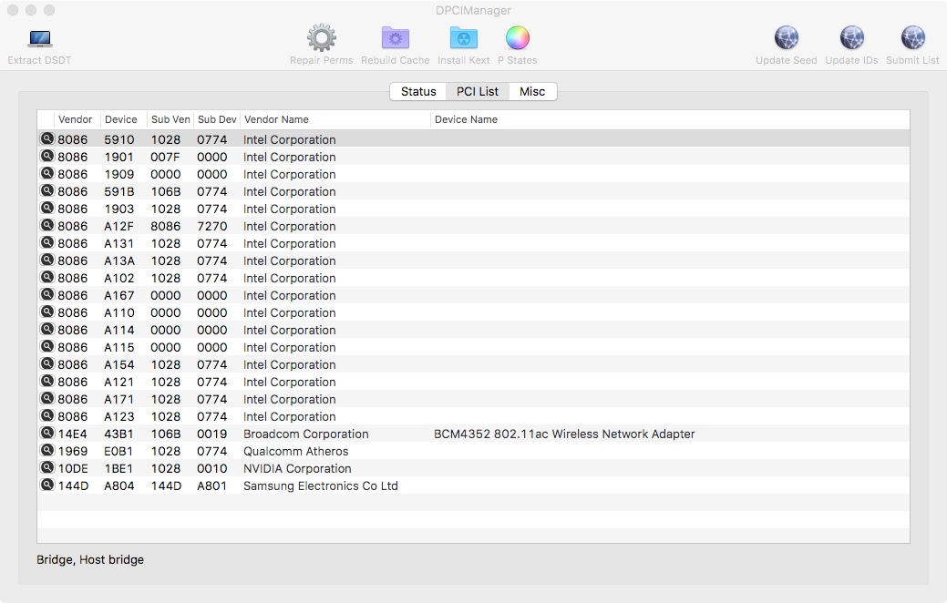

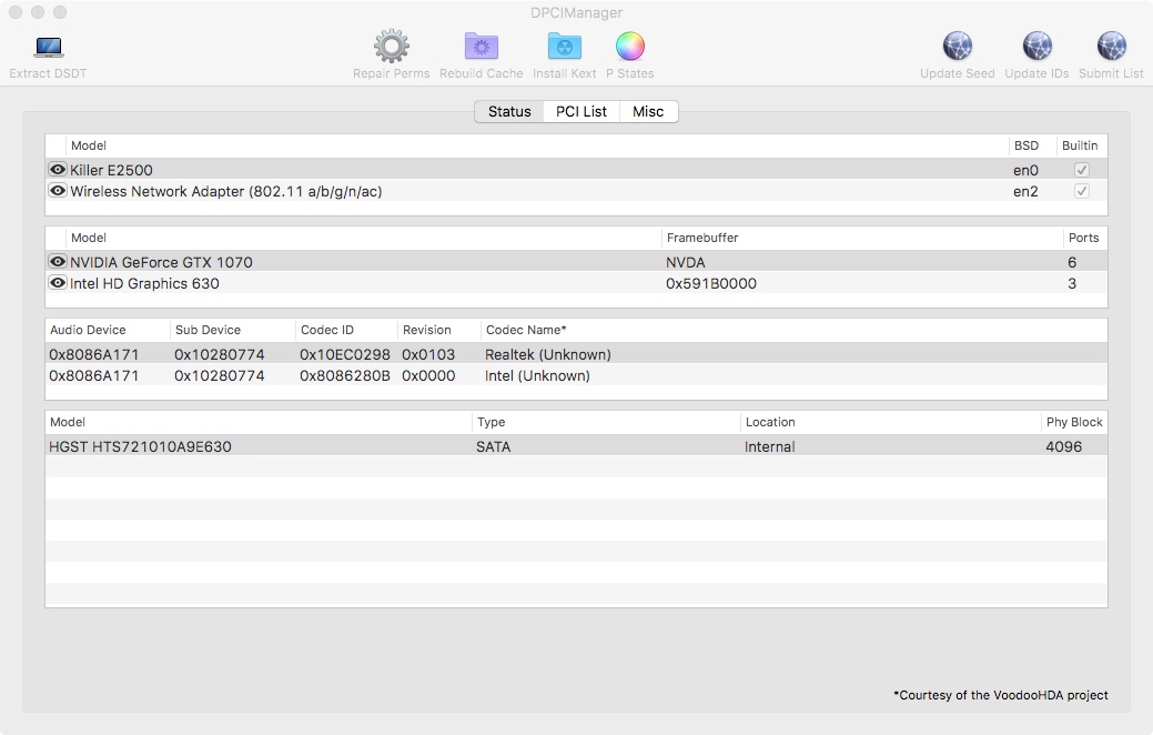

foskvs Posted January 10, 2018 Share Posted January 10, 2018 To have the definitive answer, you can download DPCIManager and take a screenshot at Status and PCI List pages. You can find DPCIManager by clicking the link in my signature (or on the web). 1 Link to comment https://www.insanelymac.com/forum/topic/327089-alienware-15-r3-on-os-x-10126/page/2/#findComment-2566309 Share on other sites More sharing options...
rongu Posted January 10, 2018 Author Share Posted January 10, 2018 HDMI auido is managed by Intel Thanks ! one question, for Alienware 15 R3 G-Sync model where the video output (LCD Panel/HDMI/Mini Display Ports) are physically connected to the output of the discrete Nvidia GPU, bypassing the Intel GPU totally will have no hope using HDMI audio, correct ? To have the definitive answer, you can download DPCIManager and take a screenshot at Status and PCI List pages. You can find DPCIManager by clicking the link in my signature (or on the web). Attached are the snapshots of DPCIManager output from aw15GS. I will upload aw13 series when is offline. Thanks ! Link to comment https://www.insanelymac.com/forum/topic/327089-alienware-15-r3-on-os-x-10126/page/2/#findComment-2566339 Share on other sites More sharing options...
foskvs Posted January 10, 2018 Share Posted January 10, 2018 On that laptop, there's no Nvidia HDMI Audio device => HDAU is managed by IGPU. 1 Link to comment https://www.insanelymac.com/forum/topic/327089-alienware-15-r3-on-os-x-10126/page/2/#findComment-2566357 Share on other sites More sharing options...
