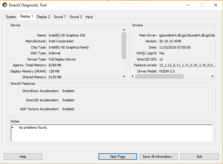

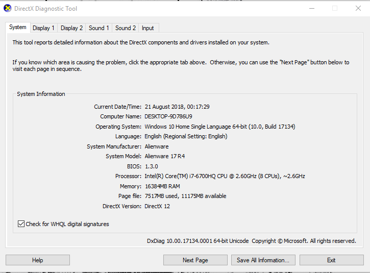

vuong.nc0411 Posted August 20, 2018 Share Posted August 20, 2018 46 minutes ago, xela said: Try this clover folder on your system. CLOVER.zip Thank you so much. Am I supposed to replace my current Clover folder in the EFI with yours? Is there anything I have to do? And btw, this is my dxdiag from windows. Link to comment https://www.insanelymac.com/forum/topic/327089-alienware-15-r3-on-os-x-10126/page/5/#findComment-2630979 Share on other sites More sharing options...
rongu Posted August 20, 2018 Author Share Posted August 20, 2018 43 minutes ago, vuong.nc0411 said: Thank you so much. Am I supposed to replace my current Clover folder in the EFI with yours? Is there anything I have to do? And btw, this is my dxdiag from windows. Yes, replace your clover folder but make a backup of your copy first. diagdx -> save all information will be more useful Link to comment https://www.insanelymac.com/forum/topic/327089-alienware-15-r3-on-os-x-10126/page/5/#findComment-2630987 Share on other sites More sharing options...
vuong.nc0411 Posted August 21, 2018 Share Posted August 21, 2018 7 hours ago, xela said: Yes, replace your clover folder but make a backup of your copy first. diagdx -> save all information will be more useful Sorry. I didn't notice the button. Here is the Dxdiag Info. DxDiag.txt Link to comment https://www.insanelymac.com/forum/topic/327089-alienware-15-r3-on-os-x-10126/page/5/#findComment-2631018 Share on other sites More sharing options...

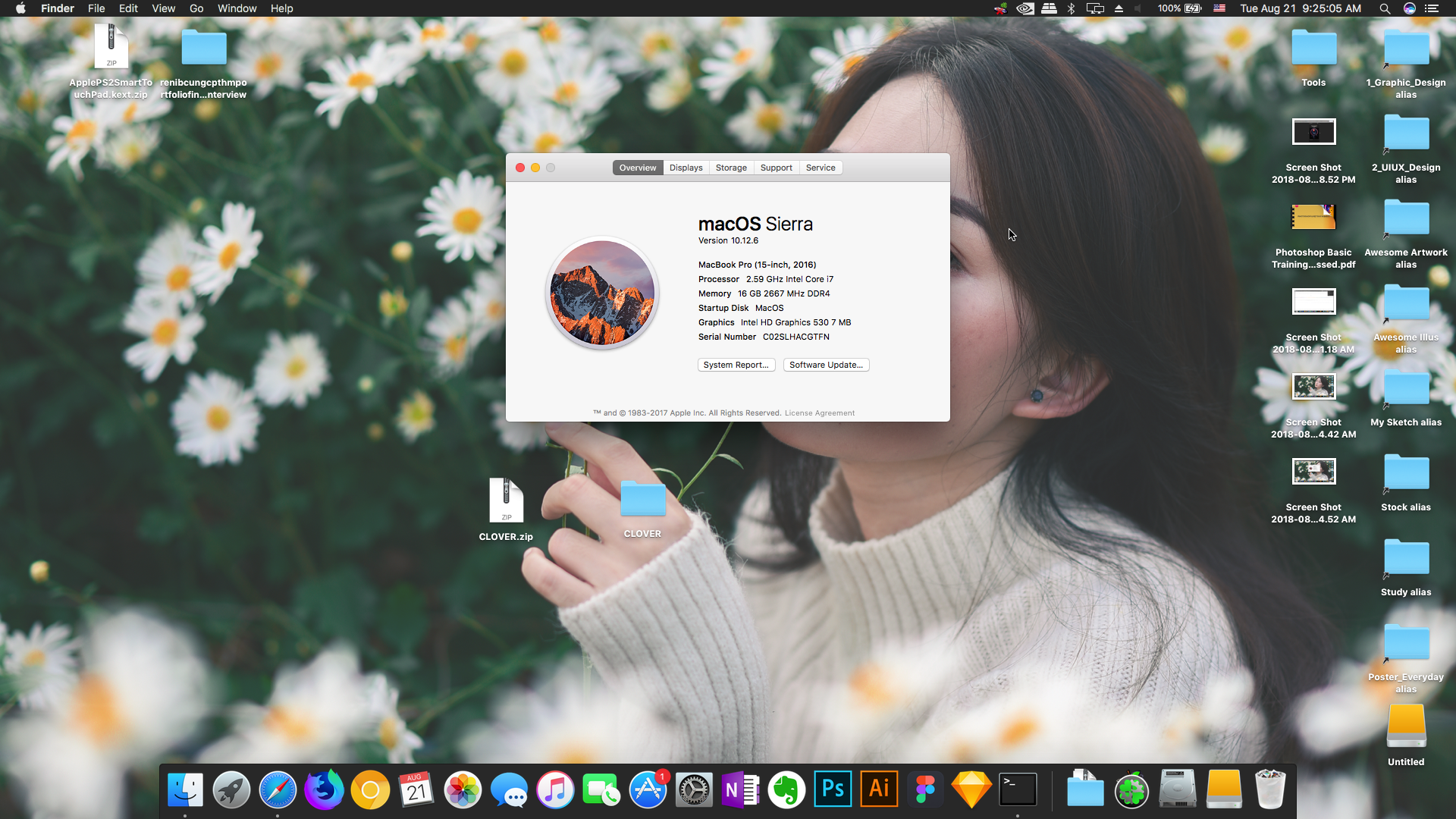

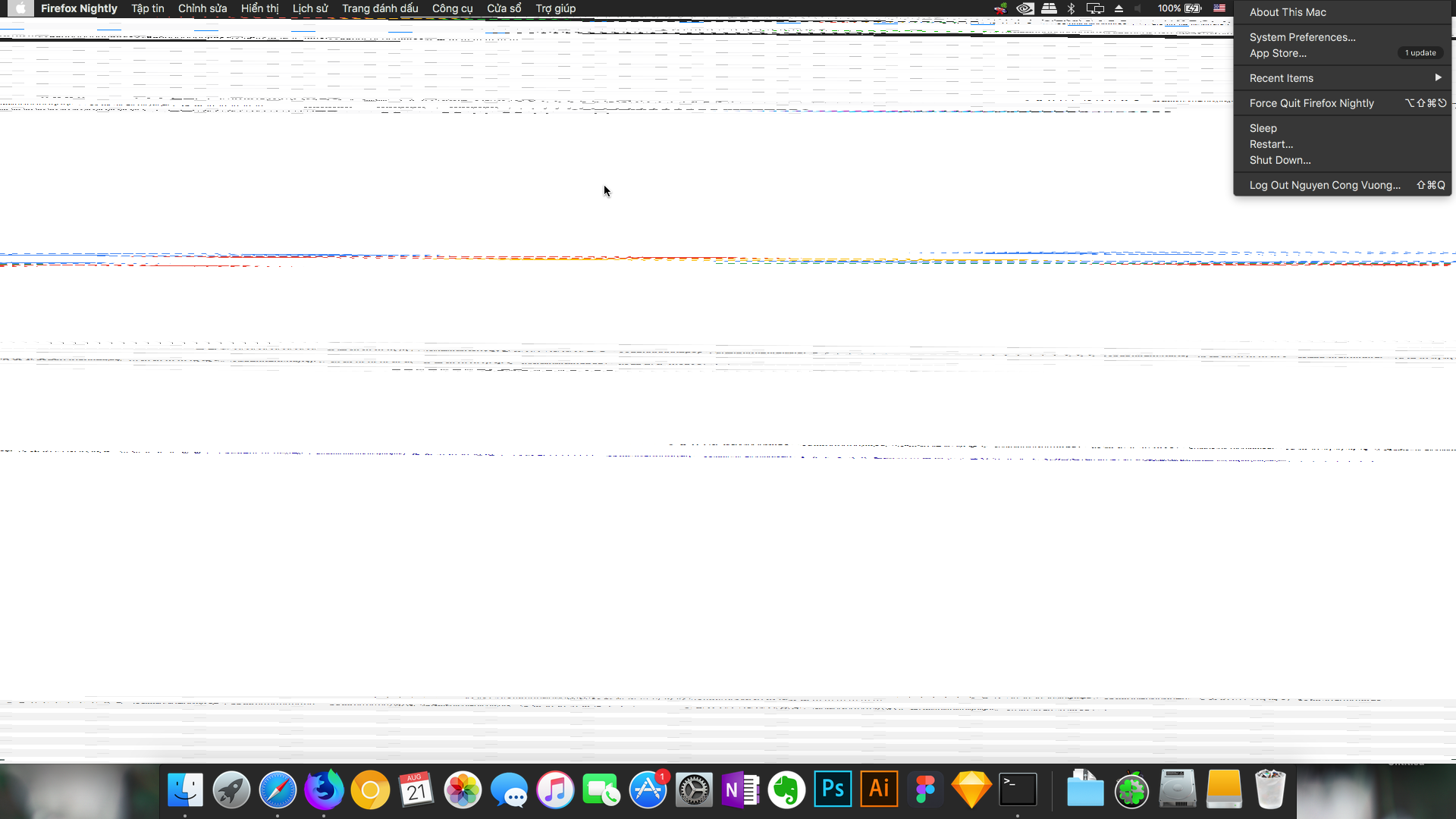

vuong.nc0411 Posted August 21, 2018 Share Posted August 21, 2018 8 hours ago, xela said: Yes, replace your clover folder but make a backup of your copy first. diagdx -> save all information will be more useful Hello xela. Thank you for your help, I have tried to replace the Clover folder but the result was bad. The memory of HD530 was only 7MB and the screen got glitch, the aero effect of dock and taskbar were gone. The sound, HDMI and display port were not working as well. Were there anything else that I had to do but I missed after replace Clover folder? Link to comment https://www.insanelymac.com/forum/topic/327089-alienware-15-r3-on-os-x-10126/page/5/#findComment-2631021 Share on other sites More sharing options...
rongu Posted August 21, 2018 Author Share Posted August 21, 2018 According to your dxdiag, you have intel hd530, try this clover. You're running 10.12.6, I am on 10.13.6 now. It very hard for a newbie in this game even on a desktop let alone laptop which is much harder. The best thing for you right now is to understand your hardware and read as much as possible (https://github.com/RehabMan/OS-X-Clover-Laptop-Config). One step at a time, it can be done. Attach is the Clover folder for your review and install. Again try to understand why those value are there and also learn to adapt and change the value relative to your hardware. So, Happy hacking and post ! CLOVER.zip Link to comment https://www.insanelymac.com/forum/topic/327089-alienware-15-r3-on-os-x-10126/page/5/#findComment-2631043 Share on other sites More sharing options...
vuong.nc0411 Posted August 21, 2018 Share Posted August 21, 2018 37 minutes ago, xela said: According to your dxdiag, you have intel hd530, try this clover. You're running 10.12.6, I am on 10.13.6 now. It very hard for a newbie in this game even on a desktop let alone laptop which is much harder. The best thing for you right now is to understand your hardware and read as much as possible (https://github.com/RehabMan/OS-X-Clover-Laptop-Config). One step at a time, it can be done. Attach is the Clover folder for your review and install. Again try to understand why those value are there and also learn to adapt and change the value relative to your hardware. So, Happy hacking and post ! CLOVER.zip Thank you for your help. really appreciate! Link to comment https://www.insanelymac.com/forum/topic/327089-alienware-15-r3-on-os-x-10126/page/5/#findComment-2631048 Share on other sites More sharing options...

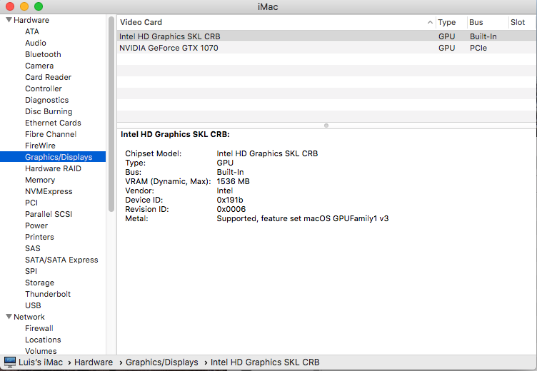

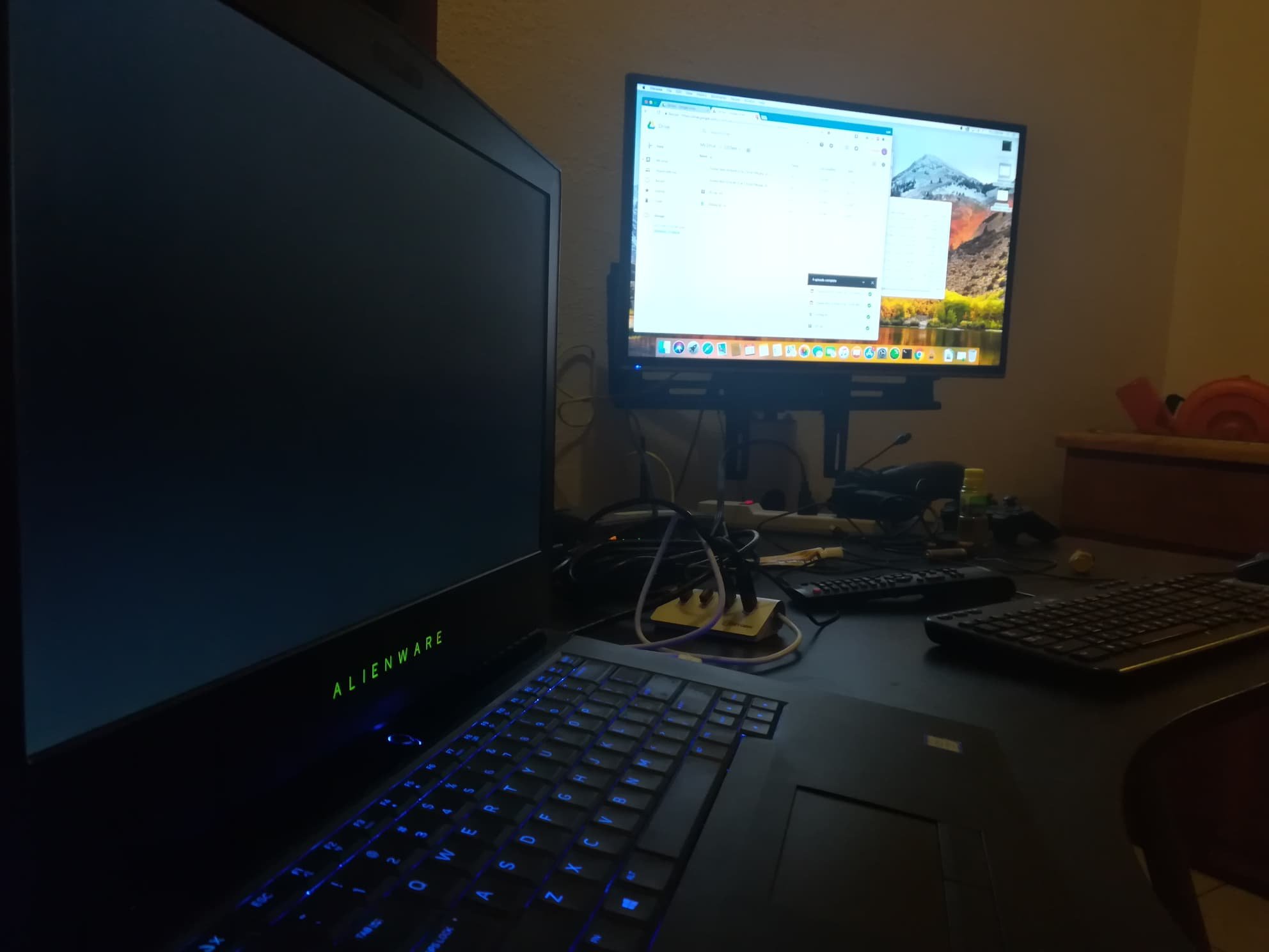

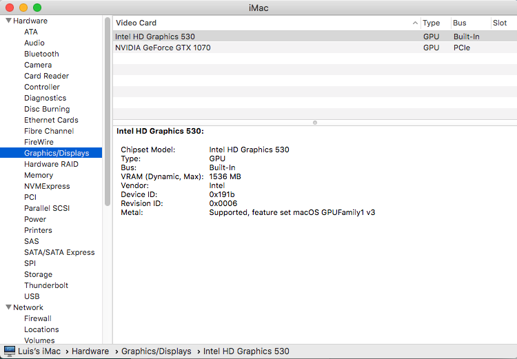

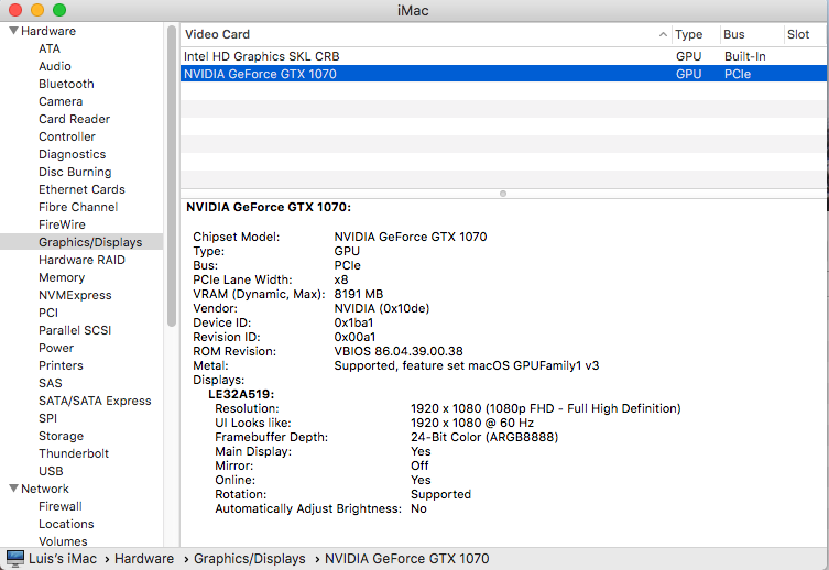

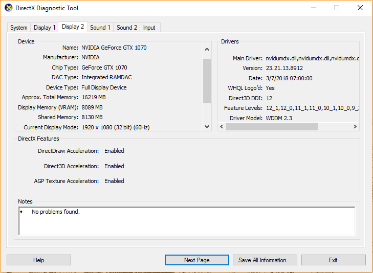

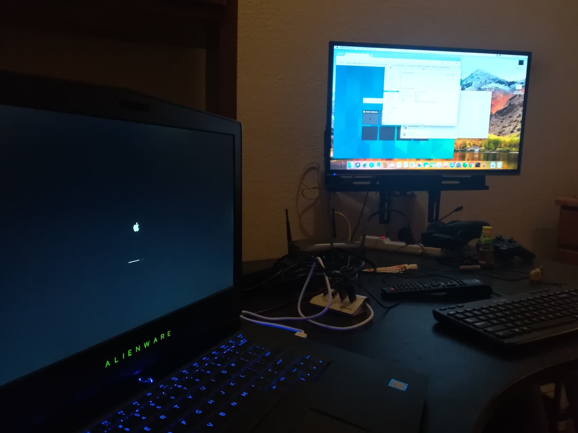

luisrene88 Posted August 24, 2018 Share Posted August 24, 2018 I was able to install and log in on 10.13.6 also Nvidia driver installed, here my progress Integrate screen black after apple logo: after install the system I installed the Nvidia drivers, disable intel graphic and restart, then my screen get black and my surprise was that my external monitor just turned on when detect signal on my HDMI, the Nvidia driver was working also a weird intel driver was loaded, see my attachment. Integrate screen get stuck on apple logo but the system loads on my external monitor, see attach: to reproduce this just enable the inject intel option and restart, my surprise was that the apple logo get stuck but my external monitor doesn't. g-sycn? I was wondering if this could be because my integrate screen is 4k and maybe has g-sycn, honestly I don't know how to confirm this. Loading drivers. Ok I was happy, then I tried to load the kexts files provided by @xela but none of them work, only the ethernet is working and I think is because was installed by [url="http://www.insanelymac.com/forum/topic/279450-why-insanelymac-does-not-support-tonymacx86/"]#####[/url] I added all files in my clover configuration I also included my 'dxdiag' output if someone wants to see my hardware detailed. Alienware 15 R3 GTX 1070 Intel HD 530 4K integrated screen All files and configuration: https://drive.google.com/drive/folders/1joTrqIvSmoTxfhVWVmmxXy0nteBaowt1 Link to comment https://www.insanelymac.com/forum/topic/327089-alienware-15-r3-on-os-x-10126/page/5/#findComment-2631491 Share on other sites More sharing options...
rongu Posted August 24, 2018 Author Share Posted August 24, 2018 (edited) @luisrene88 Have you try CoreDisplayFixup.kext to enable 4K display (https://github.com/PMheart/CoreDisplayFixup/releases)? What is your max display refresh rate in windows ? (120hz = gsync) I reviewed your clover folder but there is almost nothing inside your config.plist. Here is a mod clover folder for your aw15r3, try it and see if it fix your 4K display. CLOVER.zip Edited August 24, 2018 by xela Link to comment https://www.insanelymac.com/forum/topic/327089-alienware-15-r3-on-os-x-10126/page/5/#findComment-2631504 Share on other sites More sharing options...
