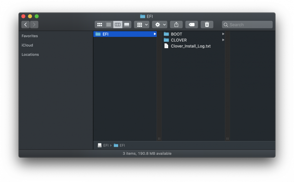

You can use F12 key on the keyboard to use the boot up menu to select a temporary boot option. You don't need to actually change the boot order in the BIOS.
once the system is turned on and when you see the Gigabyte logo press F12 key and you'll see the list of bootable devices and then select the USB Disk the you've already put the EFI folder on and the clover will boot from there and you should be able to boot into macOS Sierra from your HDD/SSD.
If you successfully booted into macOS the you can upgrade your Sierra to High Sierra or you can directly upgrade it from High Sierra Installer USB disk.
The Clover EFI folder should be copied inside the EFI Partition on the USB Disk not in the root partition of the USB Disk.
I hope I explained it more clearly.

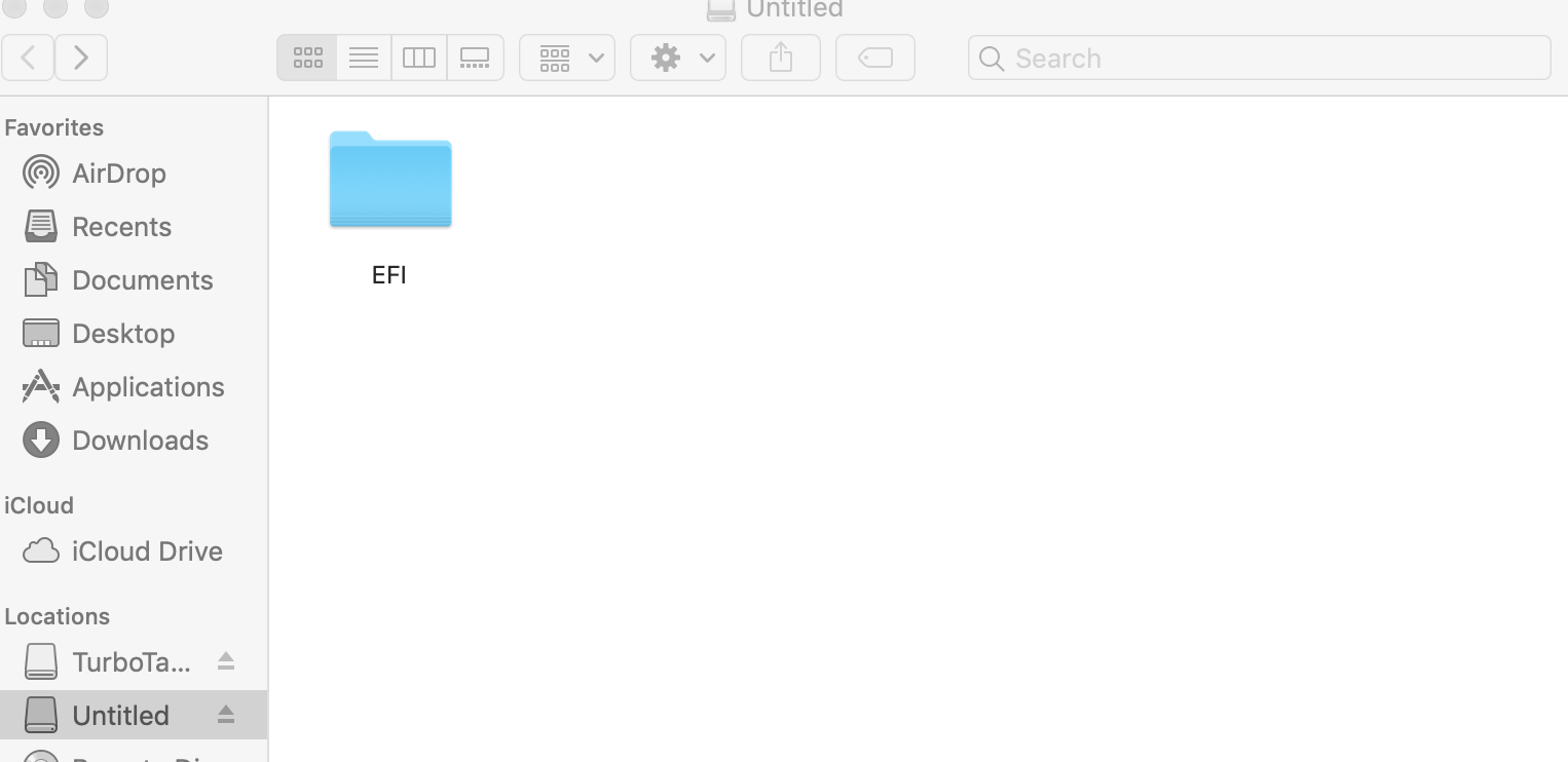

I reformatted USB flash , mac os journaled , guid partition map. copied the EFI folder from the sierra link from first page. changed to boot from USB to option 1.
it goes to clover but only has the bottom row of options, dont see any of the boot os or boot recovery option like before.
thank you. Im not sure if i am doing it correctly
Edited by nitty917

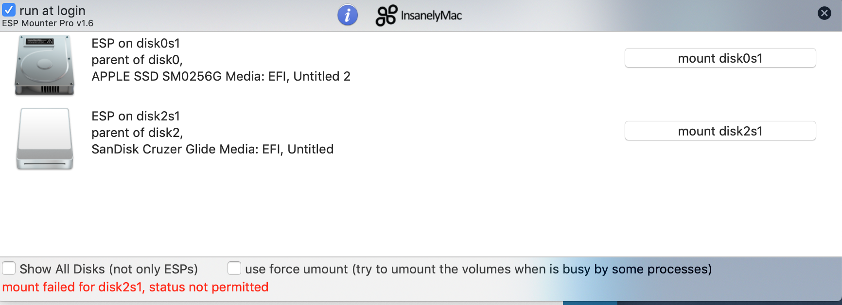

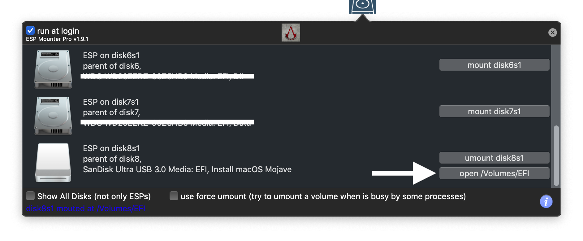

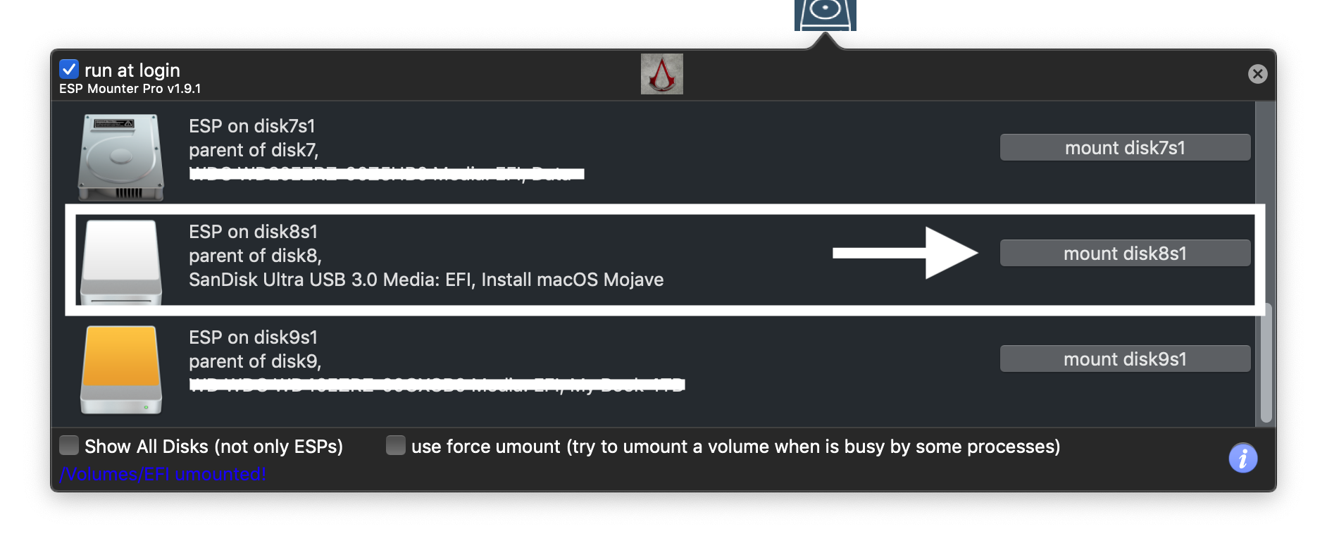

3 minutes ago, Cyberdevs said:
That's because you copied it into the root of the USB Disk, use the ESP Mounter Pro to mount the EFI partition on the USB Disk and put the EFI (Clover) folder inside it and then reboot and use F12 key to select the USB Disk to boot from.
  Reveal hidden contents
Screen Shot 2020-04-19 at 9.59.15 AM.pngScreen Shot 2020-04-19 at 10.01.28 AM.pngScreen Shot 2020-04-19 at 10.01.47 AM.png
ok that makes sense, i will give that a try.
thank you for your patience!
Just now, nitty917 said:
trying the ESP mounter and getting mount failed.
is there another way i can do it
That's weird :wacko:
You can use Clover Configurator to mount the EFI partition or you can user terminal and use "Diskutil list" command to (without quotes) to list the disks and partitions and the use "Diskutil mount disksXsX" to mount the EFI partition on the disk. replace the X with numbers of the disk.
if that failed again reformat the USB Disk.

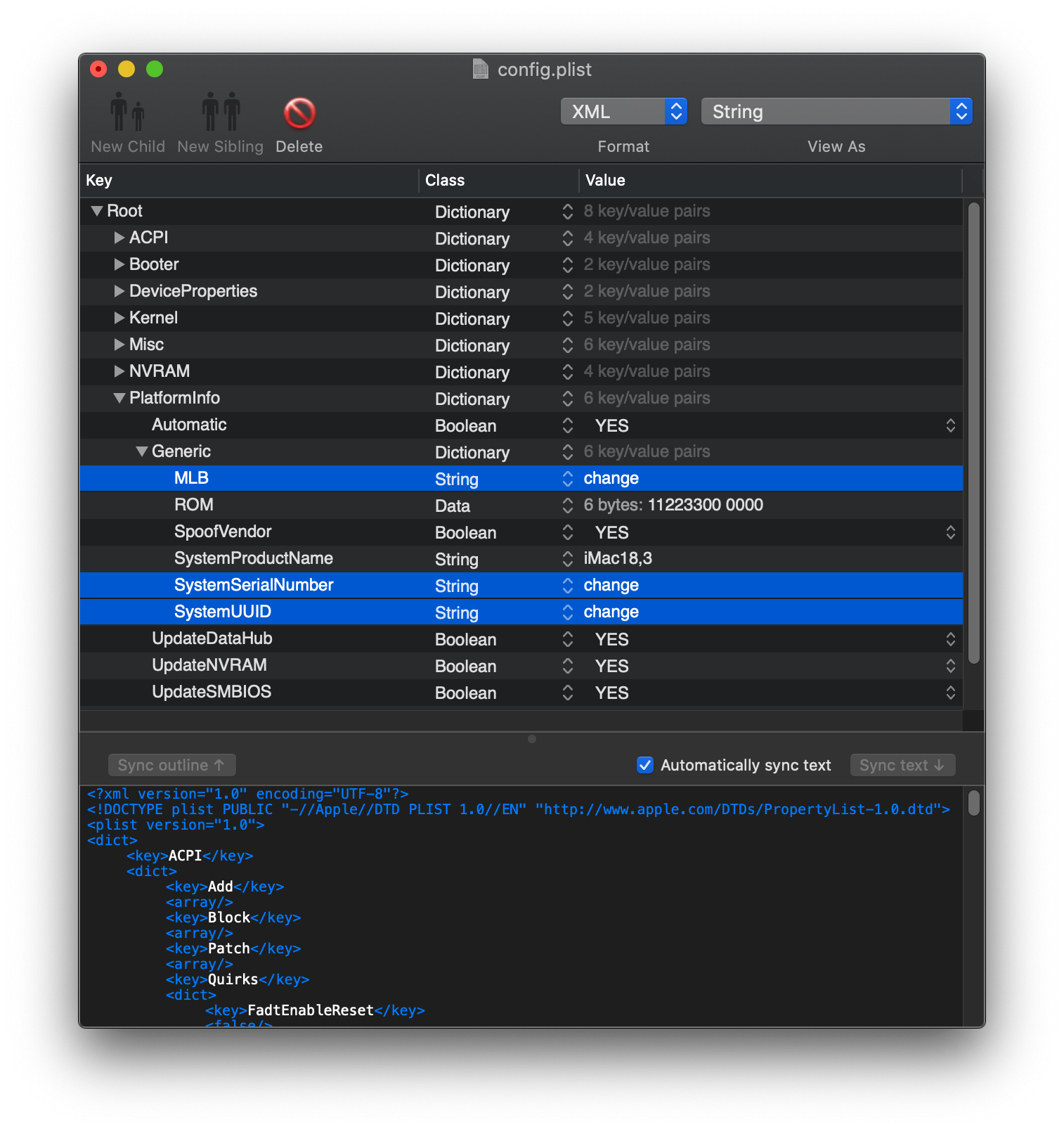

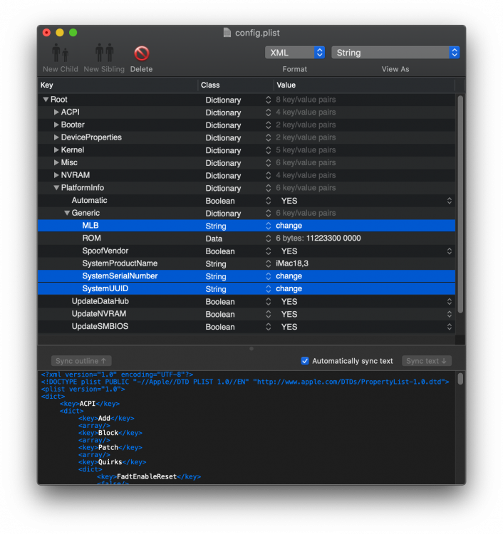

HI, want to share my updated EFI folder for OpenCore 0.5.8 release.
All you need is to change this values in OC/config.plist:
delete "agdpmod=pikera" if you are not using RX 5700 XT or other Navi graphics:
299140493_ScreenShot2020-05-05at03_22_08.thumb.png.71849abd399dcc3b025f6155e3dfd1a0.png
Generate new values:
1494624446_ScreenShot2020-05-05at03_21_57.thumb.png.6f7f7def92bddc5ff30a0cf28a448eb5.png
