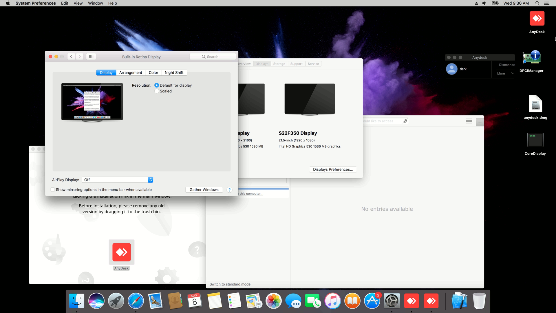

darkbluecode Posted August 7, 2018 Share Posted August 7, 2018 (edited) 16 hours ago, MARZILLO said: aaaarg MR . i fix it !!! now i have retina screen !! i used Nvidia web driver after install uninstall it ! and do patch for kext ! now how can i fix screen back light + touchpad elan 1000 ? now this is my clover CLOVER (37).zip Edited August 8, 2018 by darkbluecode Link to comment https://www.insanelymac.com/forum/topic/323556-installazione-macos-sierra-su-asus-n552vw/page/21/#findComment-2629265 Share on other sites More sharing options...

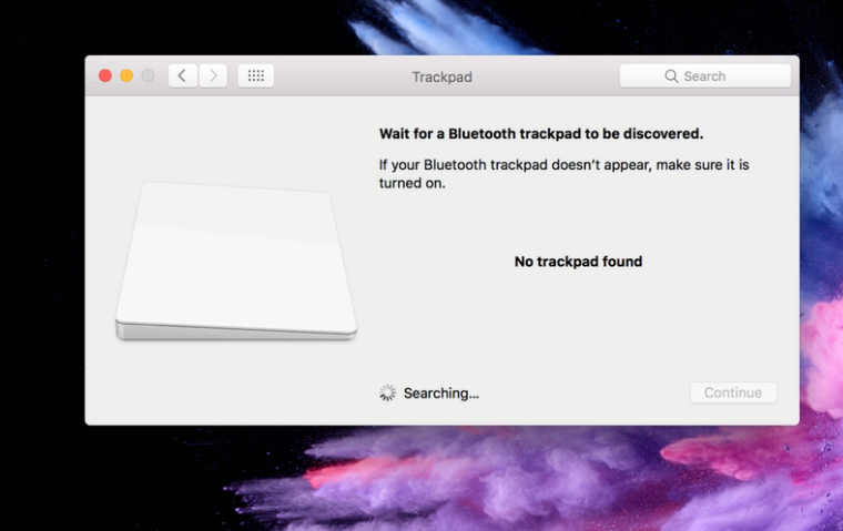

darkbluecode Posted August 10, 2018 Share Posted August 10, 2018 (edited) 10 hours ago, gengik84 said: Per favore, lo ripeto scrivi in italiano... va bene anche se usi google translator metti il dsdt in patched fai ioreg e postalo DSDT.aml.zip excuse me the buttery number now work. touchpad work without my command ! and I can't control touchpad in the setting. for install vooodooi2c Kexts family in S/L/E I deleted AppleIntelLpssL2C.kext and AppleIntelLpssI2CController.kext in S/L/E Scusami il numero burroso ora funziona. il touchpad funziona senza il mio comando! e non riesco a controllare il touchpad nelle impostazioni. per installare la famiglia di vooodooi2c Kexts in S / L / E ho eliminato AppleIntelLpssL2C.kext e AppleIntelLpssI2CController.kext in S / L / E shahram’s MacBook Pro.zip Edited August 10, 2018 by darkbluecode Link to comment https://www.insanelymac.com/forum/topic/323556-installazione-macos-sierra-su-asus-n552vw/page/21/#findComment-2629530 Share on other sites More sharing options...
gengik84 Posted August 10, 2018 Share Posted August 10, 2018 Sostituisci DSDT.aml.zip 1 Link to comment https://www.insanelymac.com/forum/topic/323556-installazione-macos-sierra-su-asus-n552vw/page/21/#findComment-2629533 Share on other sites More sharing options...
darkbluecode Posted August 10, 2018 Share Posted August 10, 2018 10 minutes ago, gengik84 said: Sostituisci DSDT.aml.zip thank you. work so good . but keyboard light doesn't work grazie. funziona così bene ma la luce della tastiera non funziona 1 Link to comment https://www.insanelymac.com/forum/topic/323556-installazione-macos-sierra-su-asus-n552vw/page/21/#findComment-2629534 Share on other sites More sharing options...

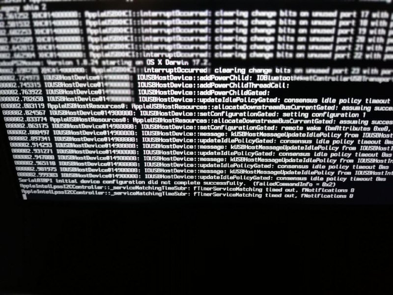

ambose Posted October 8, 2018 Share Posted October 8, 2018 ciao a tutti, sto provando ad installare su un portatile identico, ho provato a seguire piu o meno il 3d ma il sistema non arriva all'installar. Ho caricato la cartella clover di @gengik84 e il relativo file config.plist (le prime postate che hanno consentito di installare). Unica e non sottovalutabile differenza sta nel fatto che sto provando a caricare High Sierra. Si bloccava su: appleintellpass i2c controller Ho aggiunto: VoodooI2C (tutti i kext della famiglia) Continua a bloccarsi anche se non mostra piu il messaggio relativo i2c e va in "still wainting for root" Spero in un aiuto grazie mille Link to comment https://www.insanelymac.com/forum/topic/323556-installazione-macos-sierra-su-asus-n552vw/page/21/#findComment-2639574 Share on other sites More sharing options...
gengik84 Posted October 8, 2018 Share Posted October 8, 2018 hai la patch per port limit sul config? Link to comment https://www.insanelymac.com/forum/topic/323556-installazione-macos-sierra-su-asus-n552vw/page/21/#findComment-2639592 Share on other sites More sharing options...
ambose Posted October 8, 2018 Share Posted October 8, 2018 no, e non so metterla dovrei copiarla da un altro config.plist. oppure sai darmi indicazioni in merito? Comunque siccome sto installando High sierra ho creato un post nuovo nel posto giusto. Link to comment https://www.insanelymac.com/forum/topic/323556-installazione-macos-sierra-su-asus-n552vw/page/21/#findComment-2639594 Share on other sites More sharing options...

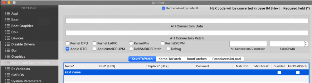

Baio77 Posted October 9, 2018 Share Posted October 9, 2018 (edited) Aggiungi questa patch Sierra 10.12.x: Name*: AppleUSBXHCIPCI Find* [Hex]: 83bd74ff ffff10 Replace* [Hex] : 83bd74ff ffff1b Comment: change 15 port limit to 26 MatchOS: 10.12.x Edited October 9, 2018 by Baio77 Link to comment https://www.insanelymac.com/forum/topic/323556-installazione-macos-sierra-su-asus-n552vw/page/21/#findComment-2639762 Share on other sites More sharing options...
ambose Posted October 9, 2018 Share Posted October 9, 2018 6 minutes ago, Baio77 said: Aggiungi questa patch Sierra 10.12.x: Name*: AppleUSBXHCIPCI Find* [Hex]: 83bd74ff ffff10 Replace* [Hex] : 83bd74ff ffff1b Comment: change 15 port limit to 26 MatchOS: 10.12.x Ti ringrazio, abbiamo proseguito l'installazione su un altro 3d (visto che stavo installando High Sierra) e siamo riusciti ad installare e a far funzionare praticamente tutto Link to comment https://www.insanelymac.com/forum/topic/323556-installazione-macos-sierra-su-asus-n552vw/page/21/#findComment-2639764 Share on other sites More sharing options...
