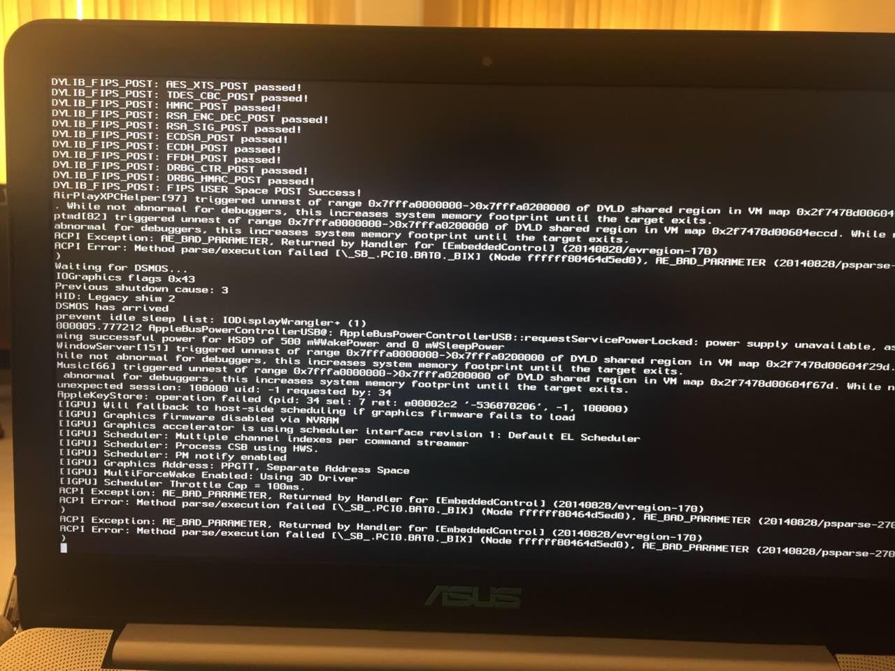

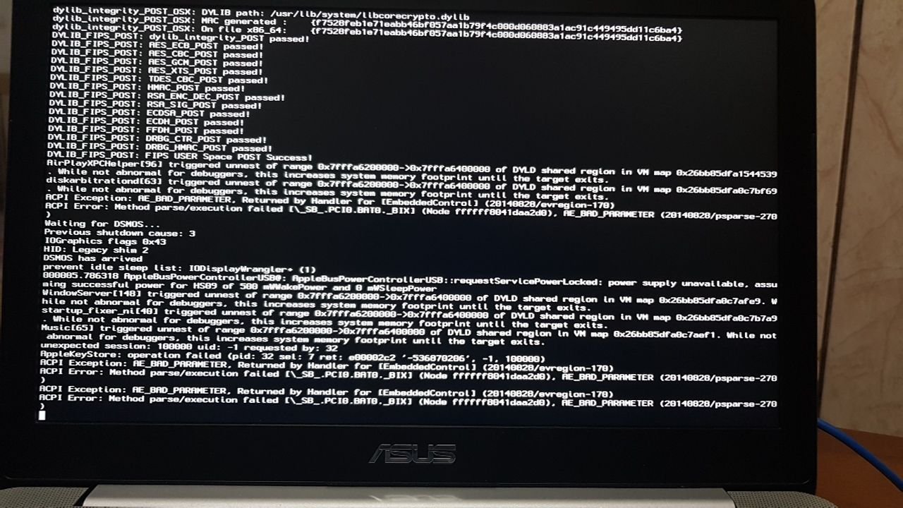

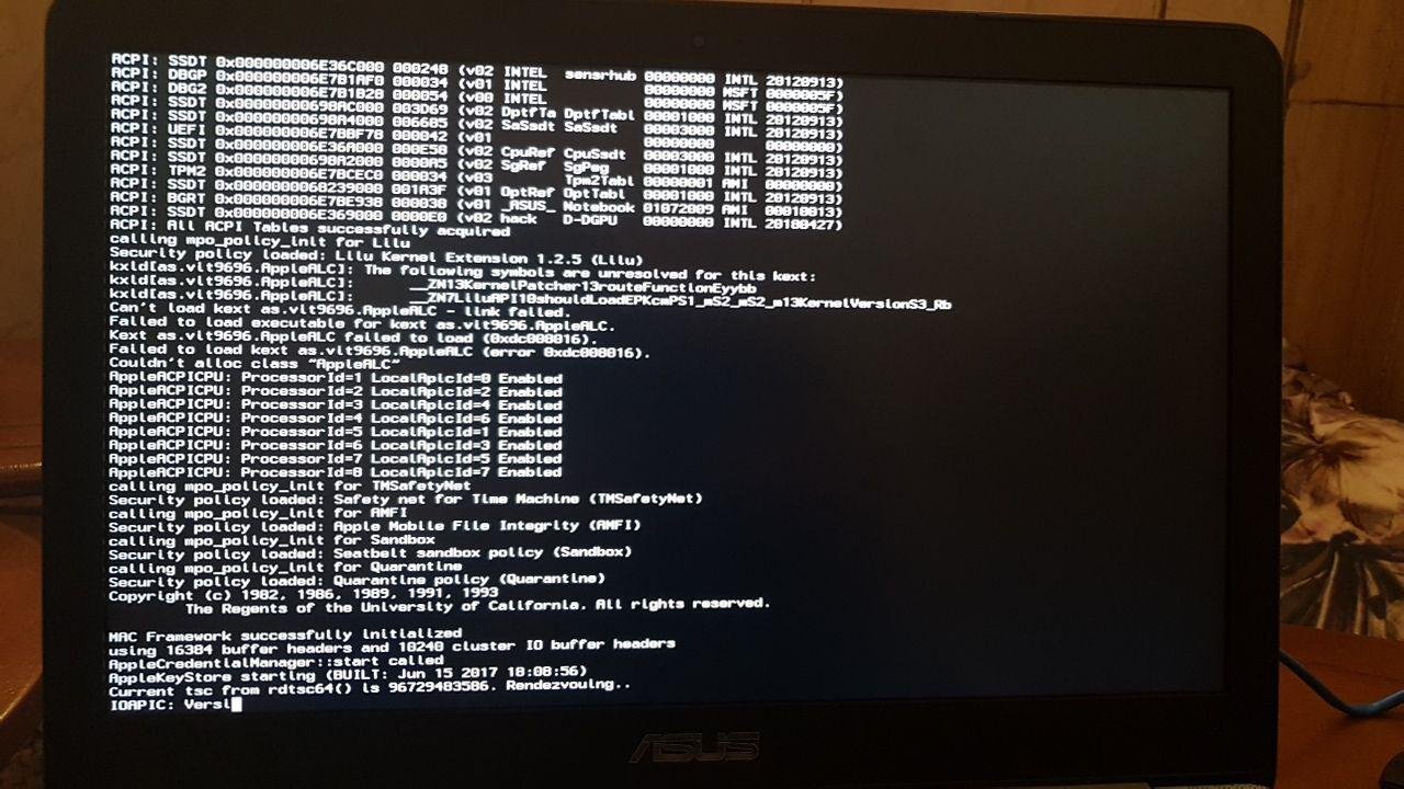

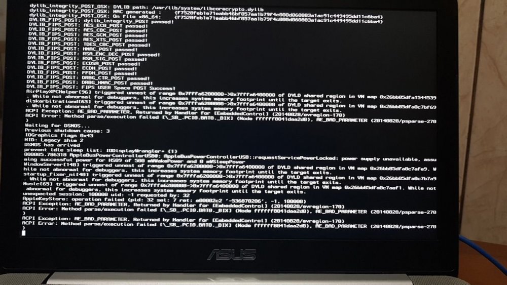

darkbluecode Posted August 6, 2018 Share Posted August 6, 2018 1 hour ago, MARZILLO said: try this CLOVER.zip when i used it Link to comment https://www.insanelymac.com/forum/topic/323556-installazione-macos-sierra-su-asus-n552vw/page/19/#findComment-2629014 Share on other sites More sharing options...
darkbluecode Posted August 6, 2018 Share Posted August 6, 2018 39 minutes ago, MARZILLO said: try this updates clover CLOVER.zip doesn't booted , rebooted ! Link to comment https://www.insanelymac.com/forum/topic/323556-installazione-macos-sierra-su-asus-n552vw/page/19/#findComment-2629019 Share on other sites More sharing options...

darkbluecode Posted August 6, 2018 Share Posted August 6, 2018 14 minutes ago, MARZILLO said: try this CLOVER.zip ........ doesn't booted , rebooted .do think i should reinstall agin ? Link to comment https://www.insanelymac.com/forum/topic/323556-installazione-macos-sierra-su-asus-n552vw/page/19/#findComment-2629028 Share on other sites More sharing options...

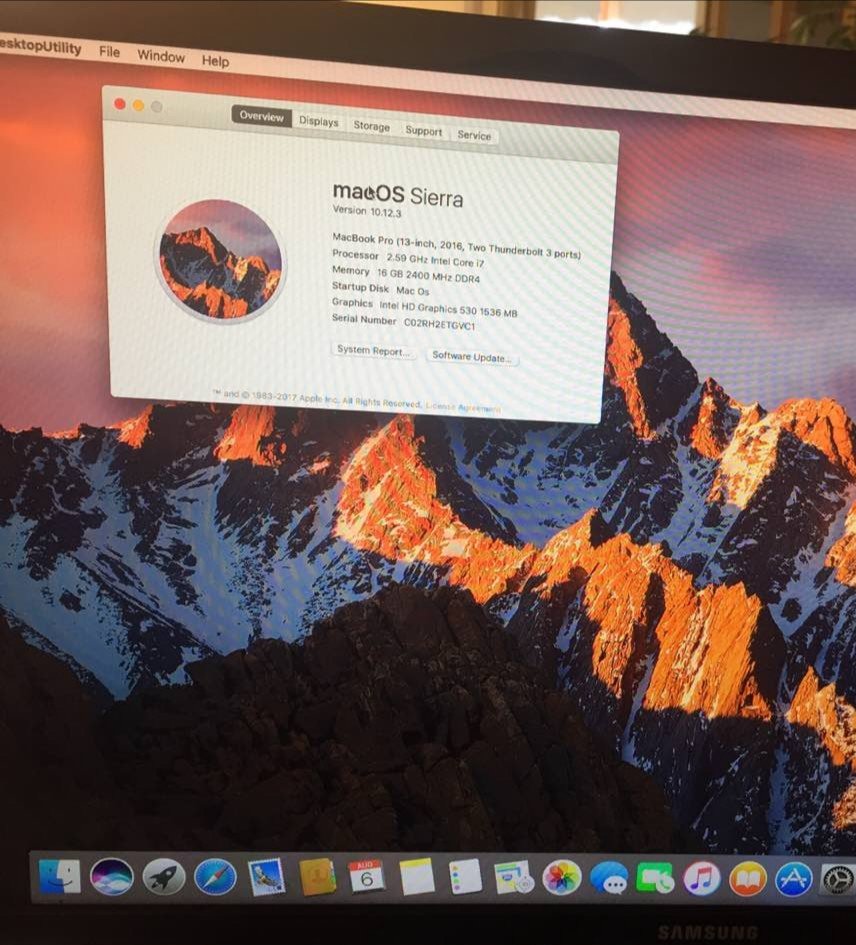

darkbluecode Posted August 6, 2018 Share Posted August 6, 2018 1 hour ago, MARZILLO said: yes i think.... now iinstall mac os 10.12.3 with your last clover and booted but hd530 ihave 3MB vram ? how can i fix this .??? and i don't install any kext on mac . Link to comment https://www.insanelymac.com/forum/topic/323556-installazione-macos-sierra-su-asus-n552vw/page/19/#findComment-2629046 Share on other sites More sharing options...

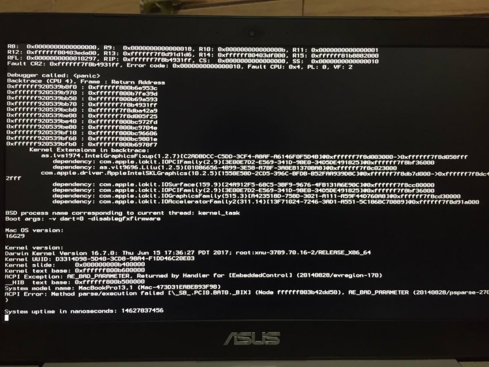

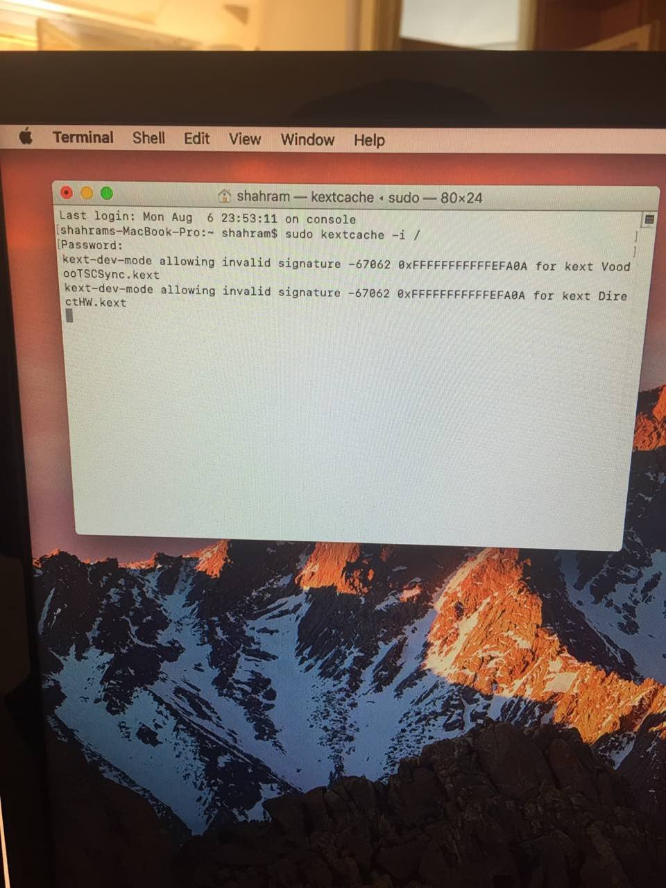

gengik84 Posted August 6, 2018 Share Posted August 6, 2018 Bisogna scrivere in italiano qui...grazie. Sostituisci la cartella clover Apri il terminale, incolla questo comando sudo kextcache -i / Riavvia CLOVER.zip 1 Link to comment https://www.insanelymac.com/forum/topic/323556-installazione-macos-sierra-su-asus-n552vw/page/19/#findComment-2629049 Share on other sites More sharing options...
darkbluecode Posted August 6, 2018 Share Posted August 6, 2018 (edited) 33 minutes ago, gengik84 said: Bisogna scrivere in italiano qui...grazie. Sostituisci la cartella clover Apri il terminale, incolla questo comando sudo kextcache -i / Riavvia CLOVER.zip HI i can't write Italy . en only . excuse me . only replace clover ? and don't i install intelgraphfix up or lilu in s/l/e ? Edited August 6, 2018 by darkbluecode Link to comment https://www.insanelymac.com/forum/topic/323556-installazione-macos-sierra-su-asus-n552vw/page/19/#findComment-2629056 Share on other sites More sharing options...

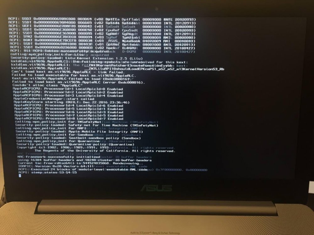

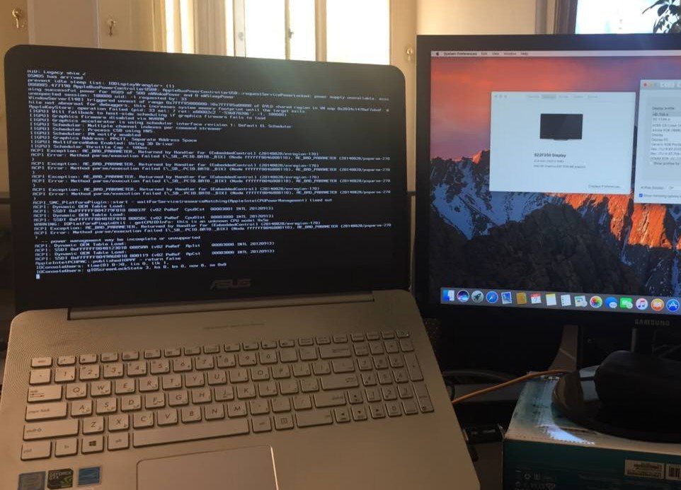

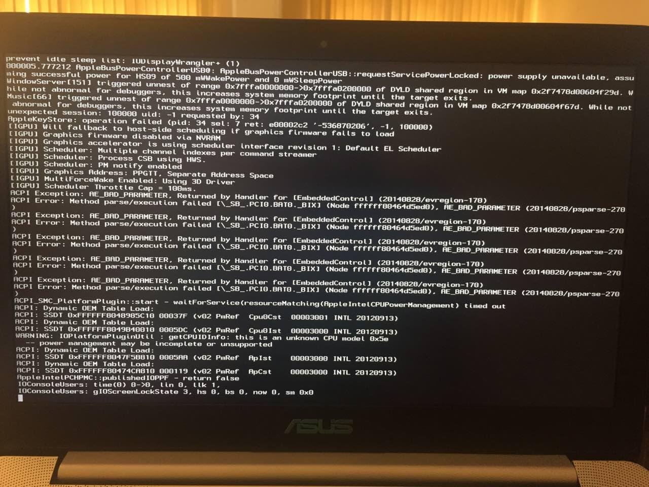

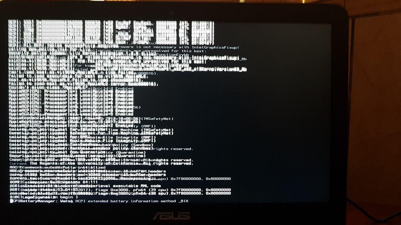

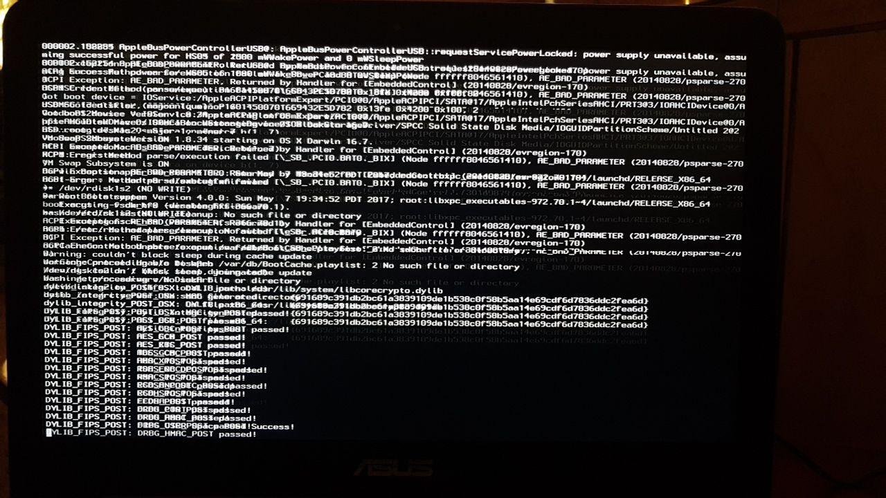

darkbluecode Posted August 7, 2018 Share Posted August 7, 2018 10 hours ago, gengik84 said: Bisogna scrivere in italiano qui...grazie. Sostituisci la cartella clover Apri il terminale, incolla questo comando sudo kextcache -i / Riavvia CLOVER.zip I can't boot system ,dark screen . Link to comment https://www.insanelymac.com/forum/topic/323556-installazione-macos-sierra-su-asus-n552vw/page/19/#findComment-2629134 Share on other sites More sharing options...
MARZILLO Posted August 7, 2018 Share Posted August 7, 2018 try with hdmi prova con hdmi 1 Link to comment https://www.insanelymac.com/forum/topic/323556-installazione-macos-sierra-su-asus-n552vw/page/19/#findComment-2629135 Share on other sites More sharing options...

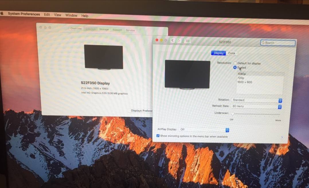

darkbluecode Posted August 7, 2018 Share Posted August 7, 2018 2 hours ago, MARZILLO said: try with hdmi prova con hdmi Ok . I'm going to test . Mr when I changed fake I'd of Intel hd to 0x12345678 screen work but vram is 3mb . Link to comment https://www.insanelymac.com/forum/topic/323556-installazione-macos-sierra-su-asus-n552vw/page/19/#findComment-2629144 Share on other sites More sharing options...
darkbluecode Posted August 7, 2018 Share Posted August 7, 2018 3 hours ago, MARZILLO said: try with hdmi prova con hdmi Yes . Working with HDMI . After first boot with HDMI laptop screen is black and I do code with terminal . After boot again HDMI work but on laptop screen code stay . How can I fix laptop screen ? Now Hd530 have 1.5gb vram Link to comment https://www.insanelymac.com/forum/topic/323556-installazione-macos-sierra-su-asus-n552vw/page/19/#findComment-2629148 Share on other sites More sharing options...

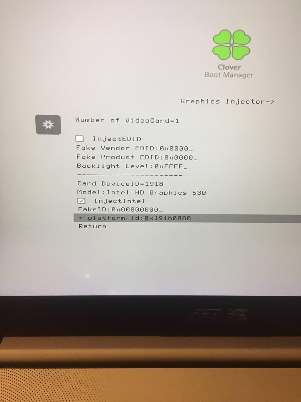

gengik84 Posted August 7, 2018 Share Posted August 7, 2018 non devi usare il Command.. ti ho messo in EFI un Kext che si usa al suo post.. sul bios imposta dvmd a 128mb Nel caso prova anche a mettere ig-platform-id=0x191b0000 1 Link to comment https://www.insanelymac.com/forum/topic/323556-installazione-macos-sierra-su-asus-n552vw/page/19/#findComment-2629160 Share on other sites More sharing options...
darkbluecode Posted August 7, 2018 Share Posted August 7, 2018 3 minutes ago, gengik84 said: non devi usare il Command.. ti ho messo in EFI un Kext che si usa al suo post.. sul bios imposta dvmd a 128mb Nel caso prova anche a mettere ig-platform-id=0x191b0000 ok . dvmd on 128MB . i'm going to test this id . Link to comment https://www.insanelymac.com/forum/topic/323556-installazione-macos-sierra-su-asus-n552vw/page/19/#findComment-2629161 Share on other sites More sharing options...
MARZILLO Posted August 7, 2018 Share Posted August 7, 2018 in config.plist ....section graphics...ig-platform-id try 0x191b0000 nel config sezione graphics...ig-platform-id...prova questo 0x191b0000 restart 1 Link to comment https://www.insanelymac.com/forum/topic/323556-installazione-macos-sierra-su-asus-n552vw/page/19/#findComment-2629162 Share on other sites More sharing options...
darkbluecode Posted August 7, 2018 Share Posted August 7, 2018 1 hour ago, MARZILLO said: in config.plist ....section graphics...ig-platform-id try 0x191b0000 nel config sezione graphics...ig-platform-id...prova questo 0x191b0000 restart 1 hour ago, gengik84 said: non devi usare il Command.. ti ho messo in EFI un Kext che si usa al suo post.. sul bios imposta dvmd a 128mb Nel caso prova anche a mettere ig-platform-id=0x191b0000 Hi i do but hdmi only work . Link to comment https://www.insanelymac.com/forum/topic/323556-installazione-macos-sierra-su-asus-n552vw/page/19/#findComment-2629174 Share on other sites More sharing options...
