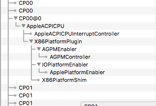

geeti Posted May 20, 2017 Share Posted May 20, 2017 Clover Generate P and C States for u too! You inspired me to try out the clover PM. It seems out with clover PM, the CPU frequency is being adjusted much more better. My previous confusion in this thread is about this. With SSDT and dropped pm/Ist0 tables, the CPU frequency keeps around max. Do you happen to know why? I see almost everyone is using ssdtPRGen created ssdt, but it just seems not that good. 1 Link to comment https://www.insanelymac.com/forum/topic/323052-guide-el-capitan-sierra-high-sierra-mojave-catalina-on-intel-5-6-7-8-9-chipset-series-nehalem-sandybridge-ivybridge-haswell-broadwell/page/8/#findComment-2428361 Share on other sites More sharing options...
MaLd0n Posted May 20, 2017 Author Share Posted May 20, 2017 now i'm using Clover, if processor have a native support, Clover generate a good PM. Send me ioreg IORegistryExplorer.app.zip 2 Link to comment https://www.insanelymac.com/forum/topic/323052-guide-el-capitan-sierra-high-sierra-mojave-catalina-on-intel-5-6-7-8-9-chipset-series-nehalem-sandybridge-ivybridge-haswell-broadwell/page/8/#findComment-2428367 Share on other sites More sharing options...

MaLd0n Posted May 20, 2017 Author Share Posted May 20, 2017 ahhh ok but PM don't work try with iMac14,2 and check ioreg 2 Link to comment https://www.insanelymac.com/forum/topic/323052-guide-el-capitan-sierra-high-sierra-mojave-catalina-on-intel-5-6-7-8-9-chipset-series-nehalem-sandybridge-ivybridge-haswell-broadwell/page/8/#findComment-2428386 Share on other sites More sharing options...
geeti Posted May 20, 2017 Share Posted May 20, 2017 Same result. As long as I put the SSDT in clover, no matter whether I drop the oem table or generate p/c from clover, the CPU frequency will stay high. But the CPU pm will be enabled in ioreg. Odd... ahhh ok but PM don't work try with iMac14,2 and check ioreg MaLd0n 2017-05-20 às 16.17.56.png 1 Link to comment https://www.insanelymac.com/forum/topic/323052-guide-el-capitan-sierra-high-sierra-mojave-catalina-on-intel-5-6-7-8-9-chipset-series-nehalem-sandybridge-ivybridge-haswell-broadwell/page/8/#findComment-2428416 Share on other sites More sharing options...

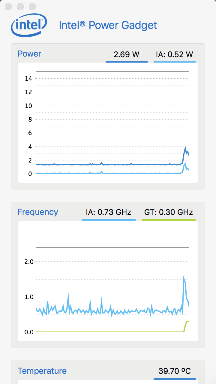

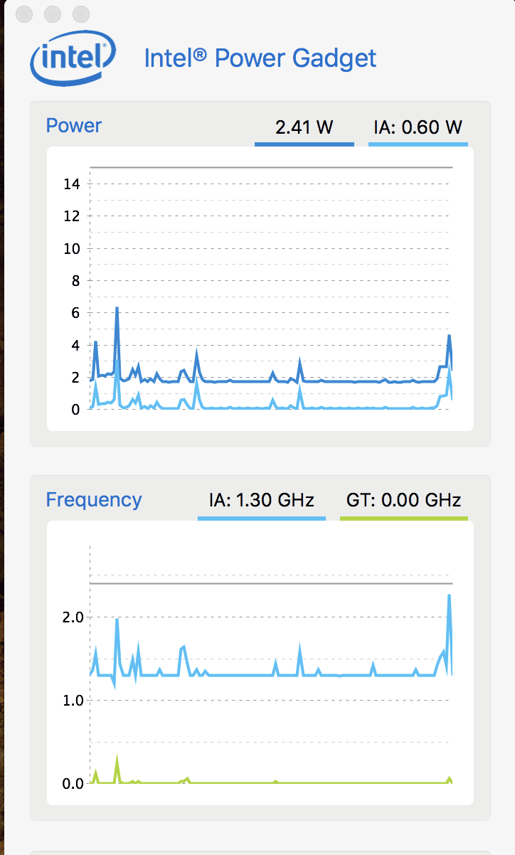

geeti Posted May 21, 2017 Share Posted May 21, 2017 post clover folder here I just finally understood it. When I use smbios of a iMac, the CPU register IA32_ENERGY_PERF_BIAS is set to 0x1, which is highest performance. At this setting, the CPU freq is maintained at a high level. WHen I use a macbook pro smbios, the same register is set to 0x5, which is performance and power balanced. At this setting, the CPU is shifting more agressively, and average frequency is much lower. I think these are all presets in x86platformplugs, so I'll just take what Apple want it to be. Thank you so much! 1 Link to comment https://www.insanelymac.com/forum/topic/323052-guide-el-capitan-sierra-high-sierra-mojave-catalina-on-intel-5-6-7-8-9-chipset-series-nehalem-sandybridge-ivybridge-haswell-broadwell/page/8/#findComment-2428572 Share on other sites More sharing options...
MaLd0n Posted May 21, 2017 Author Share Posted May 21, 2017 work at 800 mhz in idle with iMac smbios, dont need MB smbios 1 Link to comment https://www.insanelymac.com/forum/topic/323052-guide-el-capitan-sierra-high-sierra-mojave-catalina-on-intel-5-6-7-8-9-chipset-series-nehalem-sandybridge-ivybridge-haswell-broadwell/page/8/#findComment-2428587 Share on other sites More sharing options...

shakhri24 Posted May 23, 2017 Share Posted May 23, 2017 check CLOVER.zip sleep now work well keyboard backlit & Fn keys not work (use dsdt patch in attachment please ) with iMac17.1 cpu work at lower frequency, is it normal? 13. Fn Key Patches.txt 15. Keyboard Backlit 16 Level Patch.txt 1 Link to comment https://www.insanelymac.com/forum/topic/323052-guide-el-capitan-sierra-high-sierra-mojave-catalina-on-intel-5-6-7-8-9-chipset-series-nehalem-sandybridge-ivybridge-haswell-broadwell/page/8/#findComment-2429816 Share on other sites More sharing options...
MaLd0n Posted May 23, 2017 Author Share Posted May 23, 2017 lower frequency is correct, hwp dont work at minimal frequency, need read about it, need fix it i think the patchs is already in ur DSDT DSDT.aml.zip check here http://www.insanelymac.com/forum/topic/321021-guide-hwpintel-speed-shift-enable-with-full-power-management/?p=2367065 1 Link to comment https://www.insanelymac.com/forum/topic/323052-guide-el-capitan-sierra-high-sierra-mojave-catalina-on-intel-5-6-7-8-9-chipset-series-nehalem-sandybridge-ivybridge-haswell-broadwell/page/8/#findComment-2429825 Share on other sites More sharing options...
