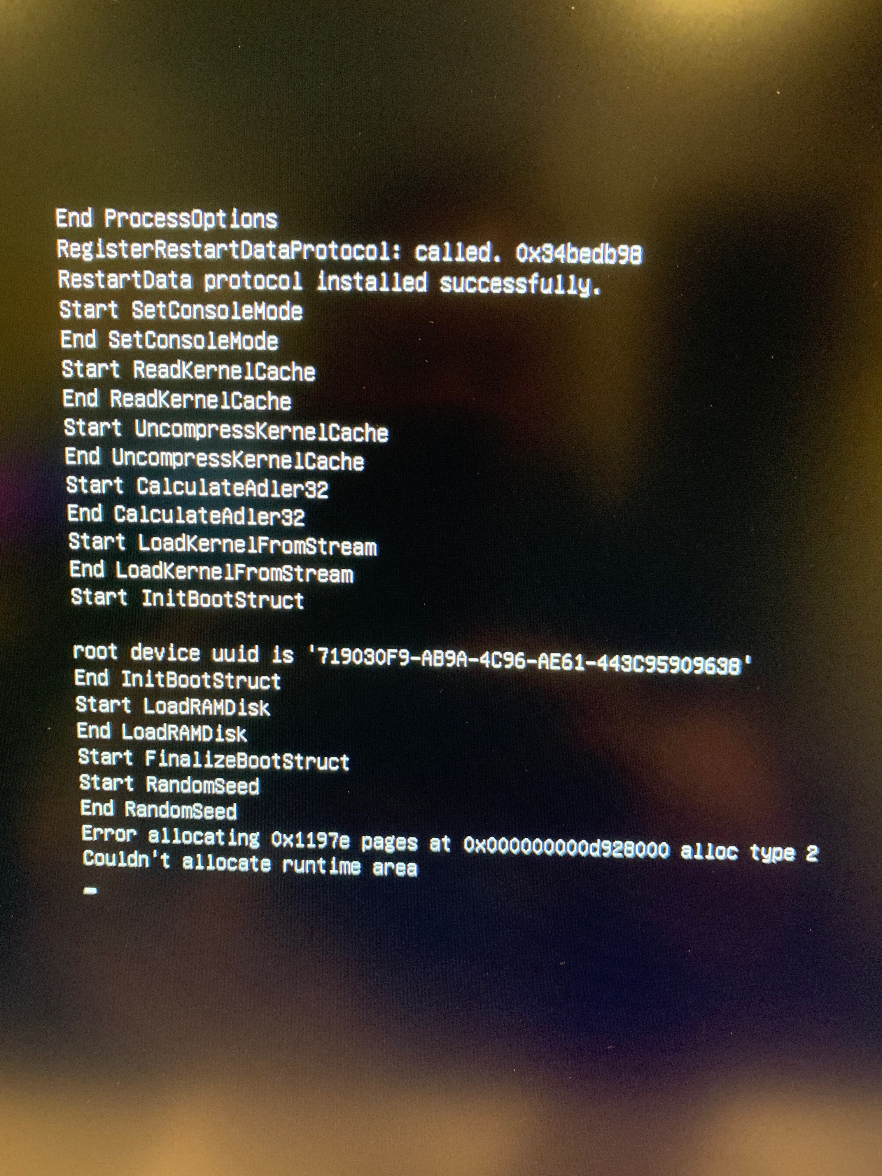

Hello,
I have another system that I am trying to get Mojave 10.14.1 working. I prepped a fresh install on a new nvme drive using a working system. I am using your clover EFI with the latest clover version 4781. Essentially I created a fresh install so that I can use on my other system, but upon booting I am getting this error and I was wondering if there's a way to fix this.
I believe I have almost the same specs are your build. Here's my system specs:
Intel Core i9-9900k
GIGABYTE Z390 AORUS MASTER
32GB DDR4
AMD RX 590 8GB
EDIT: I was messing some entries on the Kernel and Kext Patches section and enabled AppleIntelCPUPM with a FakeCPUID of 0x0906E9. It boots into the system now however the system kernel panics on shutdown/restart/sleep. I don't think this is is good idea to set on my config.plist. I did some research and it appears that it could be something with the Clover efi drivers (maybe AptioMemoryFix-64.efi?).
Edited by adrjac

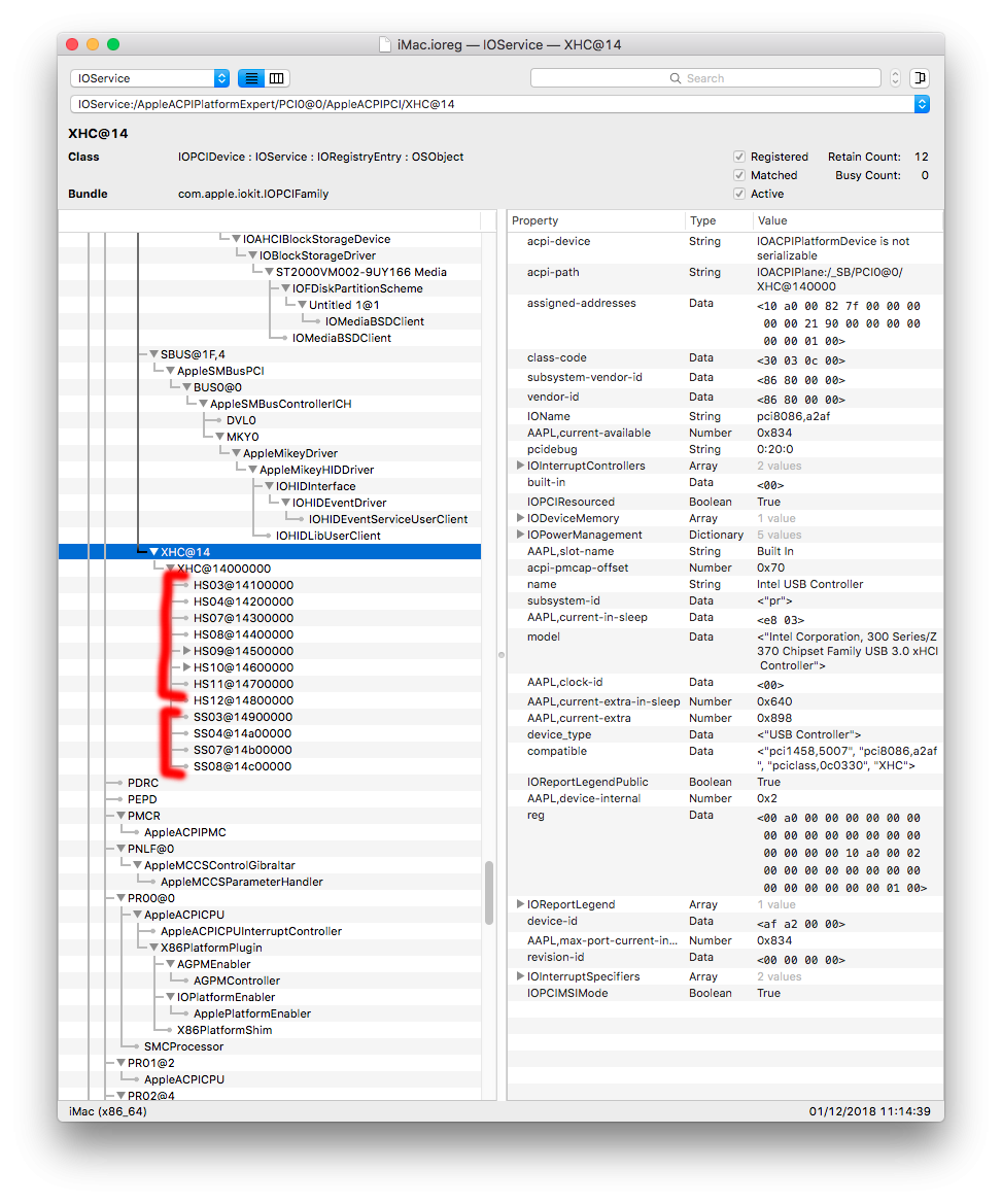

9 hours ago, samtimbaud said:
Ok and can you help me please about my usb3 speed? i tried but it too much hard for me :bye: ?  thanks
u need connect USB2 and USB3 devices in USB ports and check in ioreg what ports system use
example
my unused ports, i excluded with flag
uia_exclude=HS01;HS02;HS05;HS06;HS13;HS14;SS01;SS02;SS05;SS06;SS09;SS10;USR1;USR2
in my ioreg appears used ports, check alternate
HSxx is a USB 2, SSxx is a USB 3
SS03 is a same port HS03, but SS03 appears if u connect USB 3 device and HS03 appears is u connect USB 2 device

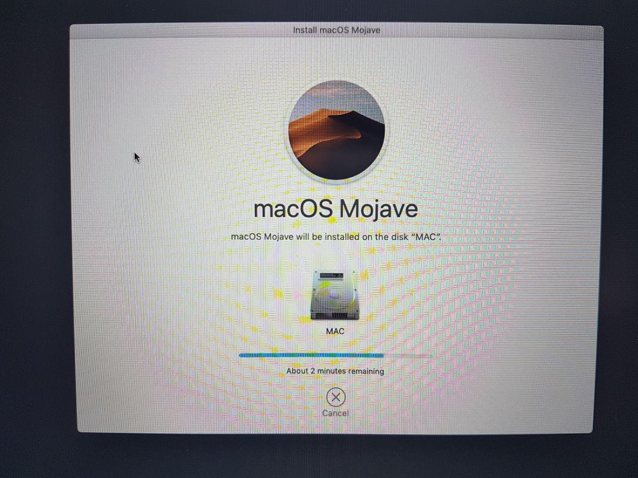

Dear Mald0n,
First of all, I'd like to say thanks that I don't need to work with complicated settings, since I'm using your raw image in my USB drive.
However, now the system encounters a serious problem, and I cannot deal with it.
These are the specs for my computer:
Device type: LAPTOP
CPU: Intel i5-8250U
RAM: 8GB DDR4
SSD: Samsung 256GB NVme SSD (PCI Express)
GPU: Intel UHD 620 + Geforce MX150
And my SSD drive is partitioned like this: (I'm using a single SSD to install both windows and mac)
EFI partition (260MB)
OEM partition (500MB)
RECOVERY partition (1GB)
Primary partition (170GB, Windows 10 installed already)
Empty primary partition (70GB, formatted in HFS to install Mac)
I applied your RAW file in this link (https://olarila.com/forum/viewtopic.php?f=51&t=6743&sid=9c107ccc6bebebabc7a161ba42a676ff) and applied it to my 32GB Sandisk USB drive using Etcher. After that, I recognized the USB drive in the VM with Mac OS Mojave, opened the config.plist file with clover configurator, and made these edits:
* added 0x12345678 in Devices - Intel GFX
* Left Inject Intel checked, and left the ig platform id box empty
After that, I installed the newest version of clover with checking all the UEFI drivers. (of course, checked install on UEFI and install clover in the ESP)
When I booted through the USB drive, it showed a lot of codes running, and booted to the Mac OS Utilities GUI successfully. (YAY!)
However, the problem comes out here. Every time I tried to install Mac OS Mojave in my PC, the installation becomes completely stuck (freezes) during the installation process (when the progress bar appears) like this:
This is just a sample of the progress, and in my case, it actually freezes around 5% of the progress bar.
I have no idea how to make it work.. I tried changing the file system of my 70GB partition from HFS to APFS, but still freezes at the same point.
Any ideas for this, mald0n? Attached is the config.plist file I used to boot, so please have a look and give me any feedbacks so that I can make it work.
Thank you!
-Felix-
config.plist
Thank you!
-Felix-
config.plist
try create new USB stick with createmediainstall command
Before I used yours, I tried creating a bootable usb with createinstallmedia, installed the latest version of clover, and replaced the EFI folder with this:
https://drive.google.com/file/d/16krxx1ftDJLfODkd99bIMti6m8mHPtCr/view?usp=sharing
A guy in Discord gave this to me, and it was also from olarila.com.. I edited the config.plist of that EFI by:
* putting 0x12345678 in INTEL_GFX (empty, but put the code)
* deleting everything in ig_platform_id (there were some code in it)
* Checking inject intel (unchecked at the beginning)
Of course, the method also booted successfully into GUI, but it freezes in the installer screen during installation..
No way how to fix it.. phew..
