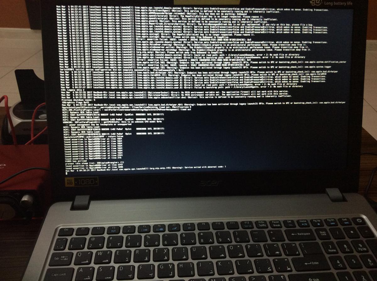

dannymozzer Posted March 5, 2017 Author Share Posted March 5, 2017 This is the latest error I got. Like I said, if you need more info, you'll have to tell me how to get it. Also I created this image (on the USB) using the software on a VMware image. So I don't know why it still doesn't work. Link to comment https://www.insanelymac.com/forum/topic/321621-solved-closed-cant-boot-to-install-screen-on-acer-aspire-f-15/#findComment-2378391 Share on other sites More sharing options...
nawcom Posted March 5, 2017 Share Posted March 5, 2017 Try removing EmuVariableUefi-64.efi from /EFI/CLOVER/drivers64UEFI as well as /nvram.plist if available on the USB install media. nvram.plist may not have been created yet. It's also hidden in Finder so you can either remove it via Terminal: ls /Volumes/Your_USB_Volume_name and see if it's there. sudo rm /Volumes/Your_USB_Volume_name/nvram.plist If you want to do it from Finder run defaults write com.apple.finder AppleShowAllFiles YES && pkill Finder and you'll be able to see it in Finder if it's there. defaults write com.apple.finder AppleShowAllFiles NO && pkill Finder turns it back off. Like I said nvram.plist might not be there if this is USB media hasn't successfully booted yet. Not sure which version of FakeSMC.kext you're using but you can use the latest one from here: https://bitbucket.org/RehabMan/os-x-fakesmc-kozlek/downloads/RehabMan-FakeSMC-2017-0117.zip ignore the other kexts in there and just use FakeSMC.kext. This error you're getting is atypical for people running OS X on real hardware. It more common with virtual machines that aren't injecting the SMC key. Let me know if this gets you past this or if you're still stuck. Link to comment https://www.insanelymac.com/forum/topic/321621-solved-closed-cant-boot-to-install-screen-on-acer-aspire-f-15/#findComment-2378673 Share on other sites More sharing options...

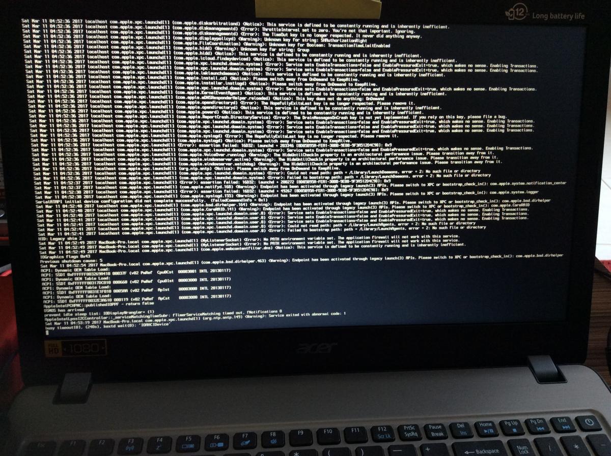

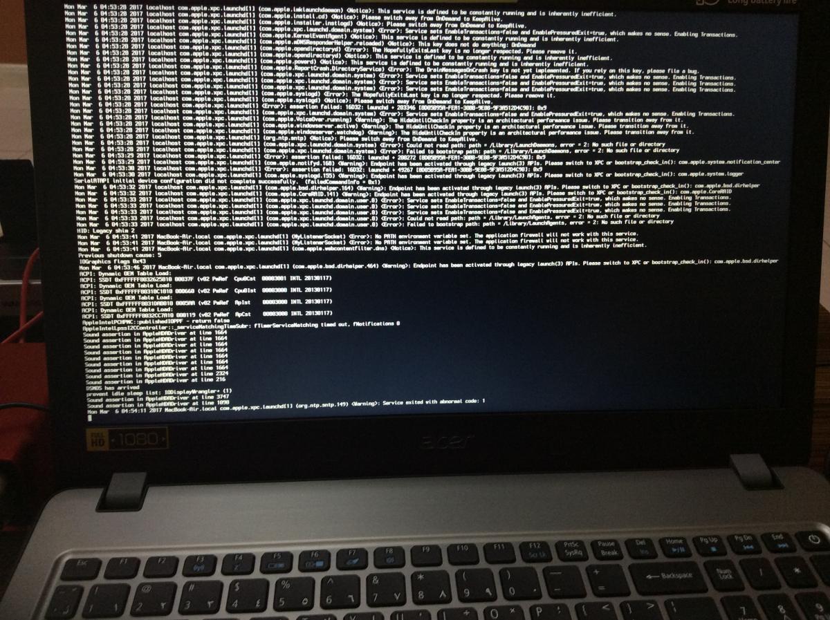

dannymozzer Posted March 6, 2017 Author Share Posted March 6, 2017 No, still no luck. Different error though. I didn't have the .plist and the only kext I have is the fakesmc (after deleting the others). I do use a fake cpu Id which was explained in a video (0x000106E0) the error is the first image (Image_0508). If I don't use the fake id I get the error in image 2. (Image_0509) Link to comment https://www.insanelymac.com/forum/topic/321621-solved-closed-cant-boot-to-install-screen-on-acer-aspire-f-15/#findComment-2378985 Share on other sites More sharing options...

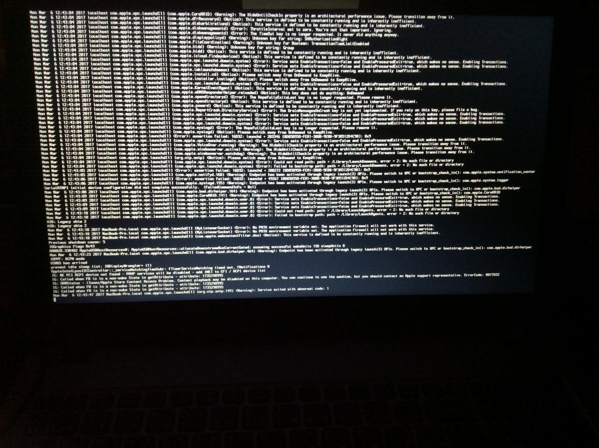

dannymozzer Posted March 6, 2017 Author Share Posted March 6, 2017 Thanks for the reply. But, error. 1 Link to comment https://www.insanelymac.com/forum/topic/321621-solved-closed-cant-boot-to-install-screen-on-acer-aspire-f-15/#findComment-2379161 Share on other sites More sharing options...
MaLd0n Posted March 6, 2017 Share Posted March 6, 2017 Try it config.plist.zip Link to comment https://www.insanelymac.com/forum/topic/321621-solved-closed-cant-boot-to-install-screen-on-acer-aspire-f-15/#findComment-2379200 Share on other sites More sharing options...

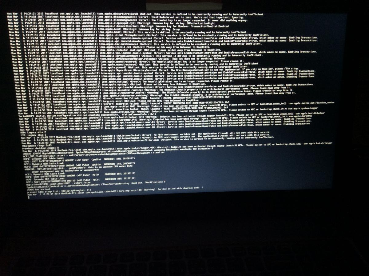

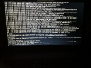

dannymozzer Posted March 10, 2017 Author Share Posted March 10, 2017 See above attached image. That's my latest error. 1 Link to comment https://www.insanelymac.com/forum/topic/321621-solved-closed-cant-boot-to-install-screen-on-acer-aspire-f-15/#findComment-2381693 Share on other sites More sharing options...
MaLd0n Posted March 10, 2017 Share Posted March 10, 2017 try dart flag config.plist.zip avoid problems VT-d Link to comment https://www.insanelymac.com/forum/topic/321621-solved-closed-cant-boot-to-install-screen-on-acer-aspire-f-15/#findComment-2381771 Share on other sites More sharing options...
dannymozzer Posted March 11, 2017 Author Share Posted March 11, 2017 It's just the same error over and over again. And I can't disable vt-d because my bios is way too basic. Could you maybe just attach a EFI folder that I could drag onto my memory stick with the right Kexts, conifgs, etc? It would probably make it easier. Or could I use a different boot loader or another hackintosh file from somewhere else? (This is the reason why I closed the topic, because I'm starting to give up) Link to comment https://www.insanelymac.com/forum/topic/321621-solved-closed-cant-boot-to-install-screen-on-acer-aspire-f-15/#findComment-2382383 Share on other sites More sharing options...

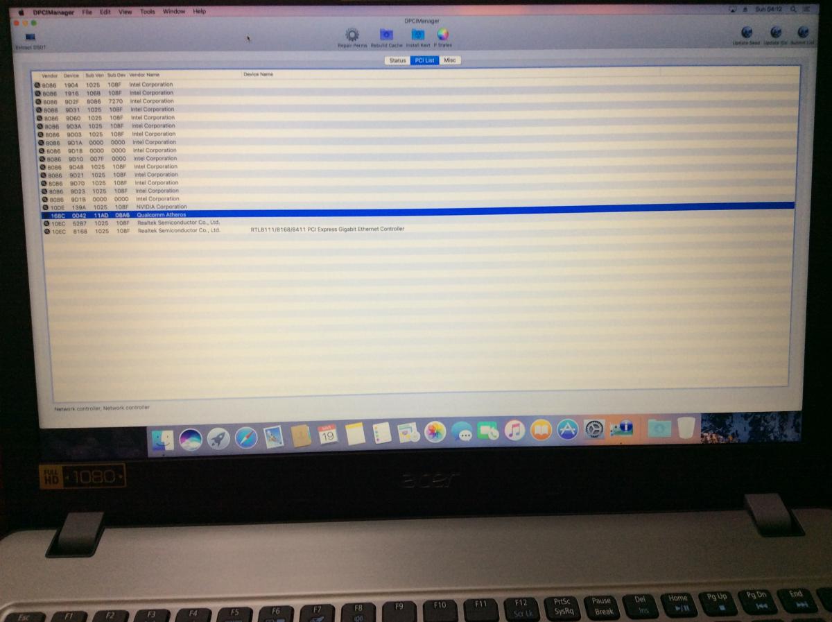

MaLd0n Posted March 16, 2017 Share Posted March 16, 2017 use DPCIManager.app and post a full photo of tab PCI List https://sourceforge.net/projects/dpcimanager/ Link to comment https://www.insanelymac.com/forum/topic/321621-solved-closed-cant-boot-to-install-screen-on-acer-aspire-f-15/#findComment-2385402 Share on other sites More sharing options...
dannymozzer Posted March 16, 2017 Author Share Posted March 16, 2017 I'll do this tomorrow when I get a wifi adapter, because I've just got windows sorted again, and I don't want to keep installing mac and windows over and over again. How can I get boot camp to work? Because I get the gpt error and Windows won't install. If I can dual boot then I would be able to do this, I just don't have a spare computer to upload any files, the only thing I can do is post pictures using my iPad. 1 Link to comment https://www.insanelymac.com/forum/topic/321621-solved-closed-cant-boot-to-install-screen-on-acer-aspire-f-15/#findComment-2385416 Share on other sites More sharing options...

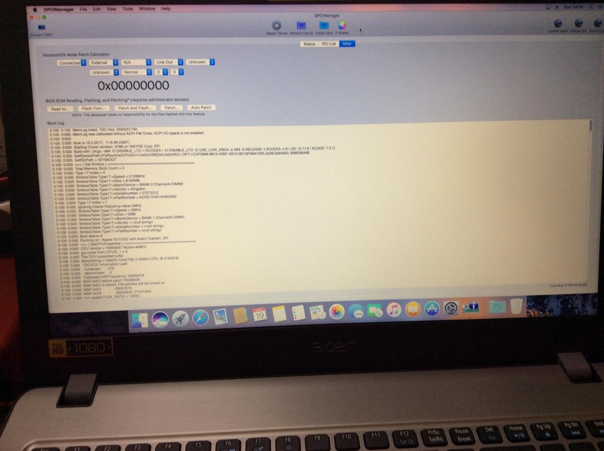

MaLd0n Posted March 18, 2017 Share Posted March 18, 2017 send me files RunMe.app.zip what ur audio codec? what lan, wifi? Use dpcimanager and post one photo Devices tab Link to comment https://www.insanelymac.com/forum/topic/321621-solved-closed-cant-boot-to-install-screen-on-acer-aspire-f-15/#findComment-2386697 Share on other sites More sharing options...

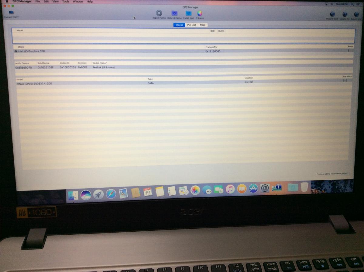

dannymozzer Posted March 19, 2017 Author Share Posted March 19, 2017 There was no devices tab, so I have attached 3 images, which show all tabs. Also I said, it's a tp-link archer T2U. Which is the dongle I would prefer to use, and not my built in adapter. So could you help me get the tp-link working please. Send me Daniel’s MacBook.zip Link to comment https://www.insanelymac.com/forum/topic/321621-solved-closed-cant-boot-to-install-screen-on-acer-aspire-f-15/#findComment-2387091 Share on other sites More sharing options...
