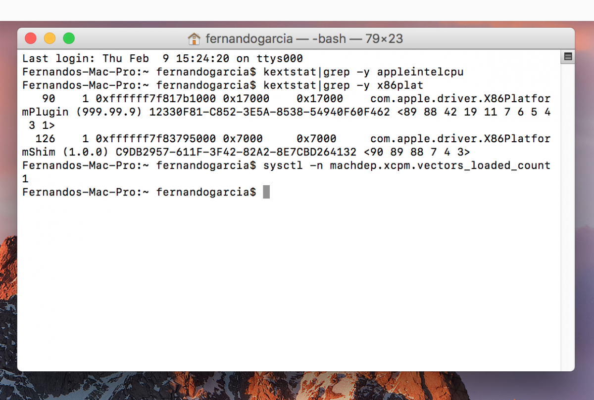

griven Posted February 10, 2017 Share Posted February 10, 2017 @Slice, @PMheart sorry my fault forget about it... I use Ozmosis and since it lacks support of on the fly patching I´ll have to bin patch the kernel on my own and messed things up I guess. XCPM is up and working as before sysctl -n machdep.xcpm.mode 1 sysctl -n machdep.xcpm.vectors_loaded_count 1 Sorry for the inconvenience I may have caused. 1 Link to comment https://www.insanelymac.com/forum/topic/320517-pre-release-macos-sierra-10124/page/4/#findComment-2365652 Share on other sites More sharing options...
PMheart Posted February 10, 2017 Share Posted February 10, 2017 @Slice, @PMheart sorry my fault forget about it... I use Ozmosis and since it lacks support of on the fly patching I´ll have to bin patch the kernel on my own and messed things up I guess. XCPM is up and working as before sysctl -n machdep.xcpm.mode 1 sysctl -n machdep.xcpm.vectors_loaded_count 1 Sorry for the inconvenience I may have caused. That's ok. Congratulations. Link to comment https://www.insanelymac.com/forum/topic/320517-pre-release-macos-sierra-10124/page/4/#findComment-2365814 Share on other sites More sharing options...
Kynyo Posted February 10, 2017 Share Posted February 10, 2017 @Slice, @PMheart sorry my fault forget about it... I use Ozmosis and since it lacks support of on the fly patching I´ll have to bin patch the kernel on my own and messed things up I guess. XCPM is up and working as before sysctl -n machdep.xcpm.mode 1 sysctl -n machdep.xcpm.vectors_loaded_count 1 Sorry for the inconvenience I may have caused. Could you explain how did you patched the kernel on Ozmosis? Thanks. I put the command and Terminal says: sysctl -n machdep.xcpm.mode 1 but sysctl -n machdep.xcpm.vectors_loaded_count 0 Link to comment https://www.insanelymac.com/forum/topic/320517-pre-release-macos-sierra-10124/page/4/#findComment-2365871 Share on other sites More sharing options...
PMheart Posted February 11, 2017 Share Posted February 11, 2017 Could you explain how did you patched the kernel on Ozmosis? Thanks. I put the command and Terminal says: sysctl -n machdep.xcpm.mode 1 but sysctl -n machdep.xcpm.vectors_loaded_count 0 You may need to inject FrequencyVectors via Pike's freqVectorsEdit.sh or change your SMBios which is containing FrequencyVectors. Link to comment https://www.insanelymac.com/forum/topic/320517-pre-release-macos-sierra-10124/page/4/#findComment-2366213 Share on other sites More sharing options...

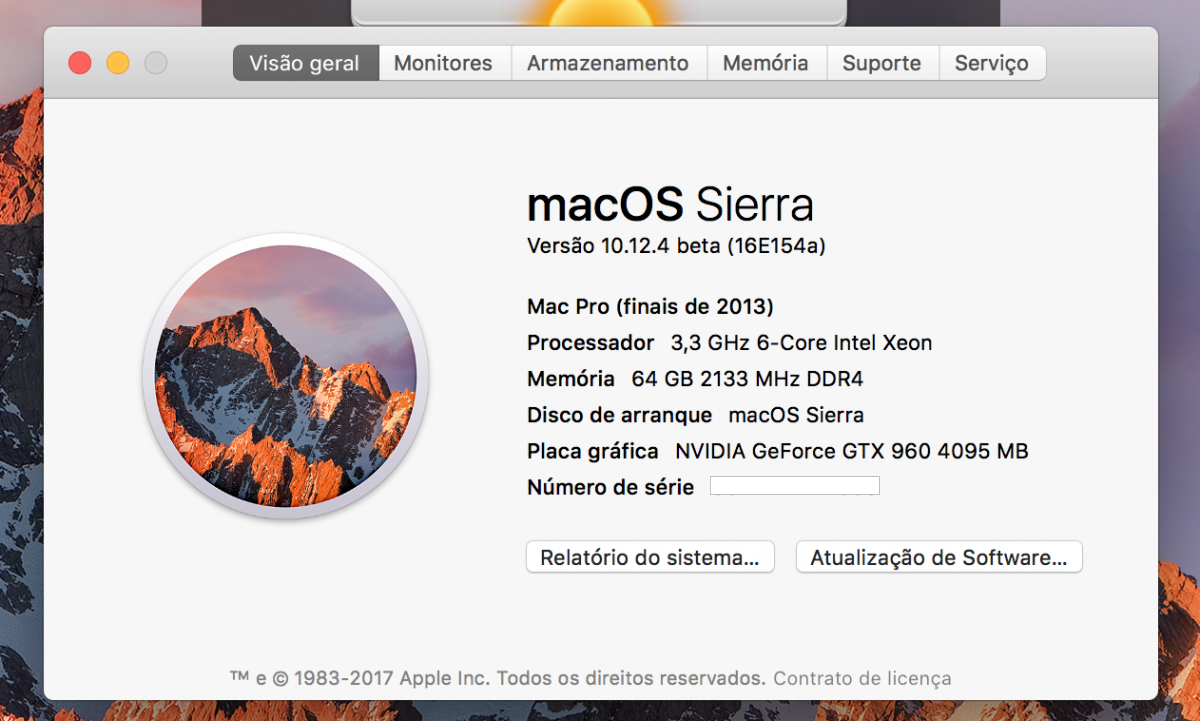

Fergarth Posted February 13, 2017 Share Posted February 13, 2017 Updated to Sierra 12.4 beta 2 (16E154a) and Clover r4003. Everything works fine and stable as always, except for NvidiaWebDrive. With the plist edited from 16D to 16E, it recognizes the graphic card and has some resolutions, but without full acceleration... PMheart, as you suggested I installed your MP61_freqV_w_iMac171.kext on SLE and erased it on Clover. And now it seems to me that it's your kext that's running the FreqVectors. I installed it before the OS update and yes, it survived Thanks friend 4 Link to comment https://www.insanelymac.com/forum/topic/320517-pre-release-macos-sierra-10124/page/4/#findComment-2367765 Share on other sites More sharing options...

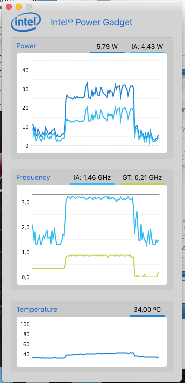

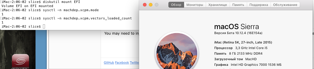

Slice Posted February 14, 2017 Share Posted February 14, 2017 You may need to inject FrequencyVectors via Pike's freqVectorsEdit.sh or change your SMBios which is containing FrequencyVectors. or And GpuTest: Furmark 2 Link to comment https://www.insanelymac.com/forum/topic/320517-pre-release-macos-sierra-10124/page/4/#findComment-2368239 Share on other sites More sharing options...
PMheart Posted February 15, 2017 Share Posted February 15, 2017 or Снимок экрана 2017-02-14 в 23.00.39.png And GpuTest: Furmark Снимок экрана 2017-02-14 в 23.06.51.png Yes. iMac17,1 is containing FrequencyVectors. 1 Link to comment https://www.insanelymac.com/forum/topic/320517-pre-release-macos-sierra-10124/page/4/#findComment-2368326 Share on other sites More sharing options...

Slice Posted February 15, 2017 Share Posted February 15, 2017 Yes. iMac17,1 is containing FrequencyVectors. Sorry, no. My result is because of additional kext X17PlatformPlugin.kext.zip AFAIK works only in SLE. 1 Link to comment https://www.insanelymac.com/forum/topic/320517-pre-release-macos-sierra-10124/page/4/#findComment-2368355 Share on other sites More sharing options...
PMheart Posted February 15, 2017 Share Posted February 15, 2017 Sorry, no. My result is because of additional kext X17PlatformPlugin.kext.zip AFAIK works only in SLE. Actually iMac17,1 has contained FrequencyVectors already and thus you don't need to inject it via a dummy kext. But as iMac17,1 does not support some features like hwp, epp for Skylake, I find that you are using another set of FrequencyVectors from other SMBios. Maybe a MacBookPro13,1, sorry for more details, I can't tell. (I inferred it's MBP131 just because I found your LFM is 0xD/13 and your EPP is 0x92/146, that's what MBP131 used.) Anyway. For desktops I think the 'perf-bias' should be 0x01/1 instead of 0x05/5, 0x05 is laptops used (for a better battery life time). And I think EPP should be 0x80/128 (by default). That can be better. Also. Yep. These kinds of dummy kext/injector should only work in SLE/LE. I adjusted your FrequencyVectors, have a try? You can check what I did via Hex Editor. [EDIT] Confusing contents removed. Link to comment https://www.insanelymac.com/forum/topic/320517-pre-release-macos-sierra-10124/page/4/#findComment-2368356 Share on other sites More sharing options...
Slice Posted February 15, 2017 Share Posted February 15, 2017 Actually iMac17,1 has contained FrequencyVectors already and thus you don't need to inject it via a dummy kext. But as iMac17,1 does not support some features like hwp, epp for Skylake, I find that you are using another set of FrequencyVectors from other SMBios. Maybe a MacBookPro13,1, sorry for more details, I can't tell. (I inferred it's MBP131 just because I found your LFM is 0xD/13 and your EPP is 0x92/146, that's what MBP131 used.) Snip20170215_1.png Anyway. For desktops I think the 'perf-bias' should be 0x01/1 instead of 0x05/5, 0x05 is laptops used (for a better battery life time). And I think EPP should be 0x80/128 (by default). That can be better. Also. Yep. These kinds of dummy kext/injector should only work in SLE/LE. I adjusted your FrequencyVectors, have a try? You can check what I did via Hex Editor. new_X17PlatformPlugin.kext.zip Thanks, but with your kext CPU is always at high speed. Link to comment https://www.insanelymac.com/forum/topic/320517-pre-release-macos-sierra-10124/page/4/#findComment-2368365 Share on other sites More sharing options...

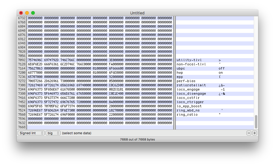

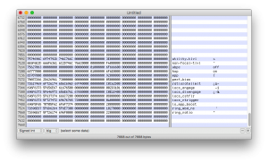

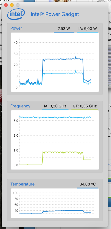

PMheart Posted February 15, 2017 Share Posted February 15, 2017 Thanks, but with your kext CPU is always at high speed. Снимок экрана 2017-02-15 в 7.10.04.png Oops weird. Try to increase the EPP value to 0xC0/192 and set 'perf-bias' to 5? Like this. X17PlatformPlugin.kext.zip [uPDATE] I don't think that you should use the FrequencyVectors from a laptop SMBios. You can try this patched plist which is modified based on the vanilla Mac-DB15BD556843C820.plist (iMac17,1), with HWP enabled, EPP value 0x80/128. Please also try this? HWP_Mac-DB15BD556843C820.plist.zip 1 Link to comment https://www.insanelymac.com/forum/topic/320517-pre-release-macos-sierra-10124/page/4/#findComment-2368367 Share on other sites More sharing options...
Slice Posted February 15, 2017 Share Posted February 15, 2017 Oops weird. Try to increase the EPP value to 0xC0/192 and set 'perf-bias' to 5? Like this. X17PlatformPlugin.kext.zip [uPDATE] I don't think that you should use the FrequencyVectors from a laptop SMBios. You can try this patched plist which is modified based on the vanilla Mac-DB15BD556843C820.plist (iMac17,1), with HWP enabled, EPP value 0x80/128. Please also try this? HWP_Mac-DB15BD556843C820.plist.zip OK, I will try but little later. 1 Link to comment https://www.insanelymac.com/forum/topic/320517-pre-release-macos-sierra-10124/page/4/#findComment-2368389 Share on other sites More sharing options...

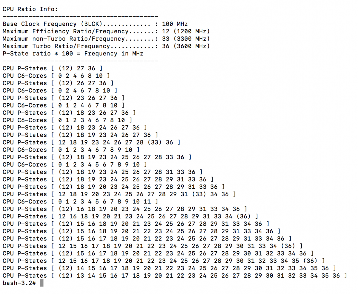

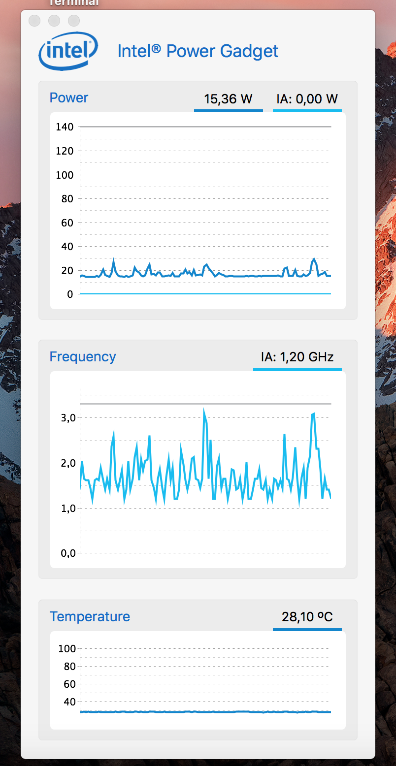

xtddd Posted February 15, 2017 Share Posted February 15, 2017 i have enabled hwp and the result is below.. imac17.1 dont support hwp, Link to comment https://www.insanelymac.com/forum/topic/320517-pre-release-macos-sierra-10124/page/4/#findComment-2368398 Share on other sites More sharing options...
PMheart Posted February 15, 2017 Share Posted February 15, 2017 i have enabled hwp and the result is below.. imac17.1 dont support hwp, I guessed that there's no X86* loading on your hack. Also. CPU-S can be not reliable to get correct P-States. Link to comment https://www.insanelymac.com/forum/topic/320517-pre-release-macos-sierra-10124/page/4/#findComment-2368428 Share on other sites More sharing options...
Kynyo Posted February 15, 2017 Share Posted February 15, 2017 i have enabled hwp and the result is below.. imac17.1 dont support hwp, What a nice tool! Could you share it with us, please? Thanks. Link to comment https://www.insanelymac.com/forum/topic/320517-pre-release-macos-sierra-10124/page/4/#findComment-2368451 Share on other sites More sharing options...

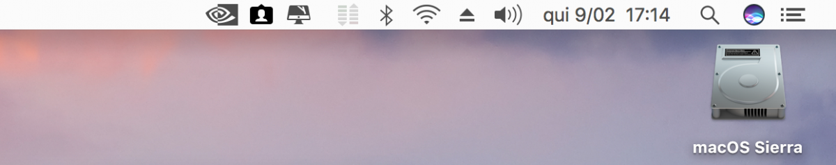

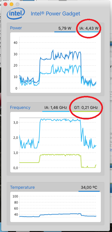

Fergarth Posted February 15, 2017 Share Posted February 15, 2017 or Снимок экрана 2017-02-14 в 23.00.39.png And GpuTest: Furmark Снимок экрана 2017-02-14 в 23.06.51.png Hi Slice, sorry to bother you. But what do I have to do, to have this function active in IPG? Do I need some plug-in or kext? Thank you. Link to comment https://www.insanelymac.com/forum/topic/320517-pre-release-macos-sierra-10124/page/4/#findComment-2368538 Share on other sites More sharing options...
