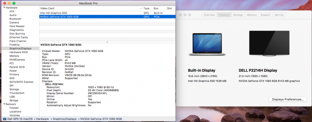

KNNSpeed Posted June 6, 2017 Share Posted June 6, 2017 GTX 1050 works for CUDA as a secondary GPU only. Generally the discrete card is disabled for battery life reasons. Don't expect to be able to use the 1050 for gaming/as a primary GPU unless you plan on dual booting Windows. Unfortunately, Optimus is not supported on hackintoshes due to architectural differences between Apple laptops, which have a physical, dedicated, and proprietary graphics-switching chip, and everyone else. Only laptops that use integrated Graphics for the display and a dedicated card for external monitors without any switching would have both working, since that would be like a computer with two separate graphics cards (this is not one of them). Could it be made to work? Conceivably, yes, if someone clever figures out how to fake the GMUX with ACPI hacks and a driver, but I will not be tackling that. That stated, Thunderbolt eGPUs might work (I don't have one, but since Thunderbolt works on boot-plug and given WWDC announcements I would imagine they'd work). Basically what I'm planning to do is upload my build with explanations of what everything does/what I had to do to get everything working. It will only be most applicable to those who have a 4k sector-compatible SSD (so not the Samsungs), since I don't want anyone trying this and then blaming me for data corruption. Link to comment https://www.insanelymac.com/forum/topic/320016-dell-xps-15-9560-version-2017-compatibility-information/page/6/#findComment-2436590 Share on other sites More sharing options...
