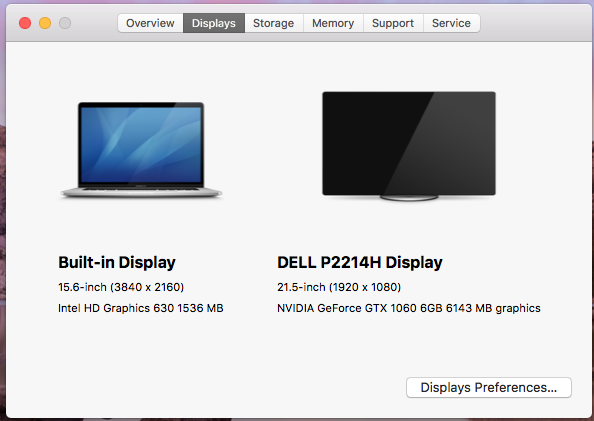

Jonny4911 Posted May 12, 2017 Share Posted May 12, 2017 Turns out my thunderbolt does work, my eGPU with an Nvidia 1060 works great (using web drivers)! My usb-c still doesn't work though, I'll try changing my SMBIOS later. I have the PM961 which is a 960 evo model right? So would be great to try out your kext and AML, thank you! Have you made sure to disable hibernation like in the 9550 thread?This is a must if you can't/haven't do(/ne) the 4k fix. sudo pmset -a hibernatemode 0 A HUGEEEEE THANK YOU for your work man ! You are the best ! Do you have any suggestions regarding the wifi for replacement ? I found this they were in the previous version of XPS : https://www.parts-people.com/index.php?action=category&id=143&sul If you look at my signature, you'll see I use a Dell Wireless DW1560 Link to comment https://www.insanelymac.com/forum/topic/320016-dell-xps-15-9560-version-2017-compatibility-information/page/4/#findComment-2422319 Share on other sites More sharing options...
