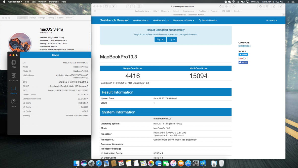

blazinsmokey Posted June 19, 2017 Share Posted June 19, 2017 Awesome, thanks for replying. I was just adding my geek bench score, care to share yours ? From your suggestions, I'll update the post and make the changes. 1 - I thought this may be the case. 2 - One day may I see my network or any network I join have speeds of over 100MB/s! I'll add it for others and if I'm ever so lucky to witness such speeds. 3 - Ok that makes sense, I'll leave that then. Ahhhh. Yea four finger is set to F11. I see now. The swipes are actually bound to keyboard strokes. Yea I have Alt as my CMD key. I'm still new to using it but that bothered me. The trackpad battle is real with this machine. freejack's voodoops2 was from rehabman. He changed the way it was polling I believe, b/c when we first got our systems, the trackpad would just stop working and freeze. Crazy thing was when our fans were running the trackpad worked great. He made the kext so some process(polling) restarted or something but this caused your cursor to stop randomly when you were moving. Been months I can't remember the exact details I think we discussed it over at tmacs. Link to comment https://www.insanelymac.com/forum/topic/320016-dell-xps-15-9560-version-2017-compatibility-information/page/7/#findComment-2447196 Share on other sites More sharing options...
KNNSpeed Posted June 19, 2017 Share Posted June 19, 2017 Oh, I thought Syscl's voodoops2 was based on RehabMan's with some shortcuts tweaked. But TBH voodoops2 can be easily changed for something else based on personal preference, as it doesn't interefere or require any other patches/kexts/SSDTs. Some WiFi trivia: MBps =/= Mbps. Small "b" is bits (what cable companies sell you), while big "B" is bytes (what your files are actually measured with), and 1 byte is 8 bits. BUT WiFi is actually half-duplex (send/receive are sequential), while ethernet is full duplex (send/receive simultaneously). So for 867Mbps WiFi you'd get about 50 MB/s effective throughput. 1.3Gbps WiFi is likewise "only" 80MB/s effective. Conversely, 1 Gbps wired is a solid 125MB/s. With a proper WiFi configuration, yes, it does almost rival a wired connection (in the same room as the router since 5GHz has trouble penetrating through walls). There're also more technical reasons why you should leave that patch on, namely stability when connecting to bonded channels. I'm starting to see 80mhz-wide channels pop up more and more, which allow those faster speeds per wireless AC specifications. For whatever reason the US (non-global) country code was causing my card to connect to 80mhz access points at only 20mhz, which is bad for everyone else on the network (slows it down). Link to comment https://www.insanelymac.com/forum/topic/320016-dell-xps-15-9560-version-2017-compatibility-information/page/7/#findComment-2447199 Share on other sites More sharing options...
blazinsmokey Posted June 19, 2017 Share Posted June 19, 2017 I thought 876Mb/s would be around 100MB/s.... Then you say effective throughput so, even though they're in theory equal amounts, the device can't do it. That's what your saying right? I'm not much of a laptop guy until recently, still prefer my rig 100% over this laptop. My first and last laptop I had was basically a desktop. Dumb dumb purchase by me. Sure game on a laptop you moron. Granted things are much better now. Must be nice with the 4K screen, my 1080p isn't too shabby though and from what I've seen the past few months my battery lives 10 hours is a understatement. Thanks so much for posting that guide I was thinking of selling and or just moving on from trying to get it to work but after reading all the stuff in your files and the guide, it totally motivated me. 1 Link to comment https://www.insanelymac.com/forum/topic/320016-dell-xps-15-9560-version-2017-compatibility-information/page/7/#findComment-2447217 Share on other sites More sharing options...
KNNSpeed Posted June 19, 2017 Share Posted June 19, 2017 Glad I could help! You're right that 867mbps is about 100MB/s, but WiFi speeds are half-duplex, which means when compared to ethernet (which is full-duplex) it's more like 50MB/s. So they're not even equal in theory (ethernet can send and receive at the same time and WiFi can't, so 100MB/s ethernet is like 200MB/s WiFi). When I need to program, the 4K screen is quite nice to run at native. I can see >100 lines of code on the screen at once, and for photos the AdobeRGB coverage is also a boon. The downside is it's not 4K driven by a GTX 1080 (though other thin & light laptops are actually starting to do this!), but this isn't really a gaming laptop... That stated--on Windows--it should be able to run my 2004 PC games at 4K60 (maybe even some 2011 DX9 stuff) for a few hours, which is enough for me! Link to comment https://www.insanelymac.com/forum/topic/320016-dell-xps-15-9560-version-2017-compatibility-information/page/7/#findComment-2447228 Share on other sites More sharing options...
