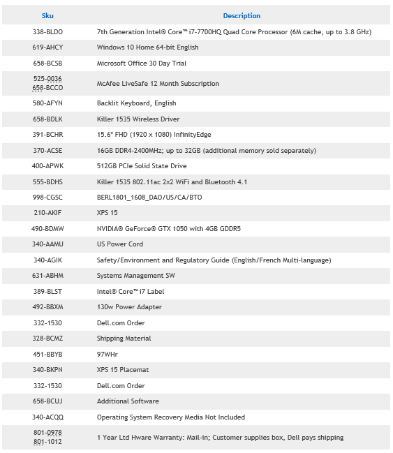

blazinsmokey Posted January 22, 2017 Share Posted January 22, 2017 I just purchased mine, waiting for delivery Jan 27-Feb 6. Parts list attached/below. Wish I would have seen that the SSD may not work, I got the 512GB was hoping to dual boot off it. Hopefully it does work or else I may have to wait for solution if at all possible. I assume purchasing a different WiFi card should be a fairly easy swap, any recommendations on what to get? Link to comment https://www.insanelymac.com/forum/topic/320016-dell-xps-15-9560-version-2017-compatibility-information/#findComment-2354171 Share on other sites More sharing options...
Krim404 Posted January 23, 2017 Author Share Posted January 23, 2017 Update: the latest LiteON and Hynix devices work now! http://www.insanelymac.com/forum/topic/319929-pikeralphas-nvme-patch-with-hynix-m2-ssds/?hl=%2Bhynix&do=findComment&comment=2348810 Link to comment https://www.insanelymac.com/forum/topic/320016-dell-xps-15-9560-version-2017-compatibility-information/#findComment-2354907 Share on other sites More sharing options...
blazinsmokey Posted January 24, 2017 Share Posted January 24, 2017 Update: the latest LiteON and Hynix devices work now! http://www.insanelymac.com/forum/topic/319929-pikeralphas-nvme-patch-with-hynix-m2-ssds/?hl=%2Bhynix&do=findComment&comment=2348810 This is awesome. Once I get my machine and pick a wifi card after some research, I'll be diving in on one of these weekends. Link to comment https://www.insanelymac.com/forum/topic/320016-dell-xps-15-9560-version-2017-compatibility-information/#findComment-2356040 Share on other sites More sharing options...

blazinsmokey Posted January 27, 2017 Share Posted January 27, 2017 According to some users who have received their 9560. 512GB - Samsung PM961 1TB - Lite-ON CX2-GB1024-Q11 1 Link to comment https://www.insanelymac.com/forum/topic/320016-dell-xps-15-9560-version-2017-compatibility-information/#findComment-2358318 Share on other sites More sharing options...
Krim404 Posted January 27, 2017 Author Share Posted January 27, 2017 According to some users who have received their 9560. 512GB - Samsung PM961 1TB - Lite-ON CX2-GB1024-Q11 at the moment all nvme ssds should work. Link to comment https://www.insanelymac.com/forum/topic/320016-dell-xps-15-9560-version-2017-compatibility-information/#findComment-2358480 Share on other sites More sharing options...
