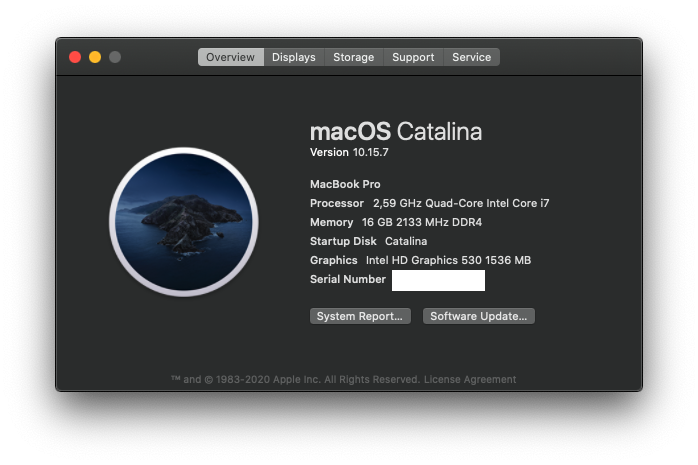

golimpio Posted August 4, 2020 Share Posted August 4, 2020 (edited) On 8/2/2020 at 4:30 PM, azeezsk said: Hi, could someone confirm the best boot time achieved, in my case its around 30 seconds on nvme 500gb ssd dual boot with win 10, which I think is slow. 39 seconds, from the Clover menu to the Login screen (verbose mode disabled) - XPS 15 9550 16GB / PM951 NVMe SAMSUNG 512GB Edited August 4, 2020 by golimpio Added ssd info Link to comment https://www.insanelymac.com/forum/topic/319764-guide-dell-xps-15-9550-mojave-1014-1015-quick-installation/page/71/#findComment-2732955 Share on other sites More sharing options...

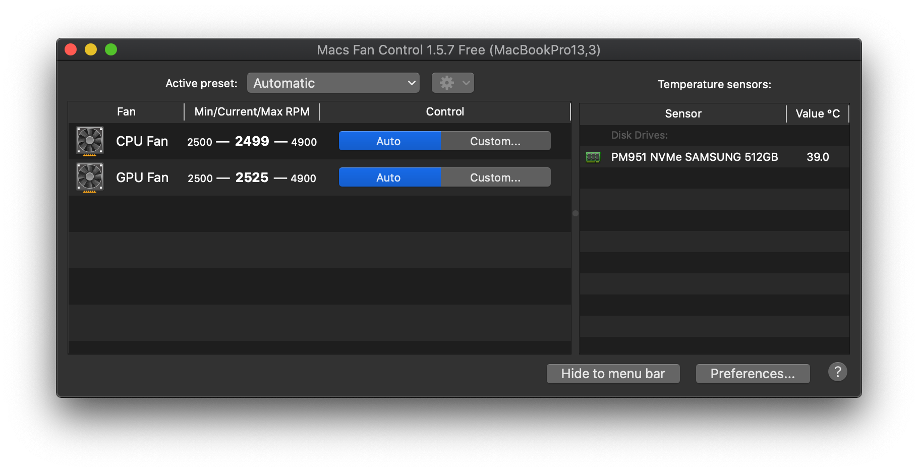

golimpio Posted August 4, 2020 Share Posted August 4, 2020 There is a new update for VirtualSMC that includes a new plugin: SMCDellSensors. From release notes: "Added a new plugin SMCDellSensors for Temp/FAN monitor/control". I've quickly tested it and it's now possible to control the fan speed through apps like Macs Fan Control. Spoiler 3 Link to comment https://www.insanelymac.com/forum/topic/319764-guide-dell-xps-15-9550-mojave-1014-1015-quick-installation/page/71/#findComment-2732962 Share on other sites More sharing options...

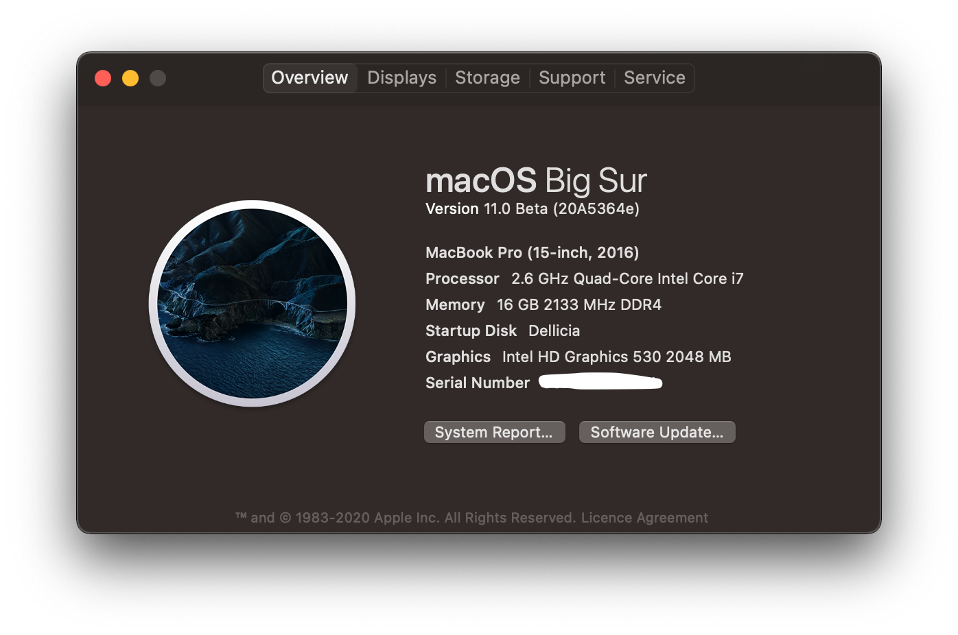

golimpio Posted September 11, 2020 Share Posted September 11, 2020 (edited) I've just upgraded to macOS Big Sur. Even though it's quite unstable at the moment (it rebooted twice in 3 hours), it does look promising, everything is working as it was in Catalina, no extra settings needed. I'm running the latest OpenCore for this and I haven't tested it with Clover, and since this is a bit off-topic, I'm not going to extend much this comment at the moment. The only trick I've done was to force the display to run at 48Hz as noted by xxxzc (I've tested and it didn't work without it). It was done using the normal MacOS software upgrade process, but it took a while and several restarts. Spoiler Edit 1: Part of the reason it was so unstable was because the firewall I was using (Lulu) isn't compatible with Big Sur yet. I've removed it and the system seems to be more stable now. Edit 2: At this moment I think the issue is with my PM951 NVMe, Big Sur doesn't seem to like it - All the KPs I experienced are related to it: panic(cpu 2 caller 0xffffff800bb42d36): nvme: "Fatal error occurred. CSTS=0x1 US[1]=0x0 US[0]=0x2bf VID=0x144d DID=0xa802 . FW Revision=BXV77D0Q\n"@/AppleInternal/BuildRoot/Library/Caches/com.apple.xbs/Sources/IONVMeFamily/IONVMeFamily-557.40.7/Common/IONVMeController.cpp:5454 Edited September 11, 2020 by golimpio Added a new note 1 Link to comment https://www.insanelymac.com/forum/topic/319764-guide-dell-xps-15-9550-mojave-1014-1015-quick-installation/page/71/#findComment-2737089 Share on other sites More sharing options...
agrafuese Posted September 12, 2020 Share Posted September 12, 2020 Thanks go! You are a pioneer for our machine Hopefully, it's just a matter of a new patch being developed. Exciting news nonetheless. 1 Link to comment https://www.insanelymac.com/forum/topic/319764-guide-dell-xps-15-9550-mojave-1014-1015-quick-installation/page/71/#findComment-2737196 Share on other sites More sharing options...
