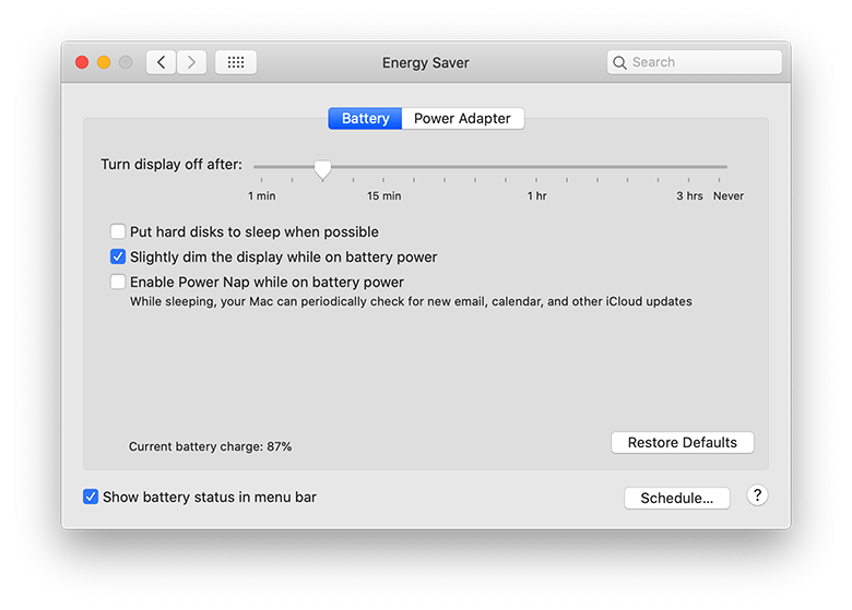

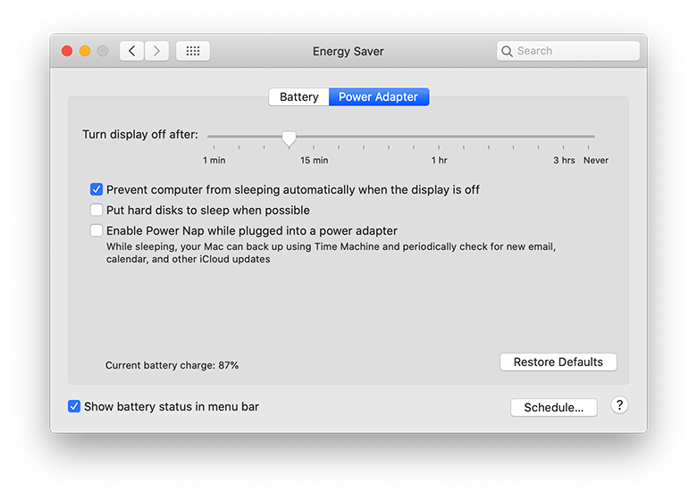

agrafuese Posted April 20, 2020 Share Posted April 20, 2020 I had a feeling you would say that about your sleep config I bet you will find that if you turn sleep on, unplug power, and close the lid, you will wake up to a reboot. Right now it's making me a very unhappy guy, because I can't close the laptop and move to a different place without shutting down first. This is the pmset error that it gives when you type: sudo pmset -g log | grep -i failure Quote Failure during sleep: 0xFFFFFFFF0000001F : EFI/Bootrom Failure after last point of entry to sleep I googled it, and no one has any specific answers to the problem. However, I am noticing that many of the results are fairly new, as if this has become a problem more recently - perhaps with Catalina, but I think some had been experiencing it since Mojave. I have compared our current setup to the old Mojave setup (because I never had sleep problems in Mojave), and sadly I couldn't find anything that would cause an issue like this. So, it is either something new with Catalina, or something new with Clover (or perhaps the newer kexts being used). Sorry to hear you are having that problem with invisible -v activation. I wish I knew more about Clover to suggest something. It is very odd. I always have -v on because it helps me predict when my trackpad is randomly not going to work (I have memorized what the error looks like when it scrolls by quickly, haha). I hope one of us here can figure out the sleep issue. Like I said, it only happens on battery power. Sleep works perfectly fine on AC power. I am obsessively looking for the answer. I may even rebuild the USB SSDT, as many results have pointed towards it being a potential fix. But the error above seems to be pointing at something else. Link to comment https://www.insanelymac.com/forum/topic/319764-guide-dell-xps-15-9550-mojave-1014-1015-quick-installation/page/68/#findComment-2718350 Share on other sites More sharing options...

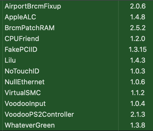

agrafuese Posted April 20, 2020 Share Posted April 20, 2020 These are the drivers I have loaded. Like you, I took out the others that you mentioned a couple days ago, trying to eliminate anything that might cause problems. Almost all of these came with the r5112 Clover installer, and they are all up to date as of now... AllocFix.efi ApfsDriverLoader.efi AppleKeyFeeder.efi AudioDxe.efi DataHubDxe.efi FirmwareVolume.efi FSInject.efi HFSPlus-64.efi NvmExpressDxe.efi OsxAptioFix3Drv.efi OsxFatBinaryDrv.efi VirtualSmc.efi Link to comment https://www.insanelymac.com/forum/topic/319764-guide-dell-xps-15-9550-mojave-1014-1015-quick-installation/page/68/#findComment-2718351 Share on other sites More sharing options...
golimpio Posted April 20, 2020 Share Posted April 20, 2020 (edited) 2 hours ago, agrafuese said: I had a feeling you would say that about your sleep config I bet you will find that if you turn sleep on, unplug power, and close the lid, you will wake up to a reboot. Right now it's making me a very unhappy guy, because I can't close the laptop and move to a different place without shutting down first. This is the pmset error that it gives when you type: sudo pmset -g log | grep -i failure Sorry, I couldn't replicate it. I've only tested it 3 times (unplugged) and I haven't any KP. I'll keep an eye on it. I've tested with the lid closed and without closing it. Note: I've updated Clover to r5113 and I've also updated all the drivers to match your list (so I should have the same EFIs that you have). At least this last update solved my problem. I think the "-v" was being loaded from the nvram file, and for some reason, even when I was deleting the nvram.plist file before, the "-v" option was coming back. I've attached an image from Hackintool with a partial list of the kexts/versions I'm using. The files I have on the kext/other folder are: AirportBrcmFixup.kext CPUFriendDataProvider.kext SMCBatteryManager.kext VirtualSMC.kext AppleALC.kext FakePCIID.kext SMCLightSensor.kext VoodooPS2Controller.kext BrcmBluetoothInjector.kext FakePCIID_Intel_HDMI_Audio.kext SMCProcessor.kext WhateverGreen.kext BrcmFirmwareData.kext Lilu.kext SMCSuperIO.kext BrcmPatchRAM3.kext NoTouchID.kext USBPorts.kext CPUFriend.kext SATA-100-series-unsupported.kext VerbStub.kext Edited April 20, 2020 by golimpio 1 Link to comment https://www.insanelymac.com/forum/topic/319764-guide-dell-xps-15-9550-mojave-1014-1015-quick-installation/page/68/#findComment-2718356 Share on other sites More sharing options...

agrafuese Posted April 20, 2020 Share Posted April 20, 2020 Thank you for your supportive suggestions and information, @golimpio . I am out of possible solutions/answers for now, or at least until I have enough time to rebuild some SSDTs, or do more research to try and figure out what I'm missing. We do indeed have the same kexts loaded as far as I can see (except I don't use NullEthernet.kext or VoodooInput - I took the plugin out of VoodooPS2Controller... but I did put it back in just as a control test, but it didn't affect anything). Here is a list of things I have done, if anyone reads this and has any suggestions: 1. Updated from Clover r5112 to r5113 (no affect). 2. Tried booting with and without: - SSDT-PCI0.aml - SSDT-UIAC.aml (note: I'm actually not sure what these do (I know UIAC is USB related, right?), but I focused on them because they are the only two UEFI files not in wmchris' repo.) 3. I tried turning on or off the following BIOS settings (because I saw them come up in sleep discussions): - Fastboot (minimal vs thorough) - Legacy Boot Rom (I can't remember the real name) - Touchscreen (only as a control test, since you don't use it, golimpio) 4. I have also taken out the I2C kexts, as another control test (since you don't use those either). 5. All of the "pmset" stuff, using all the different -a, -b, -c methods, states, and using "& reboot" after, as suggested by wmchris' guide. Also, like @kennylauer has mentioned, I noticed that the problem is the initial sleep state and not the "wake" part. I found this out after trying to sleep from the menubar as opposed to closing the lid. So yeah, choosing sleep in the menu bar is basically a way of powering off, haha. I have no choice but to give this until the end of the week, and if we don't find a solution, I'm going to have to revert back to Mojave, because I absolutely need this laptop to be able to sleep on battery power. By the way, @kennylauer do you have sleep issues on AC power, or just battery? Mine is only with battery. 1 Link to comment https://www.insanelymac.com/forum/topic/319764-guide-dell-xps-15-9550-mojave-1014-1015-quick-installation/page/68/#findComment-2718452 Share on other sites More sharing options...

agrafuese Posted April 21, 2020 Share Posted April 21, 2020 @golimpio !!! @kennylauer !!! I think I found the solution!!! I'm still very excited, so hopefully I am not missing something obvious here, but ... I went into /Library/Preferences and deleted the two plist files called com.apple.PowerManagement , rebooted, and now I get sleep with battery!! I have no idea why I have two. One of them is just the normal com.apple.PowerManagement.plist and one of them is com.apple.PowerManagement.Bunch-Of-Random-Numbers-And-Letters.plist . Both of them get regenerated upon reboot. I thought maybe only the normal one would, but that's not the case. I have no way of proving what I am about to say, but... I am highly suspicious of the "bless" problem when Catalina finishes installing. I think we are going to continue to see a lot of issues come up in the future that will eventually all link back to the bless problem. I have an unsupported (for now) theory that without blessing, there are various system file permission problems from the start, and they all need to be resolved within the system, after installing. In this case, I believe that deleting the plists and allowing the system to regenerate them fixes the file permissions in a way that other methods will not. The reason I can't fully support this theory is because fixing permissions manually (via Diskutil) SHOULD fix this problem. I tried doing this days ago outside of the OS (in Recovery Mode), but it did not fix anything. In fact, Disk Utility reported that everything was fine. So, I really don't know what else to say here. Someone with more knowledge could really help us clear this up. All of this aside, I am just VERY happy that I have battery sleep working again! 1 Link to comment https://www.insanelymac.com/forum/topic/319764-guide-dell-xps-15-9550-mojave-1014-1015-quick-installation/page/68/#findComment-2718513 Share on other sites More sharing options...
agrafuese Posted April 21, 2020 Share Posted April 21, 2020 (edited) 3 hours ago, golimpio said: As far as I remember, I still have the change from xxxzc github repository: "Use fake EC and update PMCR", so some of my ssdt are different because of it, like the additional ssdt-pci0 and a few changes to the config.plist. There is an additional ssdt-uiac, which was exported by hackintool. I was trying to solve an issue with my external usb hdd being disconnected from time to time and my wireless mouse not working properly when the usb adapter was plugged in the left USB port. I don't think it worked, but I never removed this ssdt. Because of it, I also have a different version for the USBPorts.kext I've removed the ssdt-alc298 from my setup, but I don't even remember why I've done it. Some of these changes I've done before Catalina and I just lost track of the reasons I've done them. I took out "Use fake EC and update PMCR" from mine and removed the related SSDTs a few days ago, and I didn't notice any difference with or without them. I reverted USBPorts.kext back to the original repository version, but I don't think it matters either. And there was a "high power" USB patch inside config.plist that I took out, because it seemed related to this stuff. I think I am pretty much back to the repository version of config.plist, except for some really minor preference-type stuff and a patch fix related to my hard drive. I removed the ALC298 as well and it had no impact that I could tell (I assume this is supposed to be audio-related?). In saying all of this, I'm not sure whether or not these changes will have an effect on things "behind the scenes" like power consumption or efficiency. I am no expert, and I continue to experiment and research what people say about all of these drivers/SSDTs/kexts. Some of them are harder to find info on than others. Many of them served a purpose at one time and then became outdated as new kexts or versions of Clover were released. You might remember me mentioning that a USB2 hub (unpowered) helped me with my USB hard drive problems. On the other hand, I use a wireless mouse with the receiver directly plugged in (both sides) and I've never had issues. It's hard to diagnose certain things sometimes with these laptops being about 4 years old now. For example, I recently discovered that my internal mic is physically damaged and that's the reason why it never worked - so it was not related to hackintosh at all. There are still some very minor features missing now that used to exist in the Mojave build. For example, the "slightly dim the display while on battery power" isn't working yet, and I don't think the auto brightness sensor is working anymore. None of this bothers me, but it's just something I have observed so far. Edited April 21, 2020 by agrafuese 1 Link to comment https://www.insanelymac.com/forum/topic/319764-guide-dell-xps-15-9550-mojave-1014-1015-quick-installation/page/68/#findComment-2718519 Share on other sites More sharing options...
agrafuese Posted April 21, 2020 Share Posted April 21, 2020 To confirm, I allowed my laptop to stay closed overnight for 7 hours, and it woke up perfectly fine. So, the PowerManagement.plist truly was the culprit in all of this. One thing I should also mention, I did my best to clear up any experimental sleep settings I may have applied earlier while I was trying to figure all of this out. I did the following: First I restored all power management defaults, both in the GUI system prefs and then via this Terminal command: sudo pmset restoredefaults Then, to be safe, I applied the "hibernate mode off + reboot" command to prevent the potential corruption issues described by wmchris in the guide, as shown here: sudo pmset -a hibernatemode 0 & sudo reboot I also made the sleepimage file unwriteable as an extra precaution to prevent hibernation writing to the drive at all, like so: sudo rm -f /private/var/vm/sleepimage sudo touch /private/var/vm/sleepimage sudo chflags uchg /private/var/vm/sleepimage I got most of these ideas from wmchris' script ([repo]/10.15/Post-Install/Additional Steps/Hibernation/disablehibernate.sh), but I didn't use the whole script because I'm not sure if I want everything else turned off. Then, I set energy settings in system prefs as I normally would. I'm attaching screenshots of my settings here. Link to comment https://www.insanelymac.com/forum/topic/319764-guide-dell-xps-15-9550-mojave-1014-1015-quick-installation/page/68/#findComment-2718638 Share on other sites More sharing options...
