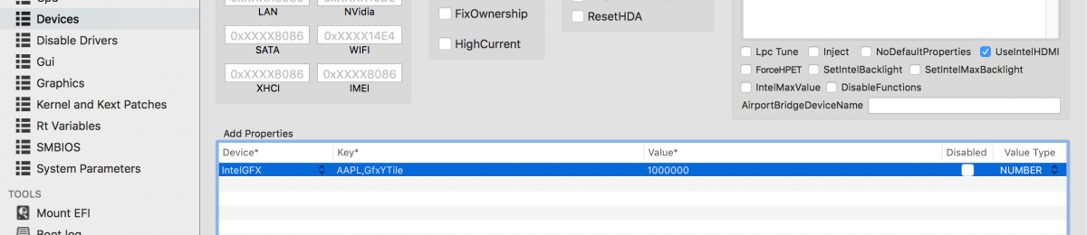

nayzebo Posted October 17, 2017 Share Posted October 17, 2017 let me know if you see anything wrong. Try to replace IntelGFX property from EAAAAA== to 1000000 as in the screenshot. I didn't find any other significant differences between your and my config.plist and boot.log Link to comment https://www.insanelymac.com/forum/topic/319656-guide-xiaomi-mi-notebook-air-13/page/19/#findComment-2517578 Share on other sites More sharing options...

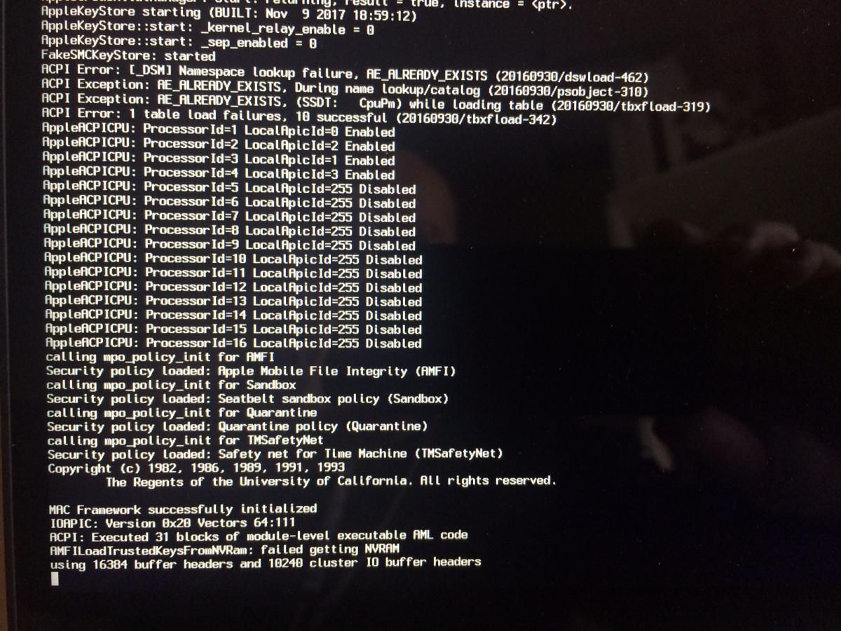

carlang59 Posted January 3, 2018 Share Posted January 3, 2018 Ho un notebook xiaomi air 13.3 con Intel Core i5-7200U Kaby Lake, RAM 8 GB DDR4 256 GB M.2 SSD, NVIDIA GeForce MX150. Vorrei installare 10.13.2 come guida. Usando il dual boot con win 10 senza doppio disco. Ho questo errore, AMFILoadTrustedKeysFromNVRam. Mi potete aiutare? Grazie j attact the image Link to comment https://www.insanelymac.com/forum/topic/319656-guide-xiaomi-mi-notebook-air-13/page/19/#findComment-2560727 Share on other sites More sharing options...

McBanjo Posted January 12, 2018 Share Posted January 12, 2018 it sounds no HELP available on this website! ;-( What do you need help with? Your last post suggests you were starting from scratch with a USB key - how did that go? Are you getting the prohibition symbol? That's normally a kernel panic, I've had it before due to a bad kext install with EasyKextPro and it might require a fresh reinstall. You can sometimes find out more about the issue by booting into verbose mode and reading the text before the crash and reboot. I've previously had to video record the screen to read the text. Double-check your EFI volumes have the required files in it. If you have Windows, you can load the EFI to check there. I followed my steps to upgrade from Sierra to High Sierra and it worked for me. By select twice I mean the boot volume needs to be selected once, then it reboots and you have to select it again a 2nd time to finalise the setup. Note your mileage may vary as the High Sierra installer has been updated since I tried. I would suggest that you start from scratch. 1 Link to comment https://www.insanelymac.com/forum/topic/319656-guide-xiaomi-mi-notebook-air-13/page/19/#findComment-2567621 Share on other sites More sharing options...
