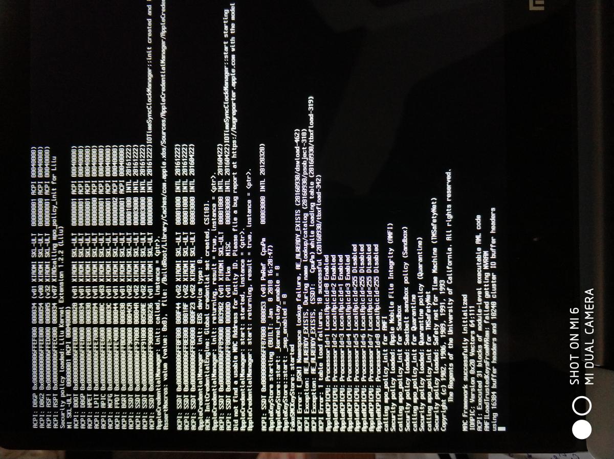

bergui45 Posted February 7, 2018 Share Posted February 7, 2018 hello Sakoula, IT DOESN’T WORK! It sounds using the same serials in your config.plist is not a wize idea! OK it works on your computer with your serials… ACPI exception : AE_ALREADY_EXISTS… AMFILOadTrustedKeys from NVRAM failed getting NVRAM So I will try using my old serials that worked on Sierra instead… Alternatively I may generate my own new serials with Clover configurator… obviously like M.Banjo said " Copy previous SMBIOS informations to the config.plist included in the 2.1 download and add to EFI volume... Link to comment https://www.insanelymac.com/forum/topic/319656-guide-xiaomi-mi-notebook-air-13/page/23/#findComment-2586452 Share on other sites More sharing options...
sakoula Posted February 7, 2018 Share Posted February 7, 2018 bergui45, the serials do not matter during installation. This is NOT a config.plist problem. I think it is more of an NVRAM issue of the BIOS. Since you have been using macOS Sierra most likely macOS have been writing on the 'nvram segment'. For some reason now it cannot read it any more. Try the following: 1. get into the BIOS and reset your BIOS settings to default/factory setting. I hope that this will reset the nvram area as well. Make sure that you know what settings you have change in order to make the changes again. I think this is more likely your problem. If this will not work: 2. let clover handle the NVRAM on a software layer: reinstall clover on the stick using the following options ``` Install for UEFI booting only Install Clover in the ESP Drivers64UEFI > EmuVariableUefi-64 Drivers64UEFI > OsxAptioFix2Drv-64 Drivers64UEFI > OsxFatBinaryDrv-64 Install RC scripts on target volume ``` After doing this copy from my latest zip the CLOVER folder but DO_NOT_OVERWRITE the drivers64UEFI directory. see if it boots. Link to comment https://www.insanelymac.com/forum/topic/319656-guide-xiaomi-mi-notebook-air-13/page/23/#findComment-2586466 Share on other sites More sharing options...
bergui45 Posted February 7, 2018 Share Posted February 7, 2018 hello Sakoula, Booting while pressing F2 then you are in the BIOS The only thing i find is F9 = Setup Defaults Let me know should i do that : hitting F9 ? DO_NOT_OVERWRITE the drivers64UEFI directory. But it is what i've done while copy & paste from your folder...? Link to comment https://www.insanelymac.com/forum/topic/319656-guide-xiaomi-mi-notebook-air-13/page/23/#findComment-2586499 Share on other sites More sharing options...
sakoula Posted February 7, 2018 Share Posted February 7, 2018 Try using F9 to get the factory defaults. Try to boot. If this will not work then try the attached clover zip and overwrite the CLOVER dir (I have made all the necessary changes and updated the zip). clover.xiaomi.4392.20180207.zip Link to comment https://www.insanelymac.com/forum/topic/319656-guide-xiaomi-mi-notebook-air-13/page/23/#findComment-2586970 Share on other sites More sharing options...

bergui45 Posted February 8, 2018 Share Posted February 8, 2018 so after resetting the Bios to factory defaults (F9) i still have the ACPI error: AE_ALREADY_Exists. ????? Link to comment https://www.insanelymac.com/forum/topic/319656-guide-xiaomi-mi-notebook-air-13/page/23/#findComment-2587199 Share on other sites More sharing options...
sakoula Posted February 8, 2018 Share Posted February 8, 2018 ok try the latest clover zip I have provided Link to comment https://www.insanelymac.com/forum/topic/319656-guide-xiaomi-mi-notebook-air-13/page/23/#findComment-2587202 Share on other sites More sharing options...
