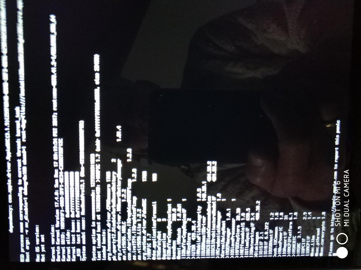

bergui45 Posted February 9, 2018 Share Posted February 9, 2018 hello sakoula, could you please understand what's in the provided crash log? Link to comment https://www.insanelymac.com/forum/topic/319656-guide-xiaomi-mi-notebook-air-13/page/24/#findComment-2587802 Share on other sites More sharing options...

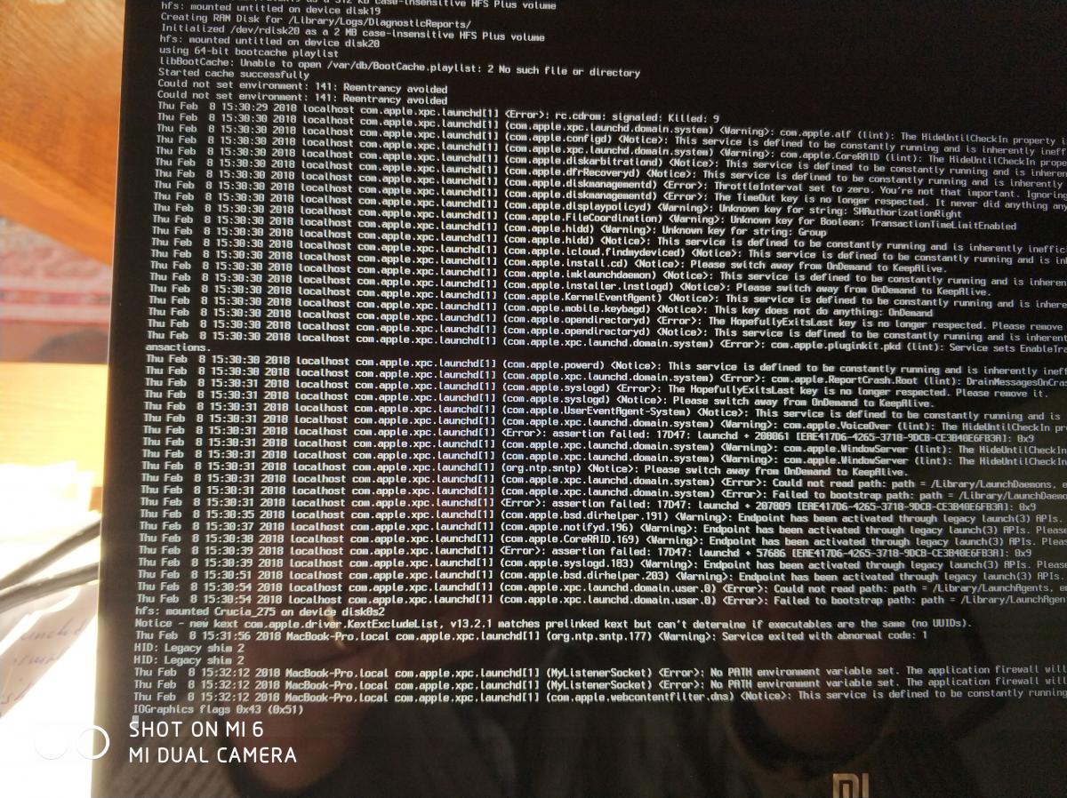

bergui45 Posted February 9, 2018 Share Posted February 9, 2018 hello Sakoula, Thanx for your support! Since in all my previous unsuccessful attempts, sometimes i stayed STUCK for more than one hour, now i press the Power BTN to exit HELL, without WAITING anymore, but this brutal exit commits some directory errors on the SATA disk... Link to comment https://www.insanelymac.com/forum/topic/319656-guide-xiaomi-mi-notebook-air-13/page/24/#findComment-2587876 Share on other sites More sharing options...
sakoula Posted February 9, 2018 Share Posted February 9, 2018 latest crashlog.jpg hello Sakoula, Thanx for your support! Since in all my previous unsuccessful attempts, sometimes i stayed STUCK for more than one hour, now i press the Power BTN to exit HELL, without WAITING anymore, but this brutal exit commits some directory errors on the SATA disk... @bergui45 this screenshot is a different one than the one you posted a couple of posts before. I assume you edited the drivers64UEFI directory and removed the EmuVariableUefi-64.efi is that correct? Also do not use the files from ClaudesTech zip because there is a chance that they will not be compatible with the clover version that you have used. sakoula Link to comment https://www.insanelymac.com/forum/topic/319656-guide-xiaomi-mi-notebook-air-13/page/24/#findComment-2587883 Share on other sites More sharing options...

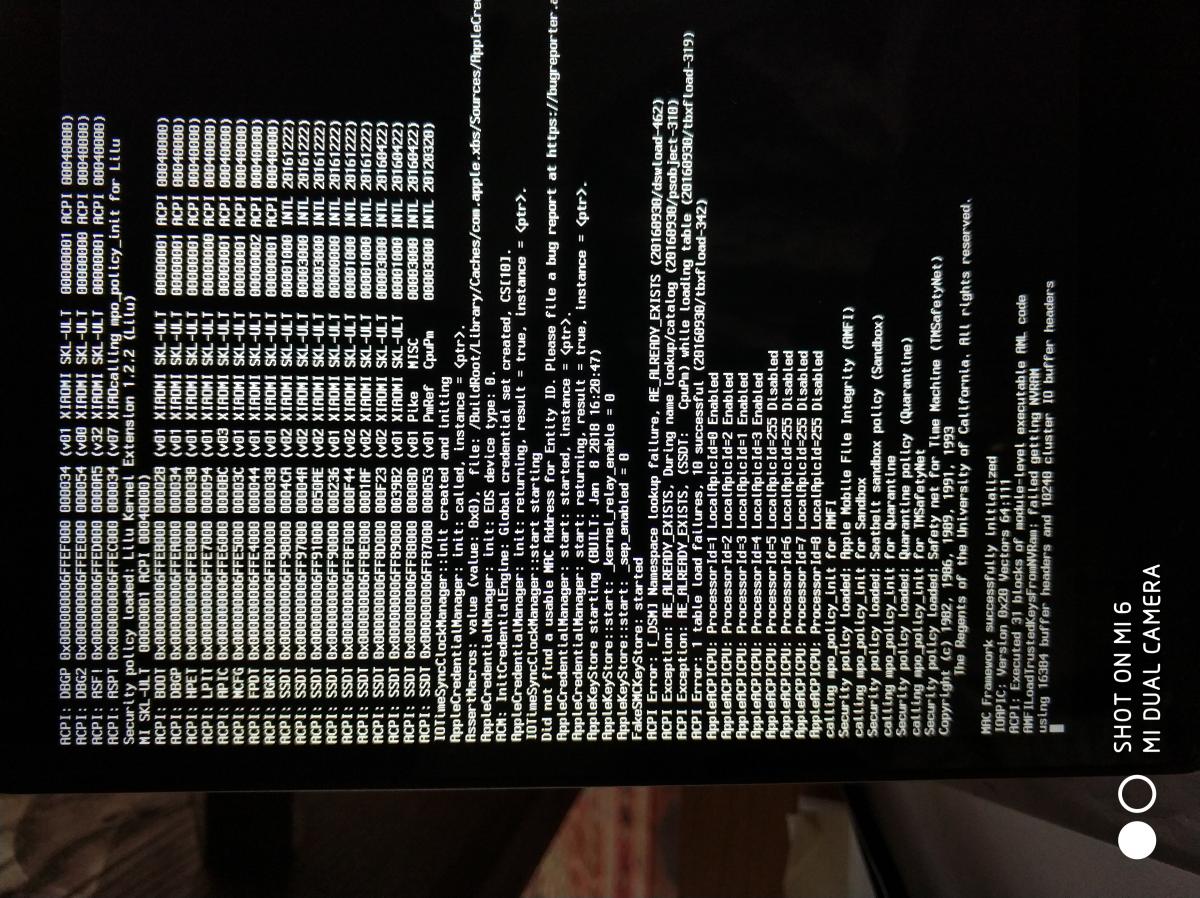

bergui45 Posted February 9, 2018 Share Posted February 9, 2018 YES i tried some mods but unfortunately with no success... So i re tried with your unmodified .zip and it sounds to progress farther in the process but finally it stucks also with: Service exited with abnormal code:1 Service only ran for 0 seconds Pushing respawnout by 10 seconds. Then one full hour later it was still stuck at the same point so no alternative solution than pushing PWR BTN until STOP... Holy sh... Link to comment https://www.insanelymac.com/forum/topic/319656-guide-xiaomi-mi-notebook-air-13/page/24/#findComment-2588000 Share on other sites More sharing options...
sakoula Posted February 9, 2018 Share Posted February 9, 2018 YES i tried some mods but unfortunately with no success... So i re tried with your unmodified .zip and it sounds to progress farther in the process but finally it stucks also with: Service exited with abnormal code:1 Service only ran for 0 seconds Pushing respawnout by 10 seconds. Then one full hour later it was still stuck at the same point so no alternative solution than pushing PWR BTN until STOP... Holy sh... Can you please take a screenshot of the error. BTW can you boot on the recovery partition on your 10.12 installation? Is it still available? sakoula Link to comment https://www.insanelymac.com/forum/topic/319656-guide-xiaomi-mi-notebook-air-13/page/24/#findComment-2588012 Share on other sites More sharing options...
bergui45 Posted February 9, 2018 Share Posted February 9, 2018 OK i will try again to take another screenshot Let me know how to boot from the recovery of 10.12? Link to comment https://www.insanelymac.com/forum/topic/319656-guide-xiaomi-mi-notebook-air-13/page/24/#findComment-2588048 Share on other sites More sharing options...
sakoula Posted February 9, 2018 Share Posted February 9, 2018 you said that you had 10.12 installed. what happened and you that made 10.12 unbootable? also when you get on the clover boot menu how many items do you see and what is it written underneath them? Are you sure you are booting from the USB stick or do you boot from the disk which has the old 10.12 installation? Link to comment https://www.insanelymac.com/forum/topic/319656-guide-xiaomi-mi-notebook-air-13/page/24/#findComment-2588174 Share on other sites More sharing options...
bergui45 Posted February 9, 2018 Share Posted February 9, 2018 When i used the HS installer from the 10.12 running on the Xiaomi it went un bootable...? So i format the Sata disk in order to reinstall HS from the USB stick. I have a Time Machine sauvegarde on another SSD but i do not have Time machine on the USB stick installer... YES i'm sure i was booting from the USB installer On the Clover boot menu i have 2 choices install HS or Boot Windows... Unfortunately no Recover partition... Really the sh... hits the fan Link to comment https://www.insanelymac.com/forum/topic/319656-guide-xiaomi-mi-notebook-air-13/page/24/#findComment-2588200 Share on other sites More sharing options...

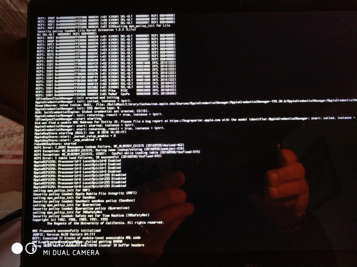

bergui45 Posted February 11, 2018 Share Posted February 11, 2018 The answer is NO! I have removed the superuser password in the BIOS There is still the same error ACPI error did not find a usable Mac address for Entity ID I have read on Tonymac that AptiomemoryFix.efi instead of OSXAptioFix.efi may allow native NVRAM to work on platform where it typically does not...? Also: DVMT-prealloc on Skylake /Kabylake: The Skylake graphic kexts provided by Apple require DVMT-prealloc to be set at 64 mb! But many laptops set it by defaults to 32 mb which is not large enough and will cause KP (kernel panic) I did not find where to check wether in BIOS or in Clover if DVMT-prealloc is correctly set to 64 mb? Link to comment https://www.insanelymac.com/forum/topic/319656-guide-xiaomi-mi-notebook-air-13/page/24/#findComment-2589484 Share on other sites More sharing options...
bergui45 Posted February 11, 2018 Share Posted February 11, 2018 Rehabman from tonymac answered: No "Problem Reporting" files attached. Read FAQ, "Problem Reporting" again. Carefully. Attach all requested files/output. It's far beyond my capabilities of understanding what the mess i'm suffering to get a KP when trying to install HS Sakoula i'm waiting for you to find the culprit on my {censored}stem... Link to comment https://www.insanelymac.com/forum/topic/319656-guide-xiaomi-mi-notebook-air-13/page/24/#findComment-2589574 Share on other sites More sharing options...
sakoula Posted February 11, 2018 Share Posted February 11, 2018 @bergui45, You are attaching screenshots with different errors. I am not sure what exactly you are doing. To help you need to be very clear and accurate on what exactly you tried and what was the result. Let's start from the beginning: 1. On the premade USB stick you need to install the latest clover by selecting the following options: ```Install for UEFI booting onlyInstall Clover in the ESPDrivers64UEFI > EmuVariableUefi-64Drivers64UEFI > OsxAptioFix2Drv-64Drivers64UEFI > OsxFatBinaryDrv-64Install RC scripts on target volume``` 2. get the latest zip I posted on the thread and on the EFI partition remove the installed CLOVER directory and substitite it with the CLOVER from the zip file. 3. boot from the USB stick use the FAKE id as described in the first post. Post photos of the output (make sure the photo is clear). 4. zip the contents of the EFI partition you are using on the USB stick and post it on this thread. It is either that something you are doing is wrong, or there is something wrong with your laptop and you need to report it to RehabMan with the procedures he mentions on the thread. sakoula Link to comment https://www.insanelymac.com/forum/topic/319656-guide-xiaomi-mi-notebook-air-13/page/24/#findComment-2589659 Share on other sites More sharing options...
bergui45 Posted February 11, 2018 Share Posted February 11, 2018 EFI.zip Thanx a lot sakoula: this morning i did exactly what you said EXCEPT that i Boot without Fake ID. OK i will retry with Fake ID in Misc there is a log file after chassis type:0x9 ERROR invalid custom UUID should be in the format xxxxxxxxx-xxxx-xxxx-xxxxxxxx.....? Result of Bootcode detection: bootable unknown (legacy) So my config.plist is a great piece of {censored} Bernard Link to comment https://www.insanelymac.com/forum/topic/319656-guide-xiaomi-mi-notebook-air-13/page/24/#findComment-2589671 Share on other sites More sharing options...
