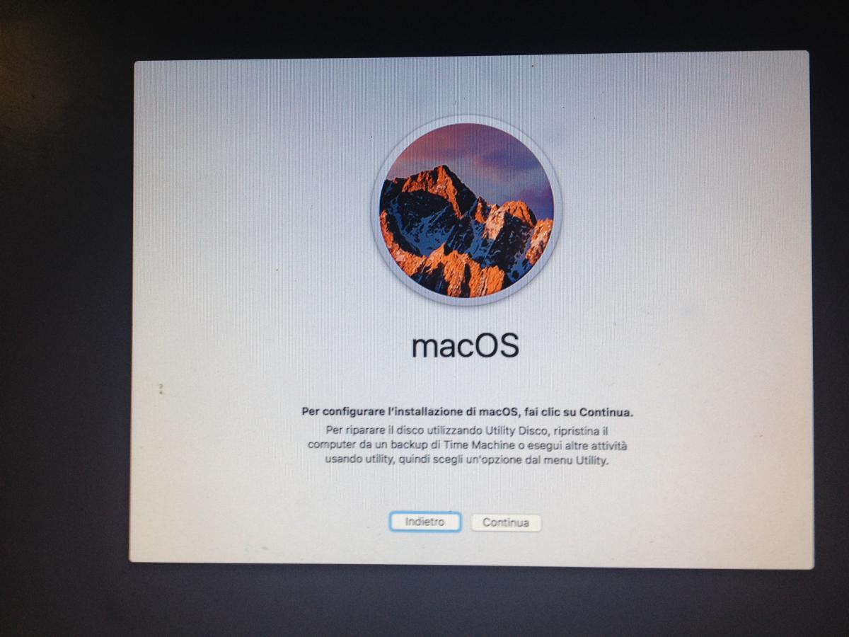

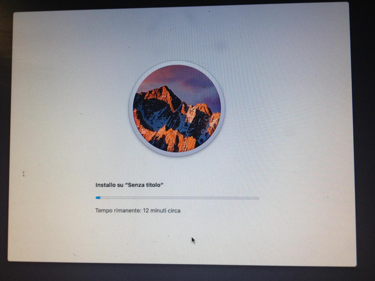

carlo_67 Posted September 28, 2016 Share Posted September 28, 2016 montato un Q9400 smontato da un hp El Capitan non partiva, rifatto DSDT....... Partito Creata USB con command di Gengik84 istallato clover, SmBios impostato MacPro6.1, iMac10,1 - iMac 13.2 - MacPro5.1-4.1 non partiva la USB Link to comment https://www.insanelymac.com/forum/topic/315622-non-riesco-ad-arrivare-allinstallersierra/page/3/#findComment-2287999 Share on other sites More sharing options...
Jolly Posted September 28, 2016 Share Posted September 28, 2016 Bel lavoro, ottime notizie. Link to comment https://www.insanelymac.com/forum/topic/315622-non-riesco-ad-arrivare-allinstallersierra/page/3/#findComment-2288019 Share on other sites More sharing options...
carlo_67 Posted September 28, 2016 Share Posted September 28, 2016 istallazione eseguita anche direttamente da istaller Link to comment https://www.insanelymac.com/forum/topic/315622-non-riesco-ad-arrivare-allinstallersierra/page/3/#findComment-2288133 Share on other sites More sharing options...

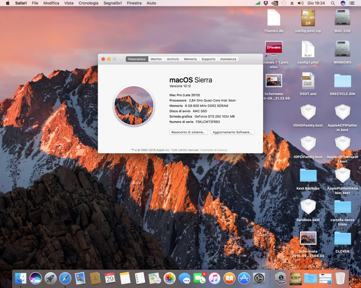

carlo_67 Posted September 29, 2016 Share Posted September 29, 2016 Arrivato oggi Cpu Q9505 perfetto anche lui, aggiornato DSDT, anche se il sistema è partito senza farlo Link to comment https://www.insanelymac.com/forum/topic/315622-non-riesco-ad-arrivare-allinstallersierra/page/3/#findComment-2288908 Share on other sites More sharing options...
Jolly Posted September 29, 2016 Share Posted September 29, 2016 Probabilmente non avendo SSE4 il DSDT per il Q6600 era totalmente inadeguato per la serie 9, invece a parità di processore ti permetteva lo stesso il boot. Però è giusto rifarlo Link to comment https://www.insanelymac.com/forum/topic/315622-non-riesco-ad-arrivare-allinstallersierra/page/3/#findComment-2288922 Share on other sites More sharing options...
