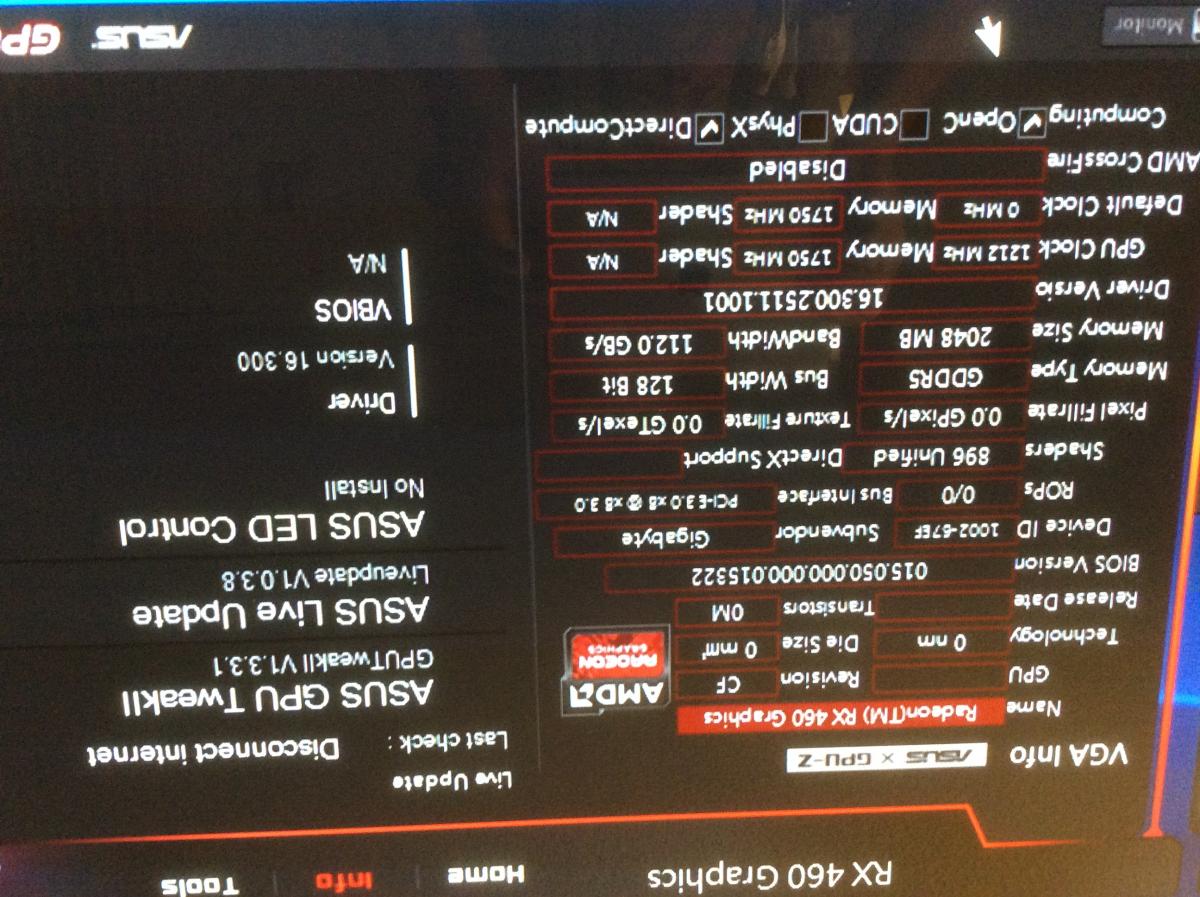

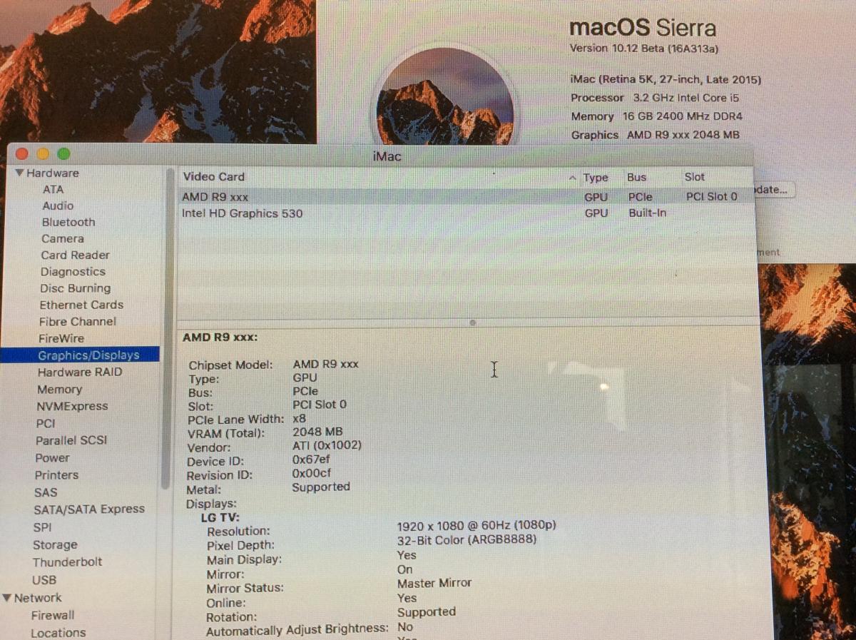

Gigamaxx Posted August 30, 2016 Share Posted August 30, 2016 (edited) I picked up a new RX 460 yesterday and after booting up with my normal Sierra i did the Beta 7 update, and viola! its supported.i tried my ASUS, and XFX RX 460 cards but they are not compatible and i get a boot flag when i try to load with them.GIGABYTE VBIOS is now running close to native style in Sierra after BETA 7 update.ANYONE have a GIGABYTE RX 480 to try out? beta 7 supports the RX 460 2 g model. i thought about this model because it doesn't have a 6 pin power connector so its likely to be a laptop compatible model. it worked and will work for you OUT OF BOX with Sierra BETA 7.BIOS settings are primary graphics (igfx) and plug HDMI into graphics card it will go black screen during boot up but the last part will show up and you end up with log in screen. uningine went from 10-15 fps with igfx to 70+ with graphics card.GIGABYTE for the win, no pun intended for EVGA fans.Update: I'm having similar luck and good results with a MSI RX 470 4gb Gaming. See more posts. Higher benchmarks and decent temps. Edited September 5, 2016 by fantomas1 Topic Title has been edited for a better relevance! 1 Link to comment https://www.insanelymac.com/forum/topic/314745-gigabyte-rx-460-2g-partial-support-in-sierra/ Share on other sites More sharing options...
Ciro82 Posted August 30, 2016 Share Posted August 30, 2016 I picked up a new RX 460 yesterday and after booting up with my normal Sierra i did the Beta 7 update, and viola! its supported. i tried my ASUS, and XFX RX 460 cards but they are not compatible and i get a boot flag when i try to load with them. GIGABYTE VBIOS is now native in Sierra after BETA 7 update. ANYONE have a GIGABYTE RX 480 to try out? beta 7 supports the RX 460 2 g model. i thought about this model because it doesn't have a 6 pin power connector so its likely to be a laptop compatible model. it worked and will work for you OUT OF BOX with Sierra BETA 7. BIOS settings are primary graphics (igfx) and plug HDMI into graphics card it will go black screen during boot up but the last part will show up and you end up with log in screen. uningine went from 10-15 fps with igfx to 70+ with graphics card. GIGABYTE for the win, no pun intended for EVGA fans. How do you expect support for the RX 480 without the Ellesmere section in the X4000 kext? Gigabyte has nothing to do with the support from Apple, you have been lucky with that model, that's all... 1 Link to comment https://www.insanelymac.com/forum/topic/314745-gigabyte-rx-460-2g-partial-support-in-sierra/#findComment-2271631 Share on other sites More sharing options...
Gigamaxx Posted August 30, 2016 Author Share Posted August 30, 2016 How do you expect support for the RX 480 without the Ellesmere section in the X4000 kext? Gigabyte has nothing to do with the support from Apple, you have been lucky with that model, that's all... It's covered by Baffin, my Gigabyte RX 460 works out of box on Beta 7. I bought two and they both are supported in Sierra. It's the Polaris 11 with no 6 pin power supply. A board that will go into laptops? Only 2 g but it has support and my other two cards have none. Has anyone else had a supported card? My others don't pass the metal. It roars up when I boot into Sierra at about mid boot, then makes that characteristic whoosh sound when it's at Password screen. I'm running it with HDMI attached to card during boot. Link to comment https://www.insanelymac.com/forum/topic/314745-gigabyte-rx-460-2g-partial-support-in-sierra/#findComment-2271757 Share on other sites More sharing options...
Ciro82 Posted August 30, 2016 Share Posted August 30, 2016 It's covered by Baffin, my Gigabyte RX 460 works out of box on Beta 7. I bought two and they both are supported in Sierra. It's the Polaris 11 with no 6 pin power supply. A board that will go into laptops? Only 2 g but it has support and my other two cards have none. Of course RX 460 is supported because Baffin is fully implemented. But you can't tell me that the RX480 will be "covered" by Baffin, it's not right... Forcing the RX480 ID in the X4000 Baffin section is totally wrong and useless. Again, we have to wait Apple and eventually the future support for Polaris 10. 1 Link to comment https://www.insanelymac.com/forum/topic/314745-gigabyte-rx-460-2g-partial-support-in-sierra/#findComment-2271774 Share on other sites More sharing options...

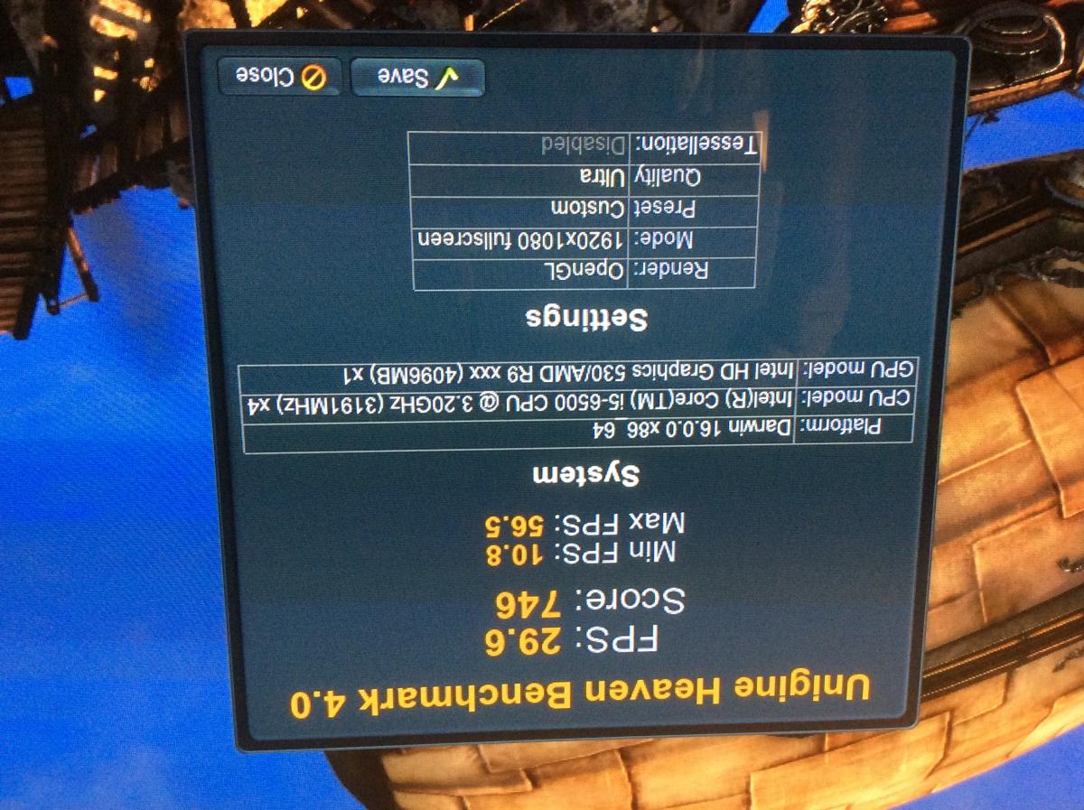

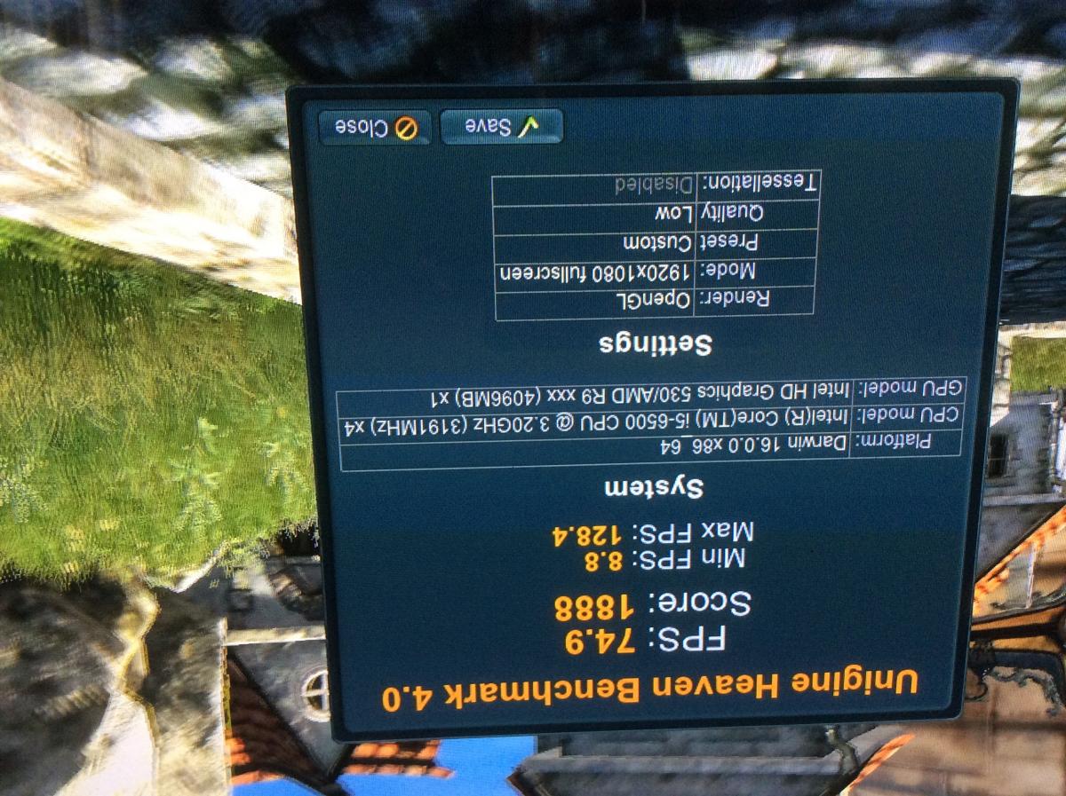

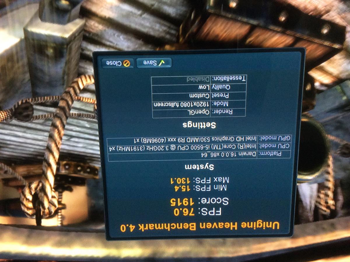

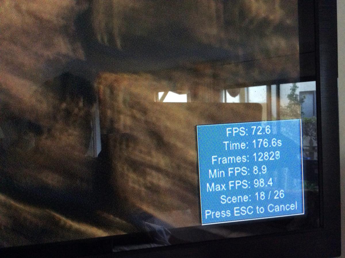

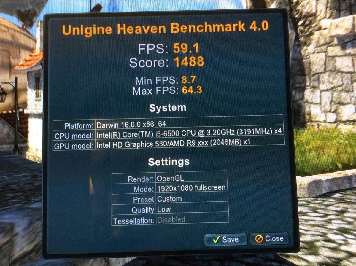

stehor Posted August 30, 2016 Share Posted August 30, 2016 gigamaxx can you run unigine heaven without any freezes and do you need fixdisplay fix in clover thx. Link to comment https://www.insanelymac.com/forum/topic/314745-gigabyte-rx-460-2g-partial-support-in-sierra/#findComment-2271847 Share on other sites More sharing options...
Gigamaxx Posted September 1, 2016 Author Share Posted September 1, 2016 gigamaxx can you run unigine heaven without any freezes and do you need fixdisplay fix in clover thx. some benchmarks Link to comment https://www.insanelymac.com/forum/topic/314745-gigabyte-rx-460-2g-partial-support-in-sierra/#findComment-2272324 Share on other sites More sharing options...
stehor Posted September 1, 2016 Share Posted September 1, 2016 perhaps you could use dropbox or the like and zip it please so we can test your rom thx Link to comment https://www.insanelymac.com/forum/topic/314745-gigabyte-rx-460-2g-partial-support-in-sierra/#findComment-2272336 Share on other sites More sharing options...

Matthew82 Posted September 1, 2016 Share Posted September 1, 2016 Boot without IGPU. If it boot without Intel graphic it is to mean that it natively working. Link to comment https://www.insanelymac.com/forum/topic/314745-gigabyte-rx-460-2g-partial-support-in-sierra/#findComment-2272426 Share on other sites More sharing options...
Ciro82 Posted September 1, 2016 Share Posted September 1, 2016 Boot without IGPU. If it boot without Intel graphic it is to mean that it natively working. Exactly And it's definitely not OOB yet... 1 Link to comment https://www.insanelymac.com/forum/topic/314745-gigabyte-rx-460-2g-partial-support-in-sierra/#findComment-2272432 Share on other sites More sharing options...
Matthew82 Posted September 1, 2016 Share Posted September 1, 2016 If you run fcpx and same render test gpu performance will be slow dawn to slower gpu (in this case IntelGpu) Link to comment https://www.insanelymac.com/forum/topic/314745-gigabyte-rx-460-2g-partial-support-in-sierra/#findComment-2272435 Share on other sites More sharing options...
Gigamaxx Posted September 1, 2016 Author Share Posted September 1, 2016 (edited) If you set your bios to IGFX as primary, and use auto not enable or disable it works out of box. I have three Gigabyte cards and they all worked without any other settings than the IGFX. Think about it, it's integrated graphics blending which will kick serious butt when direct x 12 becomes mainstream.The black screen at boot until the password is because this is a secondary monitor card. If you have two monitors one will pick up the clover process (board HDMI) and the graphics card monitor boots at password.How can you say it's not OOB when you haven't tried it? I have an Asus and XFX 460 that do not get support status in system info. I have benchmarks and video to show it works, better than any I've seen at without framebuffer and Vbios mods, it fires right up with no glitches.If I boot with one monitor and HDMI attached to IGFX it runs Unigine on low settings in the 15 fps range, I plug the HDMI into graphics card and it's the same rate.Reboot with HDMI attached to card and it goes to 70-130 fps on low settings. I will return my other cards and get another monitor so I can test further but I will tell you I've tried to run the other cards in Unigine and they always die unless you use the IGFX which only gives you 15 fps on low settings. THIS CARD WORKS! Again, we have to wait Apple and eventually the future support for Polaris 10. If you run fcpx and same render test gpu performance will be slow dawn to slower gpu (in this case IntelGpu) Or I can run the HDMI out of the board, I will look into this fcpx, and post anything I find, good or bad. Edited September 1, 2016 by Allan 1 Link to comment https://www.insanelymac.com/forum/topic/314745-gigabyte-rx-460-2g-partial-support-in-sierra/#findComment-2272482 Share on other sites More sharing options...
