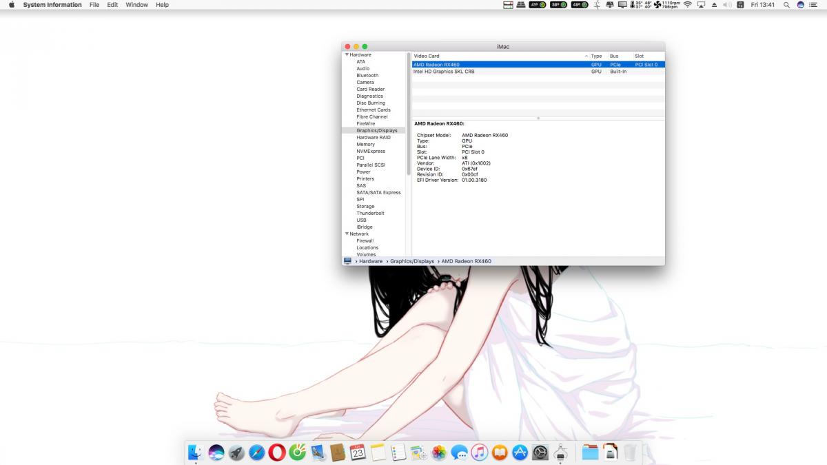

Sypack Posted December 7, 2016 Share Posted December 7, 2016 Would anyone be so kind to help me please. I've installed a Gigabyte rx460 2gb card and the card is not recognized by MacOS as shown in screenshots. I must be doing something wrong but i don't get it because it's should work OOB. thank you. Link to comment https://www.insanelymac.com/forum/topic/314745-gigabyte-rx-460-2g-partial-support-in-sierra/page/3/#findComment-2330714 Share on other sites More sharing options...
Gigamaxx Posted December 7, 2016 Author Share Posted December 7, 2016 If you are using the latest clover and inject ATI you should get the name correct. The R9 XXX is the default name given in AMD9500Controller.kext. It is cosmetic and you have metal supported status and 30 bit color. You can fix it using clover injection or iHex but it won't increase performance. Link to comment https://www.insanelymac.com/forum/topic/314745-gigabyte-rx-460-2g-partial-support-in-sierra/page/3/#findComment-2330792 Share on other sites More sharing options...
