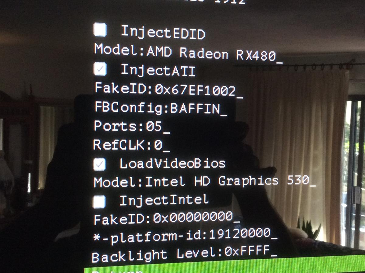

Ciro82 Posted September 2, 2016 Share Posted September 2, 2016 Baffin contains 67df1002 which is the RX 480 code. 9500 has it as well. Wrong, Baffin does not contain the RX480 ID. Man are you kidding me? Tell me what you want to do. RX480 is ELLESMERE Why are you posting wrong information? Have you even read my thread about Polaris and Sierra? Link to comment https://www.insanelymac.com/forum/topic/314745-gigabyte-rx-460-2g-partial-support-in-sierra/page/2/#findComment-2272996 Share on other sites More sharing options...

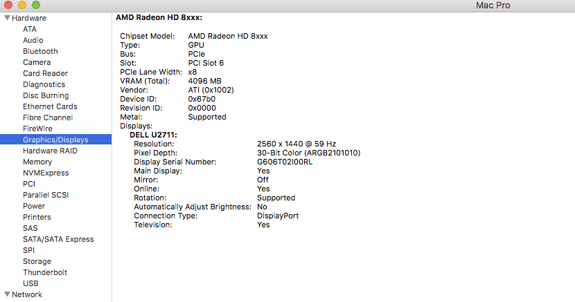

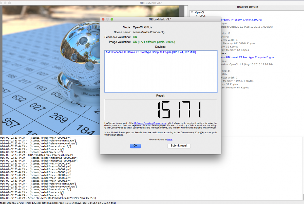

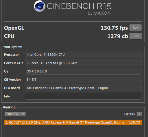

Matthew82 Posted September 3, 2016 Share Posted September 3, 2016 I think it is important subject, but admin should move this to AMD>Graphics section and change name for "290x/390x/RX 460, 470, 480 Native Sierra support" Yesterday I make experiment and put to the first slot HD 5770 to run from secend 290X. This is results: Heaven benchmark is 5 fps lower then El Capitan nice surprise is that USB 3.1 from ASUS is working Link to comment https://www.insanelymac.com/forum/topic/314745-gigabyte-rx-460-2g-partial-support-in-sierra/page/2/#findComment-2273160 Share on other sites More sharing options...

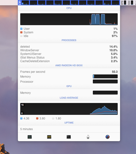

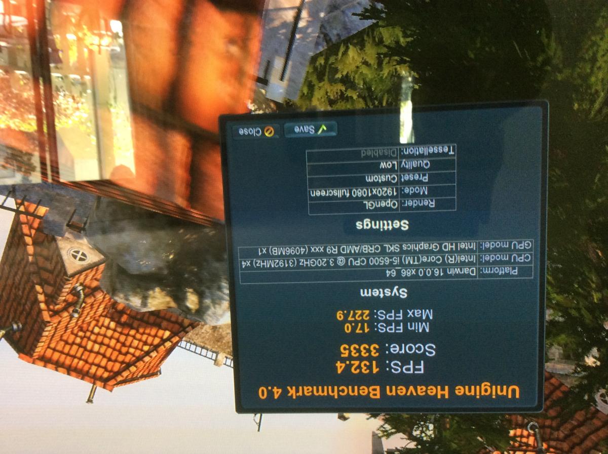

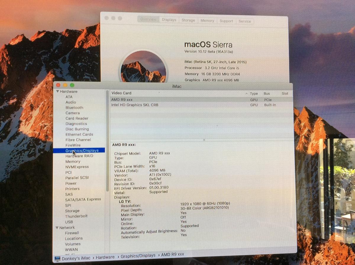

Gigamaxx Posted September 4, 2016 Author Share Posted September 4, 2016 Here's a benchmark I got today from an MSI RX 470 4g gaming. I did this to get in. Adjusted bios settings to IGFX as primary and set to auto in chipset window. Boot with HDMI attached to card to get acceleration. Link to comment https://www.insanelymac.com/forum/topic/314745-gigabyte-rx-460-2g-partial-support-in-sierra/page/2/#findComment-2273991 Share on other sites More sharing options...

Gigamaxx Posted September 4, 2016 Author Share Posted September 4, 2016 Wrong, Baffin does not contain the RX480 ID. Man are you kidding me? Tell me what you want to do. RX480 is ELLESMERE Why are you posting wrong information? Have you even read my thread about Polaris and Sierra? Wrong, Baffin does not contain the RX480 ID. Man are you kidding me? Tell me what you want to do. RX480 is ELLESMERE Why are you posting wrong information? Have you even read my thread about Polaris and Sierra? You're right and I can put it in there by changing 2 letters. EO to DF. And get my XFX RX 480 to get support status. It's wickedly unstable but it works. Link to comment https://www.insanelymac.com/forum/topic/314745-gigabyte-rx-460-2g-partial-support-in-sierra/page/2/#findComment-2274012 Share on other sites More sharing options...

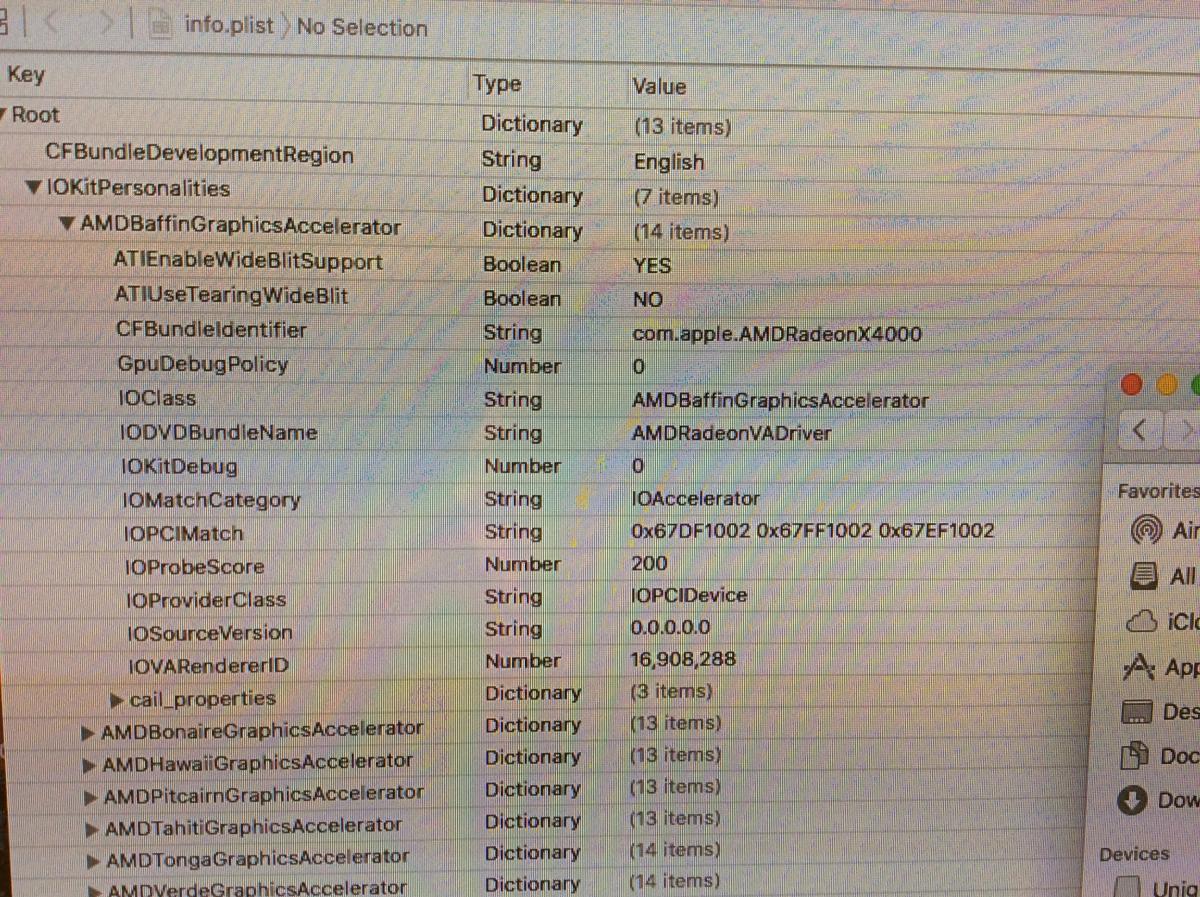

fantomas Posted September 5, 2016 Share Posted September 5, 2016 I did this to get in. image.jpeg 'Baffin' is GPU name, not framebuffer. And yes, for some users, using RX 460 FakeID worked fine but it still seems to be an unstable trick but we already knew that. Link to comment https://www.insanelymac.com/forum/topic/314745-gigabyte-rx-460-2g-partial-support-in-sierra/page/2/#findComment-2274072 Share on other sites More sharing options...
Pavo Posted September 5, 2016 Share Posted September 5, 2016 'Baffin' is GPU name, not framebuffer. And yes, for some users, using RX 460 FakeID worked fine but it still seems to be an unstable trick but we already knew that. When you inject a framebuffer that is not a framebuffer in any Controller, Apple will default to RadeonFramebuffer which does work for some cards but not all and there is no reason to be using a fakeid anymore since the AMD9500Controller has the 470/480 device in it now, the issue is there is not an acceleration for the 470/480 yet in the AMDRadeonX4000 kext. The device ids that are currently in that kext are the 67EF is RX 460 and 67E0, 67FF are Polaris 11 as you can see below: 1 Link to comment https://www.insanelymac.com/forum/topic/314745-gigabyte-rx-460-2g-partial-support-in-sierra/page/2/#findComment-2274076 Share on other sites More sharing options...
fantomas Posted September 5, 2016 Share Posted September 5, 2016 When you inject a framebuffer that is not a framebuffer in any Controller, Apple will default to RadeonFramebuffer which does work for some cards but not all and there is no reason to be using a fakeid anymore since the AMD9500Controller has the 470/480 device in it now, the issue is there is not an acceleration for the 470/480 yet in the AMDRadeonX4000 kext. The device ids that are currently in that kext are the 67EF is RX 460 and 67E0, 67FF are Polaris 11 as you can see below: Hey, don't know if you misunderstood me or maybe I misspoke When you inject a framebuffer that is not a framebuffer in any Controller, Apple will default to RadeonFramebuffer which does work for some cards but not all Yes, already knew that but thank you anyway. there is no reason to be using a fakeid anymore since the AMD9500Controller has the 470/480 device in it now, the issue is there is not an acceleration for the 470/480 yet in the AMDRadeonX4000 kext. And that's the real purpose of using a FakeID An example with an old HD4850 - Device-ID (0x94421002) is in ATIRadeonX2000.kext but not in AMD4800Controller.kext. And yes, the card will work fine if you inject device in AMD4800Controller.kext but you can also use FakeID with Apple HD 4850 model (0x944A1002). Link to comment https://www.insanelymac.com/forum/topic/314745-gigabyte-rx-460-2g-partial-support-in-sierra/page/2/#findComment-2274079 Share on other sites More sharing options...
Pavo Posted September 5, 2016 Share Posted September 5, 2016 So.... I did find something interesting both Baffin and Ellesmere are in the AMDRadeonX4000 binary: 1 Link to comment https://www.insanelymac.com/forum/topic/314745-gigabyte-rx-460-2g-partial-support-in-sierra/page/2/#findComment-2274081 Share on other sites More sharing options...
fantomas Posted September 5, 2016 Share Posted September 5, 2016 @ Pavo Yes, I already reported it here: http://www.insanelymac.com/forum/topic/312582-amd-polaris-ids-on-1012-sierra/?p=2273853 You can find AMDBaffinGraphicsAccelerator but there's no AMDEllesmereGraphicsAccelerator - It is why I strongly believe that Ellesmere full support will pass through Baffin - OTOH, don't know how Apple will deal with that. 2 Link to comment https://www.insanelymac.com/forum/topic/314745-gigabyte-rx-460-2g-partial-support-in-sierra/page/2/#findComment-2274088 Share on other sites More sharing options...
