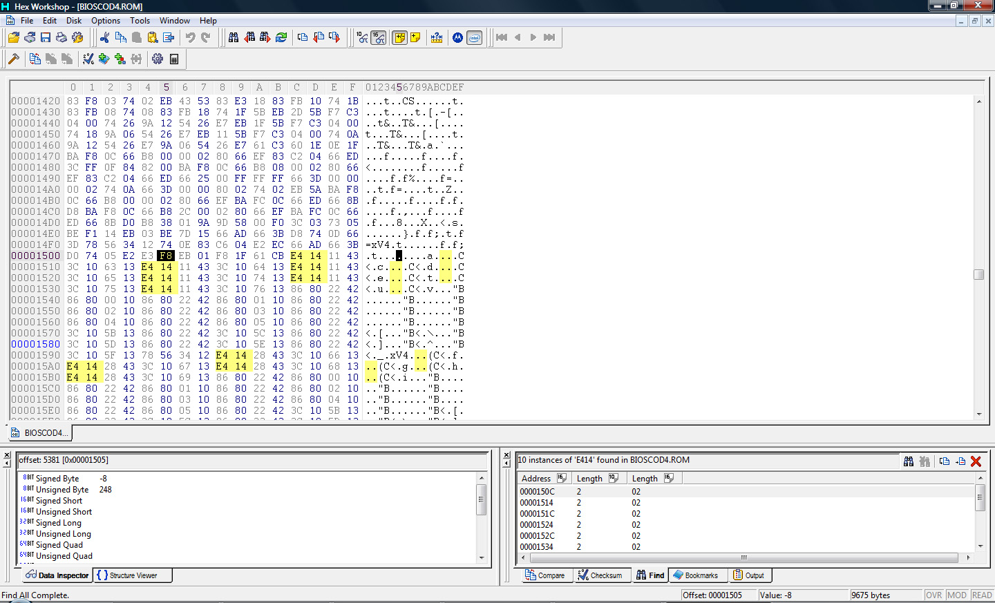

amoeller Posted July 24, 2008 Share Posted July 24, 2008 Well I did some work on the latest BIOS for the dv9200 intel laptop the F.2C BIOS. I followed what people said on this thread and made this patched file at the bottom. I used Phoenix Bios Editor to extract and used HexIt to change the F9 stc to F8 clc in BIOSCOD4.rom and I also checked it in HexWorkshop 5 and saw that at offset 0x1505 the hex was changed from F9 to F8. Then I rebuilt it in Phoenix bios editor. Unfortunately my laptop (a dv9200 CTO) is being used by my friend and he wont be back until this Sunday. If anyone wants to try this out feel free. If the whitelist is gone and everything else works tell me because I plan on using this on my laptop when it gets back. Thanks Here is the file I made. http://awesomeoreviews.com/OTHER/30BBF2C-HACKED.zip Link to comment https://www.insanelymac.com/forum/topic/31474-hp-dv6000t-laptop/page/7/#findComment-831215 Share on other sites More sharing options...
kevd_hackin Posted July 24, 2008 Share Posted July 24, 2008 Well I did some work on the latest BIOS for the dv9200 intel laptop the F.2C BIOS. I followed what people said on this thread and made this patched file at the bottom.I used Phoenix Bios Editor to extract and used HexIt to change the F9 stc to F8 clc in BIOSCOD4.rom and I also checked it in HexWorkshop 5 and saw that at offset 0x1505 the hex was changed from F9 to F8. Then I rebuilt it in Phoenix bios editor. Unfortunately my laptop (a dv9200 CTO) is being used by my friend and he wont be back until this Sunday. If anyone wants to try this out feel free. If the whitelist is gone and everything else works tell me because I plan on using this on my laptop when it gets back. Thanks Here is the file I made. http://awesomeoreviews.com/OTHER/30BBF2C-HACKED.zip thats very wierd because when i was modifing these bios, the f9 lock had been disabled by hp and moved to biosrom 1 which you can not easily move with out bricking your computer, i hope this does work for you, but all the f series bios i have seen are like this so i don't know why this one would be different. Good luck kev Link to comment https://www.insanelymac.com/forum/topic/31474-hp-dv6000t-laptop/page/7/#findComment-831285 Share on other sites More sharing options...
amoeller Posted July 24, 2008 Share Posted July 24, 2008 thats very wierd because when i was modifing these bios, the f9 lock had been disabled by hp and moved to biosrom 1 which you can not easily move with out bricking your computer, i hope this does work for you, but all the f series bios i have seen are like this so i don't know why this one would be different. Can you explain the lock in later bios to me? I don't want to brick my laptop for something that could be avoided. Also since my laptop dose not have a floppy drive how could I use a recovery floppy to fix if I bricked it? Link to comment https://www.insanelymac.com/forum/topic/31474-hp-dv6000t-laptop/page/7/#findComment-831347 Share on other sites More sharing options...
kevd_hackin Posted July 24, 2008 Share Posted July 24, 2008 Can you explain the lock in later bios to me? I don't want to brick my laptop for something that could be avoided. Also since my laptop dose not have a floppy drive how could I use a recovery floppy to fix if I bricked it? floppy can be usb, so worst case jsut borrow one if something happens. For the lock being moved, when you open the hex editor and search for e414 or 8086 the hex before that used to be f9 then we changed it to f8, and that removed the check. With the new bios the already disabled this and moved the lock to different rom. If when you open the rom with hex editor, and it is still f9 just go ahead and try it. As for the offsets you listed those were not the correct ones with the 51 or 53 bios so not sure what you are changing. Also bios editor unpacks bios different some times, but rebuilds correctly so maybe those are the correct offsets, do you see the whitelisted cards after the hex. just be careful changing things kev Link to comment https://www.insanelymac.com/forum/topic/31474-hp-dv6000t-laptop/page/7/#findComment-831453 Share on other sites More sharing options...

amoeller Posted July 24, 2008 Share Posted July 24, 2008 I see what you saying. I looked though all of the BIOSCOD roms and BIOSCOD4.ROM was the only one that had the E414 hex in it and before it had the F9 hex. I have a photo of what I'm seeing in the attachment. I have already changed the F9 to F8 though. Link to comment https://www.insanelymac.com/forum/topic/31474-hp-dv6000t-laptop/page/7/#findComment-831922 Share on other sites More sharing options...

amoeller Posted July 26, 2008 Share Posted July 26, 2008 I remade the F.2C BIOS but added AR5BXB6 vendor and sub ids to the white list and left it the F9 hex alone. Can you take a look at this screen shot to see if everything is up to par? The screen shot is http://awesomeoreviews.com/OTHER/BIOSCOD4_ADD.jpg and the notepad file shows the AR5BXB6 ids. The remade BIOS is http://awesomeoreviews.com/OTHER/30BBF2C-HACKED-NWL.zip Thanks for all your help I really appreciate it. Link to comment https://www.insanelymac.com/forum/topic/31474-hp-dv6000t-laptop/page/7/#findComment-834030 Share on other sites More sharing options...
