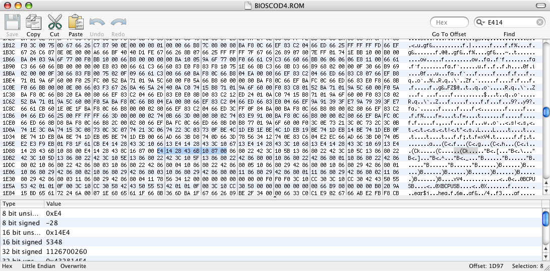

metaldog Posted April 24, 2008 Share Posted April 24, 2008 I have successfully patched the F.51 bios to add the BCM94321KFBG (taken from an Apple TV, same as used in MacBook Pro) to the whitelist, and have been using the card in an HP dv9700t with iATKOS updated with Kalyway 10.5.2 updater. Card is ID'd as Airport and connects fine (to hotel wireless, not sure what the router is). The PCI\VEN is 14E4 4328. I had to install the card in a Dell laptop running XP to get the SUBSYS ID, 106B x87. So the hex to patch was E414 2843 6B01 8700. I had to use Phoenix BIOS editor pro 2.2 to extract the modules from the HP bios. The module to patch was "BIOSCOD4.ROM" from the F.51 bios downloaded from HP site. I actually performed the hex editing using 0xED app on Hackintosh. I ran the Phoenix BIOS program in Parallels with XP pro image. I then replaced the BIOSCOD4.ROM in the TEMP directory created by the BIOS Editor with the patched file, and then selected Build Bios. Built with no errors, then transfered the BIOS and the orig HP BIOS (self-installer) to USB to use on the dv9700t. The HP dv9700t was running Vista. Had issues with getting the SWinFlash program to run, but was finally able to flash the Bios with the patched F.51 bios. Installed the card, booted up, and the 104 error is gone. I am currently running 10.5.2 from and external USB drive. Everything works except Sleep and shutdown. Willing to help, but currently on travel and won't be able to do much until next week. Link to comment https://www.insanelymac.com/forum/topic/31474-hp-dv6000t-laptop/page/4/#findComment-722801 Share on other sites More sharing options...

metaldog Posted April 25, 2008 Share Posted April 25, 2008 I used OxED on my Hack Pro. I just used the search function for "E414", then used overwrite edit mode to patch in the new hex values and save. The app is at this link OxED Link to comment https://www.insanelymac.com/forum/topic/31474-hp-dv6000t-laptop/page/4/#findComment-723073 Share on other sites More sharing options...

internetadam4657 Posted April 25, 2008 Share Posted April 25, 2008 do you remeber what offset you found it at? i found the values for my intel card, and near them i found a set of vaules for a broadcom card that i had edited for my airport card and that is what bricked me in the first place. Link to comment https://www.insanelymac.com/forum/topic/31474-hp-dv6000t-laptop/page/4/#findComment-723196 Share on other sites More sharing options...
metaldog Posted April 25, 2008 Share Posted April 25, 2008 do you remeber what offset you found it at? i found the values for my intel card, and near them i found a set of vaules for a broadcom card that i had edited for my airport card and that is what bricked me in the first place. I edited starting at offset 1D97. Attached is a screenshot with the highlighted edits. Link to comment https://www.insanelymac.com/forum/topic/31474-hp-dv6000t-laptop/page/4/#findComment-723372 Share on other sites More sharing options...
internetadam4657 Posted April 25, 2008 Share Posted April 25, 2008 567302B113660FBC is what i see when i go to that offset. is it possible that it could be in a different place since this is a different bios and all? in fact, when i search for e414 i don't even come up with anything. Link to comment https://www.insanelymac.com/forum/topic/31474-hp-dv6000t-laptop/page/4/#findComment-724072 Share on other sites More sharing options...
