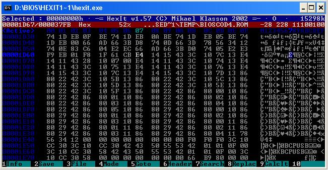

mcollao Posted April 30, 2008 Share Posted April 30, 2008 567302B113660FBC is what i see when i go to that offset. is it possible that it could be in a different place since this is a different bios and all? in fact, when i search for e414 i don't even come up with anything. Same here. Link to comment https://www.insanelymac.com/forum/topic/31474-hp-dv6000t-laptop/page/5/#findComment-729631 Share on other sites More sharing options...

kevd_hackin Posted May 18, 2008 Share Posted May 18, 2008 Please Help, i have got a gigabyte card with the ateros chipset the id is 168c 0024 e916 1458 i edited the hex to 8c16 2400 5814 16e9 and then rebuild bios and i still get 104 error? What am I doing wrong please help. thanks v is f53 Link to comment https://www.insanelymac.com/forum/topic/31474-hp-dv6000t-laptop/page/5/#findComment-750415 Share on other sites More sharing options...

kevd_hackin Posted May 27, 2008 Share Posted May 27, 2008 hi guys, after having many problems adding cards to my whitelist, i downgraded to bios f33 and was about to add the cards ids when i saw a f9 one hex row up, i went back to doctorj's post and looked at his and it looked the same, except at a different offset, so i changed this to f8 and rebuild, flashed and prayed. booted up fine, the switched cards, rebooted and waited.. no 104 errror, so put in another card and again no 104 error. I have completely removed the whitelist check from my bios. Hopefully this works for others, i will be trying with 53 this weekend. Make sure to make a crisis recovery floppy before trying this one, it did not brick my computer, but who knows kev dv9700t with dell 1500 and gigabyte atheros 5008 both workingBIOS.rar Link to comment https://www.insanelymac.com/forum/topic/31474-hp-dv6000t-laptop/page/5/#findComment-759780 Share on other sites More sharing options...
