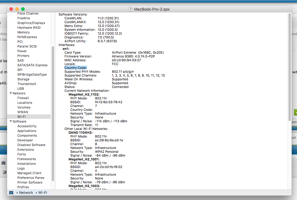

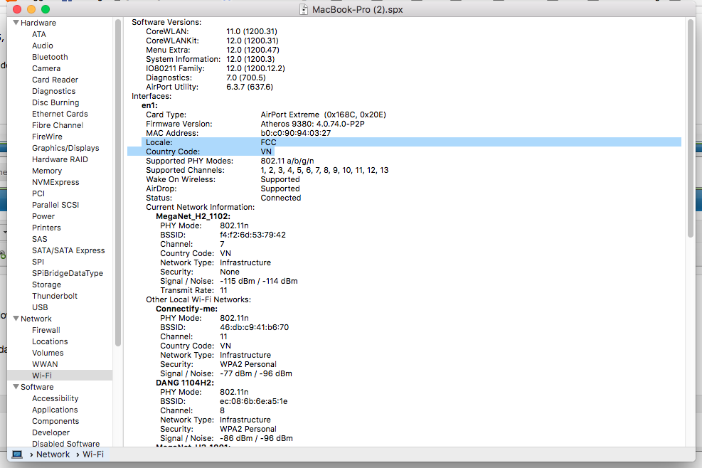

DuongTHVN Posted June 29, 2017 Share Posted June 29, 2017 i'm try v14 on my AR9565. it work but speed verry low. i'm check is have no Country code @@ is that reason about low speed ? Link to comment https://www.insanelymac.com/forum/topic/312045-atheros-wireless-driver-os-x-101112-for-unsupported-cards/page/13/#findComment-2453253 Share on other sites More sharing options...

chunnann Posted June 29, 2017 Share Posted June 29, 2017 i'm try v14 on my AR9565. it work but speed verry low. i'm check is have no Country code @@ is that reason about low speed ? AR9565, like AR9485, should be able to get the maximum speed up to 54Mbs due to its 2.4Ghz, 1 stream. For unknown reason, the speed seems to be limited to 11Mbs maximum... As for the country code, I think it depends on the router you are using... Link to comment https://www.insanelymac.com/forum/topic/312045-atheros-wireless-driver-os-x-101112-for-unsupported-cards/page/13/#findComment-2453384 Share on other sites More sharing options...

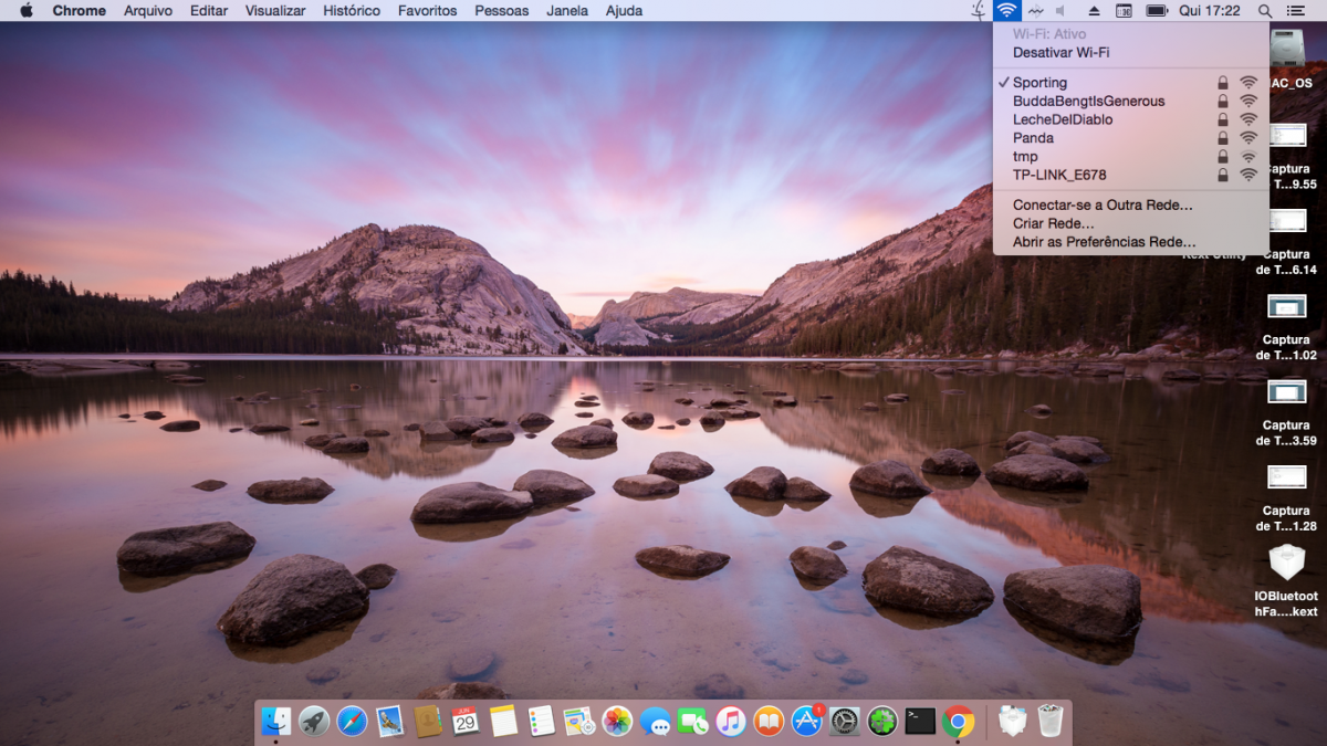

everart Posted June 29, 2017 Share Posted June 29, 2017 I am sorry for my delay! I was trying to fix my problem and I think is working great now. I tried save mode and everything works just fine so I realized it can be some other kext. I need to make more tests but looks like stable and the download also works fast as was with Ethernet. I will give you more information in few hours. Works with Yosemite 10.10.5 Link to comment https://www.insanelymac.com/forum/topic/312045-atheros-wireless-driver-os-x-101112-for-unsupported-cards/page/13/#findComment-2453534 Share on other sites More sharing options...
everart Posted June 29, 2017 Share Posted June 29, 2017 I found the problem!!! My bluetooth... I take it out IOBluetooth and it works great. But for some reason my AppleHDA is not loading. I need to find one way to not load my bluetooth but keep my kext. Link to comment https://www.insanelymac.com/forum/topic/312045-atheros-wireless-driver-os-x-101112-for-unsupported-cards/page/13/#findComment-2453847 Share on other sites More sharing options...
DuongTHVN Posted June 30, 2017 Share Posted June 30, 2017 AR9565, like AR9485, should be able to get the maximum speed up to 54Mbs due to its 2.4Ghz, 1 stream. For unknown reason, the speed seems to be limited to 11Mbs maximum... As for the country code, I think it depends on the router you are using... thanks about info of speed. i hope have some update soon ! about country code, when i update lastest driver on windows from asus homepage end comeback to mac it fixed Country Code: , but speed no fix. -> i think driver on windows was update firmware for wifi card. Link to comment https://www.insanelymac.com/forum/topic/312045-atheros-wireless-driver-os-x-101112-for-unsupported-cards/page/13/#findComment-2454155 Share on other sites More sharing options...
