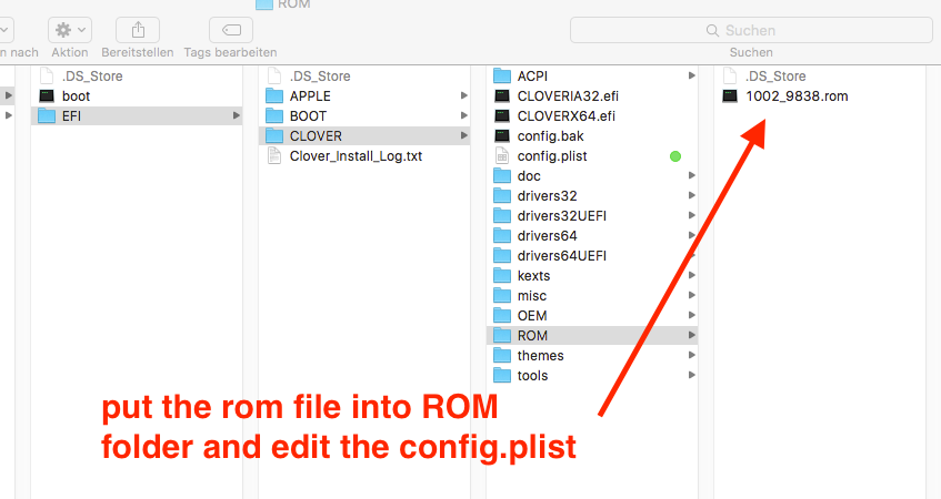

spakk Posted April 9, 2016 Share Posted April 9, 2016 (edited) Hi guys, First of all, I just wanna thank very much Allan & Artur_p for their support , I've just finished a clean install of El Capitan 10.11.4 using the last version of clover, here are the results, using the files of Allan (a special thanks ): - Sleep working, - Dual display working (Via DVI ports), - Smooth screen (though I don't install a heavy game to check acceleration level), - Audio working using audio_cloverALC-110.command.zip (all credits goes to the developer), - USB 2.0 working by only renaming EHC1/EHC2 to EH01/EH02 in the DSDT (Thanks to RehabMan) and I don't create an injector kext, My questions now are: 1- What is the best way to check if I have a full acceleration? do I have to install a special game? 2- I still have displayed 1536 MB instead of 1024 MB in my MAC info (I've noticed that in the Ioreg file, NVCAP wasn't override even the VRAM,totalsize), regarding of the DSDT values), seems like something keeps that values from changing, any idea? Thanks for all, install on windows operating system either GPU-Z or AIDA64, then export the graphic-rom file then install and run the NVCAP Maker 1.4.app on mac os x, so open the graphic-rom file, a string will be you shown. write these values in your dsdt in the area NVCAP. Then change the vram-total size value in the dsdt ==> 00000040 then edit the graphic rom file with your vendor-id and device id for example 10de_1204.rom ***, save the rom file in your Extra folder, then change the org.chameleon.boot.plist with these string: <key>UseNvidiaROM</key> <string>Yes</string> <key>VBIOS</key> <string>Yes</string> finished, restart your system then everything should be displayed correctly. *** (change these values with your values, install and open DPCI-Manager.app or SystemInfo.app look at your vendor id and device id) Edited April 9, 2016 by spakk 1 Link to comment Share on other sites More sharing options...
Elbeyrouni7 Posted April 9, 2016 Author Share Posted April 9, 2016 install on windows operating system either GPU-Z or AIDA64, then export the graphic-rom file then install and run the NVCAP Maker 1.4.app on mac os x, so open the graphic-rom file, a string will be you shown. write these values in your dsdt in the area NVCAP. Then change the vram-total size value in the dsdt ==> 00000040 then edit the graphic rom file with your vendor-id and device id for example 10de_1204.rom ***, save the rom file in your Extra folder, then change the org.chameleon.boot.plist with these string: <key>UseNvidiaROM</key> <string>Yes</string> <key>VBIOS</key> <string>Yes</string> finished, restart your system then everything should be displayed correctly. *** (change these values with your values, install and open DPCI-Manager.app or SystemInfo.app look at your vendor id and device id) Thanks for you very explicit explanation , I'm using Clover Legacy, so I presume that I'm going to add UseNvidiaROM & VBIOS keys into Config.plist, and copy the ROM file into EXTRA folder, is that correct? Thanks again , Link to comment Share on other sites More sharing options...
spakk Posted April 9, 2016 Share Posted April 9, 2016 that's just only an example with my AMD Radeon HD8240 (kabini) put the rom file into the ROM folder, if uefi then in to the EFI/Clover/OEM/SystemProductname/ROM/ 1 Link to comment Share on other sites More sharing options...
Elbeyrouni7 Posted April 9, 2016 Author Share Posted April 9, 2016 that's just only an example with my AMD Radeon HD8240 (kabini) put the rom file into the ROM folder, if uefi then in to the EFI/Clover/OEM/SystemProductname/ROM/I If it's Legacy, is it the same folder? Link to comment Share on other sites More sharing options...
spakk Posted April 9, 2016 Share Posted April 9, 2016 if no uefi then insert the rom file as seen in the picture ;-) EFI/CLOVER/ROM/ Edit: For the modification of the config.plist can be clover configurator.app very helpful. 1 Link to comment Share on other sites More sharing options...
Elbeyrouni7 Posted April 10, 2016 Author Share Posted April 10, 2016 if no uefi then insert the rom file as seen in the picture ;-) EFI/CLOVER/ROM/ Edit: For the modification of the config.plist can be clover configurator.app very helpful. Thanks spakk you are really helpful I'm gonna test it tomorrow. Thanks again. Link to comment Share on other sites More sharing options...
Elbeyrouni7 Posted April 19, 2016 Author Share Posted April 19, 2016 Thanks spakk you are really helpful I'm gonna test it tomorrow. Thanks again. Thanks spakk it's working, good job Link to comment Share on other sites More sharing options...
