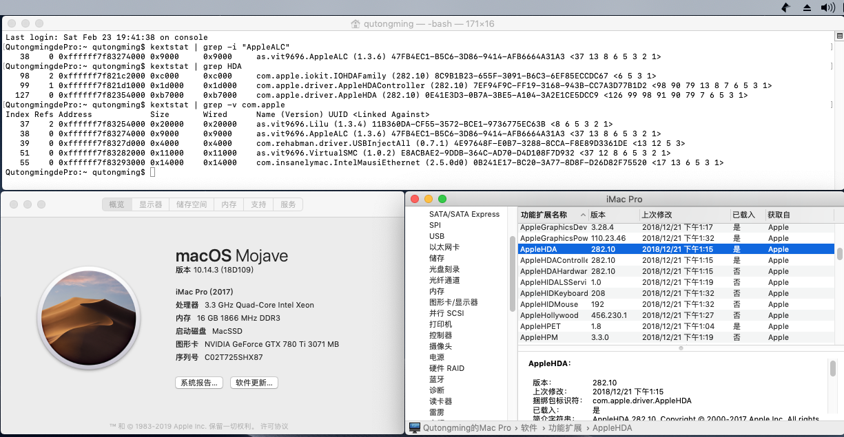

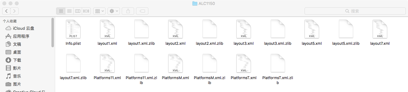

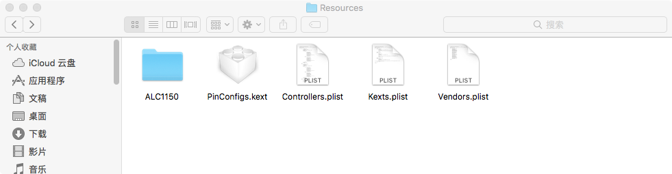

2 hours ago, toleda said:
1.3.6, AppleALC.kext did not run
Looks like you made a local copy of the AppleALC  repo and removed all Resources/non 1150 codecs, correct?
Why?
Thanks for your help

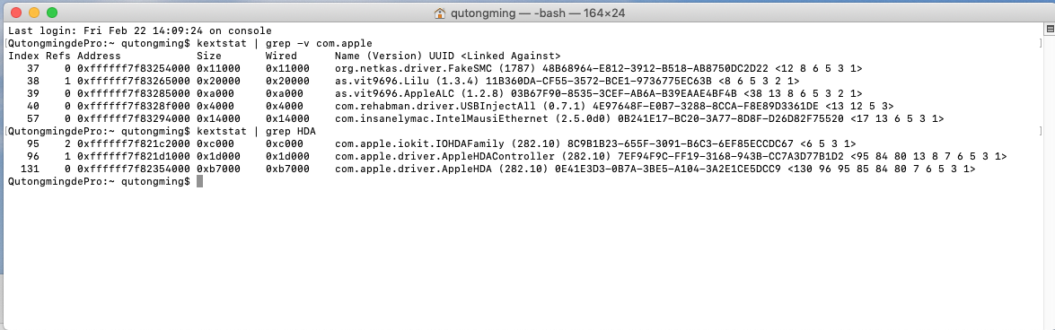

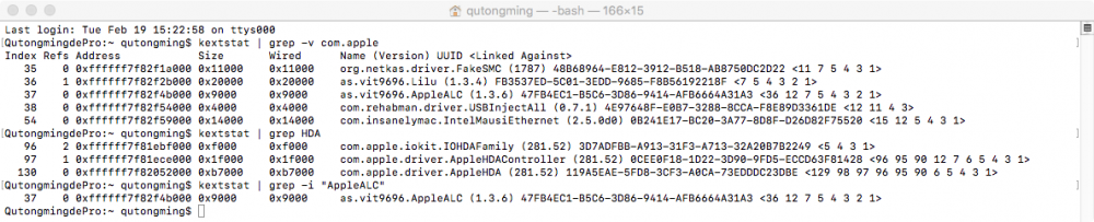

Terminal View Loaded
IORegistryExplorer View Loaded
AppleALC1.3.6.thumb.png.31028296224c8ea616e6f4a94a46594f.pngAppleALC1.3.6.thumb.png.31028296224c8ea616e6f4a94a46594f.png

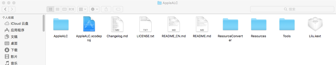

Use commands, not copies。   git clone https://github.com/vit9696/AppleALC.git   AppleALC.kex1.3.6 New source code compilation
But try copying 1.2.8_1150 codes
Why is 1.0.0 to 1.2.8 okay?
Why ?
Ask for your help
Edited by qutongming
An IOReg screenshot is useless, IOReg/File/Save a Copy As ..., attach compressed copy.
Repo: GitHub Desktop/clone, do not copy. Resources file is not complete, user error.
Xcode/compile is successful, AppleALC.kext is incomplete; does not run, audio failure.

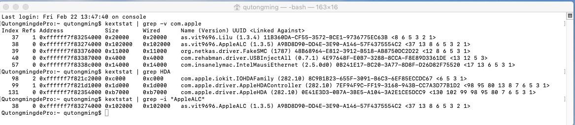

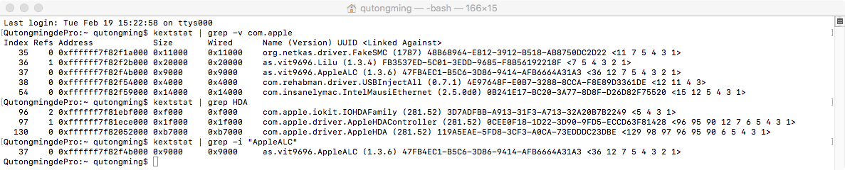

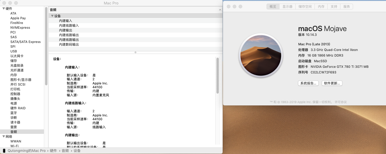

New MacOs Mojave 10.14.3 Installation Today
AppleALC Official Download AppleALC1.3.5
https://github.com/acidanthera/AppleALC/releases
Equipment blank
1.3.5.RELEASE.zip
IOReg file.zip
AppleALC Official Download AppleALC1.2.8
https://github.com/acidanthera/AppleALC/releases/download/1.2.8/1.2.8.RELEASE.zip
Delete 1.3.5 and replace 1.2.8
Equipment blank !!!!!

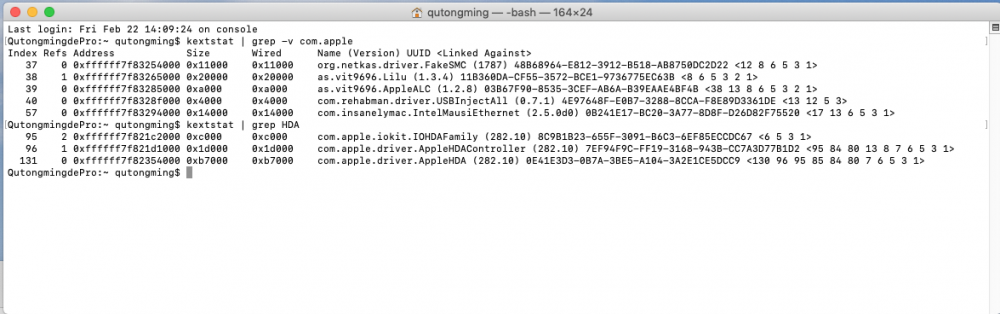

https://github.com/acidanthera/AppleALC/archive/1.2.8.zip
modify kern_start.cpp
PluginConfiguration ADDPR(config) {
    xStringify(PRODUCT_NAME),
    parseModuleVersion(xStringify(MODULE_VERSION)),
    LiluAPI::AllowNormal | LiluAPI::AllowInstallerRecovery,
    bootargOff,
    arrsize(bootargOff),
    bootargDebug,
    arrsize(bootargDebug),
    bootargBeta,
    arrsize(bootargBeta),
    KernelVersion::MountainLion,
    KernelVersion::HighSierra,     modify Mojave
        alc.init();
Compile AppleALC1.2.8  Everything is perfect.
Why ?
Ask for your help

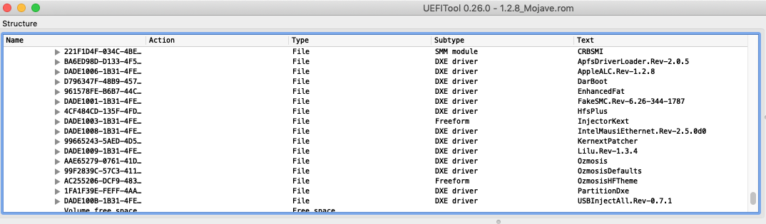

good 1.2.8_AppleALC.kext.zip

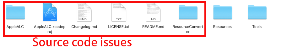

Resources file (Not the 1150 source code problem)That's absolute.
(AppleALC  AppleALC.xcodeproj  ResourceConverter)Source code issues

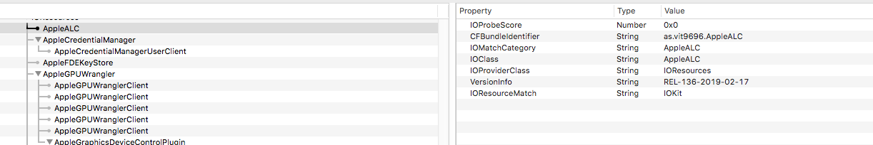

19 hours ago, toleda said:
IOReg shows WhateverGreen has enabled Nvidia HDMI audio
Make and model of the 2 Apple Displays connected to the GTX 650?
Attach an IOReg with a TV connected.

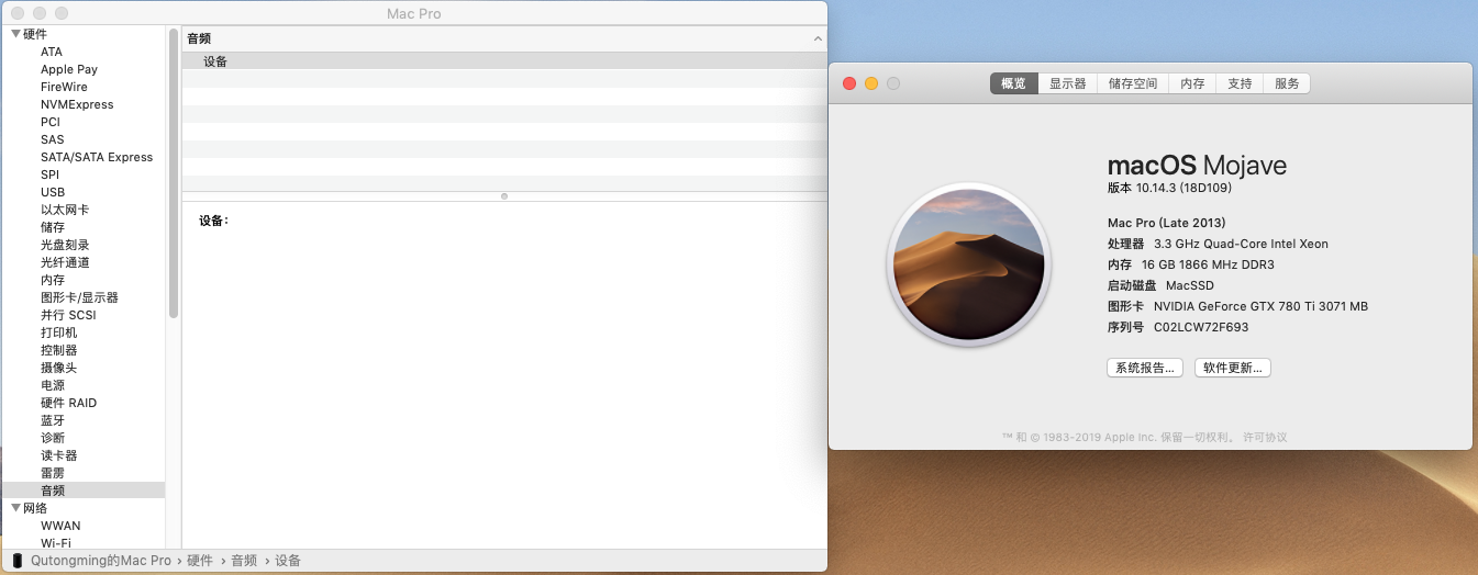

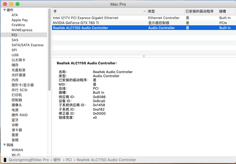

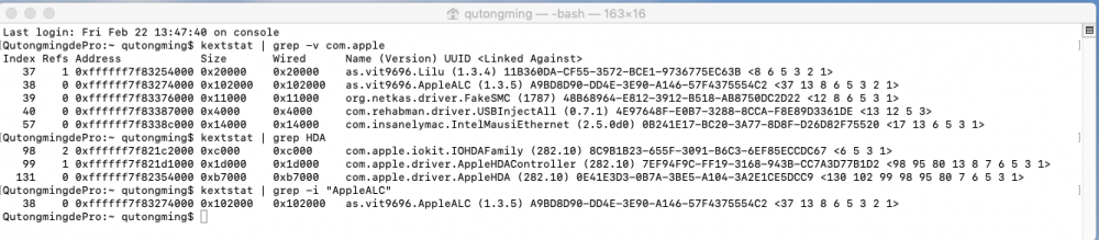

Clean system
Main board: GA Z97X-UD3H Ver1.1
BIOS: Z97XUD3H.10b
Sound Card: Realtek ALC 1150
I use Ozmosis.rom.  Clover is not in use
Every test brushes BIOS
LayoutID 1 2 3 5 and 7  Tried one by one。  Brush BIOS 60 times, Installation system 3 times,Installation from 10.14.3MacOS and 10.13.6MacOS 10.14.3MacOS
Now used  1.2.8 very good。 LayoutID 1 Injection utilizing DSDT
1.3.0 1.3.1 1.3.2 and 1.3.6 Equipment blank
Why?
BIOS, Replace only 1.3.0.  Equipment blank

Attach IOReg and config.plist
I use translation
Thanks for your help,
Source code issues, 1.3.6 does not support MacPro configuration
Support iMacPro 1.1
4 hours ago, qutongming said:
I use translation
Support iMacPro 1.1
It works fine for me with MacPro6,1 SMBIOS, and ALC1150. But I'm using Lilu 1.3.4 and AppleALC 1.3.5 (latest official builds). So it might be different. Also, I'm using Clover, not Osmosis. But if it works for you with iMacPro1,1, then maybe you can use that one instead. I personally had no issues with MacPro6,1. :)
Thank you for your warm-hearted friends.
I'm sorry, everybody.
It's my configuration problem.
Sorry for the author
It's not a code problem
Clean system
BIOS: Z97XUD3H.10b
Why?
Hi,
Remove the layout id's from the DSDT, open your OzmosisDefaults with a plist app like plist edit pro, go to the boot-args, and ad alcid=1, save it, and replace it with the current one on the bios. You can replace it even if plist file, using UEFITool, and by replace body, set the extension to bi inserted as other, then go choose you OzmosisDefaults.plist you've just modified, UEFITool is able to convert the plist file to raw data.
Now download the latest AppleALC source code, and unzip it. From the Resources folder on the AppleALC Master, delete all other codecs except the ALC1150. Now, download the Lilu Master source code, run the project using Xcode, and copy the resulted Lilu.kext to the AppleALC Master folder, open the project using Xcode, and convert the resulted small AppleALC.kext file size to ffs, replace it with the current one on the bios. Download the latest release of Lilu kext from the release page, convert it to ffs, replace it with the current one on the bios. Now, save the BIOS and refresh your mob with it.
For the DSDT avoid using it, and instead, use a SSDT that contain all the patchs used in the DSDT, IMHO.
Good Luck ^_^
