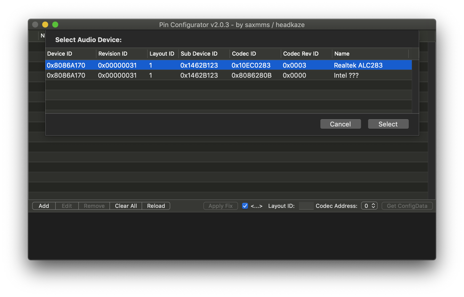

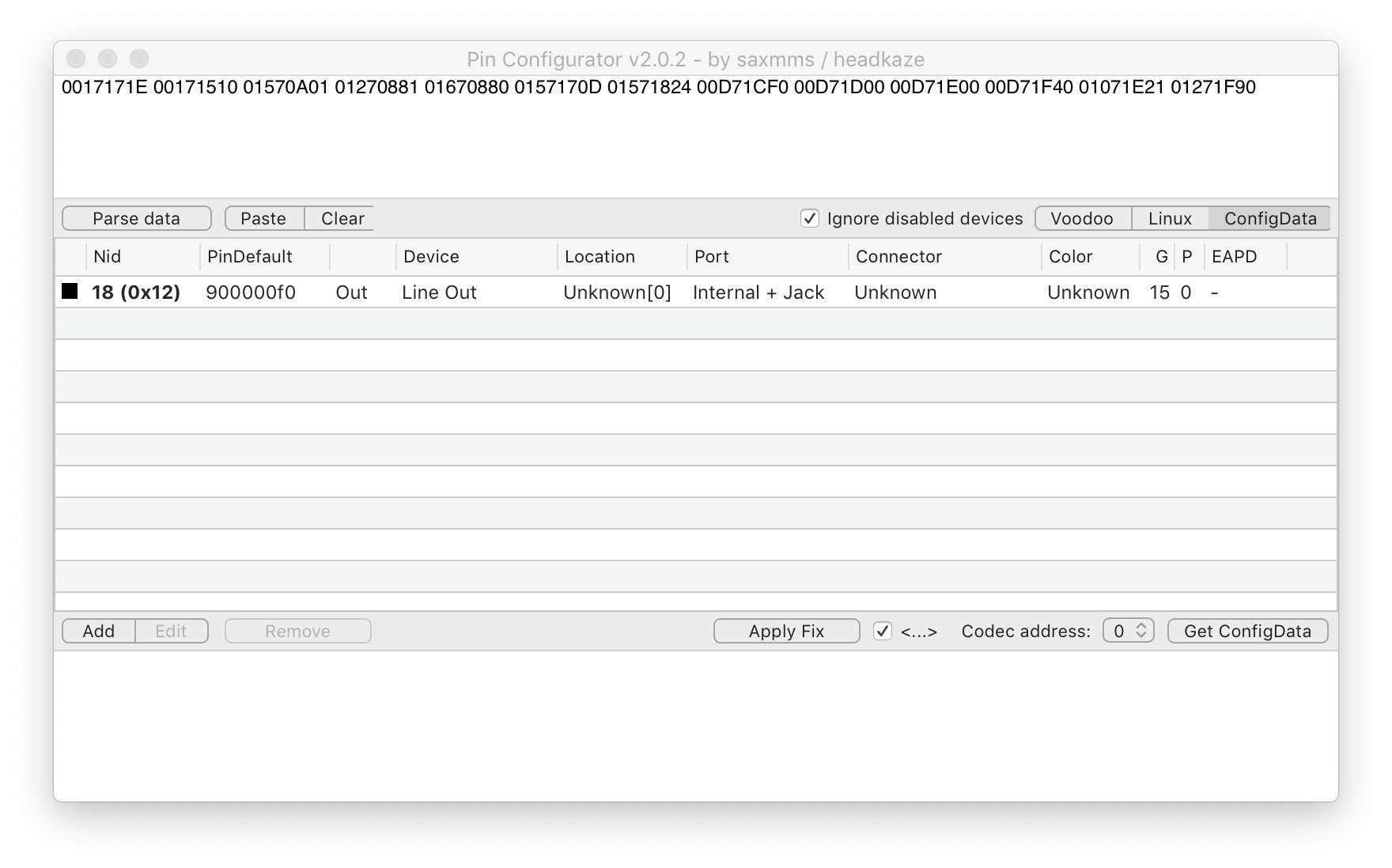

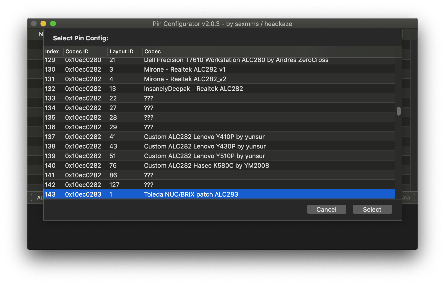

headkaze Posted February 13, 2019 Share Posted February 13, 2019 (edited) Hi @Rodion2010 @insanelyDeepak and others. I have made significant progress with Pin Configurator. Currently you can import from IORegistry and import/export to PinConfigs.kext. @ctich has given me info on how I can automate the process some more. I'm looking for the source code to GetDumpXML. From what I understand it's written by @Alejandro. It would be nice to integrate it directly rather than calling the utility externally. EDIT @ctich is going to contact @Alejandro and get back to me Edited February 13, 2019 by headkaze 4 Link to comment https://www.insanelymac.com/forum/topic/311293-applealc-%E2%80%94-dynamic-applehda-patching/page/165/#findComment-2663931 Share on other sites More sharing options...
headkaze Posted February 13, 2019 Share Posted February 13, 2019 Pin Configurator v2.0.3 Released - Added Import / Export PinConfigs.kext - Added Import IORegistry pin configuration - Added Export verbs.txt Download from here You now use the File menu to Open / Import / Export files. Please give feedback on the progress so far... 3 Link to comment https://www.insanelymac.com/forum/topic/311293-applealc-%E2%80%94-dynamic-applehda-patching/page/165/#findComment-2663966 Share on other sites More sharing options...
headkaze Posted February 13, 2019 Share Posted February 13, 2019 On 2/10/2019 at 5:41 AM, insanelyDeepak said: also you add option to export text file like verbs.txt , so it will easy compare if app fails sometimes Added Export verbs.txt as per your request, although slightly different format to verbit Eg. Verbs from Linux Codec Dump File: Rodion2010.txt Codec: Realtek ALC861 Address: 2 DevID: 283904097 (0x10ec0861) Nid PinDefault Device Location Port Connector Color G P EAPD Original Verbs ----------------------------------------------------------------------------------------------------------------------------------- 11 (0x0b) 01014010 Out Line Out Rear Jack or ATAPI 1/8" Stereo/Mono Green 1 0 - 20b71c10 20b71d40 20b71e01 20b71f01 12 (0x0c) 01813430 In Line In Rear Jack or ATAPI 1/8" Stereo/Mono Blue 3 0 - 20c71c30 20c71d34 20c71e81 20c71f01 13 (0x0d) 01a19c3e In Microphone Rear Jack or ATAPI 1/8" Stereo/Mono Pink 3 14 - 20d71c3e 20d71d9c 20d71ea1 20d71f01 14 (0x0e) 411111f0 Out Speaker Rear Unknown[4] 1/8" Stereo/Mono Black 15 0 - 20e71cf0 20e71d11 20e71e11 20e71f41 15 (0x0f) 02013420 Out Line Out Front Jack or ATAPI 1/8" Stereo/Mono Blue 2 0 - 20f71c20 20f71d34 20f71e01 20f71f02 16 (0x10) 02a19c40 In Microphone Front Jack or ATAPI 1/8" Stereo/Mono Pink 4 0 - 21071c40 21071d9c 21071ea1 21071f02 17 (0x11) 99330150 Out CD Internal Internal + Jack ATAPI Unknown 5 0 - 21171c50 21171d01 21171e33 21171f99 18 (0x12) 411111f0 Out Speaker Rear Unknown[4] 1/8" Stereo/Mono Black 15 0 - 21271cf0 21271d11 21271e11 21271f41 31 (0x1f) 411111f0 Out Speaker Rear Unknown[4] 1/8" Stereo/Mono Black 15 0 - 21f71cf0 21f71d11 21f71e11 21f71f41 32 (0x20) 411111f0 Out Speaker Rear Unknown[4] 1/8" Stereo/Mono Black 15 0 - 22071cf0 22071d11 22071e11 22071f41 ----------------------------------------------------------------------------------------------------------------------------------- Nid PinDefault Device Location Port Connector Color G P EAPD Modified Verbs ----------------------------------------------------------------------------------------------------------------------------------- 11 (0x0b) 01114010 Out Speaker Rear Jack or ATAPI 1/8" Stereo/Mono Green 1 0 - 20b71c10 20b71d40 20b71e11 20b71f01 12 (0x0c) 01813030 In Line In Rear Jack or ATAPI 1/8" Stereo/Mono Blue 3 0 - 20c71c30 20c71d30 20c71e81 20c71f01 13 (0x0d) 91a09050 In Microphone Rear Internal + Jack Unknown Pink 5 0 - 20d71c50 20d71d90 20d71ea0 20d71f91 15 (0x0f) 01113020 Out Speaker Rear Jack or ATAPI 1/8" Stereo/Mono Blue 2 0 - 20f71c20 20f71d30 20f71e11 20f71f01 16 (0x10) 01809040 In Line In Rear Jack or ATAPI Unknown Pink 4 0 - 21071c40 21071d90 21071e80 21071f01 ----------------------------------------------------------------------------------------------------------------------------------- 2 Link to comment https://www.insanelymac.com/forum/topic/311293-applealc-%E2%80%94-dynamic-applehda-patching/page/165/#findComment-2663967 Share on other sites More sharing options...
