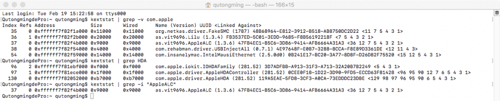

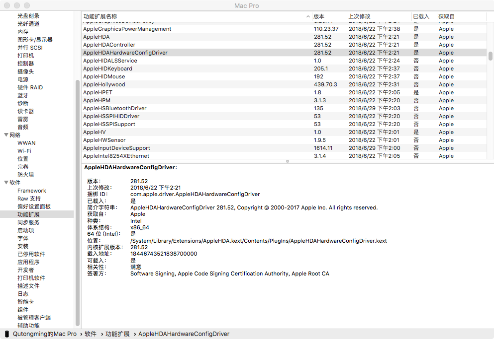

qutongming Posted February 19, 2019 Share Posted February 19, 2019 Asking for help Main board: GA Z97X-UD3H Ver1.1 Sound Card: Realtek ALC 1150 AppleALC.kext 1.3.0 will not be able to patch AppleHDAHardwareConfigDriver.kext Equipment blank 1.2.8_good_audio.zip 1.3.6_no_audio.zip Link to comment https://www.insanelymac.com/forum/topic/311293-applealc-%E2%80%94-dynamic-applehda-patching/page/168/#findComment-2664659 Share on other sites More sharing options...

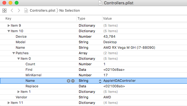

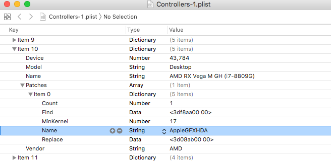

toleda Posted February 19, 2019 Share Posted February 19, 2019 (edited) Suggestion, add AppleALC support for AppleGFXHDA.kext. AppleGFXHDA.kext supports AMD R9 2xx/R9 3xx/Polaris/Vega/VII HDMI audio controllers. Of the dozen controllers supported in the binary, 3 are IOPCIMatch in Info.plist (10.14.3) Currently trying to enable Hades Canyon NUC/i7-8809G/AMD RX Vega M audio Unsuccessful, log shows AppleALC/Lilu patched AppleHDAController: Success, AMD R9 290X HDMI patch adapted to AMD RX Vega M works with AppleHDAController: AppleGFXHDA binary path is required. RX 560/aae0 HDMI audio working without IOPCIMatch. Edited February 20, 2019 by toleda Link to comment https://www.insanelymac.com/forum/topic/311293-applealc-%E2%80%94-dynamic-applehda-patching/page/168/#findComment-2664715 Share on other sites More sharing options...

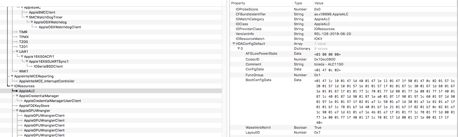

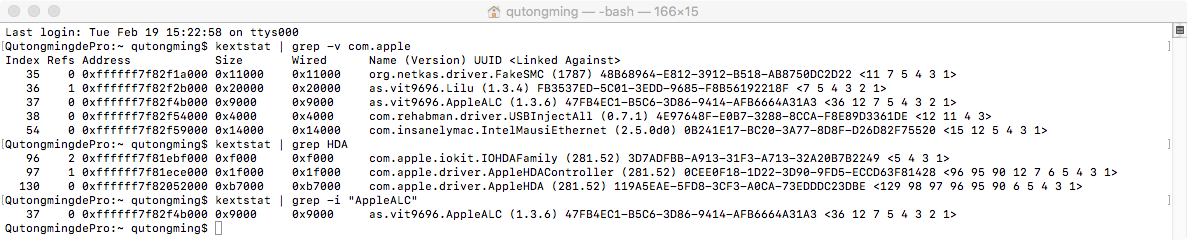

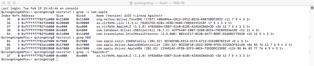

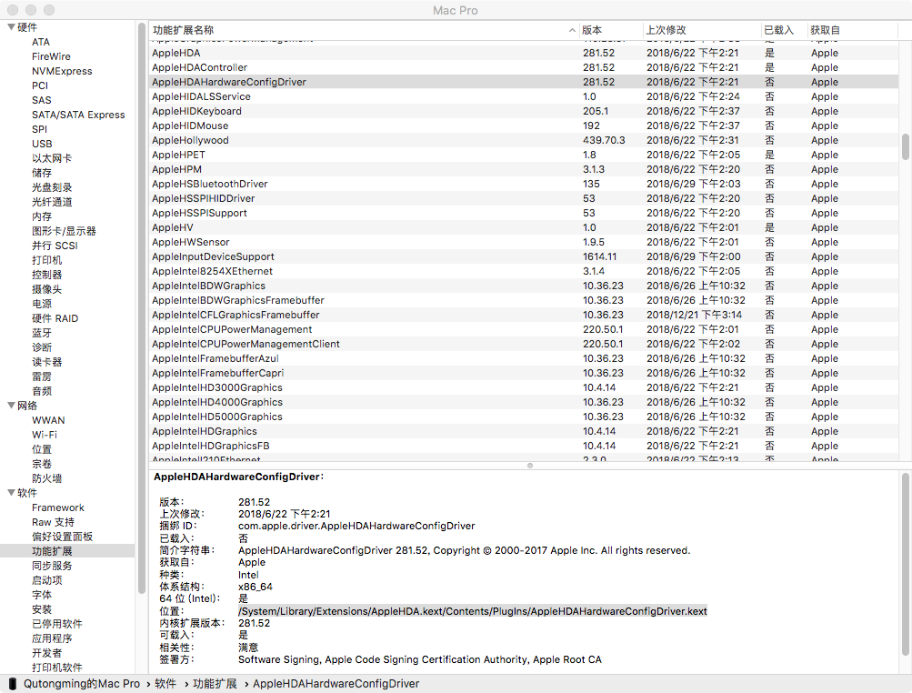

qutongming Posted February 20, 2019 Share Posted February 20, 2019 (edited) Seek help Main board: GA Z97X-UD3H Ver1.1 Sound Card: Realtek ALC 1150 Layout-ID1 AppleALC.kext 1.3.0 - 1.3.6 Equipment blank ,Perfect loading of components such as AppHDA No sound Layout-ID1 AppleALC.kext 1.0.0 - 1.2.8 Device loading ,Perfect loading of components such as AppHDA The sound quality is very good Asking for help 1.2.8_good_audio.zip 1.3.6_no_audio.zip Edited February 20, 2019 by qutongming Link to comment https://www.insanelymac.com/forum/topic/311293-applealc-%E2%80%94-dynamic-applehda-patching/page/168/#findComment-2664726 Share on other sites More sharing options...

qutongming Posted February 20, 2019 Share Posted February 20, 2019 Main board: GA Z97X-UD3H Ver1.1 Sound Card: Realtek ALC 1150 Hope to fix 1.3.6 after the source code support 1150 device blank problem Thank you I've tested the source code problem in multiple ways. Link to comment https://www.insanelymac.com/forum/topic/311293-applealc-%E2%80%94-dynamic-applehda-patching/page/168/#findComment-2664754 Share on other sites More sharing options...
toleda Posted February 20, 2019 Share Posted February 20, 2019 (edited) 15 hours ago, Matgen84 said: IOReg and config.plist in attachment IOReg shows all ALC892 audio devices and working audio for layout 1. What problem are you trying to solve? 9 hours ago, qutongming said: Hope to fix 1.3.6 after the source code support 1150 device blank problem I've tested the source code problem in multiple ways. AppleALC.kext_v1.3.6/ALC1150 working for layouts 1, 2 and 3; no source code problems. Attach IOReg and config.plist Edited February 20, 2019 by toleda Link to comment https://www.insanelymac.com/forum/topic/311293-applealc-%E2%80%94-dynamic-applehda-patching/page/168/#findComment-2664805 Share on other sites More sharing options...

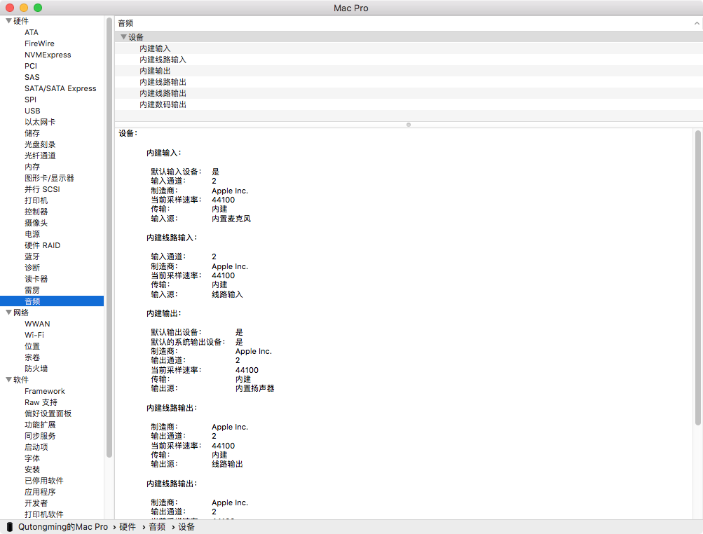

qutongming Posted February 21, 2019 Share Posted February 21, 2019 (edited) 13 hours ago, toleda said: IOReg shows all ALC892 audio devices and working audio for layout 1. What problem are you trying to solve? AppleALC.kext_v1.3.6/ALC1150 working for layouts 1, 2 and 3; no source code problems. Attach IOReg and config.plist The problem is (AppleALC AppleALC.xcodeproj ResourceConverter) What's wrong with it? IORegistryExplorer.zip The code is all right..zip Edited February 21, 2019 by qutongming Link to comment https://www.insanelymac.com/forum/topic/311293-applealc-%E2%80%94-dynamic-applehda-patching/page/168/#findComment-2664837 Share on other sites More sharing options...
insanelyDeepak Posted February 21, 2019 Share Posted February 21, 2019 17 minutes ago, qutongming said: The problem is (AppleALC AppleALC.xcodeproj ResourceConverter) What's wrong with it? IORegistryExplorer.zip The code is all right..zip exactly whats wrong with it , release version and source is fine for me Link to comment https://www.insanelymac.com/forum/topic/311293-applealc-%E2%80%94-dynamic-applehda-patching/page/168/#findComment-2664838 Share on other sites More sharing options...

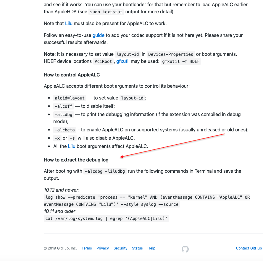

tyufhl Posted February 21, 2019 Share Posted February 21, 2019 1 hour ago, qutongming said: The problem is (AppleALC AppleALC.xcodeproj ResourceConverter) What's wrong with it? IORegistryExplorer.zip The code is all right..zip https://github.com/acidanthera/AppleALC/wiki/Installation-and-usage Link to comment https://www.insanelymac.com/forum/topic/311293-applealc-%E2%80%94-dynamic-applehda-patching/page/168/#findComment-2664848 Share on other sites More sharing options...

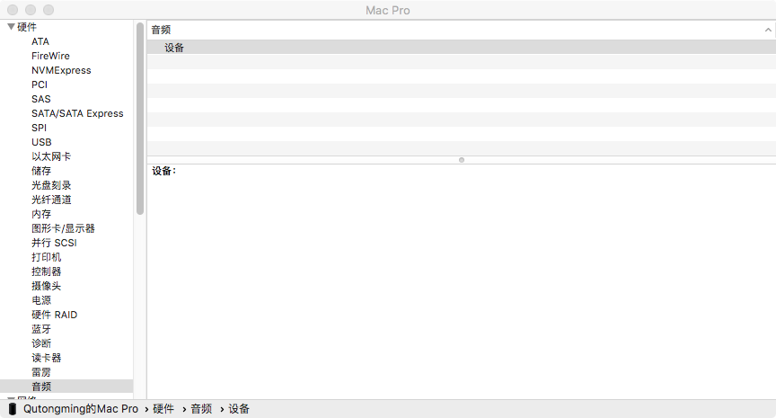

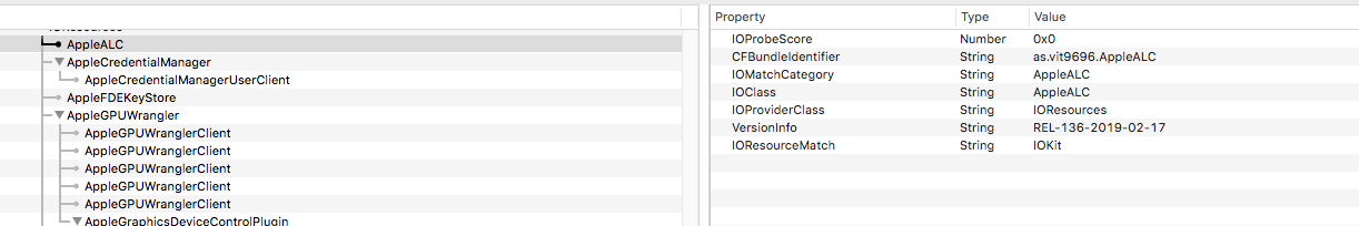

qutongming Posted February 21, 2019 Share Posted February 21, 2019 (edited) 15 hours ago, toleda said: Thank you very much. Toleda you layout1.xml and layout3.xml No problem。 From 1.00 to 1.2.8 are very good. From 1.3.0 to 1.3.8, it will not work. There is no equipment. AppALC1.2.8 15 hours ago, toleda said: AppALC1.3.6 15 hours ago, toleda said: Edited February 21, 2019 by qutongming Link to comment https://www.insanelymac.com/forum/topic/311293-applealc-%E2%80%94-dynamic-applehda-patching/page/168/#findComment-2664869 Share on other sites More sharing options...

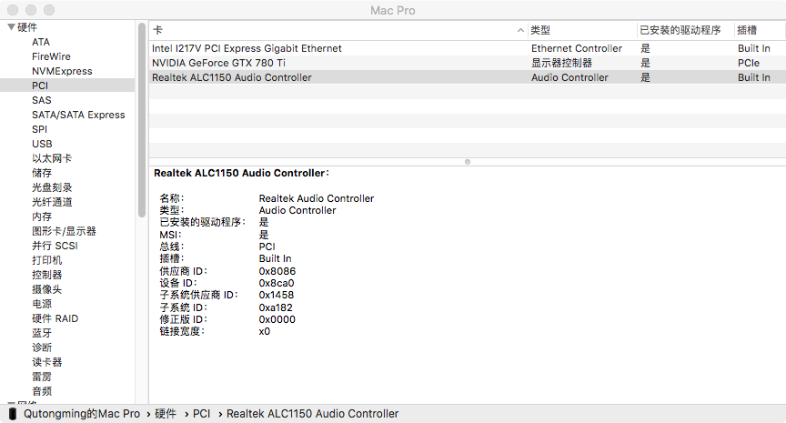

qutongming Posted February 21, 2019 Share Posted February 21, 2019 (edited) 15 hours ago, toleda said: IOReg shows all ALC892 audio devices and working audio for layout 1. What problem are you trying to solve? AppleALC.kext_v1.3.6/ALC1150 working for layouts 1, 2 and 3; no source code problems. Attach IOReg and config.plist From 1.3.0 1.3.1 1.3.2 1.3.3 1.3.4 1.35 and 1.3.6 All equipment blank Similarly, your layout1.XML layout2.XML and layout3.XML From 1.0.0 and 1.2.8 No problem at all. The following figure is AppleALC1.3.6 The following figure is AppleALC1.2.8 IORegi file.zip The code is all right..zip Edited February 21, 2019 by qutongming Link to comment https://www.insanelymac.com/forum/topic/311293-applealc-%E2%80%94-dynamic-applehda-patching/page/168/#findComment-2664876 Share on other sites More sharing options...
tyufhl Posted February 21, 2019 Share Posted February 21, 2019 19 minutes ago, qutongming said: From 1.3.0 1.3.1 1.3.2 1.3.3 1.3.4 1.35 and 1.3.6 All equipment blank Similarly, your layout1.XML layout2.XML and layout3.XMLFrom 1.0.0 and 1.2.8 No problem at all. The following figure is AppleALC1.3.6 The following figure is AppleALC1.2.8 IORegi file.zip The code is all right..zip second try Link to comment https://www.insanelymac.com/forum/topic/311293-applealc-%E2%80%94-dynamic-applehda-patching/page/168/#findComment-2664878 Share on other sites More sharing options...
qutongming Posted February 21, 2019 Share Posted February 21, 2019 16 minutes ago, tyufhl said: second try I can't speak English! (I use a translator) Thank you very much for your help. I will not use debugging mode ! ! ! ! ! But I tried to give orders. -alcbeta After AppleALC 1.3.0, the source code changed and the equipment was blank. Link to comment https://www.insanelymac.com/forum/topic/311293-applealc-%E2%80%94-dynamic-applehda-patching/page/168/#findComment-2664881 Share on other sites More sharing options...

IAmHolland Posted February 21, 2019 Share Posted February 21, 2019 5 hours ago, qutongming said: I will not use debugging mode ! ! ! ! ! Why not? Check that you don't have multiple copies of Lilu.kext. v1.3.0 requires a specific version or later. It shows in your kextstat, but it could be an install/setup issue? I have a Gigabyte Z97X-UD7-TH and it works fine for me. There are no source code changes targeting the ALC1150, specifically, in v1.3.0. The only reason it would fail to patch is if there are multiple versions of lilu. The last release of AppleALC is v1.3.5. You're running AppleALC v1.3.6. Where did you get that? Did you build it yourself? Are you using the correct version of Lilu.kext there and did you use the correct version when building AppleALC? Link to comment https://www.insanelymac.com/forum/topic/311293-applealc-%E2%80%94-dynamic-applehda-patching/page/168/#findComment-2664905 Share on other sites More sharing options...

toleda Posted February 21, 2019 Share Posted February 21, 2019 18 hours ago, qutongming said: What's wrong with it? 1.3.6, AppleALC.kext did not run Looks like you made a local copy of the AppleALC repo and removed all Resources/non 1150 codecs, correct? Why? Link to comment https://www.insanelymac.com/forum/topic/311293-applealc-%E2%80%94-dynamic-applehda-patching/page/168/#findComment-2664942 Share on other sites More sharing options...
