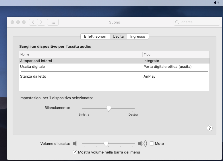

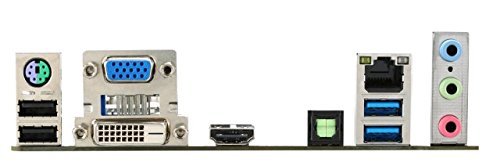

14 minutes ago, Te0 said:
is a MSI h81l
I tried all the outputs, both with speakers and headphones.
I would like to point out that with mojave 10.13.6 and audio_cloverALC-130_v0.3 of Toleda it was working. I do not know if it can help
it suppose to work bcoz all layout1,2,3 5,13 are compatible with your codec_dump
send me screenshot of system preferences devices

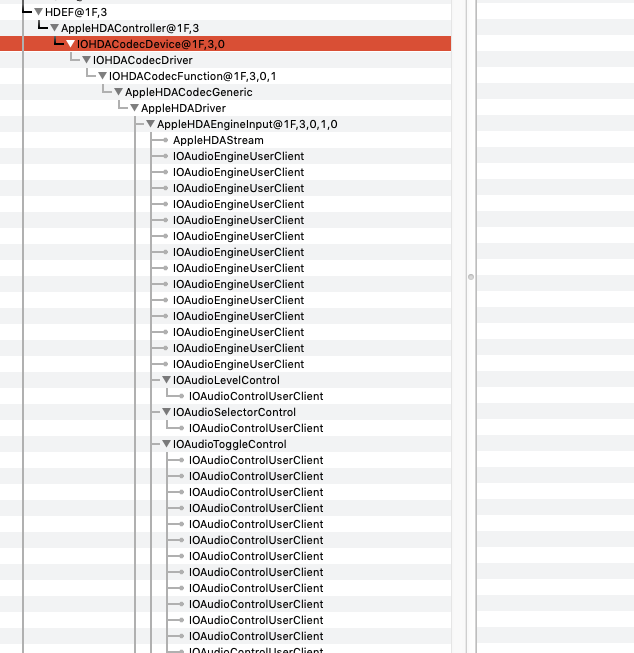

Used those two files, set layout to 22 and rebooted, attached is the IOReg output. Also, no worries about taking a few days, you're the one helping me! Thanks again!
XPS13IOReg.zip
Edited by dcshoes23
XPS13IOReg.zip
I can see audio is working now...
Edited by Andres ZeroCross
  • Thanks 1

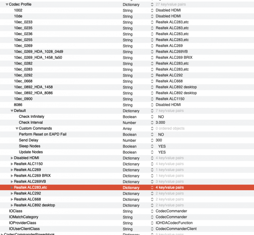

Hi,
I've solved my pb by installing CodecCommander.kext of Rehabman (thanks), in L/E like recommended, and after editing the info.plist file...
Thanks ;-)
4 hours ago, Andres ZeroCross said:
Your IOREG show your audio is working,,
1. Try to completly shutdown your notebook and turn on again to macOS or,
2. Remove CodecCommander.kext if you used it

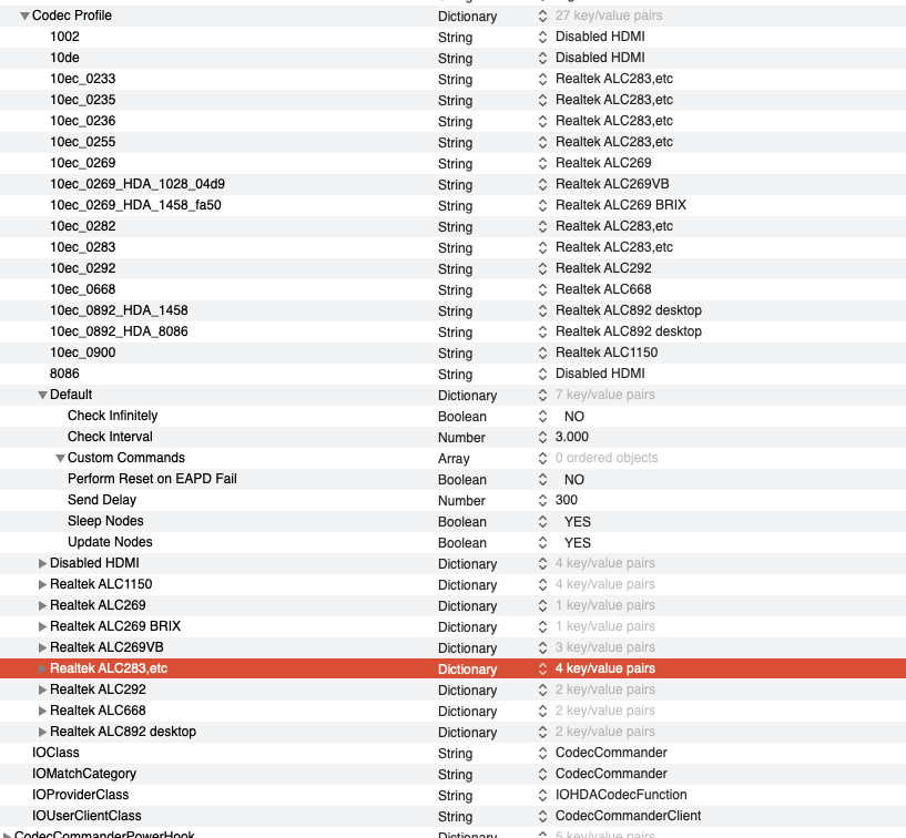

I did not have CodecCommander.kext so I tried adding it and now audio works perfectly! Nice and loud and clear! Thanks for all of your help!
Then it's mean your problem is about kextcache
I tried removing it and rebuilding the kextcache but it doesn't work without CodecCommander. It just shows the output device but there is no sound. As soon as I add CodecCommander it works again.
I don't think so. CodecCommander with Default Profile doesn't have ability to update custom command. There is no profile for ALC299 except you used custom SSDT for CodecCommander. Did you use DSDT/SSDT???
